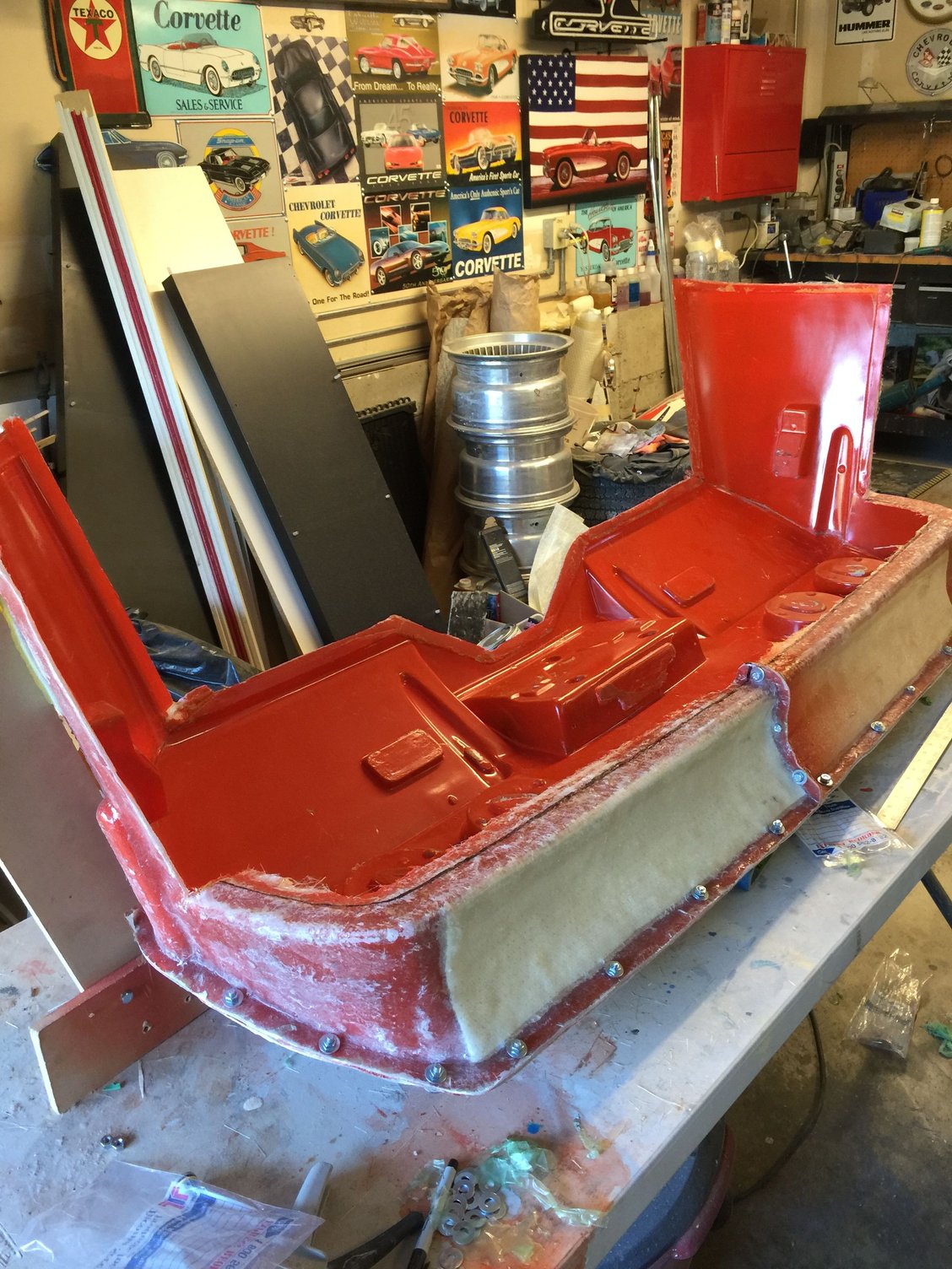

It is not an easy task to align the early rear bumper design to the later urethane bumper car, as everybody knows there are sufficient differences both in body lines and rear side market light locations. The only successful way I found was to make my own mold and build my own custom rear bumper. By doing this I was able to get things to line up and do some slight adjustments to the spoiler height and add a third brake light.
This is the mold that I made

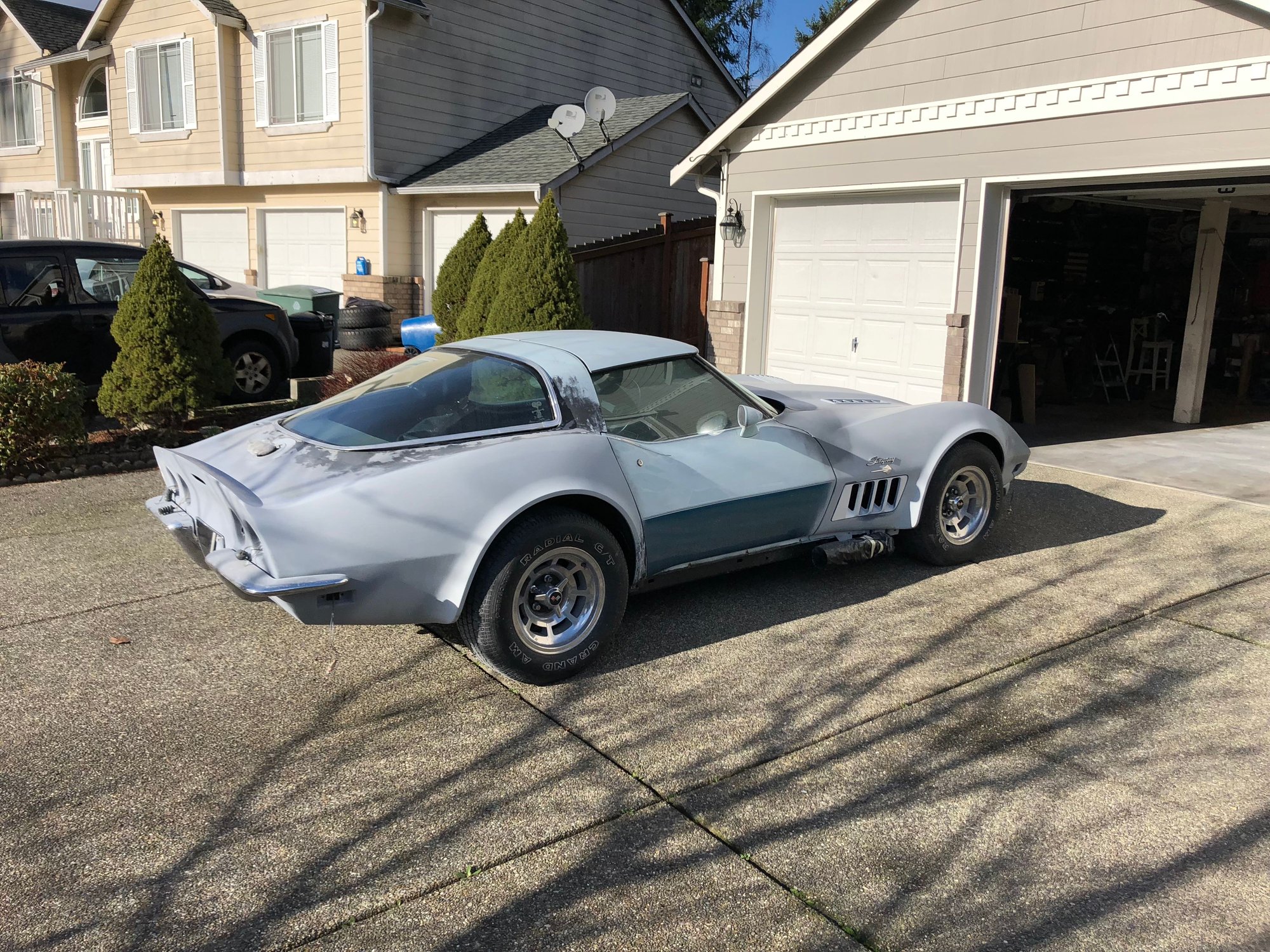

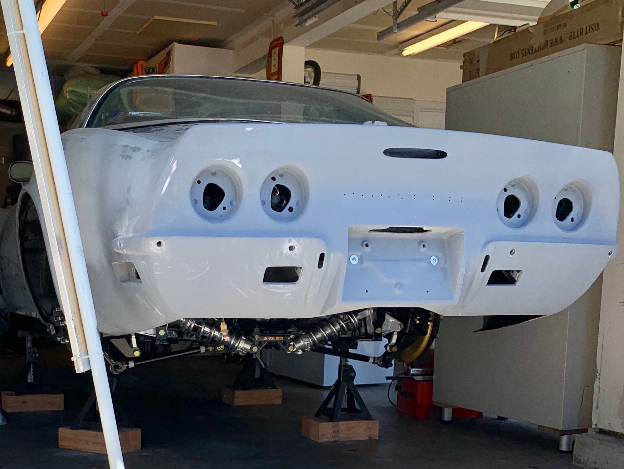

And the finished rear bumper
Here is a side view showing everything pretty much lining up and makes the whole rear end look one piece. The biggest task was building the mold, the actually fitting of the bumper was easy and very little filling was required to blend everything. I am sharing this just to encourage anybody wanting to do this and also concerned about wanting a factory type look that it can be done.
