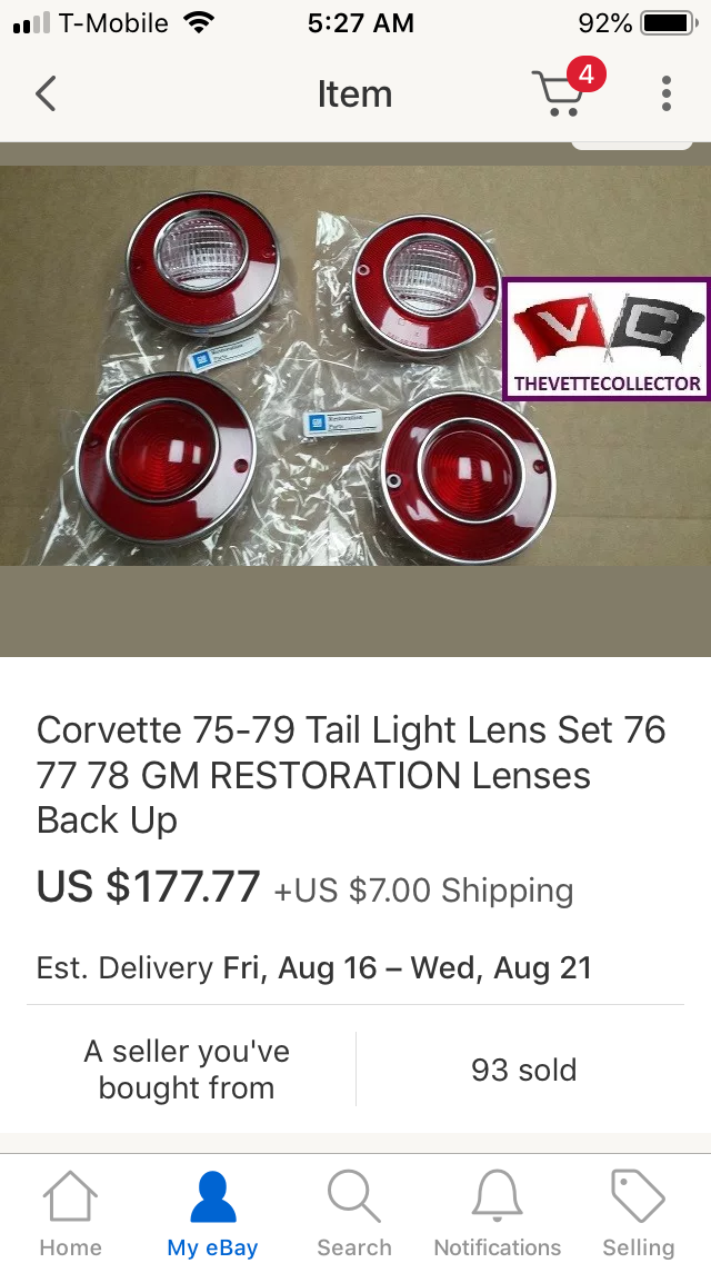

Wow, now that I can see the tail on a real car it looks a lot better than I expected. I've been going back and forth on this idea vs the '82 bumper for quite a while. Where did you get that chrome piece in the license plate well?

I bought it off Ebay from the crazypartsguys. They list it as a driver quality part, but it is much better than that. $68.00 to my door. Most of the major venders were out of stock on the NOS or GM approved ones, and they were more money

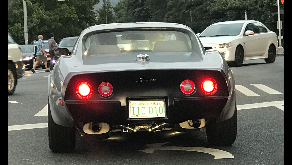

so what was your trick for splitting the rear '75 tail lights with out cracking them?

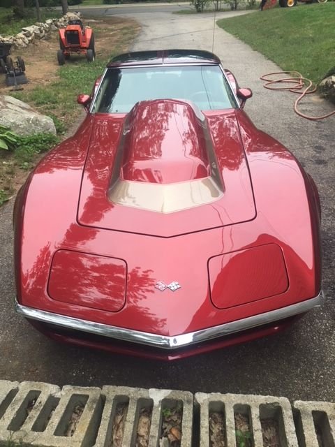

Thanks for the kind comments. This kit was from a non supporting vendor so per forum rules I cannot say whom it came from...….
The Taillights on this car are not 75 units but are 68-69 LED units that are directly mounted so no cups needed to be used.
Here is another recent view.

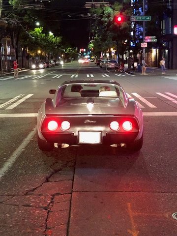

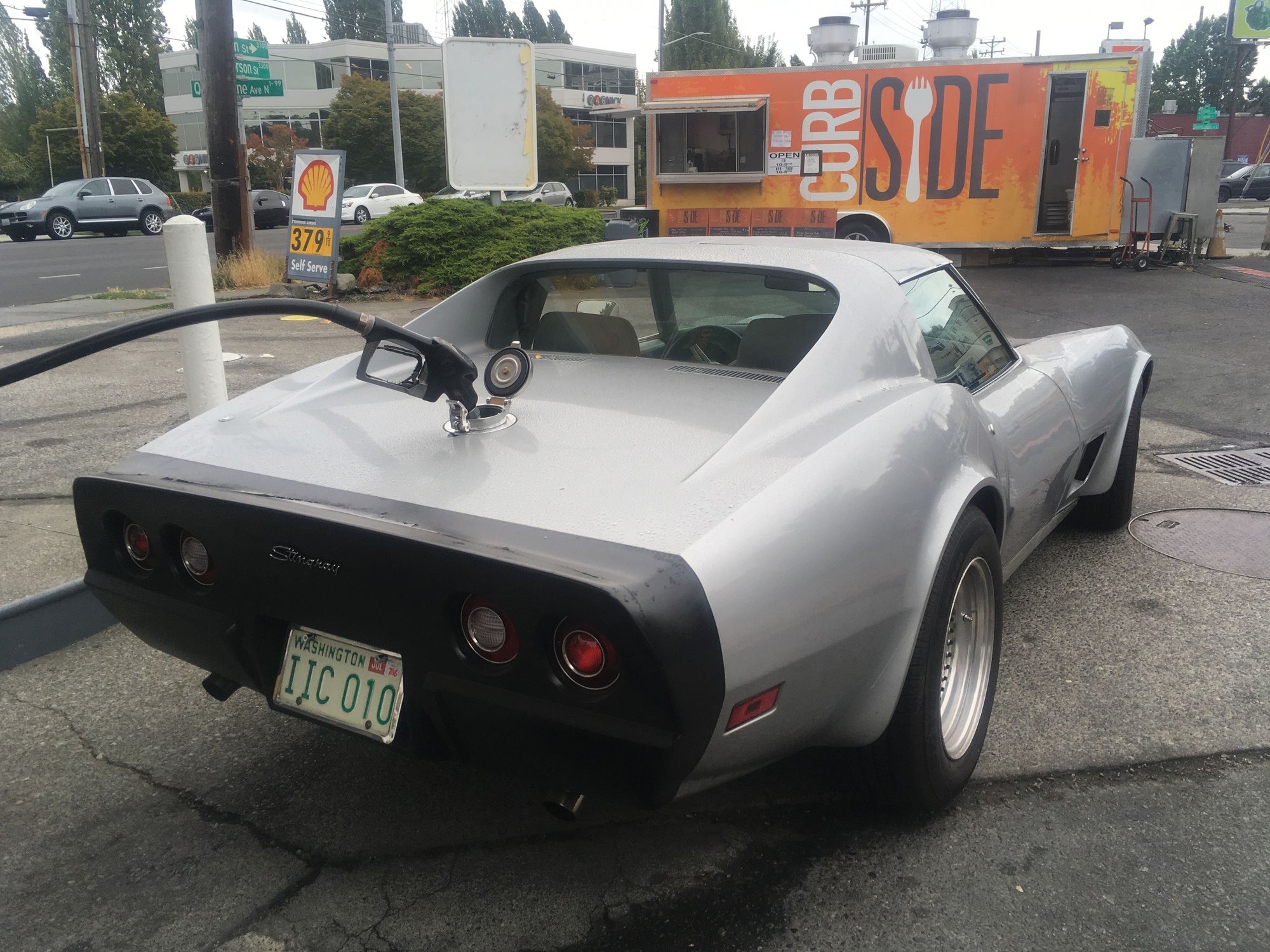

I bought new rear lights for my 75 and very carefully sliced them in 1/2 on my father’s bandsaw. Place them in the openings of the new bumper piece and drill your holes. I used a little 3M “dum-dum” on each 1/2 of the lights and installed them with custom hardware. It’s really not very difficult and looks great to my eye.

thanks, I kinda thought I'd have to use some sort of saw to open them up but I just wanted to verify that with someone that did it..
