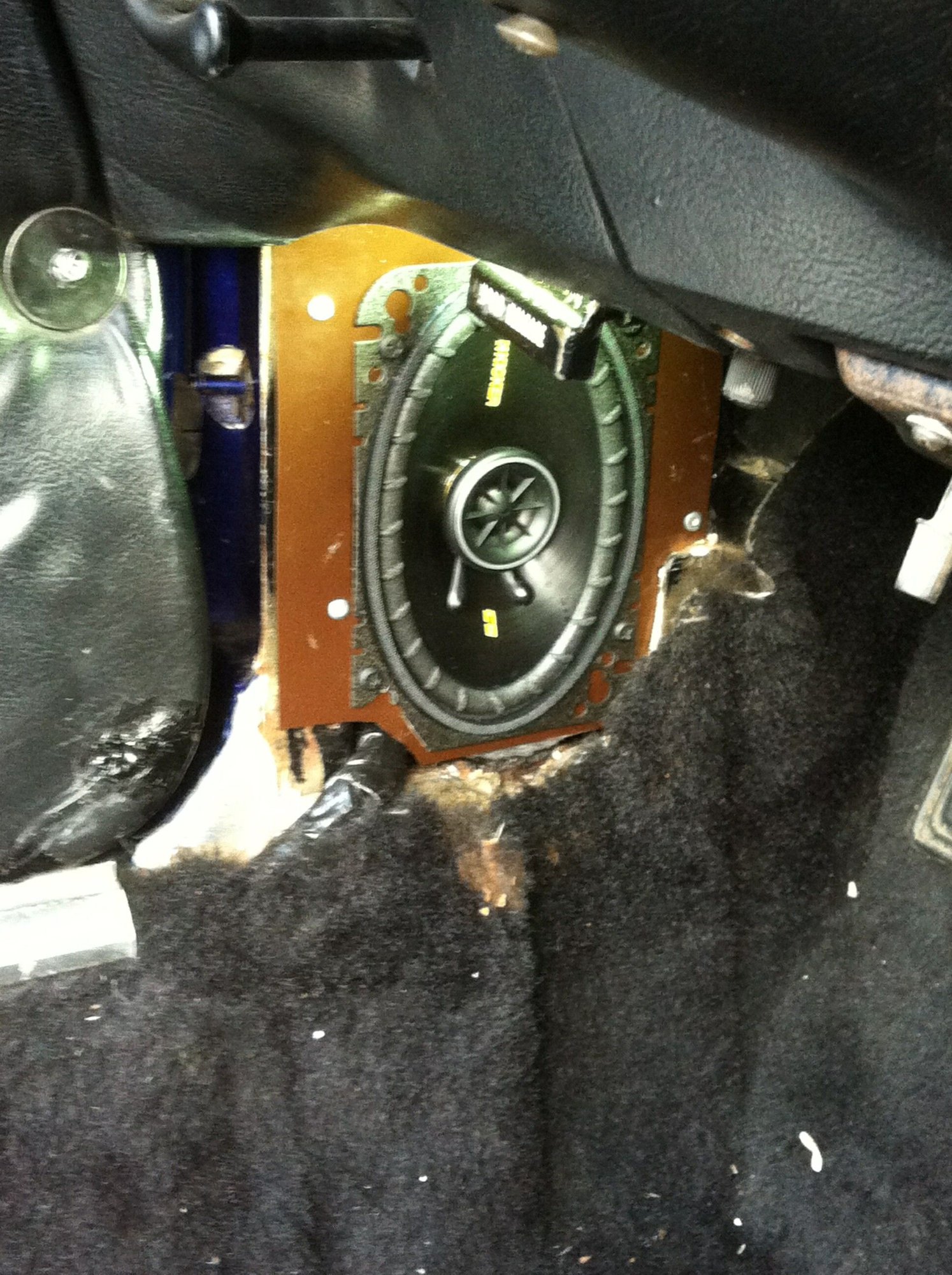

I pulled my interior out when I got my car too to install a nice new stereo.
I now have 9 speakers, an 8" sub and 1200 watts of power in my vette.
The answer to your question would be based on how much you like your tunes. I like to here mine when I drive down the road with the t-roof's off.
You can not see anything when standing beside my car. I have the 8" Infinity sub in the Tire Jack box, I have the amps mounted on the back wall and I replaced all the speakers with Kicker's. You cannot see any of them in my car.
If you want more information about the stereo, contact me and I can walk you thru what I did. I'm not a mechanic, I just like my music (actually I'm a computer programmer).

Couple of tips for the Corvette-
Do yourself a favor and get a dash bezel that accepts a DIN opening- Opens up your choices big time and a better radio will cost less.
For the front speaker- they are better served by running some "bass blockers"- will keep the speakers from doing something they can't- as they are too small to produce any real bass.
300HZ ones will work great-
https://www.crutchfield.com/S-N1Cw2d...z-cut-off.html
For the kick panels- put the plastic originals in your garage and make a couple panels out of some 1/4 MDF -You can front load the speaker and get away with a bigger 6.5"
Richard

Brenden,
Go with Richards Idea and get a face plate if you can find/afford one. I purchased an after market one that doesn't look as nice as a real face plate. I had to grind out my existing one and add the new face plate over the original. It looks ok but if you are looking for perfection get a full face plate.
I also used the 300 hz base blockers in my uppers too.
But I never use MDF in an area where water can collect. The lower part of the bird cage is such a place, hence I used foam speaker covers and just cut piece of metal as a face plate to fit in there. You can't see the speakers from the outside. I don't get much base from these but since I have a sub in the back, I don't need much.
Hey Ken-
I'm not a fan of mounting a speaker to metal.
You can shoot the MDF with undercoating- it will keep it from soaking up moisture and help deaden resonances.
Good point re the baffles-
The big thing about mounting speakers in cars- is what's know as an acoustical short circuit. The sound waves from the front of the speaker are 180º out of phase with the back of the speaker- not baffled they will cancel out a lot of bass.
Richard
