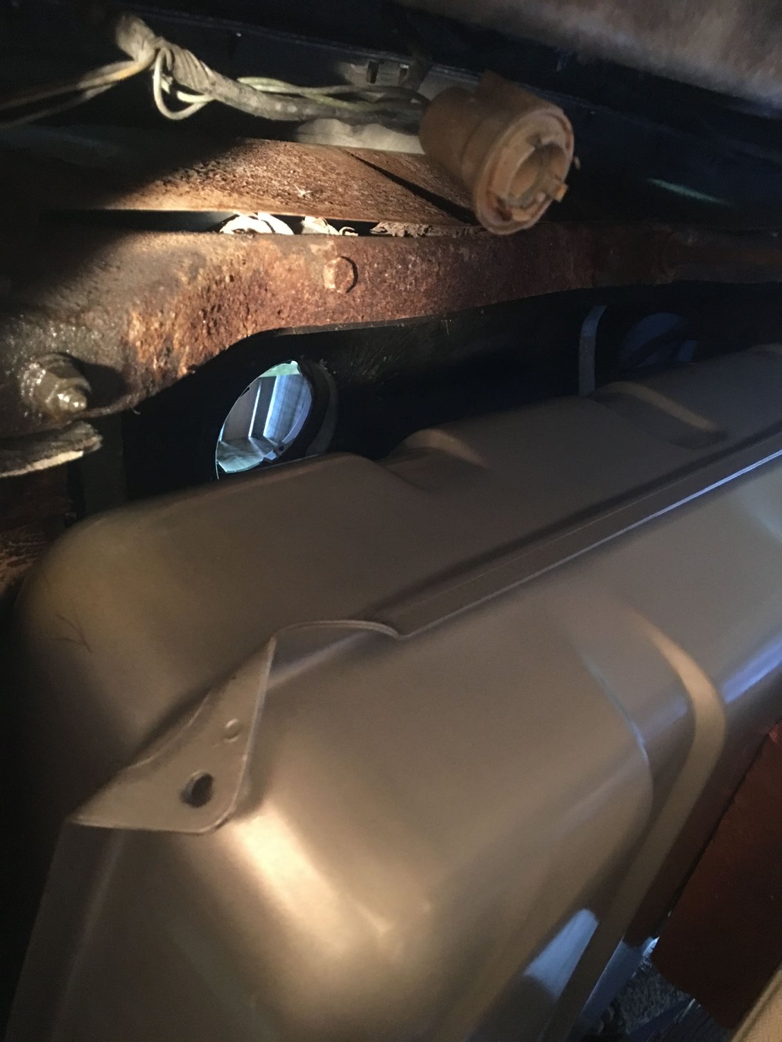

Hey guys we are at the point where all the hoses are connected to the tank, now we are trying to get it up there so we can connect it with the straps. Does anyone know how to clip them on the tank?

The tank straps first hook through the bolt-in-place tank crossmember the front of the tank sits on, and then after the strap is passed over the tank towards the rear of the car, the other end of the strap with the nut on it is pulled down snug toward the rear crossmember using bolts that pass through holes in the crossmember. The straps aren't fastened to the tank at all, the straps 'trap' it in place when they're tightened.
Look at UPC A8, Sheet 2 in you AIM. The connections are shown in 2 details on that sheet.

Here is the installation page from the assembly manual for 1975-1977. Hope this helps.

Are there any tricks to getting the tank up there?

thank you that diagram is going to help, now just trying to get the tank up there.
Thanks
Tanner
Not really.. just a bunch of grunting if you are doing it on the ground. If you have a lift, we use a transmission jack to push the tank into place.
