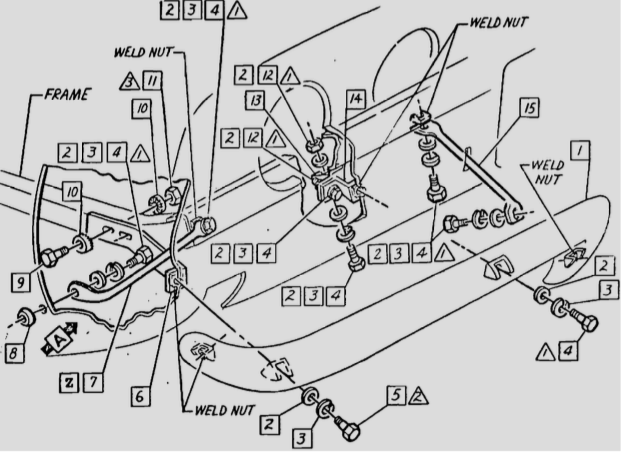

Hi ntd,
I looked at my notes from my 71 bumpers and there are 3 different 7/16"x14 bolts noted…. but they are all listed as 1-1/4" in length.
BUT, 71 cars don't have the bumper bracket that runs from the frame to the SIDE of the bumper.
Doesn't the bolt you describe pass through that bracket and then the fiberglass and tighten into the bumper, not into the bracket?
Regards,
Alan
Is this the location of bolt you're having a problem with? (Remember, this is a 71 so there is no bracket.)
[/QUOTE]
Alan, that's the location of the side bolt. The one I'm having issues with is the the bolt on the corner of the bumper. It's that one that screws in the outer bracket.

Hi,
Ah, this bolt.
Regards,
Alan
This bolt.
