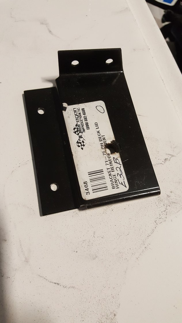

I seem to have hit a snag on my 81 convertible conversion, I can't for the life of me figure out how the mounting plates attach for the rear deck hinges. I purchased new plates but can't seem to get them in the right position. Would anyone have a picture of the hinge plate or bottom area of the deck hinge? thanks.

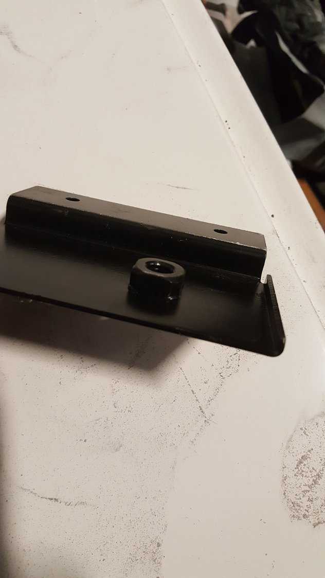

Old Aug 16, 2017 | 12:15 PM
suprkoop's Avatar
suprkoop
Joined: Mar 2013
Posts: 209
Likes: 41
From: Blue Point NY
Ok, so these are the plates I bought for the deck hinge mounting, however they don't seem to line up with the opening above the #4 mount in any position. Am I missing something else or was the mount opening different on an '81 than a '75 ? I have the AIM but it seems really weak on the convertible parts and assembly.

Originally Posted by suprkoop
You have it going the wrong direction. The 2 holes on the short tab should be against the outer wall and should line up with the existing rivets on that wall. Then the 2 holes on the bottom should line up with the existing holes on the floor pan.
This would only work if the rivet moles are the same between the 2 years, which I am unsure of. But, that is how it should mount up.
Edit: You will have to drill out the old rivets and install new ones. Essentially you will be sandwiching the fiberglass between the 2 brackets.

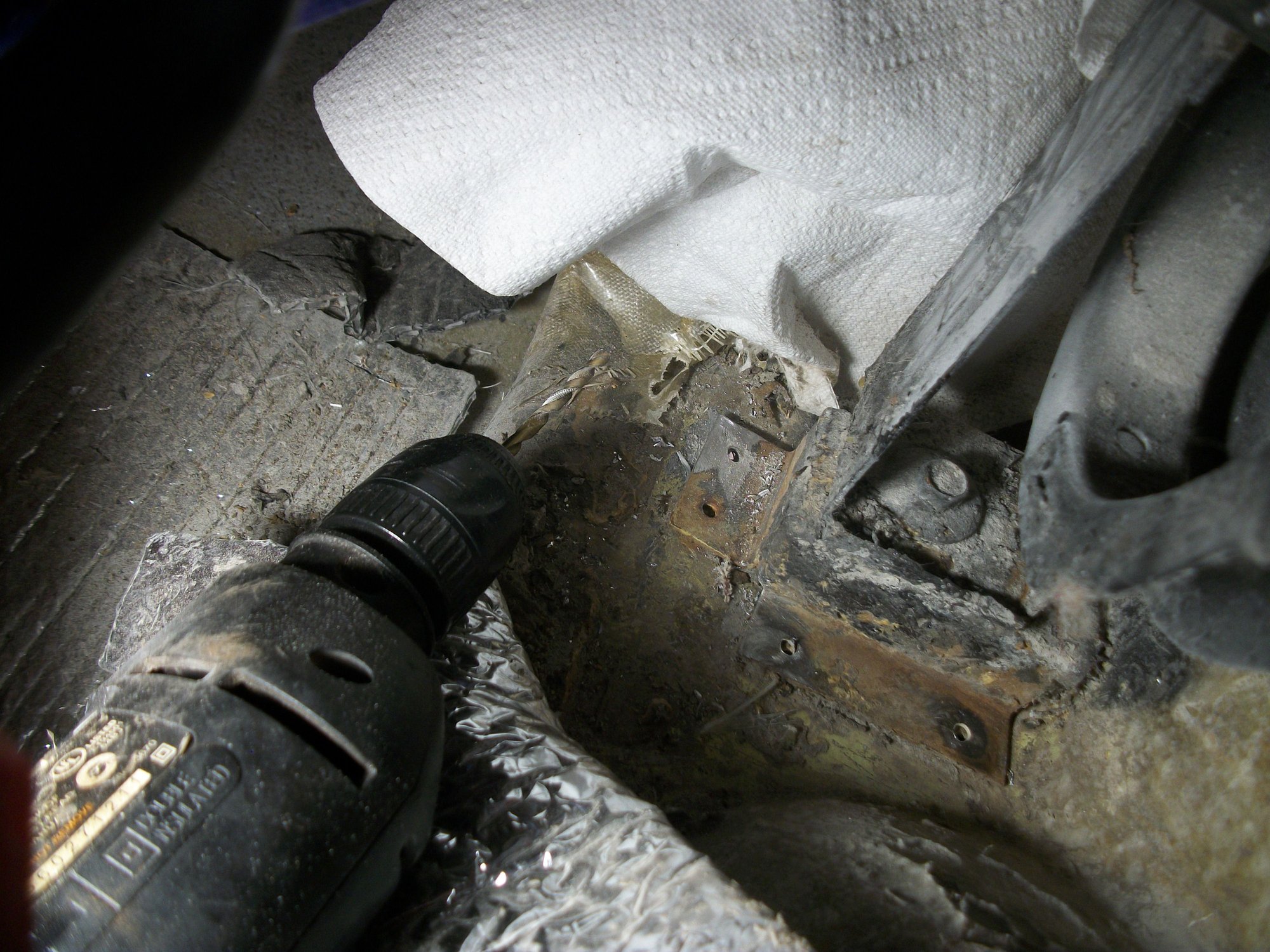

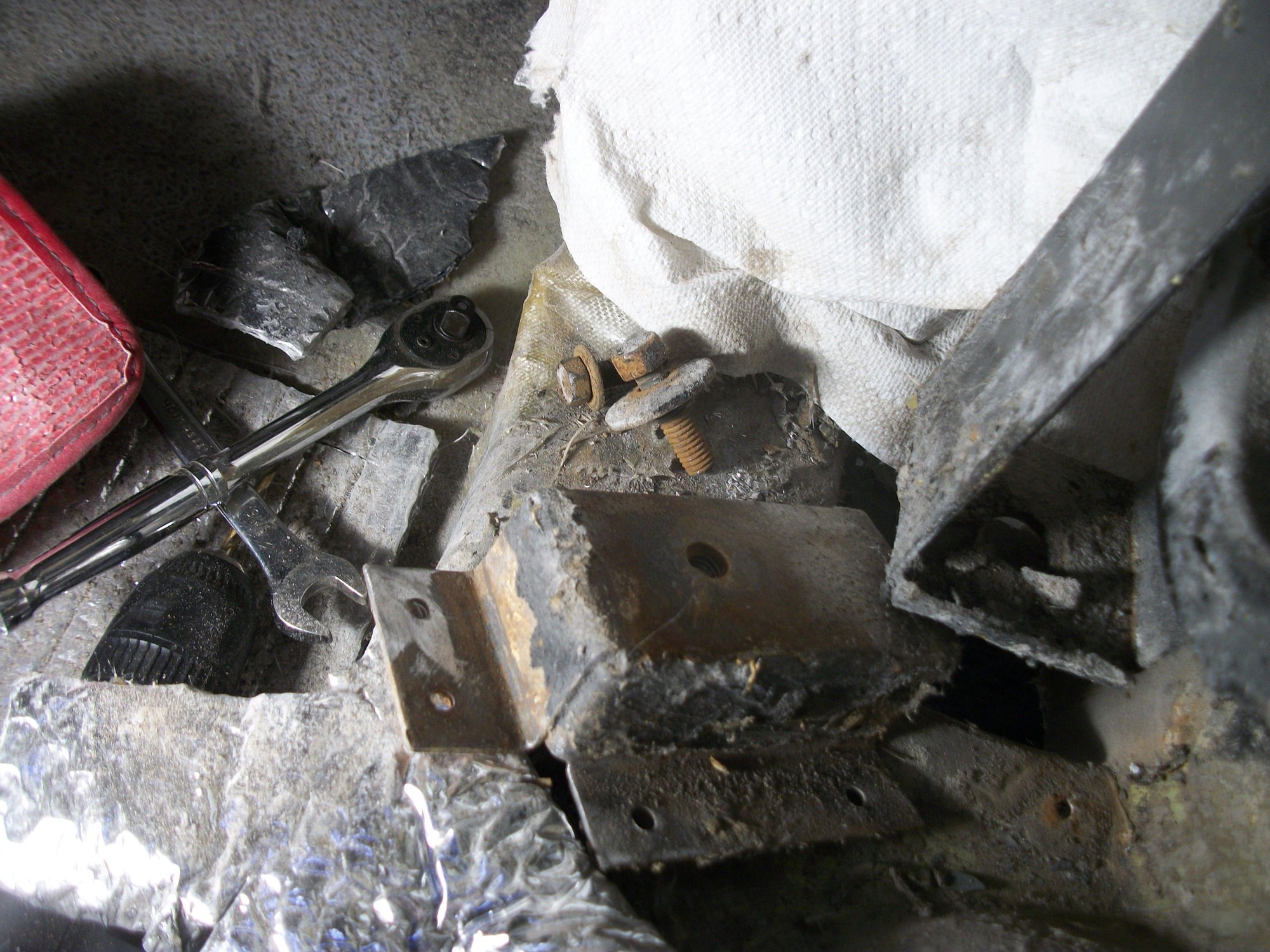

Old Aug 16, 2017 | 04:56 PM

Originally Posted by doorgunner
you're my inspiration, thanks

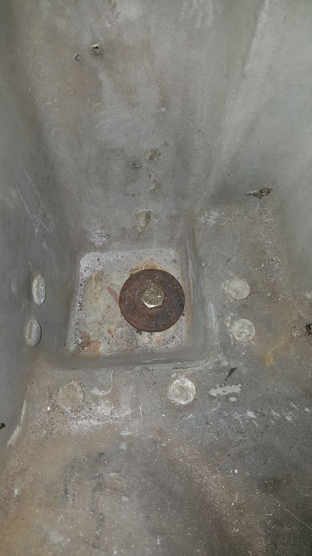

Old Aug 16, 2017 | 06:08 PM
doorgunner's Avatar
doorgunner
2026 Loser of the Year
Posts: 36,597
Likes: 7,046
From: New Or-leens Loo-z-anna

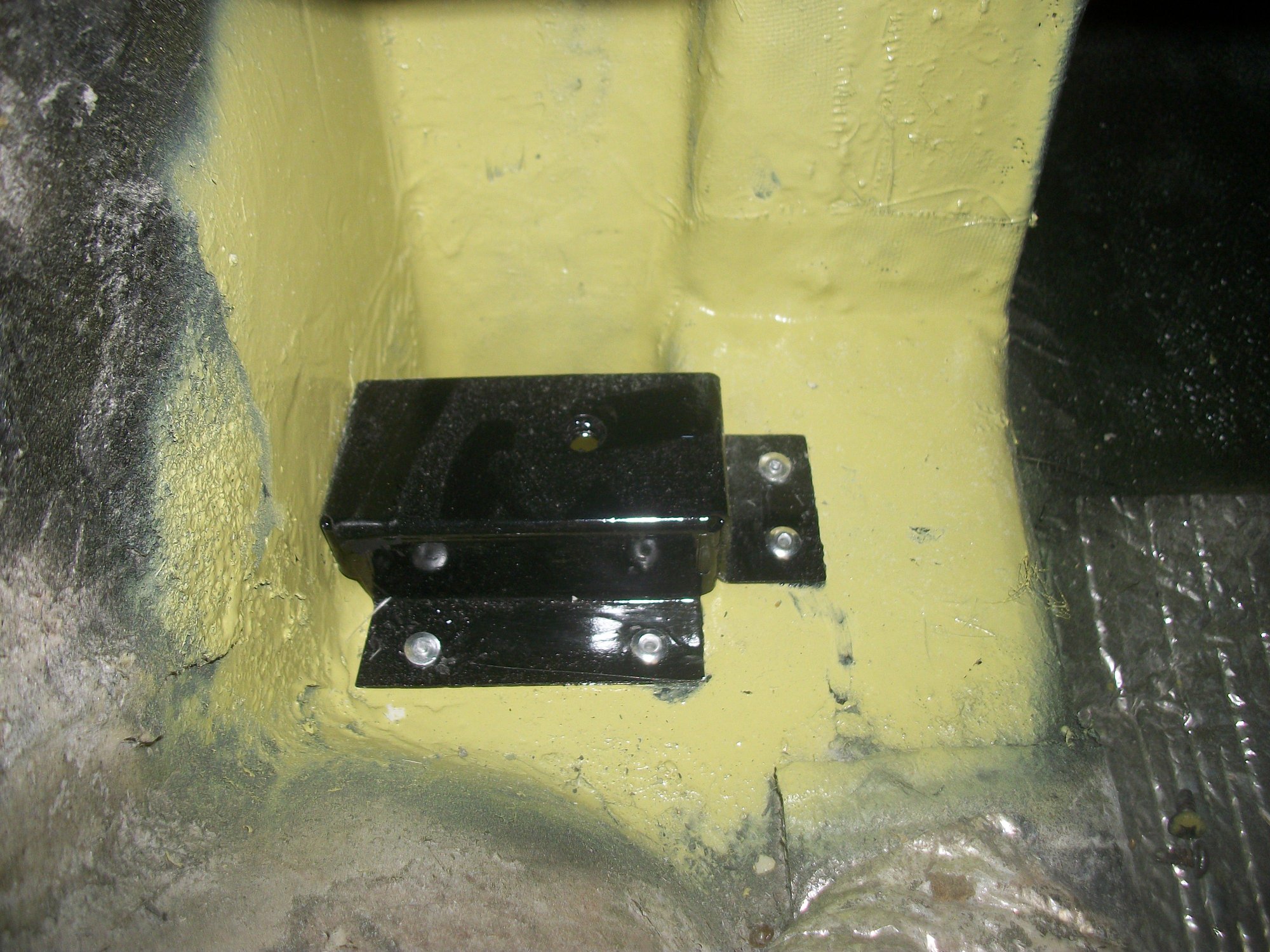

I cheated and converted to a bolt instead of a nut cage in the last picture when I rebuilt the fiberglass area below the deck hinge bracket.
so did I...

Old Aug 17, 2017 | 07:25 PM
DUB's Avatar
DUB
Joined: Apr 2009
Posts: 19,294
Likes: 2,754
From: Charlotte NC
so did I...
I am all for doing away with the caged nut if it has failed...which was there only for ease and speed of assembly.
But I would like to suggest that you invert the bolt and have the threads inside the car and head head exposed to what the rear tire will throw on it.
Just a suggestion.
DUB
Just a suggestion.
DUB
Good idea, thanks, I'll make sure to invert it before I put in the plates...
