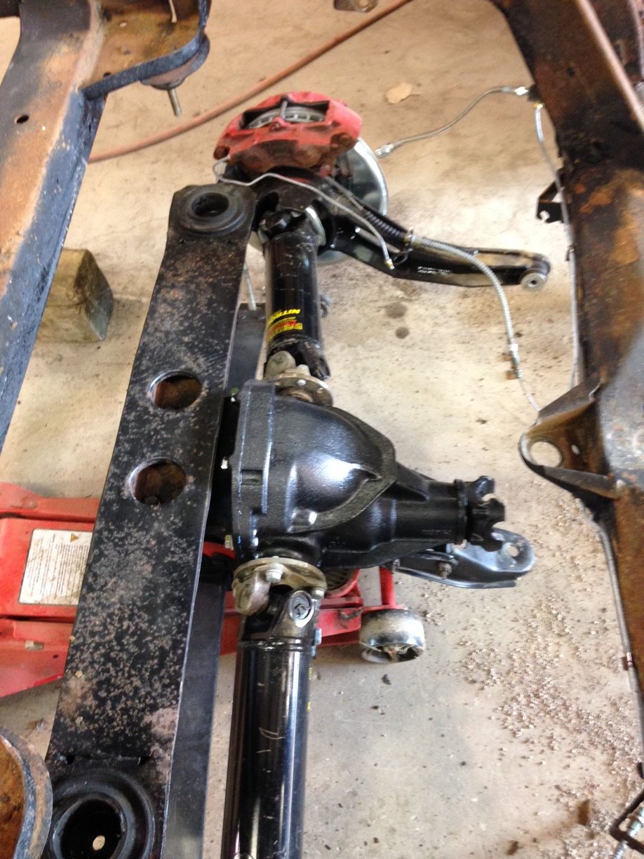

Dropped the rear end out yesterday. Now I just have the brake lines to remove and the tank and tranny cross members to remove and it ready for the blaster.
Side note, see the scratches all over my new Denny's Driveshaft Nitrous Ready half shafts, the painter threw chains or something similar over them when he moved my car. For those who read my "My painter screwed me" thread, you know about my problems with him.
