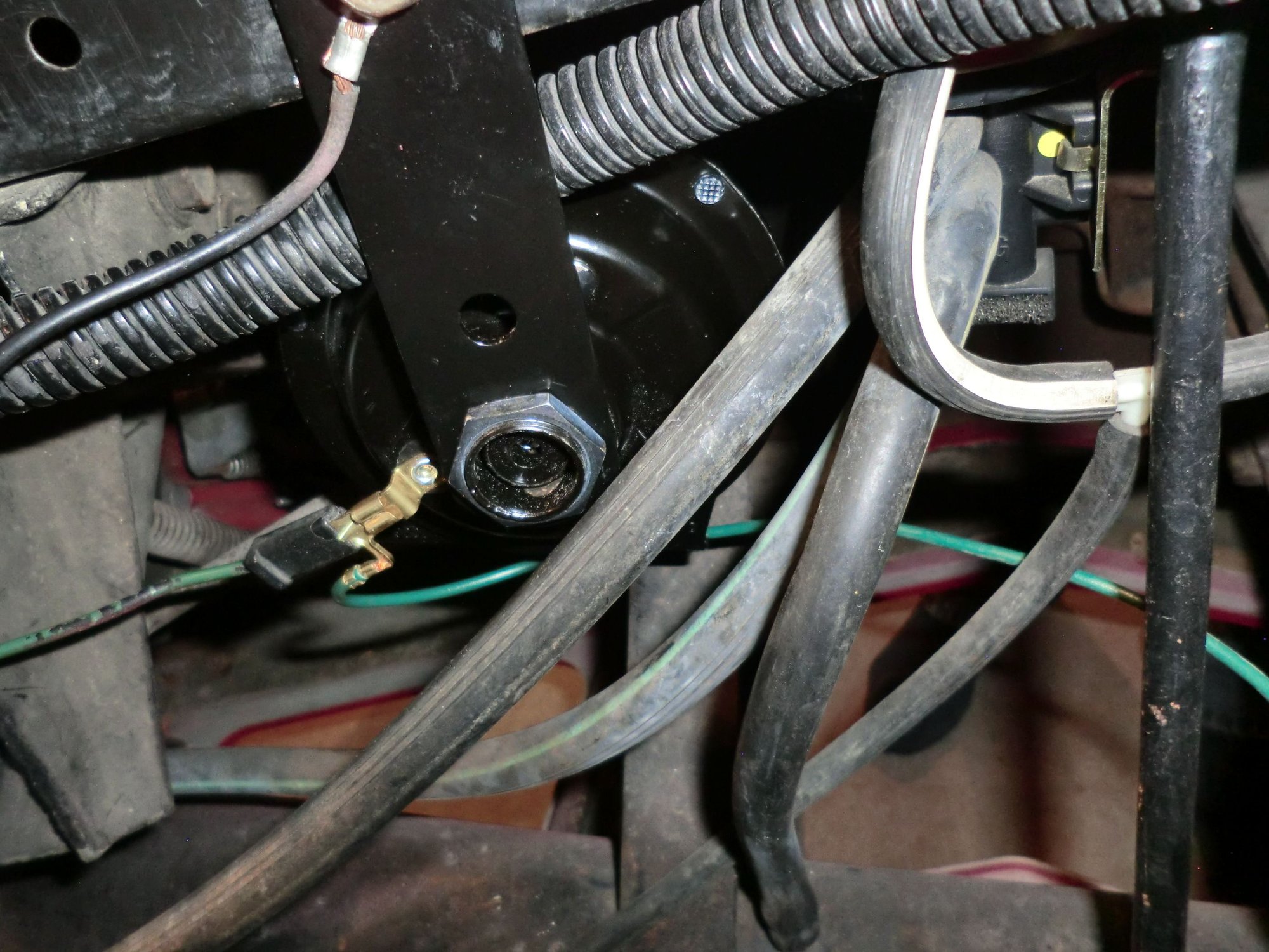

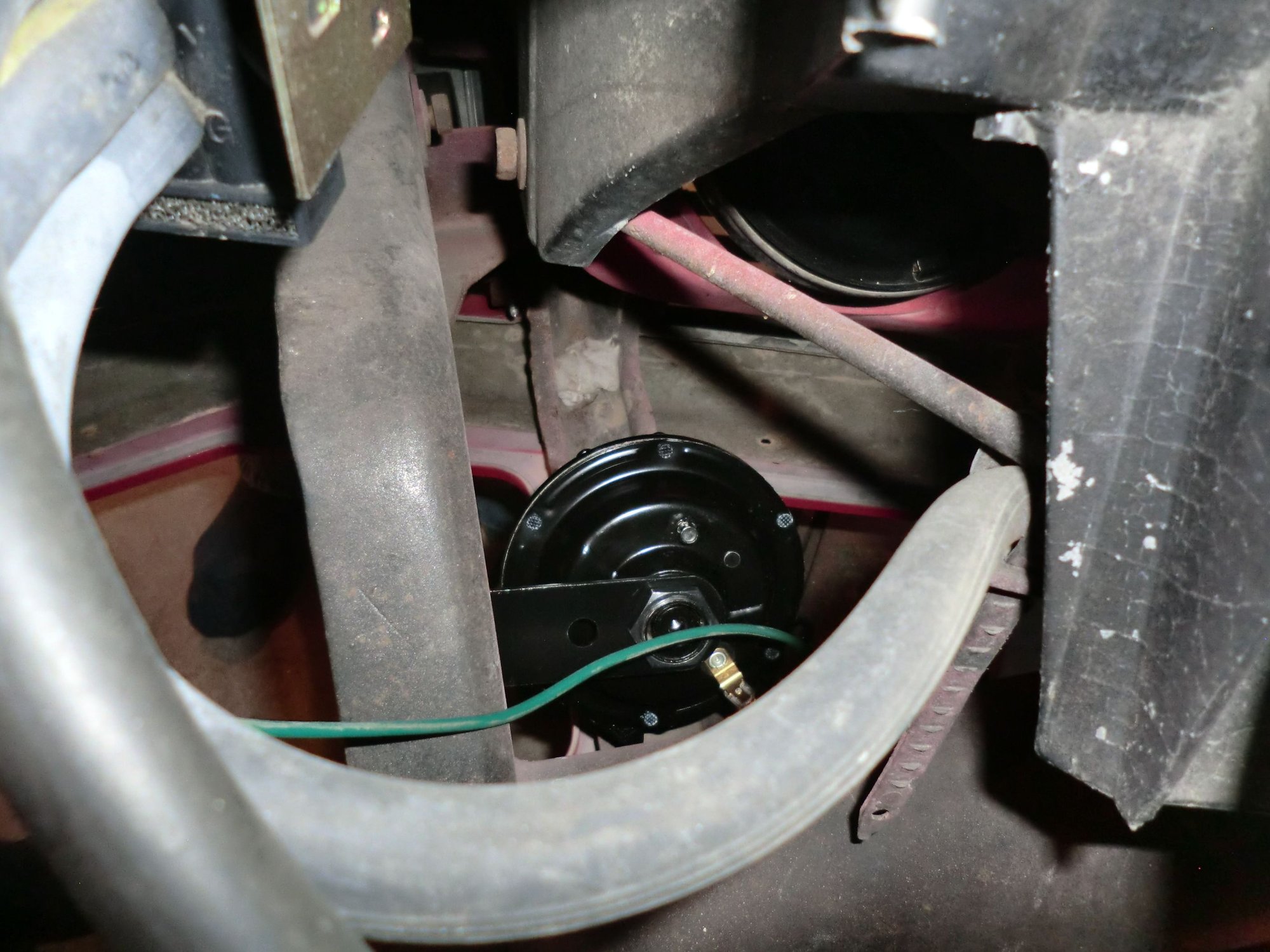

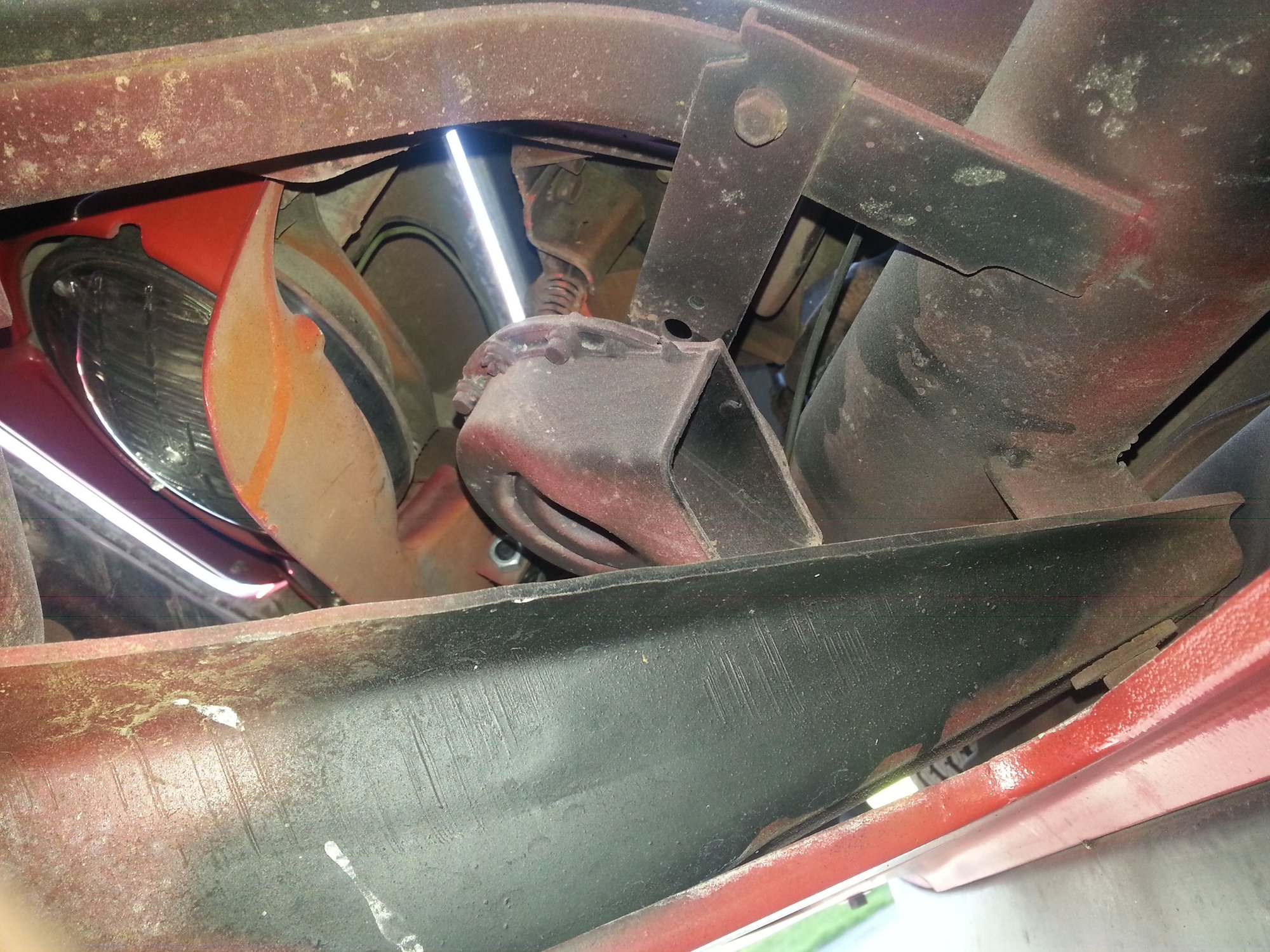

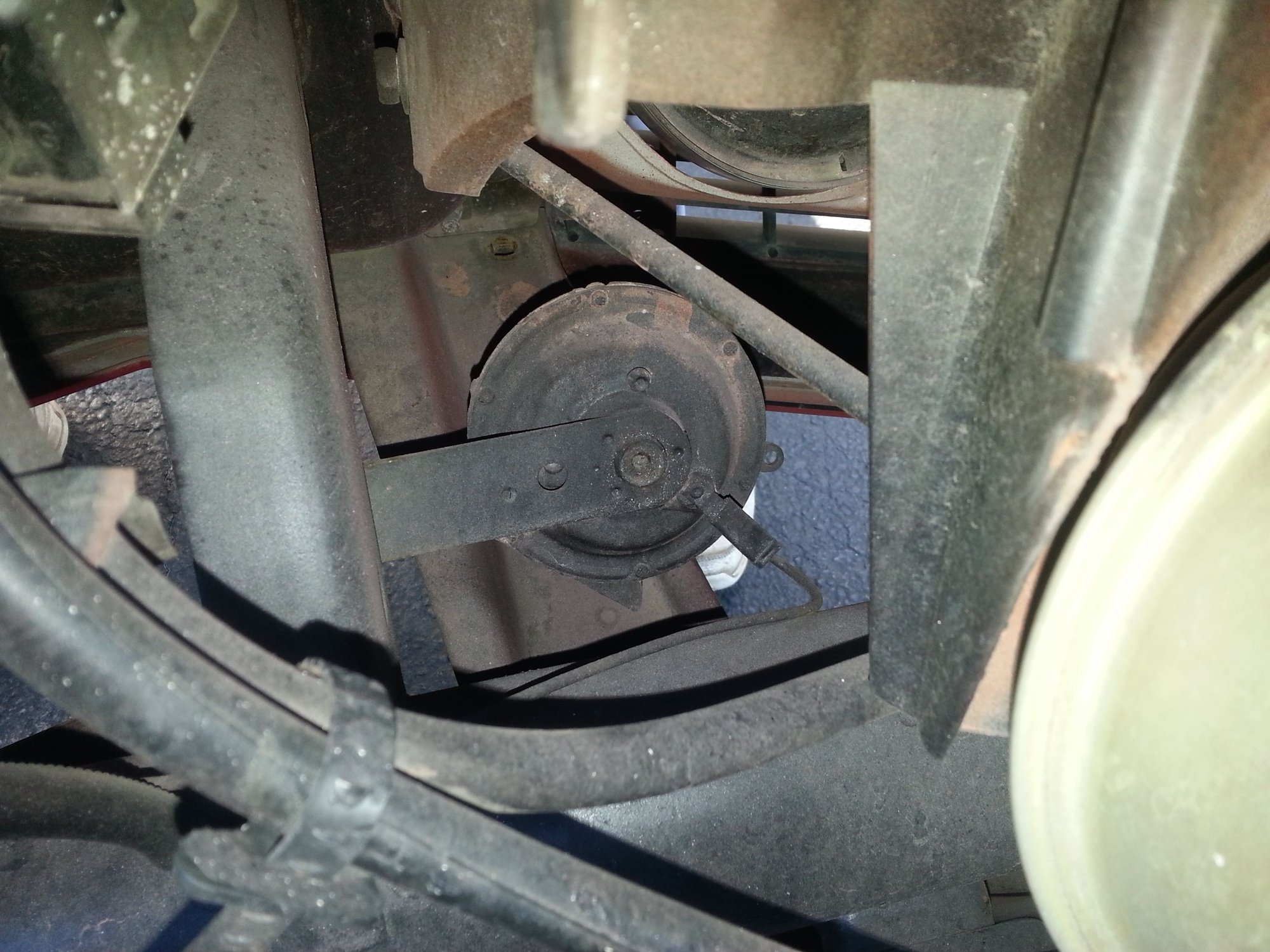

Here's some pics of a factory installation of dual horns that may help.
Driver's side looking down.
Passenger side looking down.
Passenger side looking up.

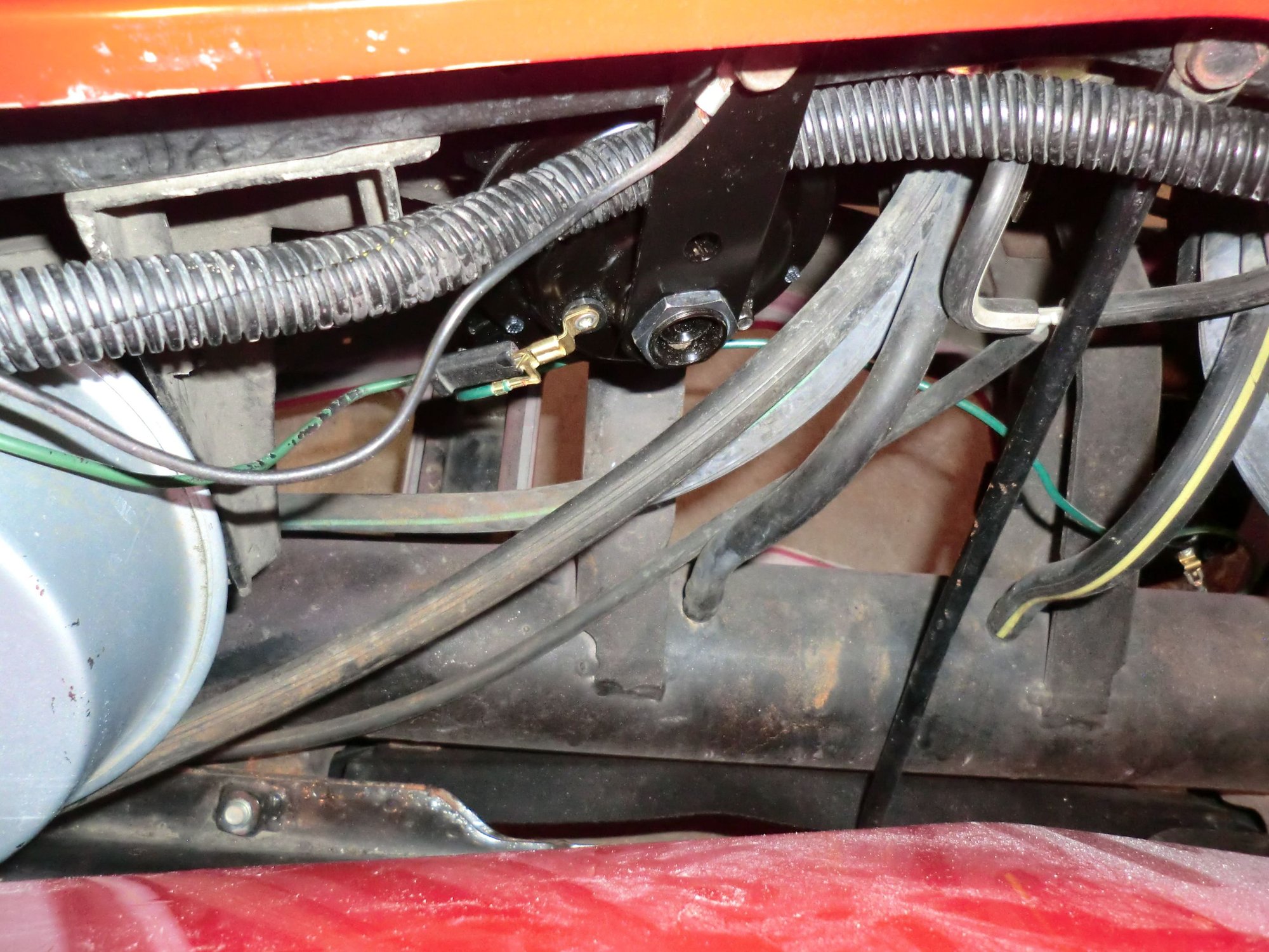

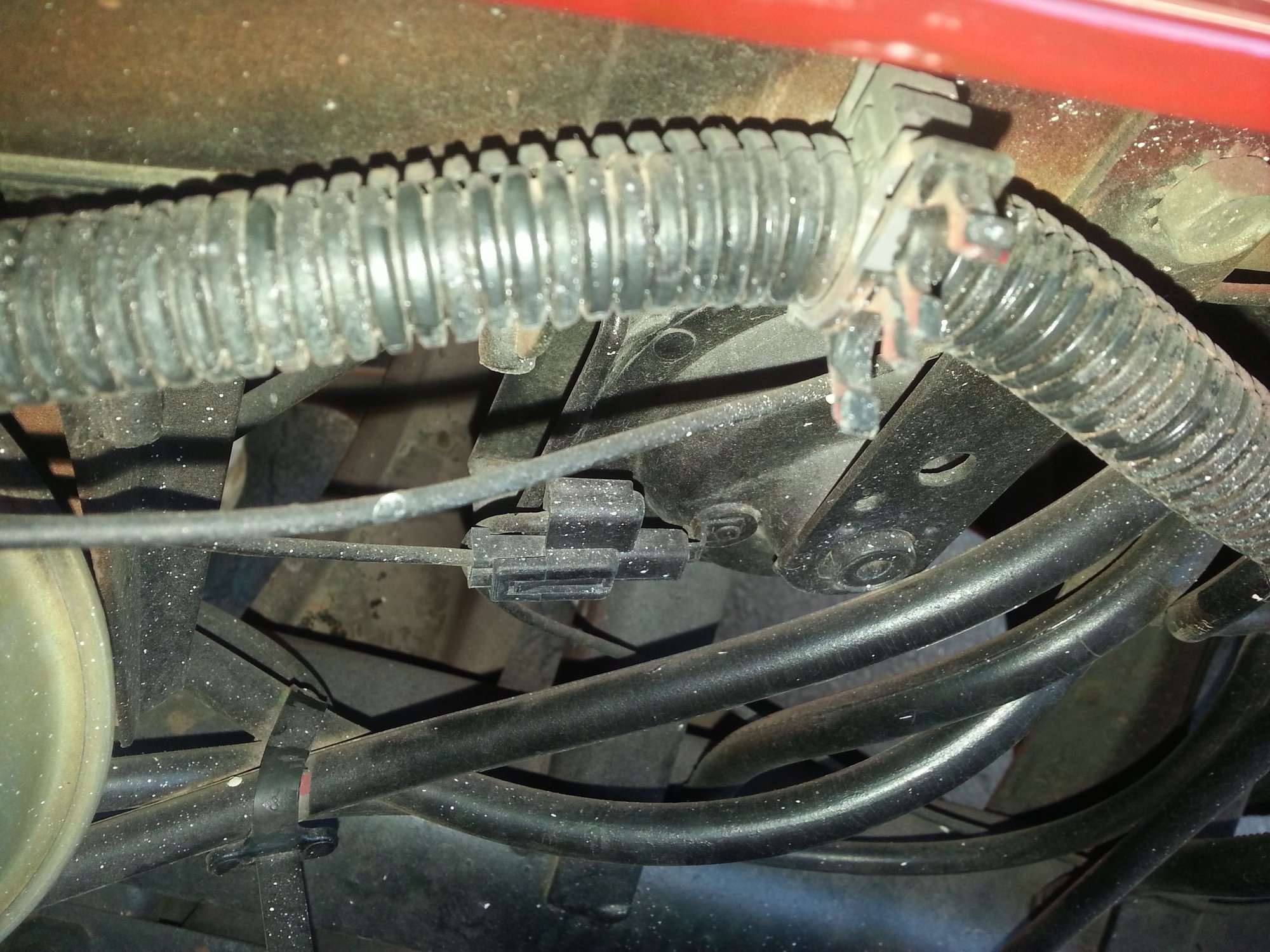

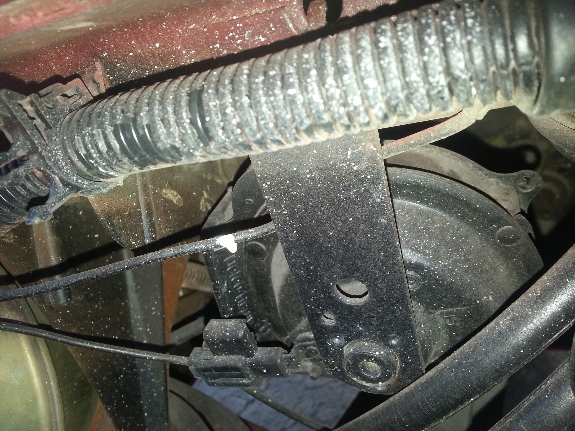

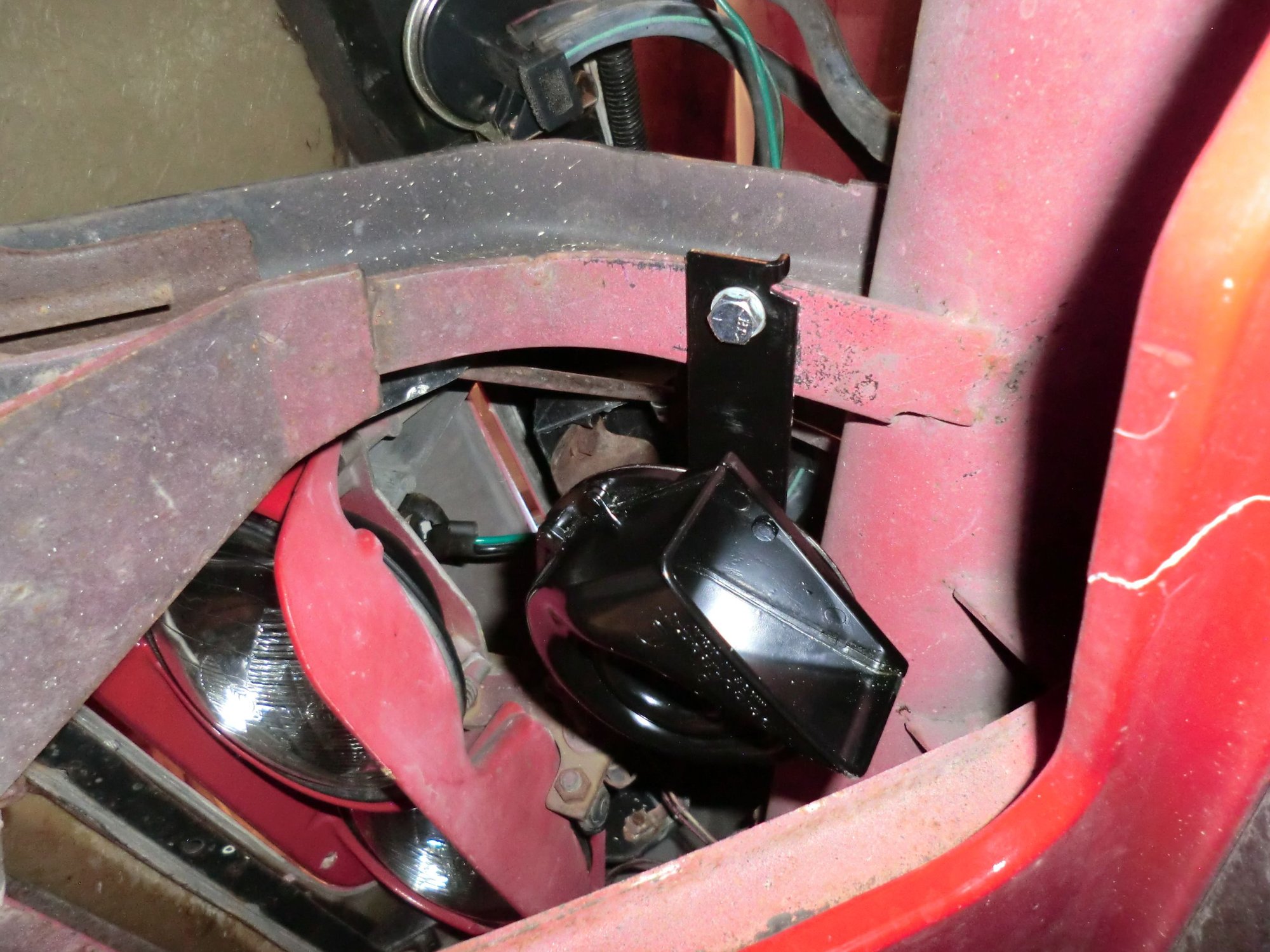

And here's pics of my installation on my '73.
