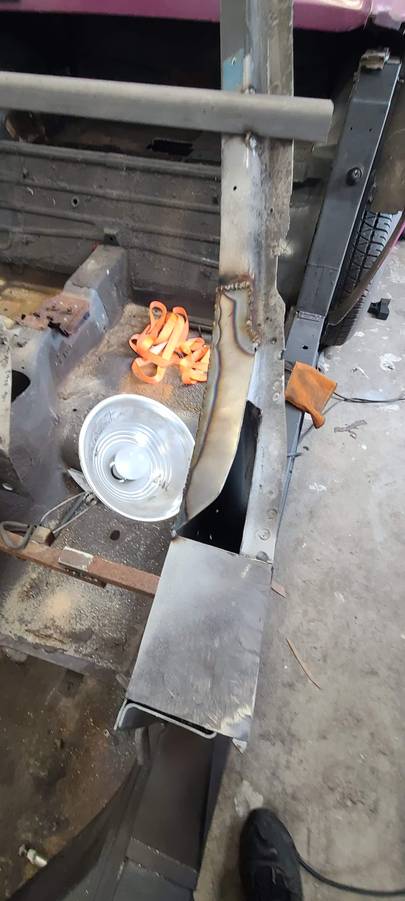

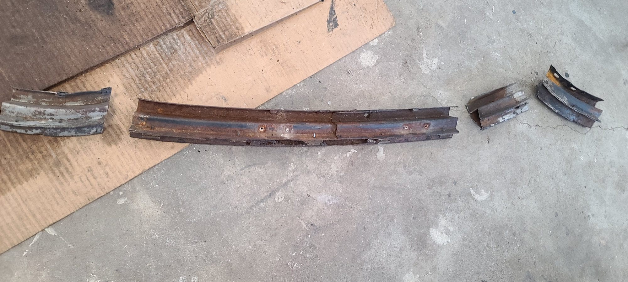

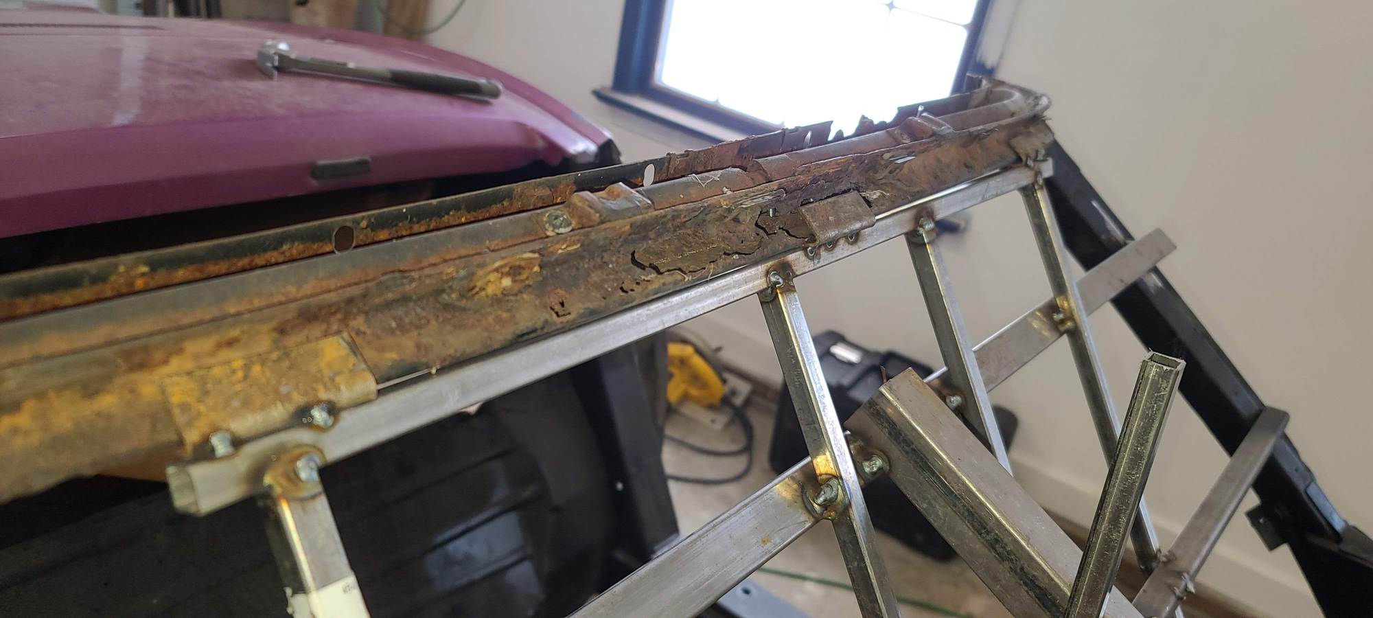

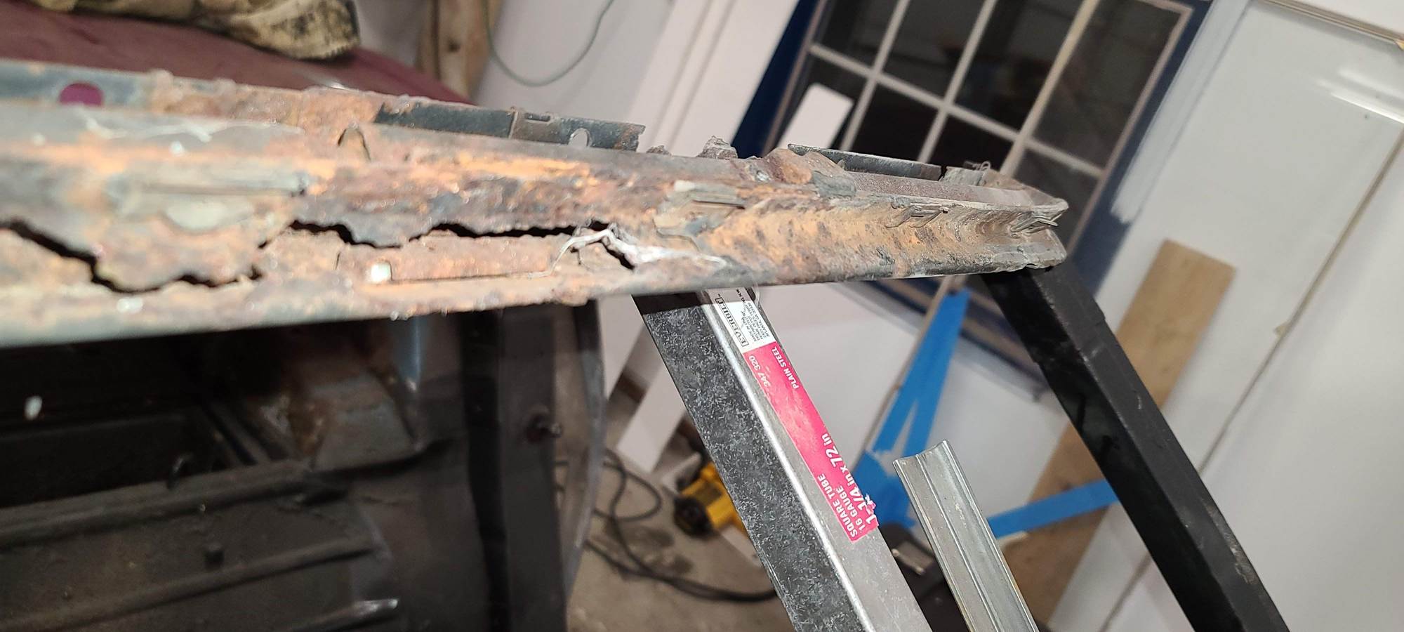

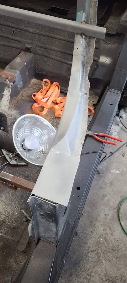

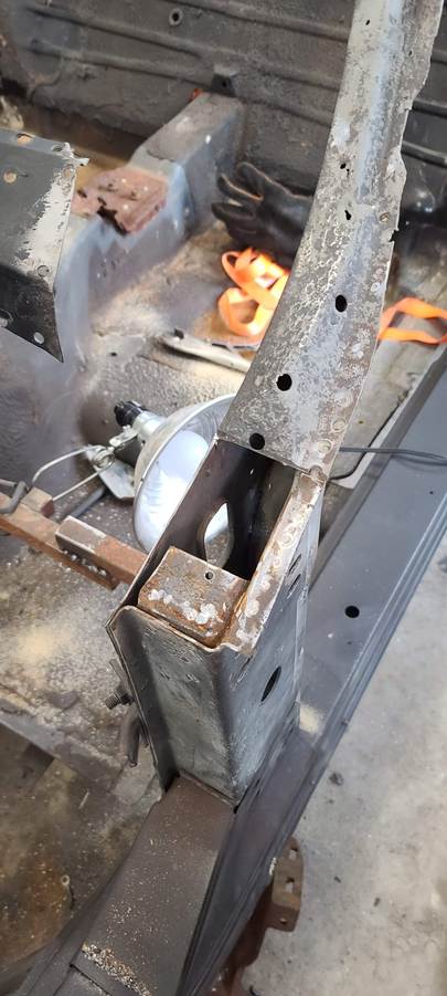

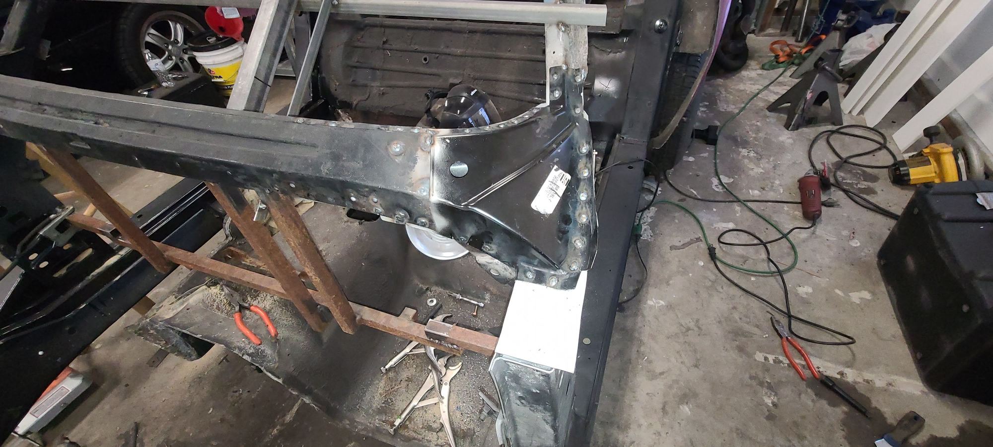

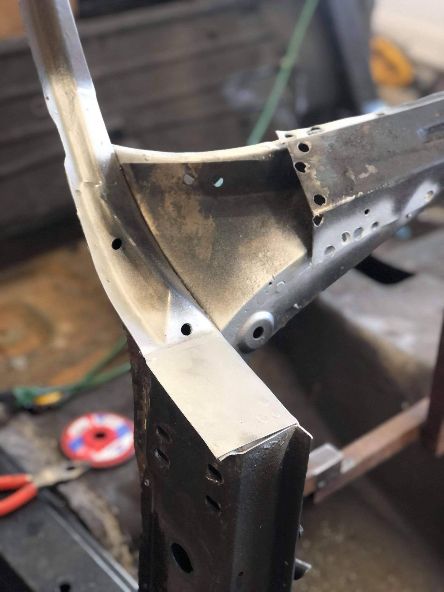

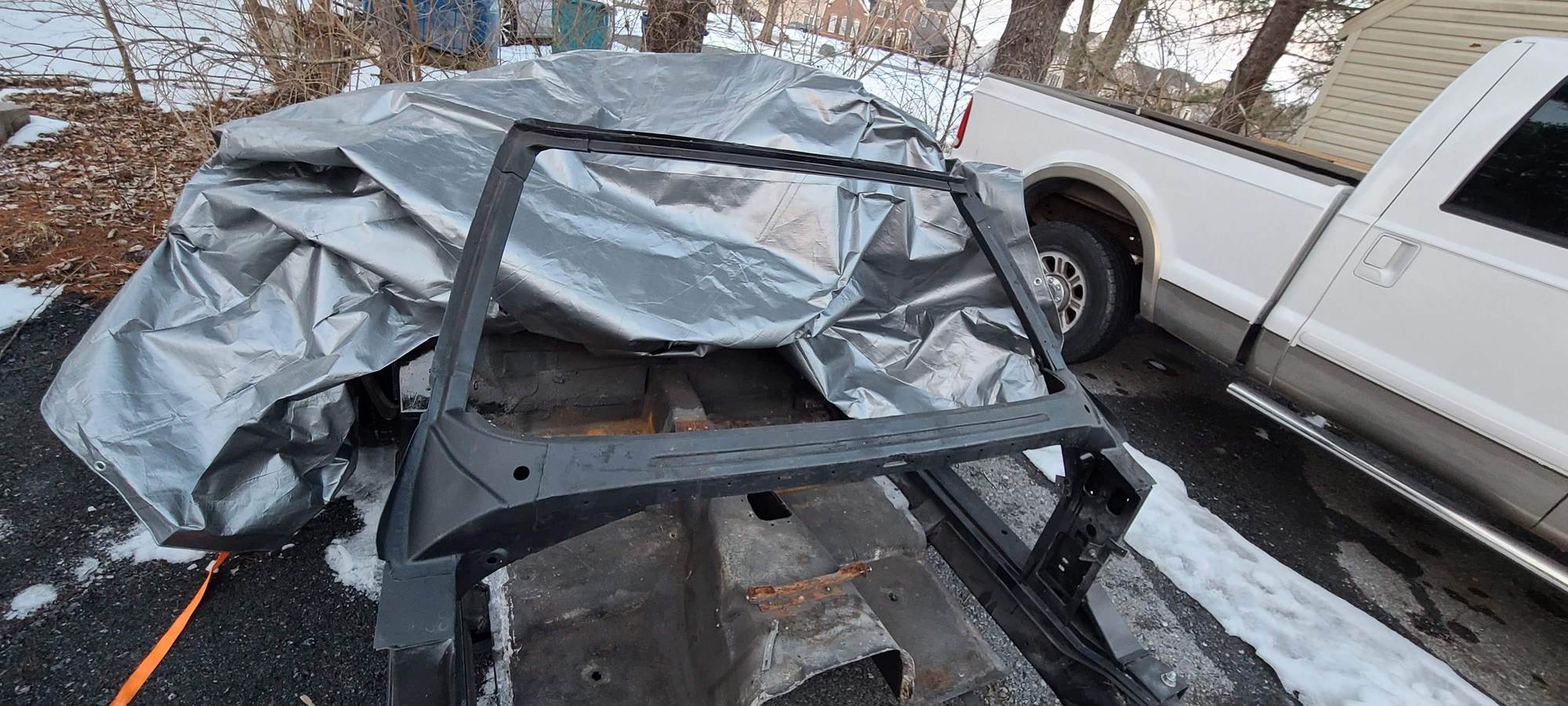

Took care of the lower inner and outer this weekend. The upper windshield bar is next.

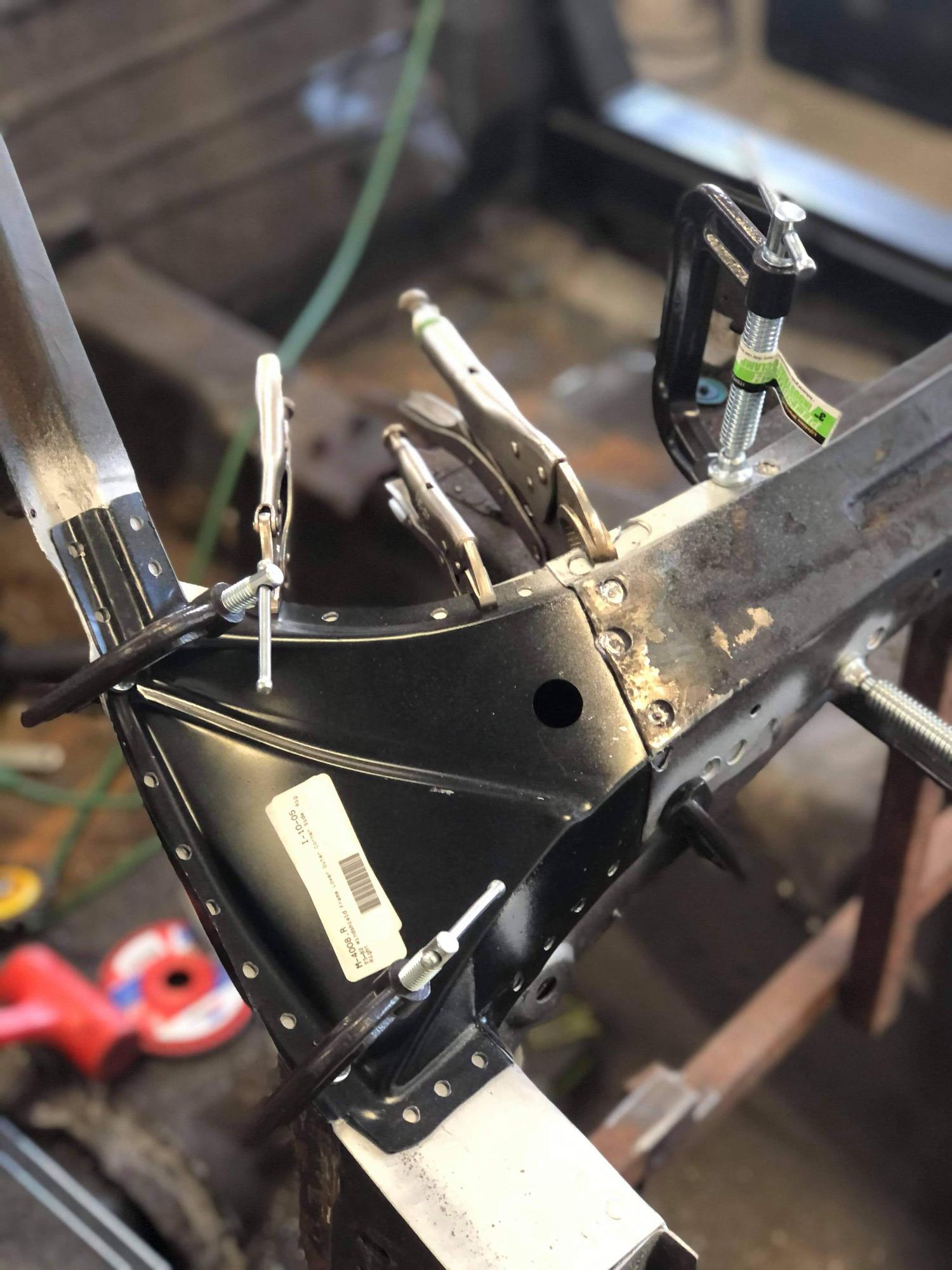

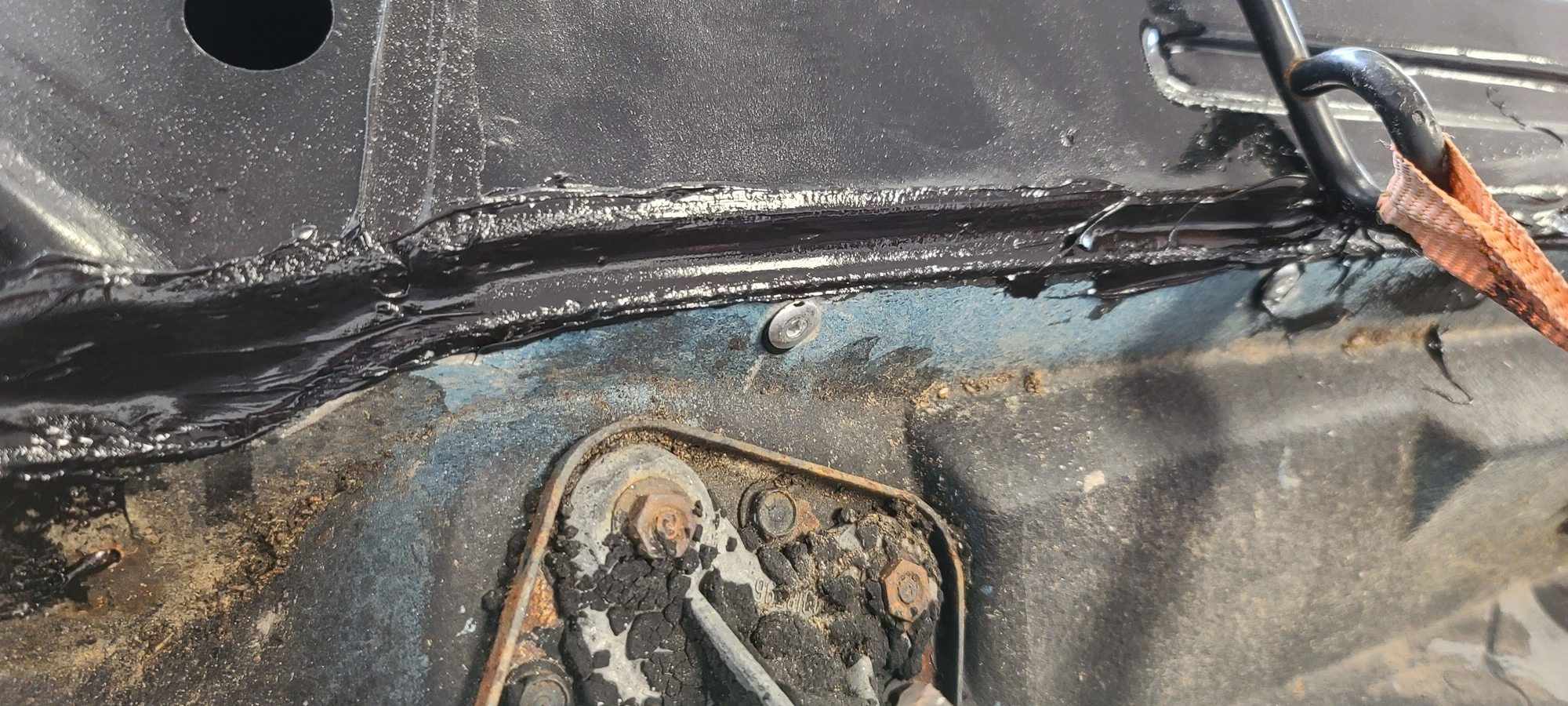

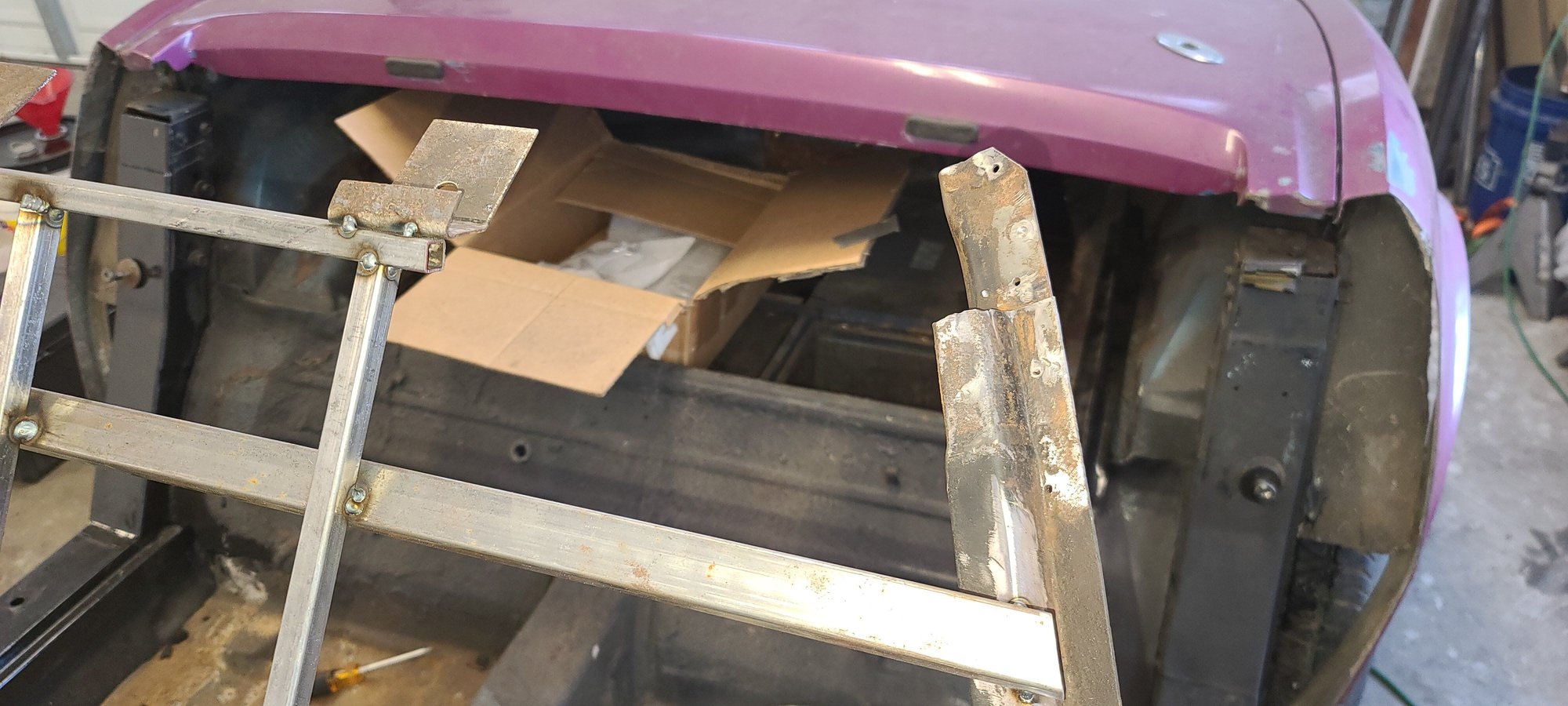

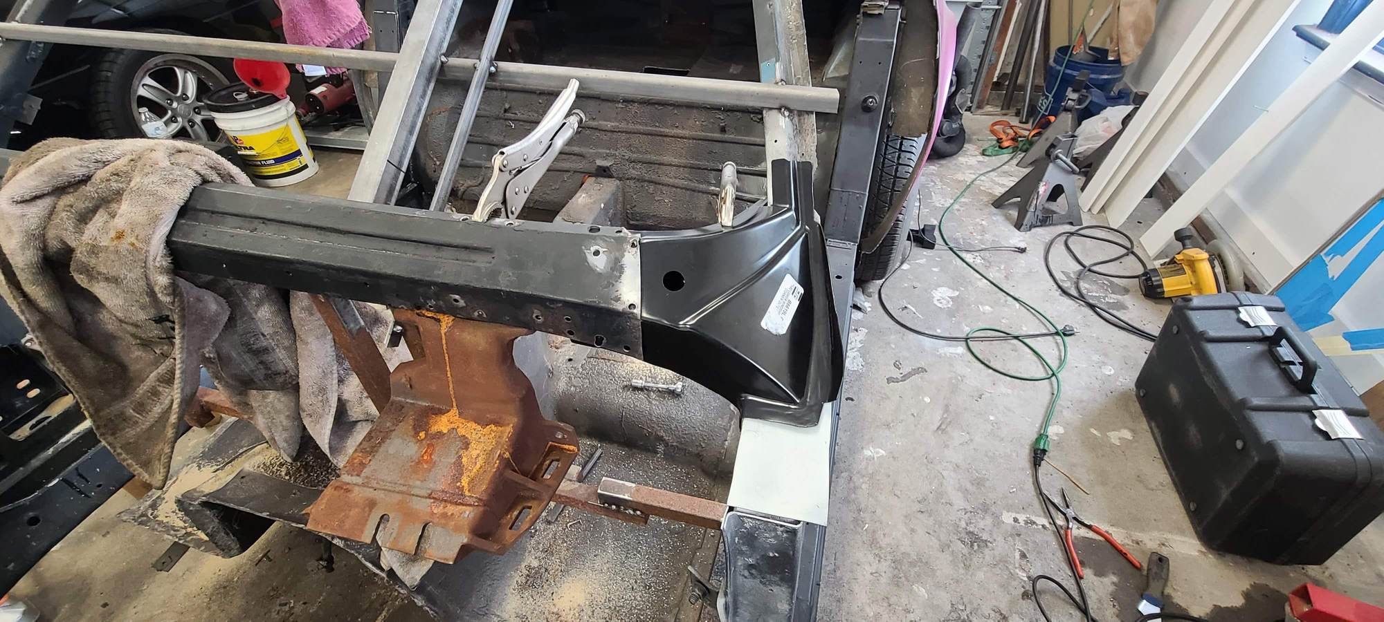

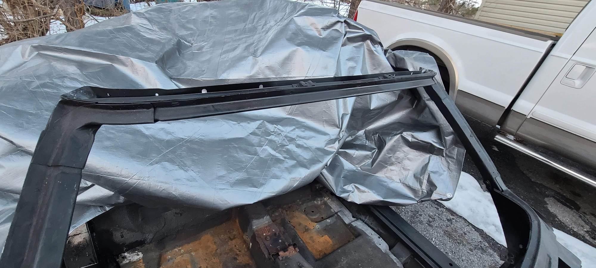

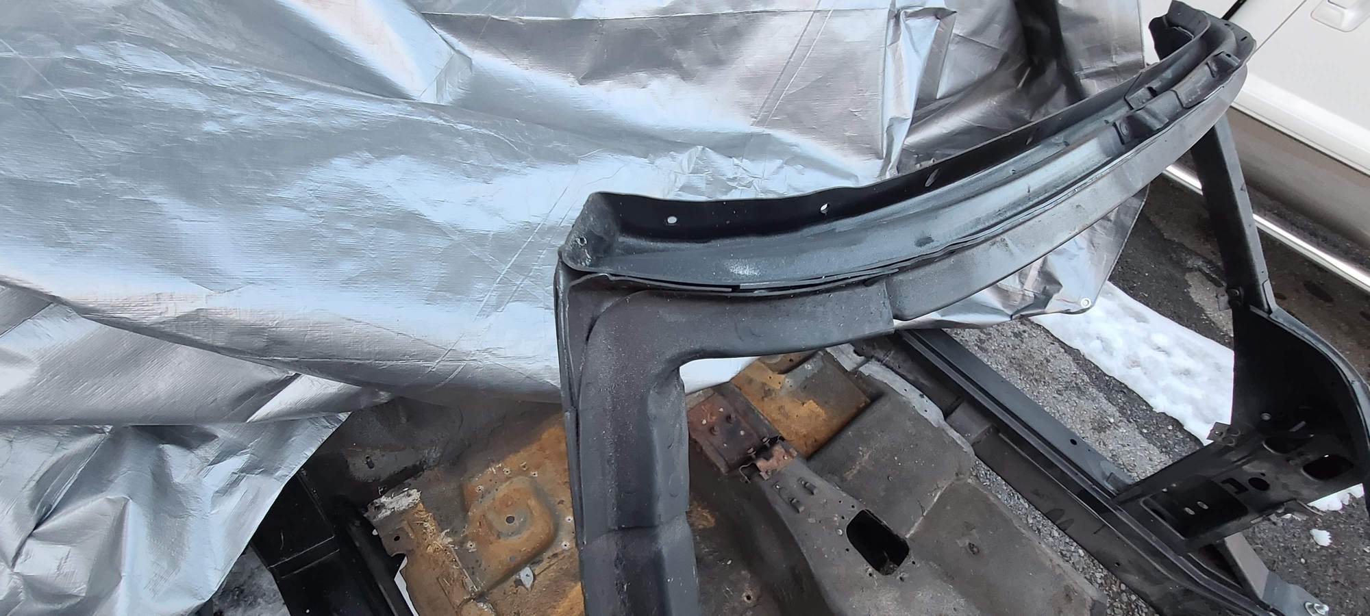

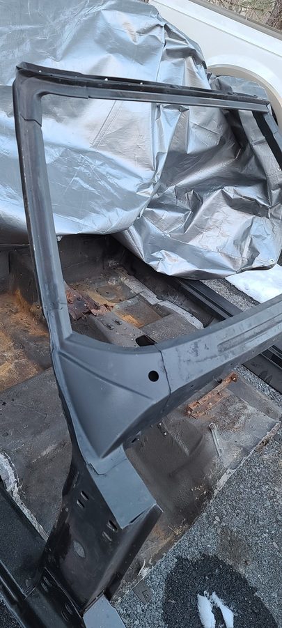

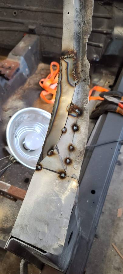

Another great weekend ! Top windshield bar and both corners replaced and the passenger side lower outer. I now have a rust free birdcage. From here its no linger birdcage work. Should I continue updating this thread with the rest of the restoration or should I start a new thread . what do you guys think ?

Looks really good. Yeah, keep us updated, as you progress with the resto. Hopefully, it will be a lot easier, in the future.
One suggestion.....you may want to treat the "inner areas" with some sort of rustproofing material, to preserve these places that won't get painted. I highly recommend a product called 'LPS 3"........

keep going..! nice pics..weld thru primer. etc..assume later will be prep and final paint in black?

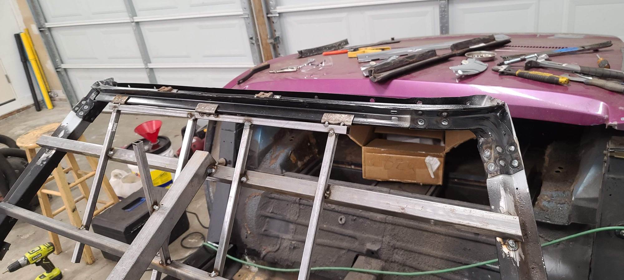

Ingenious solution making the jig, really well done!
I would keep this thread going as returning the fiberglass to the birdcage successfully is all part of this job and you should keep it all together.

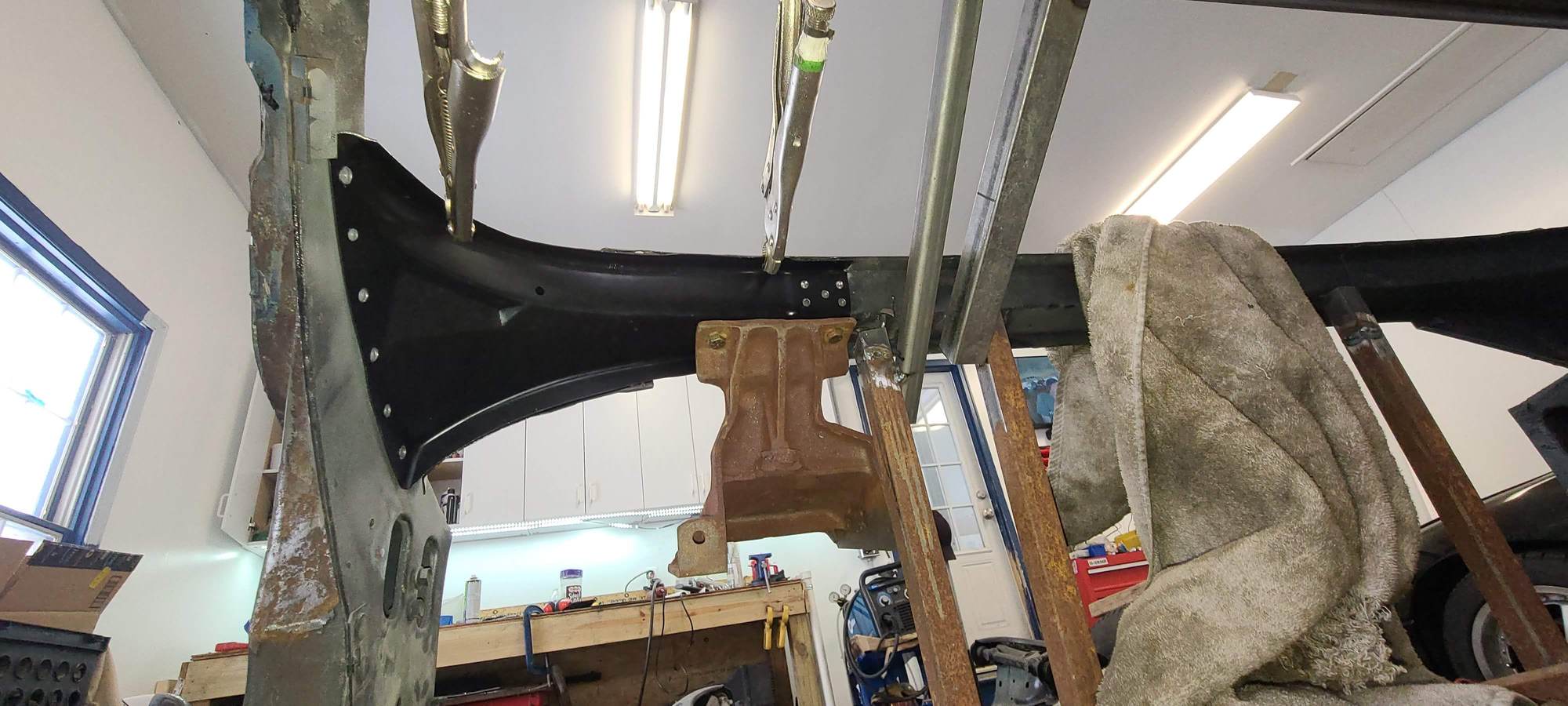

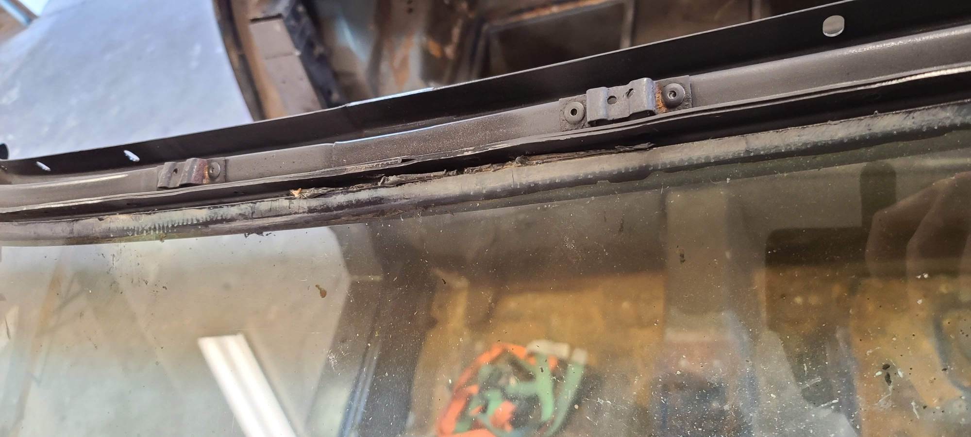

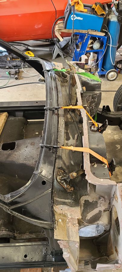

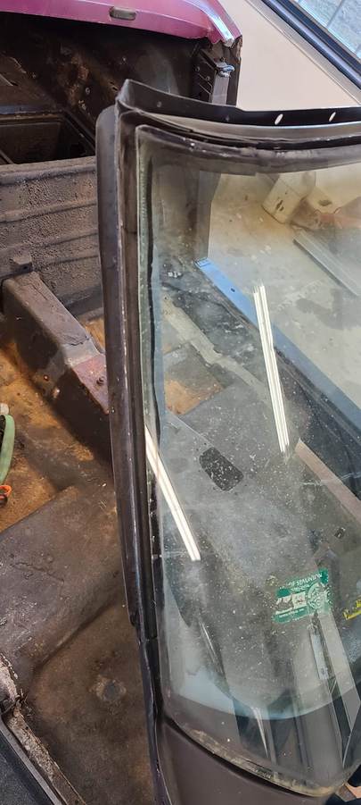

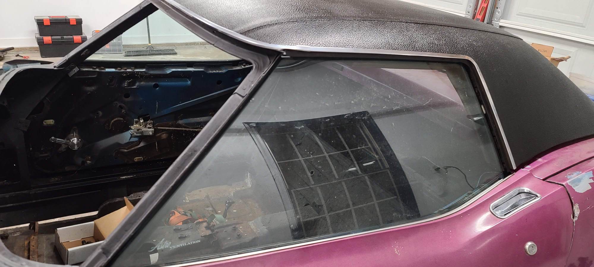

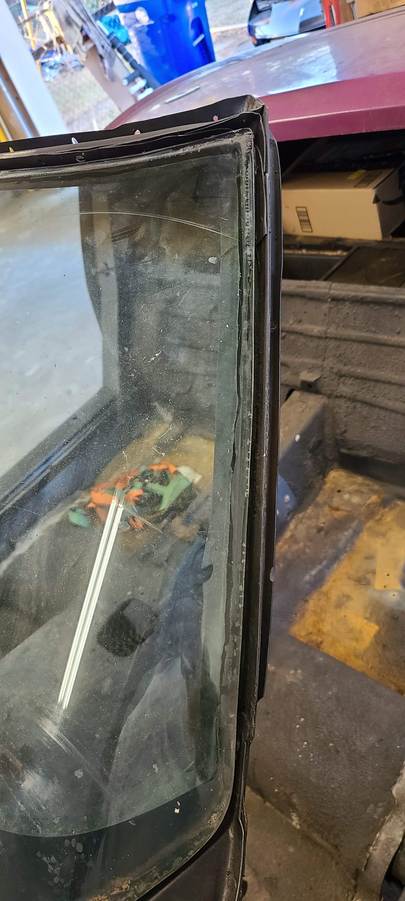

Last night we test fitted the glass, firewall, doors and hard top. It all looks to fit well.

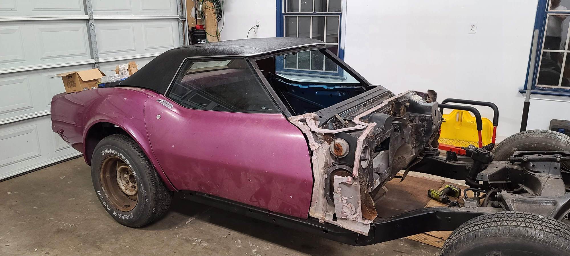

Old Apr 13, 2021 | 12:19 AM
  #55
ss400rscamaro's Avatar
ss400rscamaro
Joined: Aug 2016
Posts: 72
Likes: 100
From: Maryland

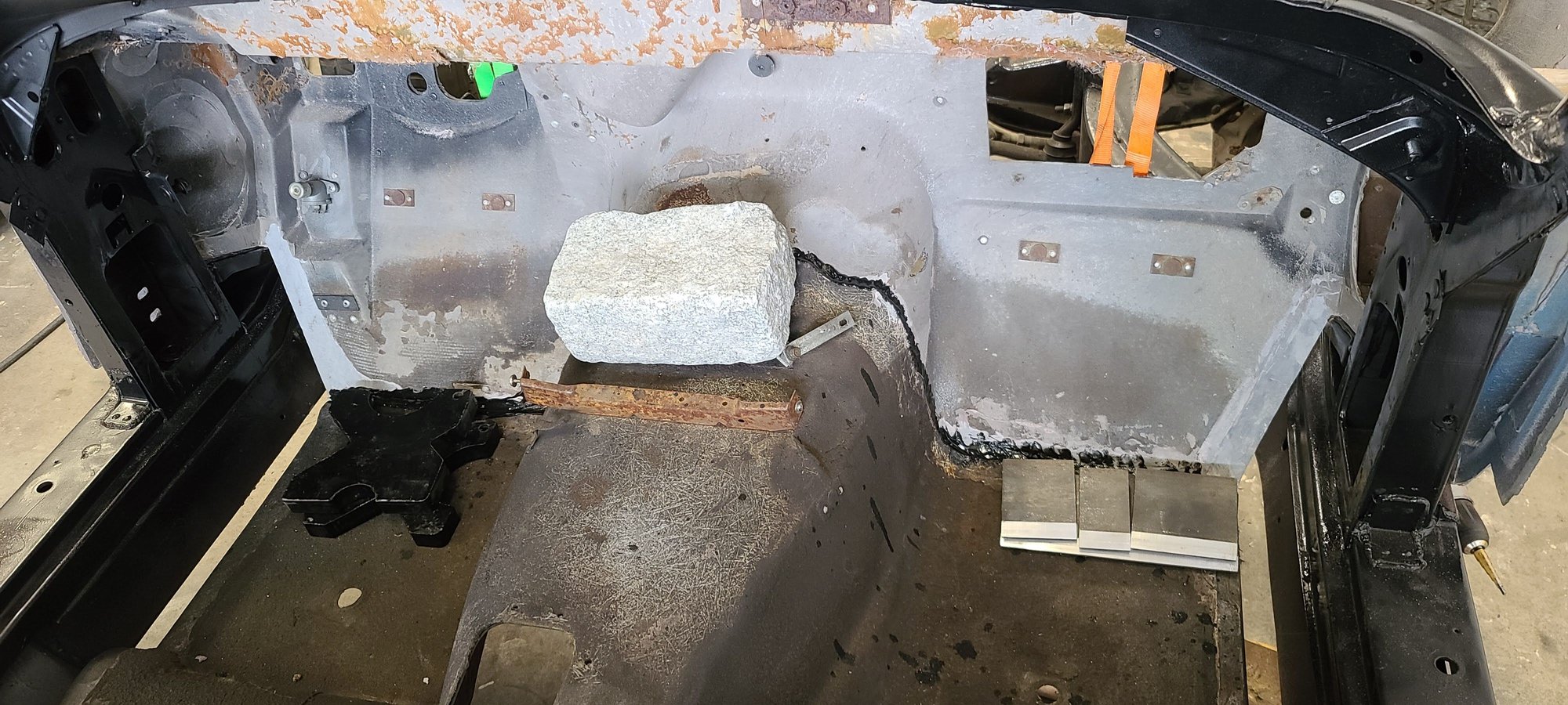

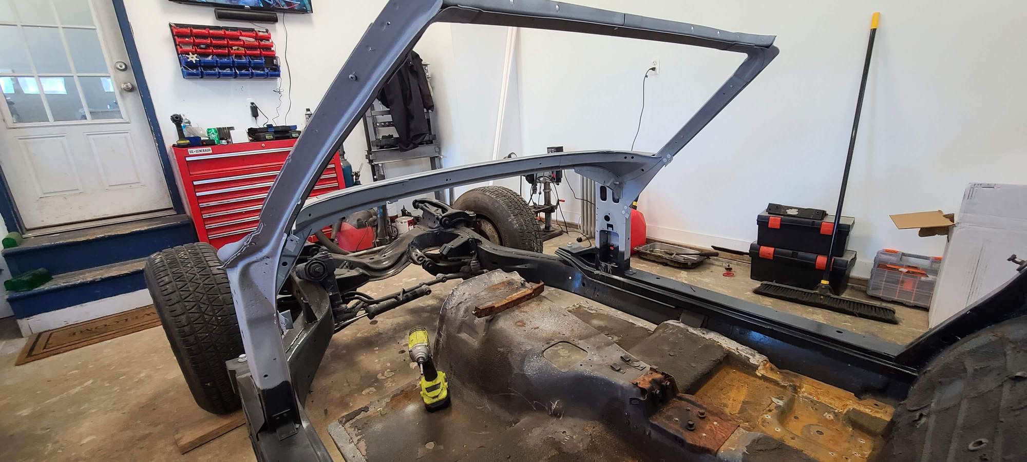

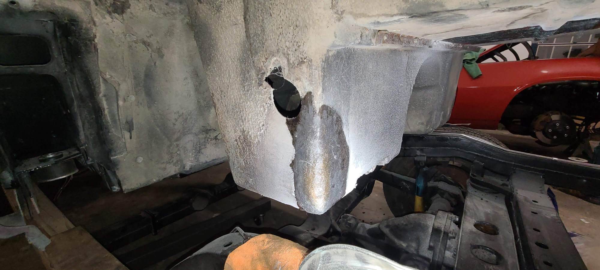

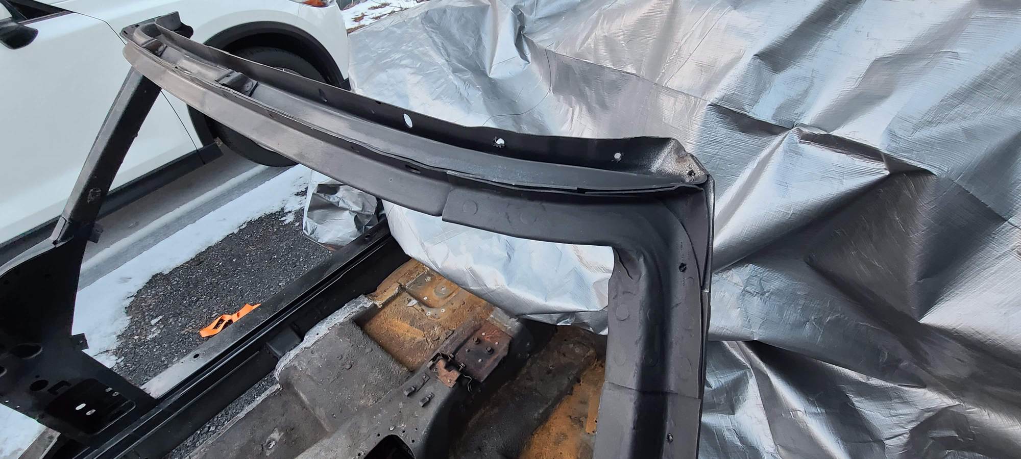

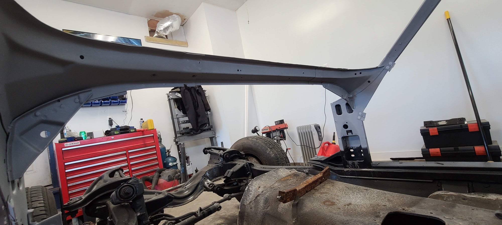

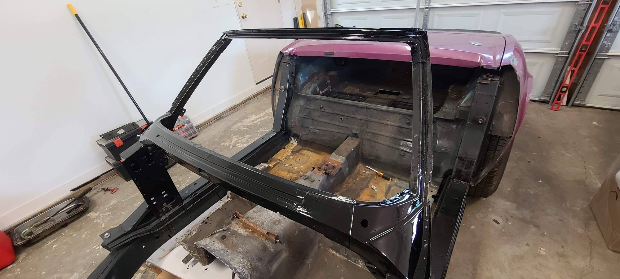

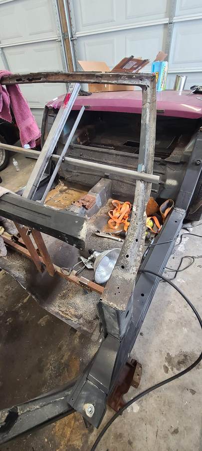

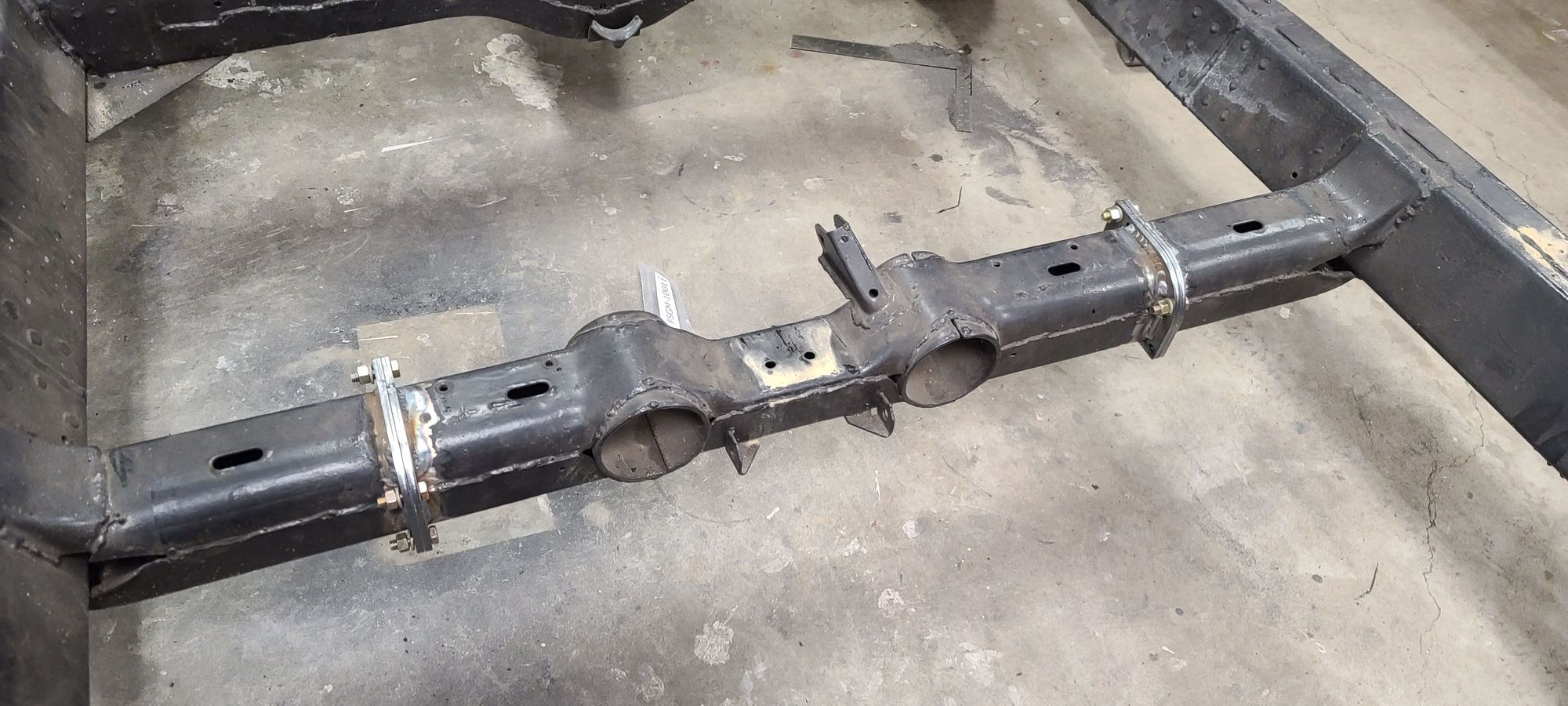

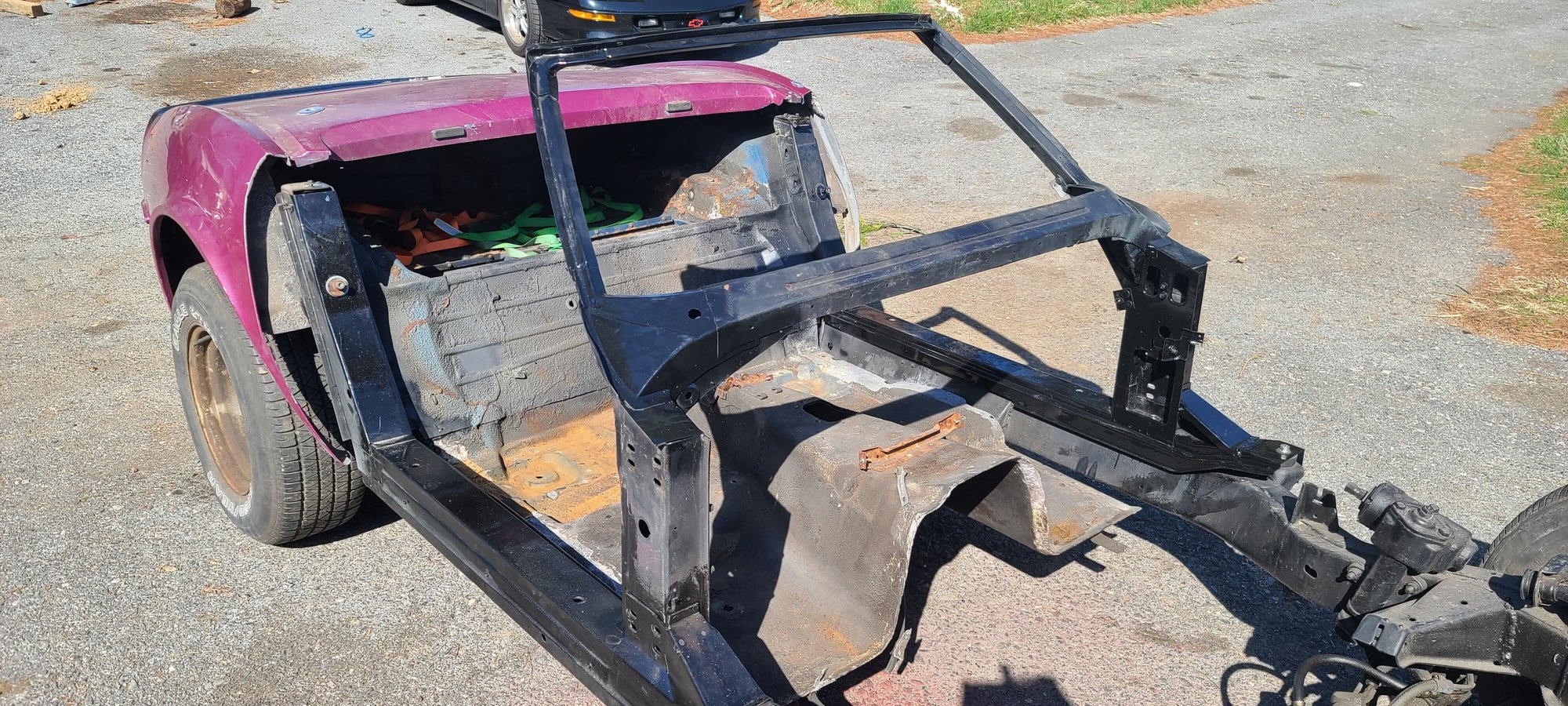

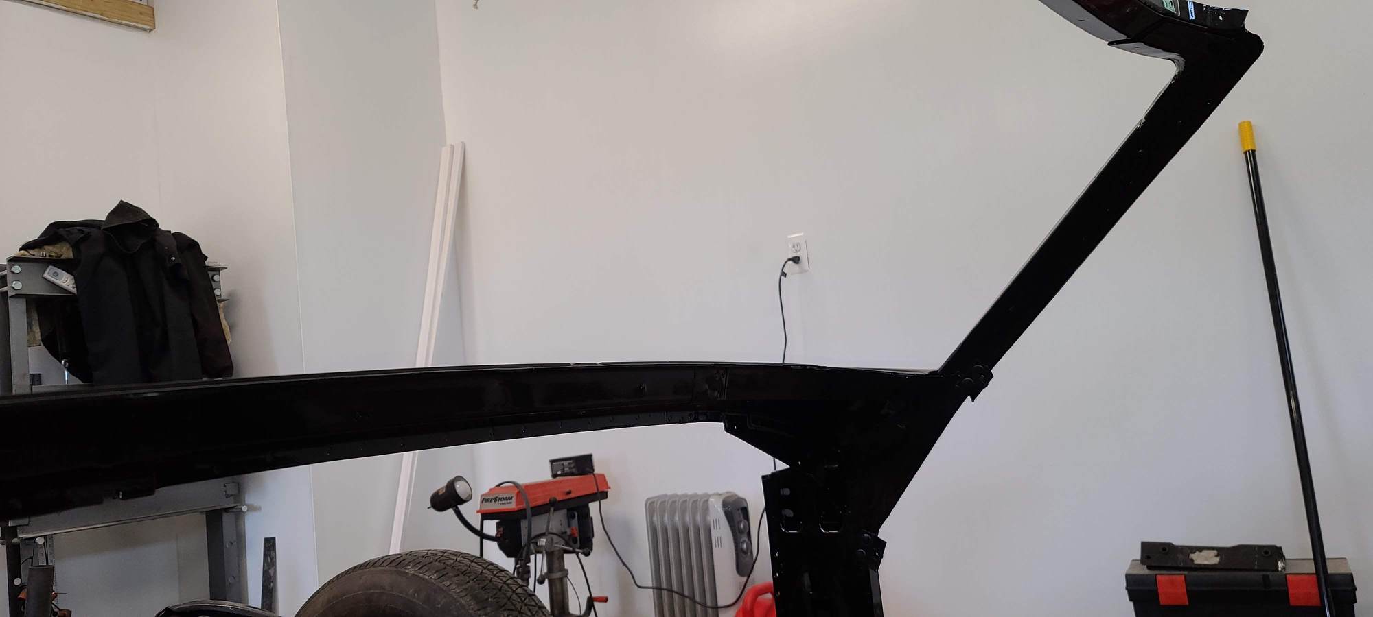

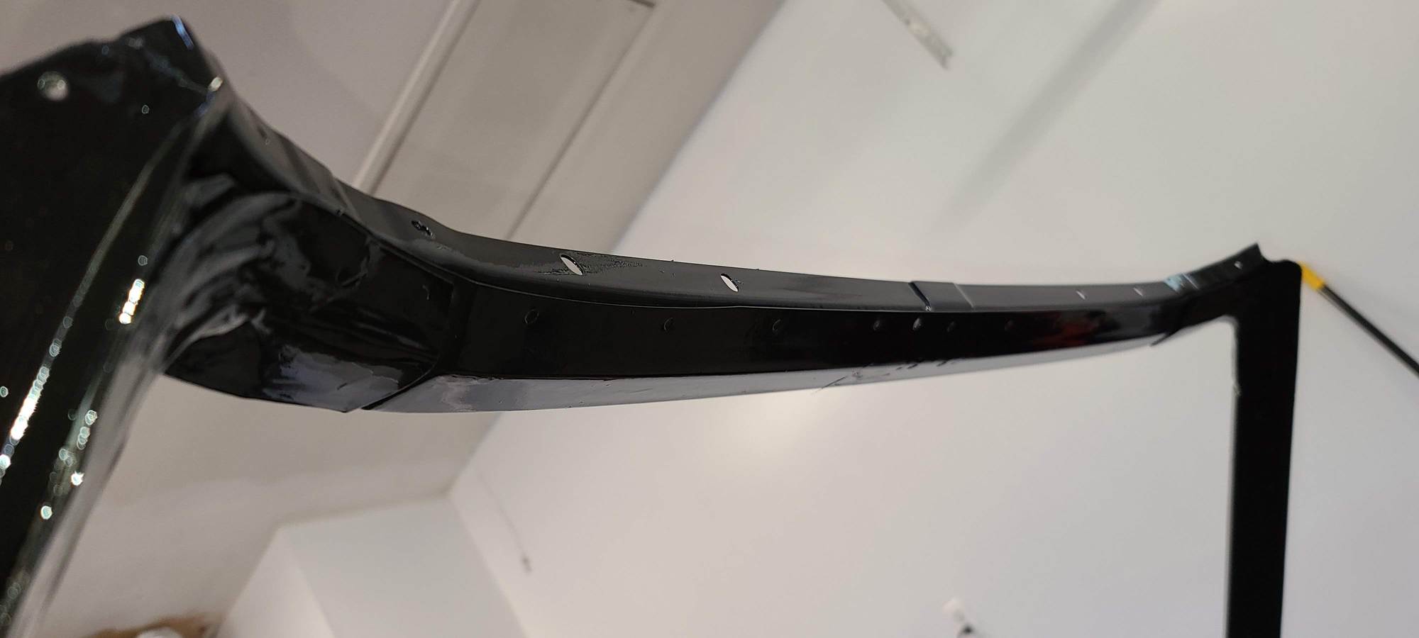

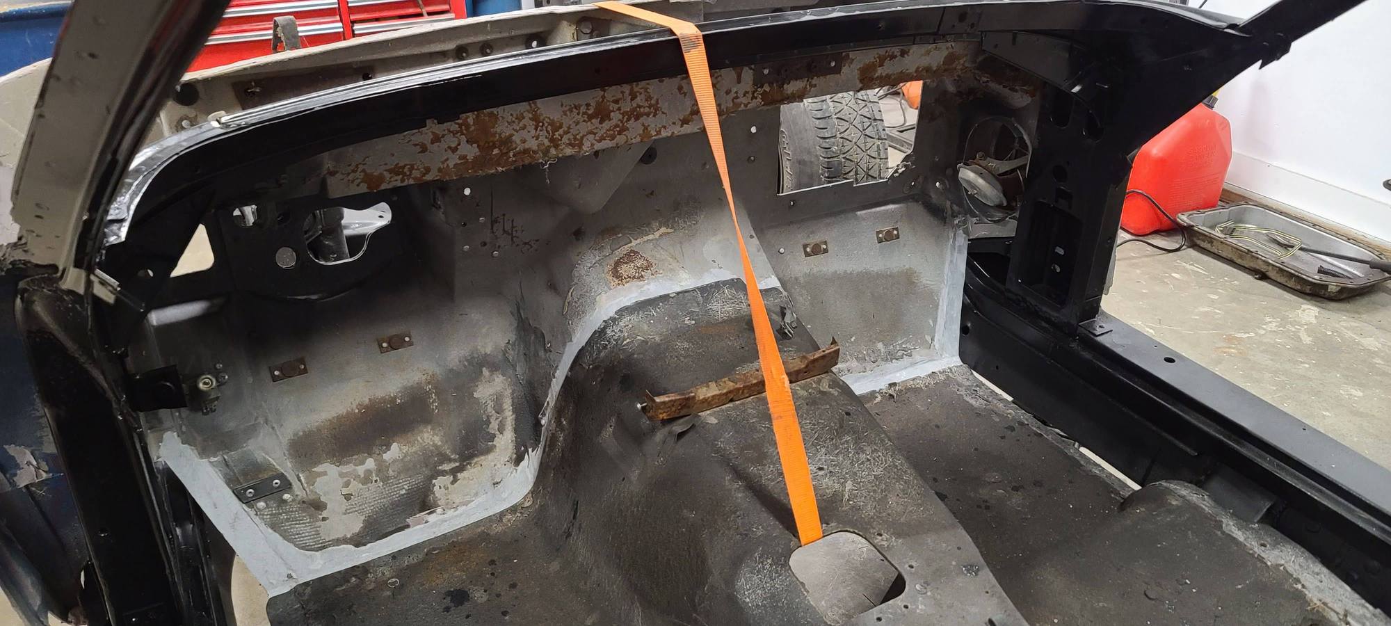

Its been a bit since ive posted. I've been doing more work. I decided to install the removable cross member kit from American Powertrain. I had the vette sand blasted and I decided to paint the the birdcage with por15 then top coat with epoxy paint for the UV protection. Then I prepped the firewall to go back on. I sanded all the old bonding adhesive off and test fitted everything. This past weekend we bonded the firewall back on.
before blasting
before blasting

You are doing such a phenomenal job that I almost hate to post this point.
POR15 stands for “paint over rust” it uses a suspended phosphoric acid solution that reacts with the oxygen (ferric oxide) bonded to the steel that is rust. It captures the oxygen atoms holding them inert and forms a hard coating that bonds to the rusted surfaces that is durable, but not UV stable. On non-rusted surfaces it is significantly inferior to a good epoxy primer. EP will bond to clean steel, POR15 will not. In fact, on non-rusted surfaces POR15 scratches easily and I’ve seen it come off in large flakes. I cannot understand this fascination people have with POR15 on non-rusted surfaces. If it were me, I would use a rust converting acid wash on the outside and coat it with EP, then use a product like Eastwood’s internal frame coat to coat as much of the inside of the birdcage as possible.
Anyway, your work is impressive and I admire the process and dedication to doing it right!
Old Apr 13, 2021 | 09:13 AM
  #57
ss400rscamaro
Joined: Aug 2016
Posts: 72
Likes: 100
From: Maryland
Oh Im well aware what POR is and have been using it with better results than anything else for a long time. The way I have been prepping metal has been giving me no issues with how POR adheres, It does NOT HAVE to be a rusted surface. Give POR an etched surface (sand basted) and it will grab no problem. Also the stuff is way more scratch/chip resistant than any paint or epoxy. And yes my birdcage and chassis is coated inside with Eastwood's internal frame coating.

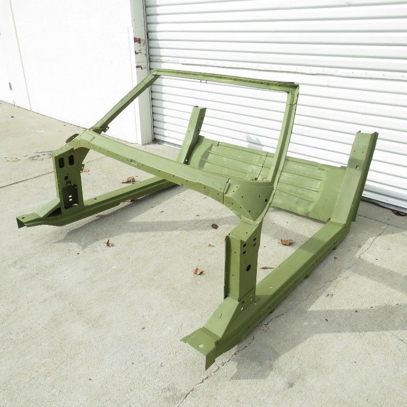

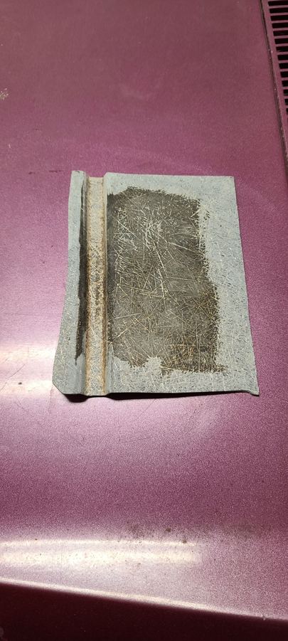

This was from an old thread about a guy who had a birdcage like yours and he just bought one of these instead or this was his final repair don't recall which.
That was the plan with the 68 birdcage i had bought but I had a couple conversations with people telling me that unless i can save my original birdcage I should give up on the car. So here we are.

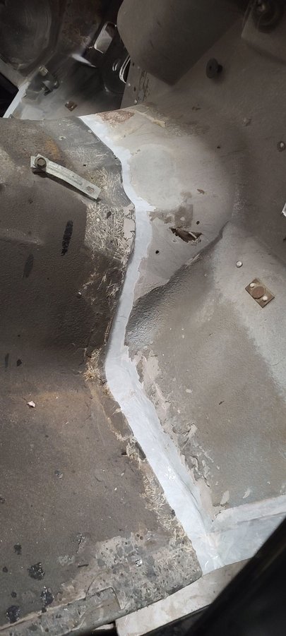

Old May 25, 2021 | 10:50 AM
  #60
ss400rscamaro
Joined: Aug 2016
Posts: 72
Likes: 100
From: Maryland

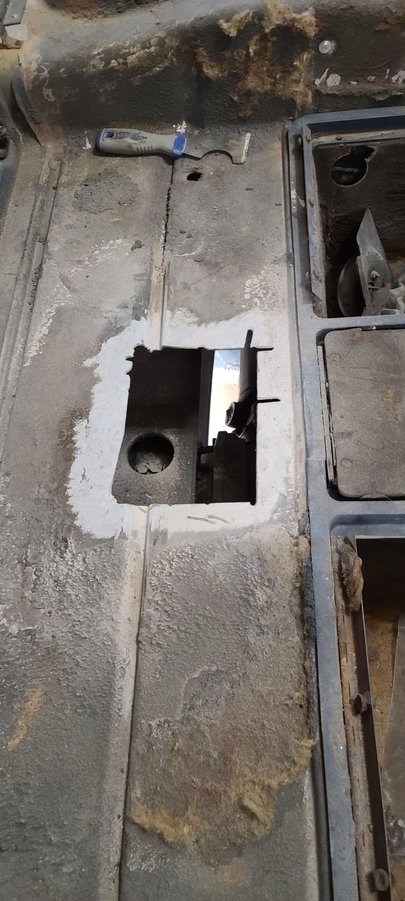

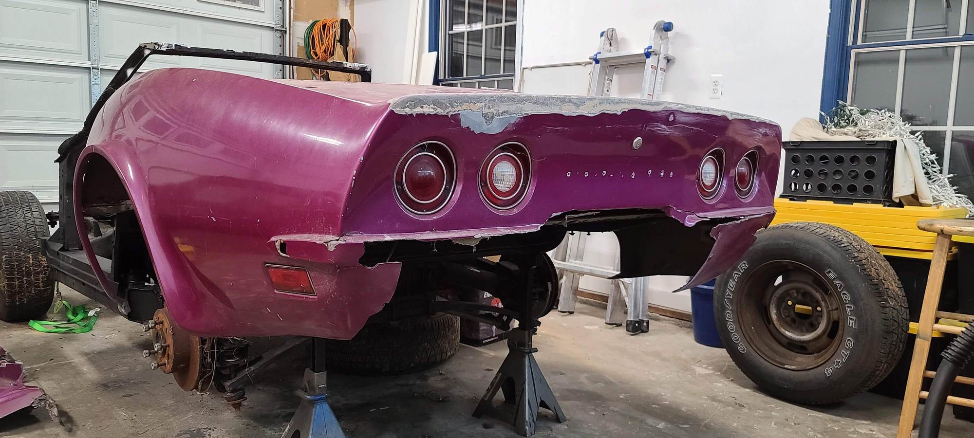

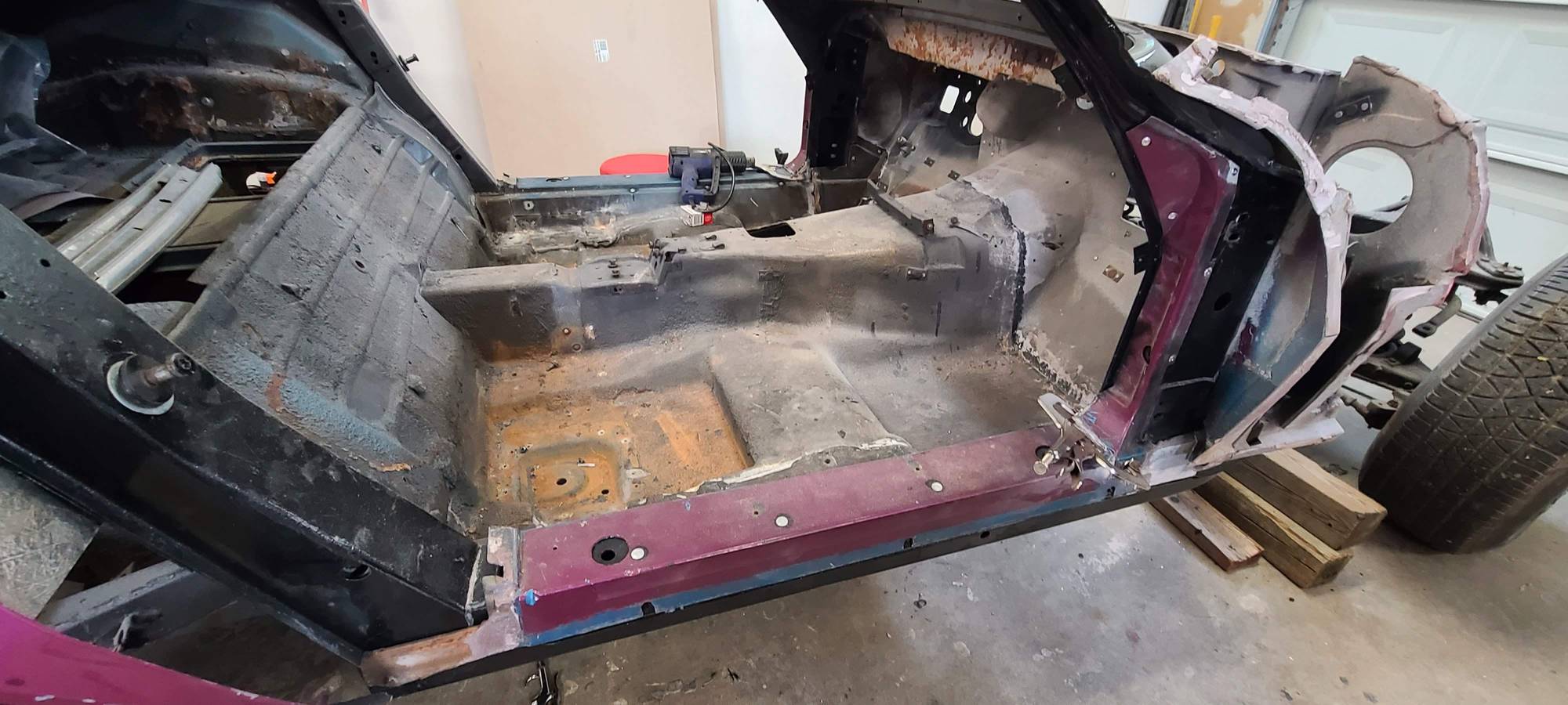

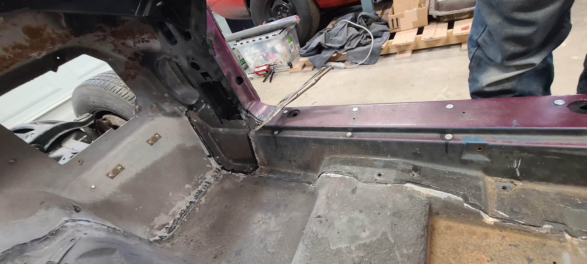

Its been awhile since ive posted. I have rebonded the whole floor back together and patched some other holes in the floor from previous owners. Ive also been getting the body / frame ready to be joined together for the last time. Then i'll start with some exterior fiberglass replacement like my tail light panel. I also cleaned and painted the firewall.
