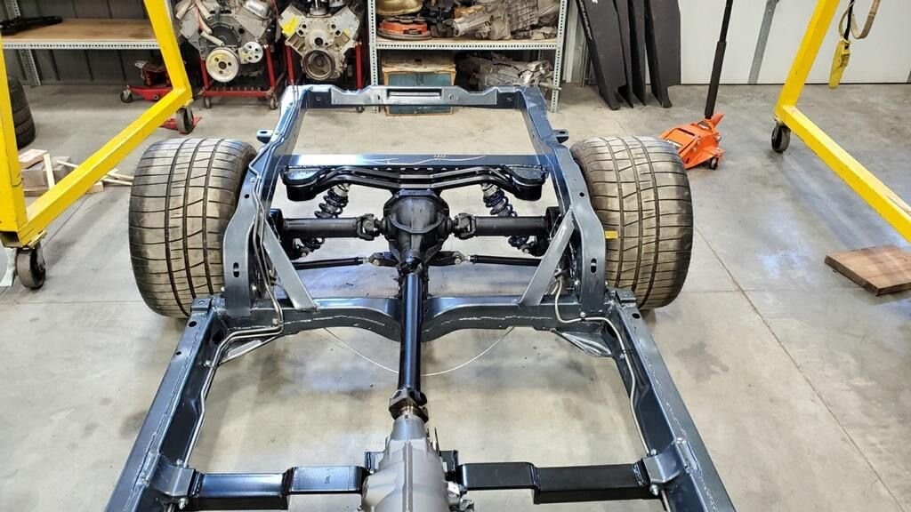

Progress continues on my car. The chassis cleaned up from above photo...
And more paint detail
The chassis and body are mated at this point.

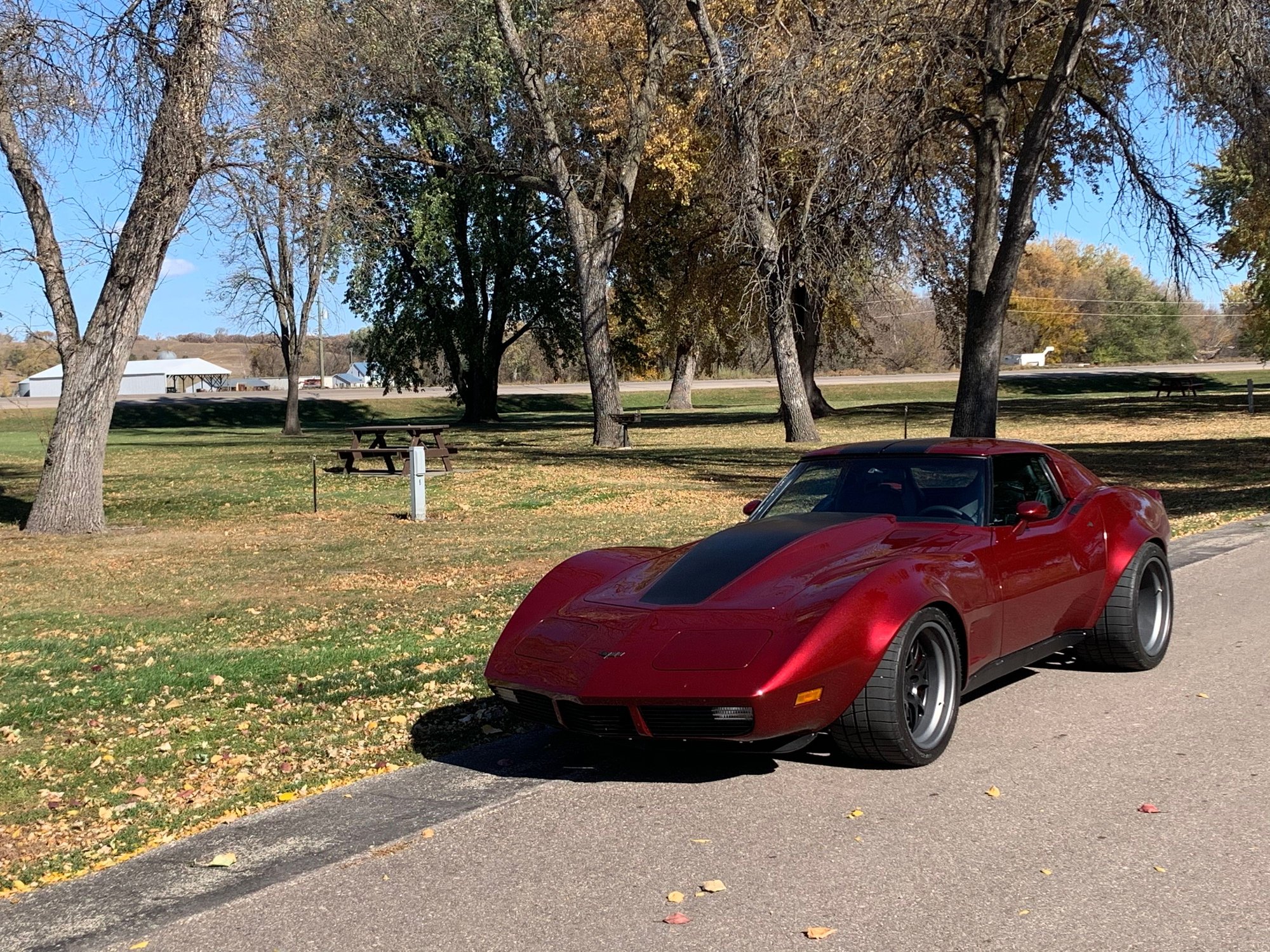

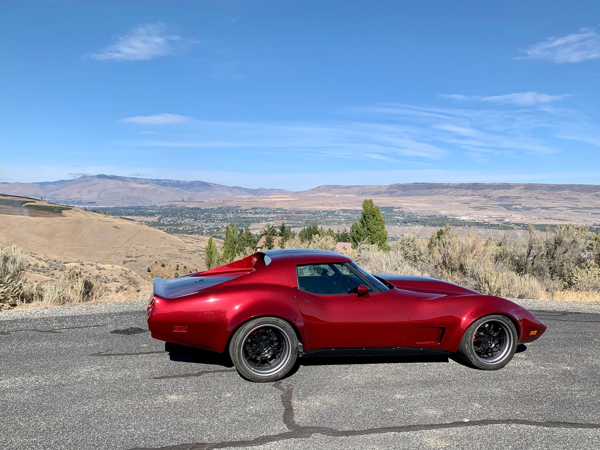

Two and a half short years later, I have my ultimate car!
Road race in theme, street in function.
Thank you Josh and co - a 2020 '77...

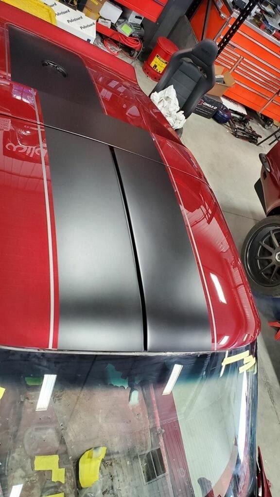

Oh, the hood. It is a one off hood. A Sunoco drag race hood sunken in & sectioned, all for the road race vibe. I just could not do another L-88 or raised Z-28 hood.
My whole theme was based off of one pic of one car...

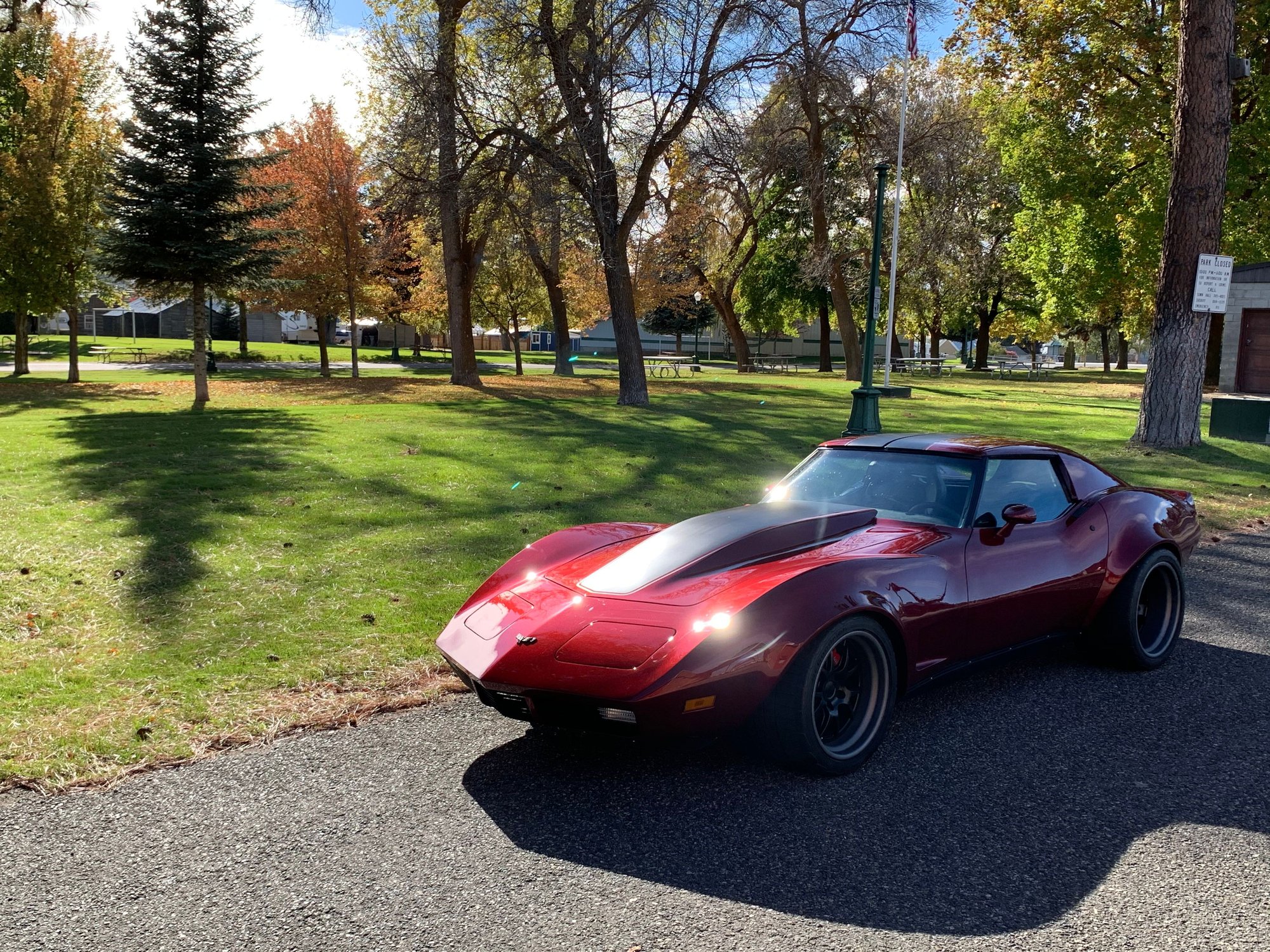

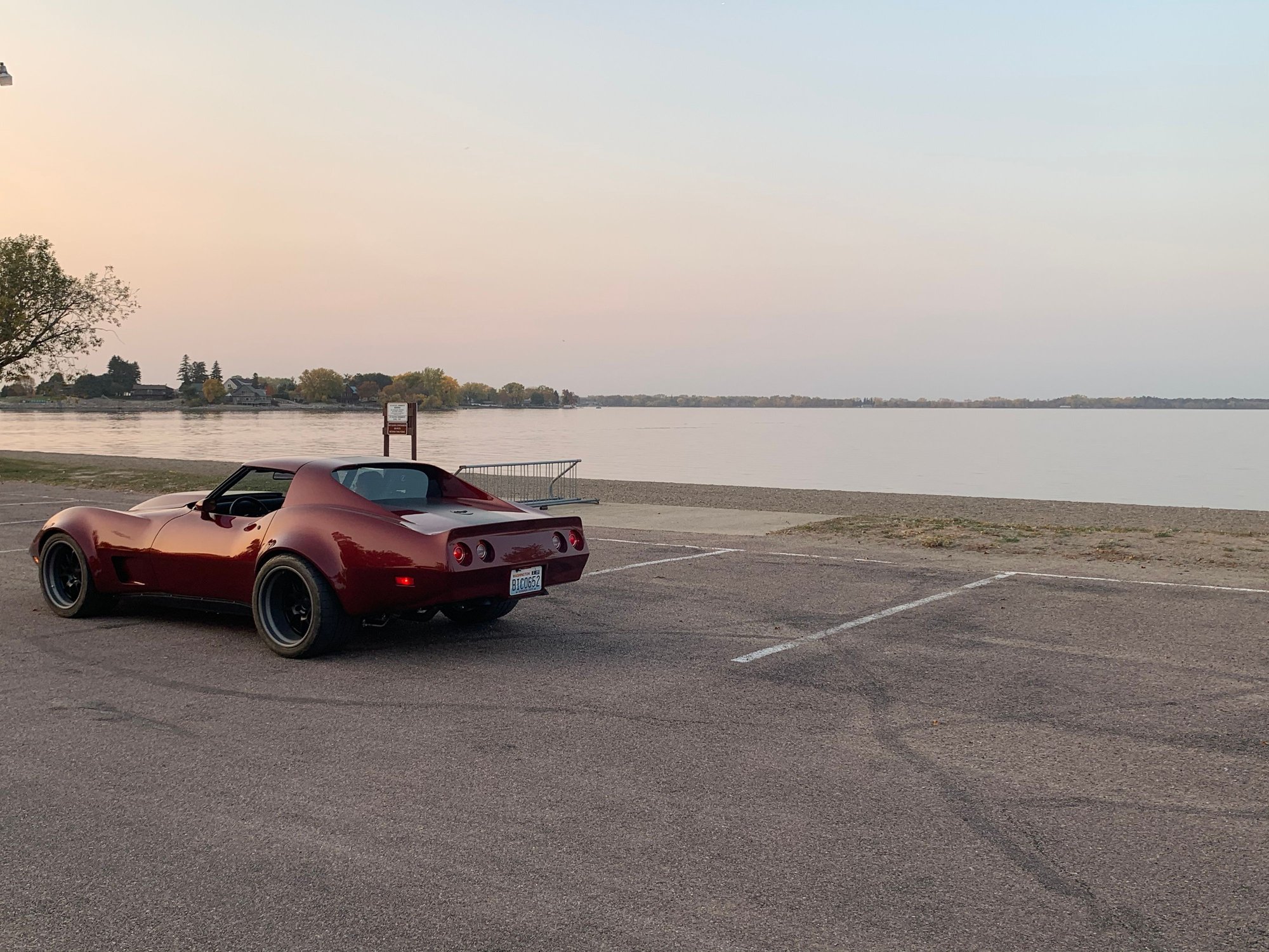

Well I will pedal my own car here... Thoughts on it. The paint is very satisfying, in the shadows it really changes.
The motor... As a dyno tuned engine, it still requires to retard the timing. It detonates on any fuel I have found (91, 92 and I will try a 100 octane mix in the days ahead). I will ease off the timing.
I have adjustability for when the fans kick in. Gonna pull that back to a lower temp also. Its been to 215 degrees so far, in cool weather.
The handling... The RideTech suspension & wide G Force tires are amazing. I have ripped some corners at an intensity I had no business doing. Turns like an angry ****. Just crazy. It deserves track days.
The sticky tires pick up every rock & pebble, making for a ride of throwing rocks. My rear fenders are suffering the effect quickly. Need to add some clear matt rock protection.
Vintage air... A great system with a thermostatically controlled temp. No issues there.
I have a pretty thumping sound system. Retrosound with 4 speakers, woofer & amp. Killer tunes. But with headers, x pipe and flow masters, exhaust sound wins. I am too old to crank tunes over a loud car. But the loud car is good. Vey performance sounding and yes I have to drive around minor drone.
So, in my case the car needs fine tuning. Retard the timing, turn on the fans earlier and quell the rattle in the console. I consider it a performance car not a luxury car. Performance 1977 never had.
Its quite the car CIC put together... my cup is 90% full... complete outrageousness!

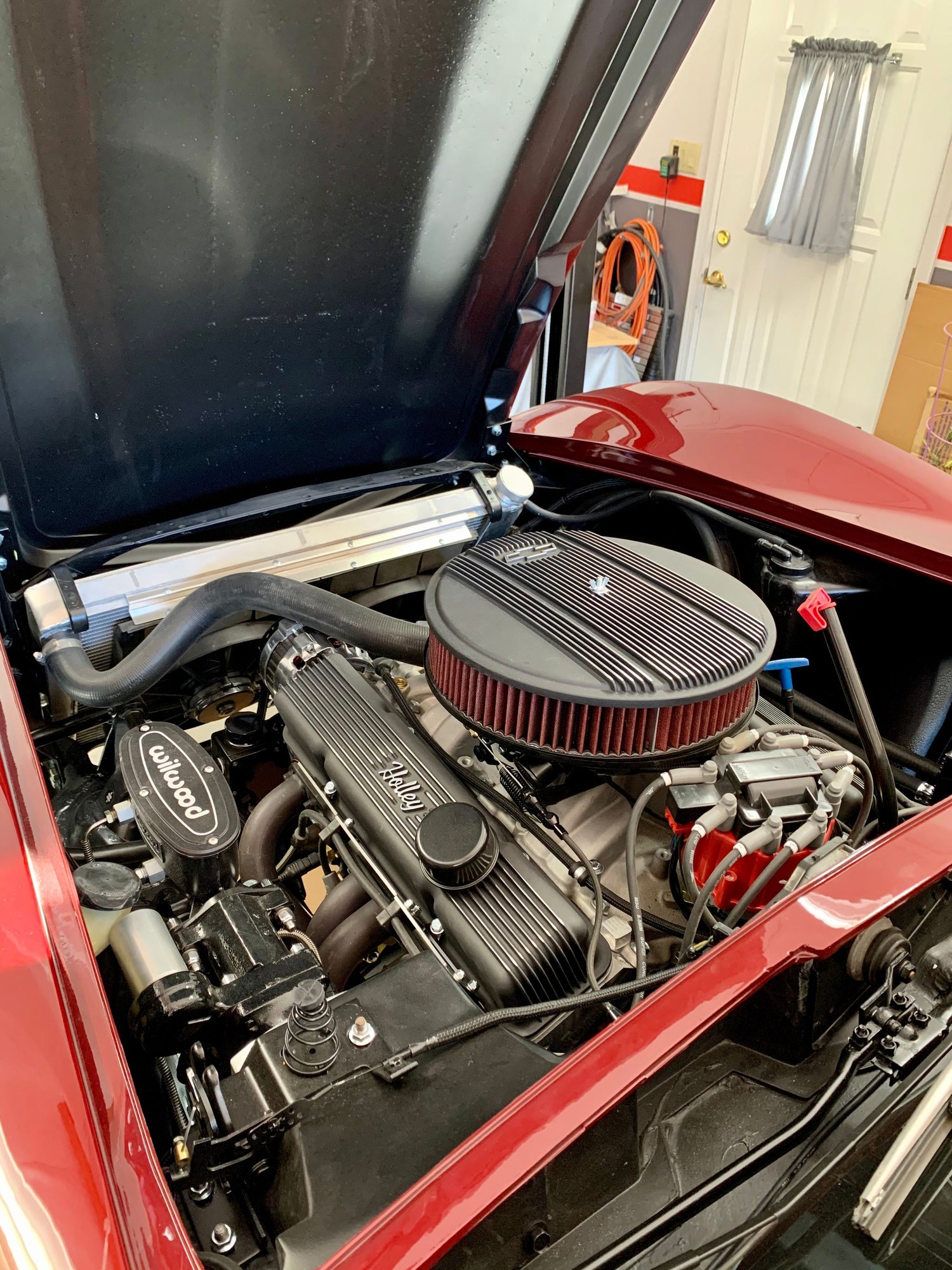

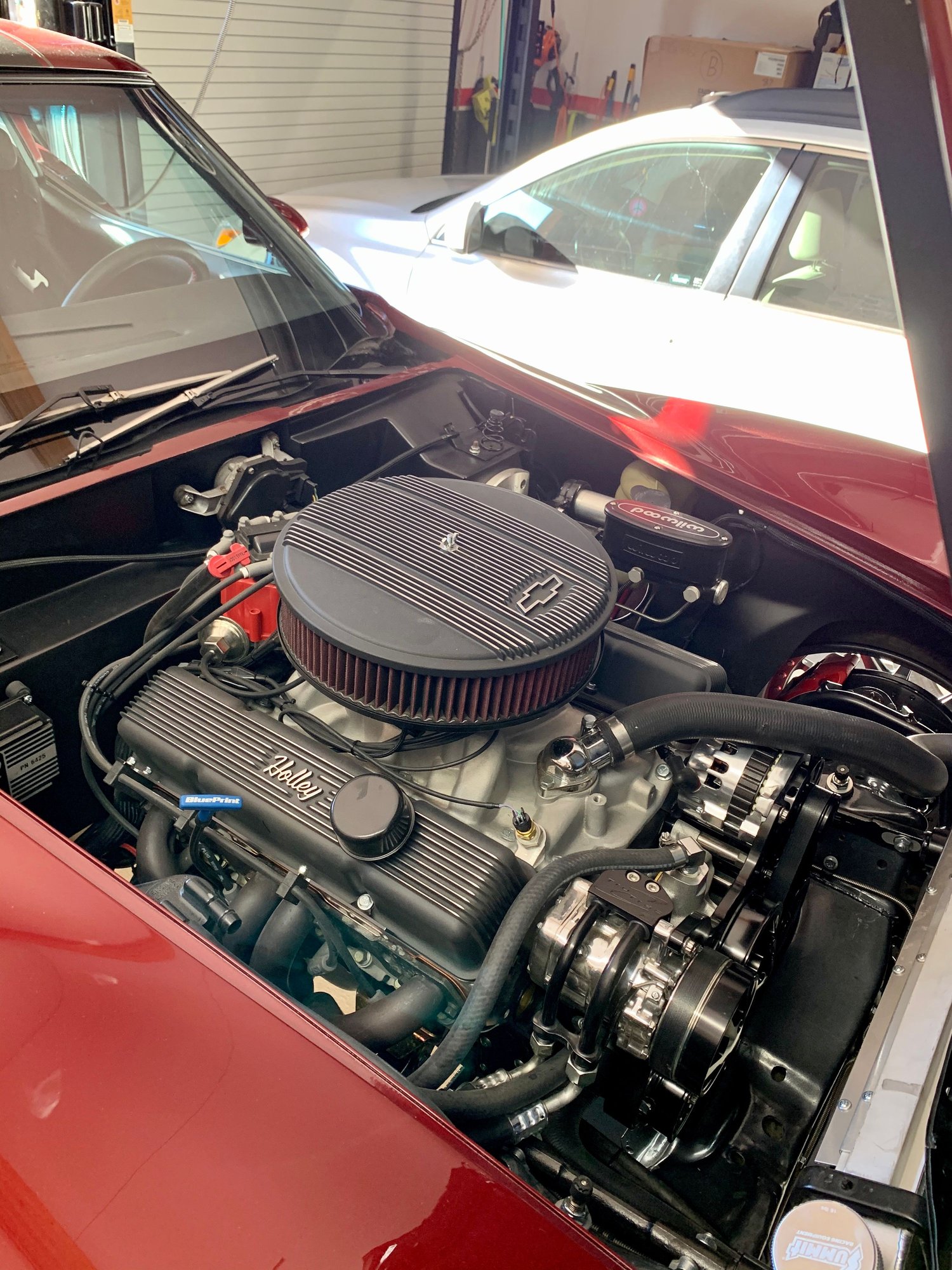

Time for some motor compartment pics.
I wanted my motor compartment to be subdued & understated. Which means very little chrome or polished aluminum. All business in a race car kind of way. But a street car.
I suppose finned black valve covers & air filter are their own bling, but overall low key. All the goods are there but not huge standouts.
Billet Specialties serpentine belt system, Vintage Air, MSD & Sniper FI. Sniper control box and a CompuShift trans controller. Borgeson steering, Hydro-Boost booster, Wilwood master cylinder & brakes. Trans cooler, aluminum radiator & twin fans. All operating pretty well together.
