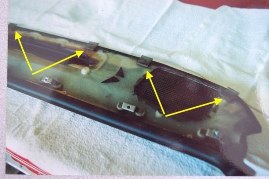

Hi EM,
"I'm hoping for somebody with a 69+ car to pop up and show me what the underside of theirs looks like. "
Later cars (71) have a single small bracket that bolts to the cowl and the upper pad near the center of the pad.
Regards,
Alan
The under side of the upper dash pad. Note the clips that attach to the flange on the windshield frame and the u-nuts for the screws in the lower dash pads' upper edges. This is an original dash pad.

E.Murray.
You can take out that beam. It is NOT a structural part of any major significance. It is just to weak to provide any type of resistance IF the two hinge posts were thinking of collapsing in towards each other. To prove my point..you can easily pull down on it and watch it flex. And YES...it is to support the top dash pad made for that year model
The curved stamped steel lower windshield frame area has all that covered....because...none of this is used on Corvettes a few years later.
DUB
