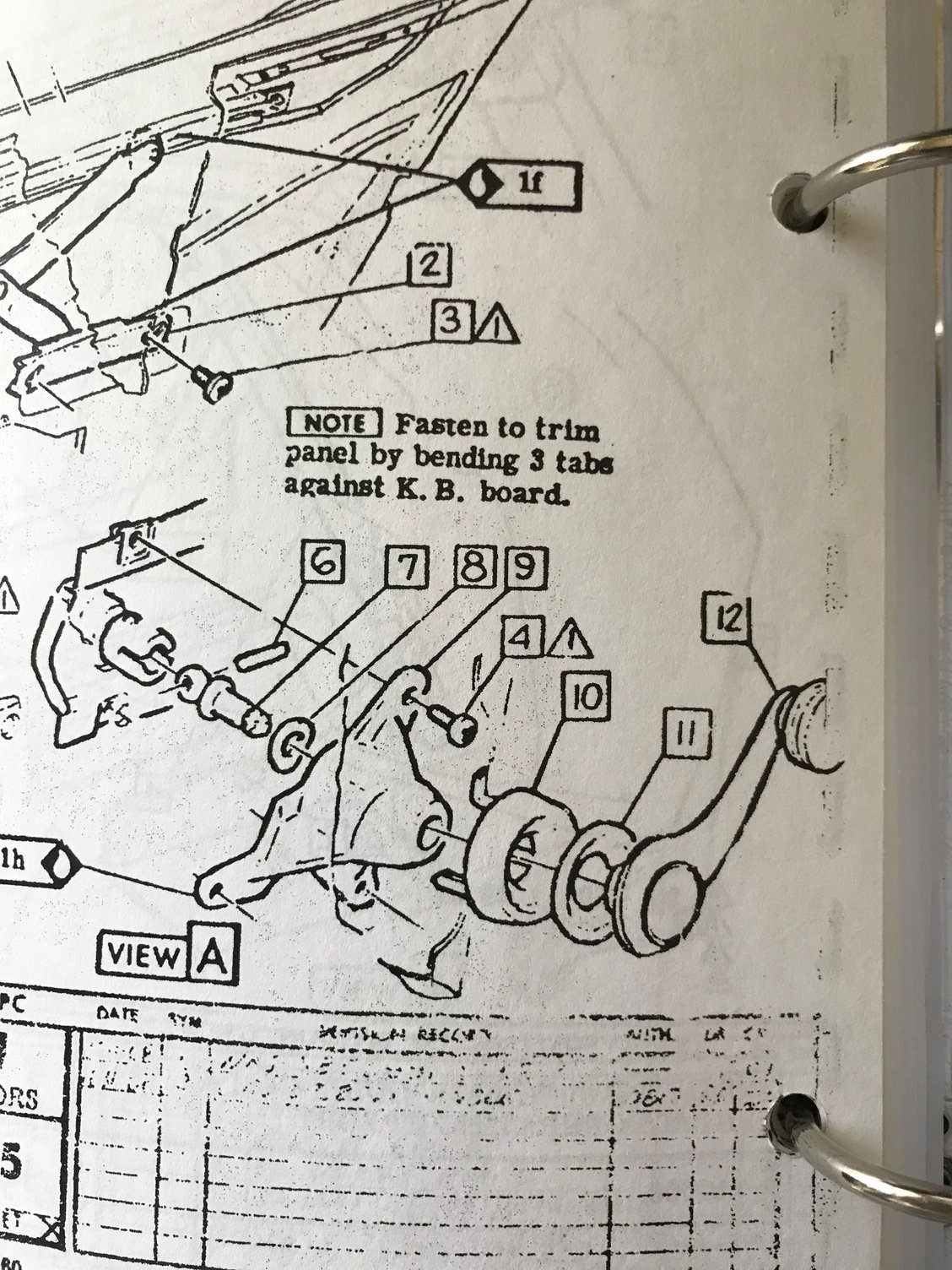

I can’t figure out what’s holding this on. I don’t see a clip to grab like the lock ****

Hi H69,
A small wire clip is slipped on the window winders and lock *****.
When the winder is pushed into place the clip locks it on the stud.
There's a special tool for removing the clips or you can use a loop of gentle floss to grab the clip and pull it off.
It's very easy to do AFTER you've done it once.
Regards,
Alan
It's being pushed in place in this photo in the direction indicated.

OK, that is what I pulled off the lock ****. I would double check the window handle. It definitely seems like its held on by something!

Yep same as the lock **** , when its time to put the handle back on , put the clip on first then push it onto the shaft until the clip locks on
