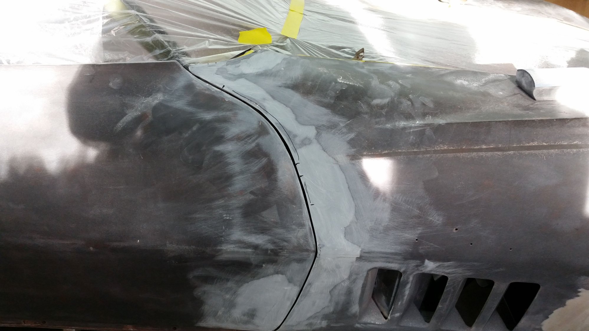

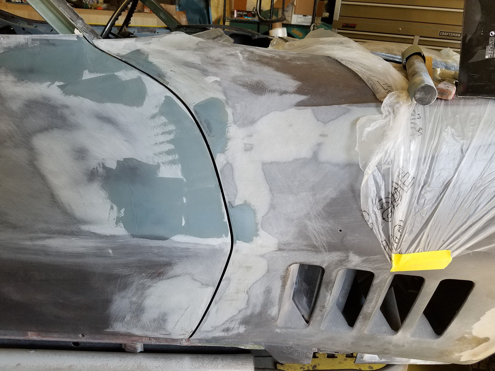

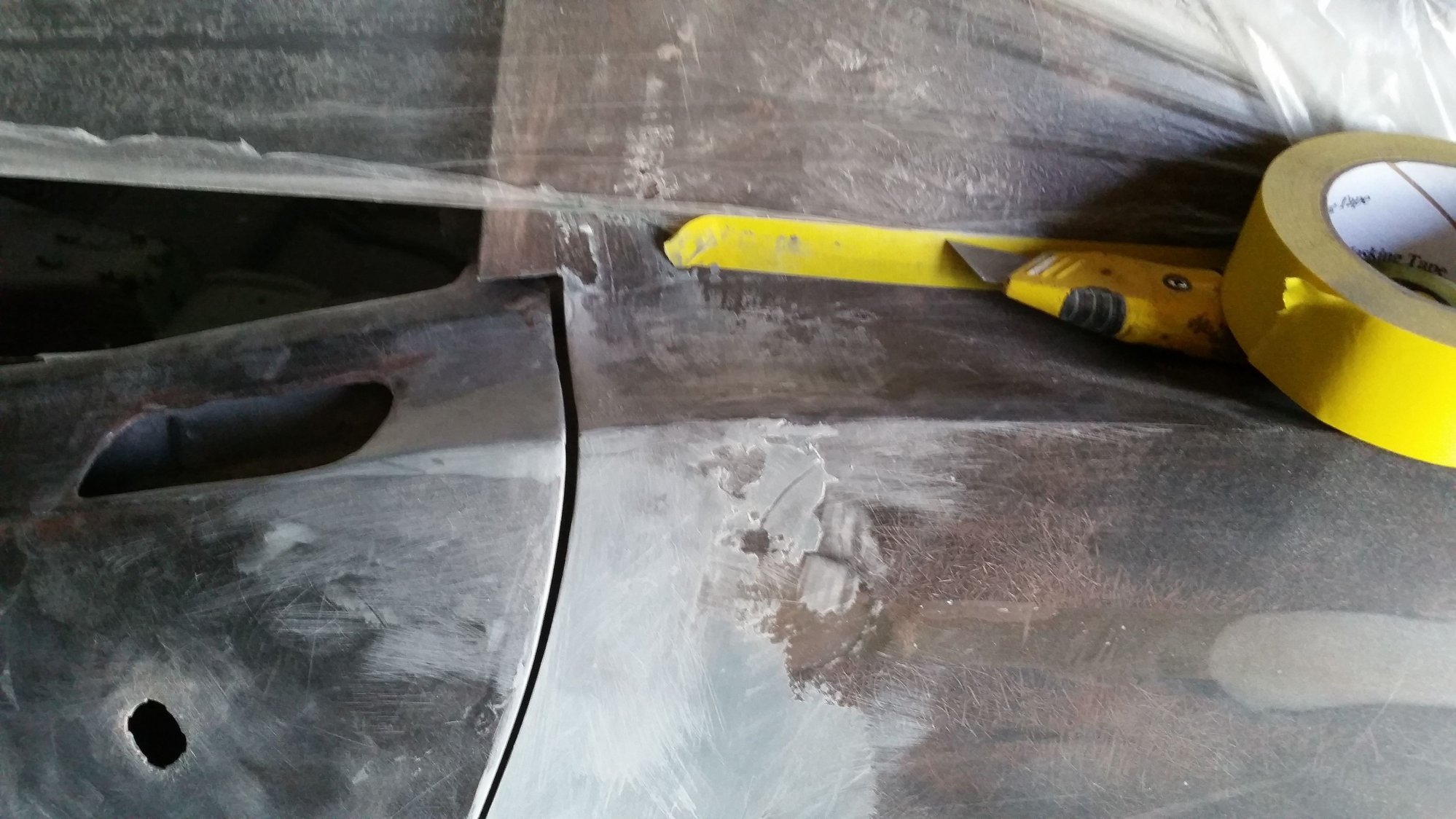

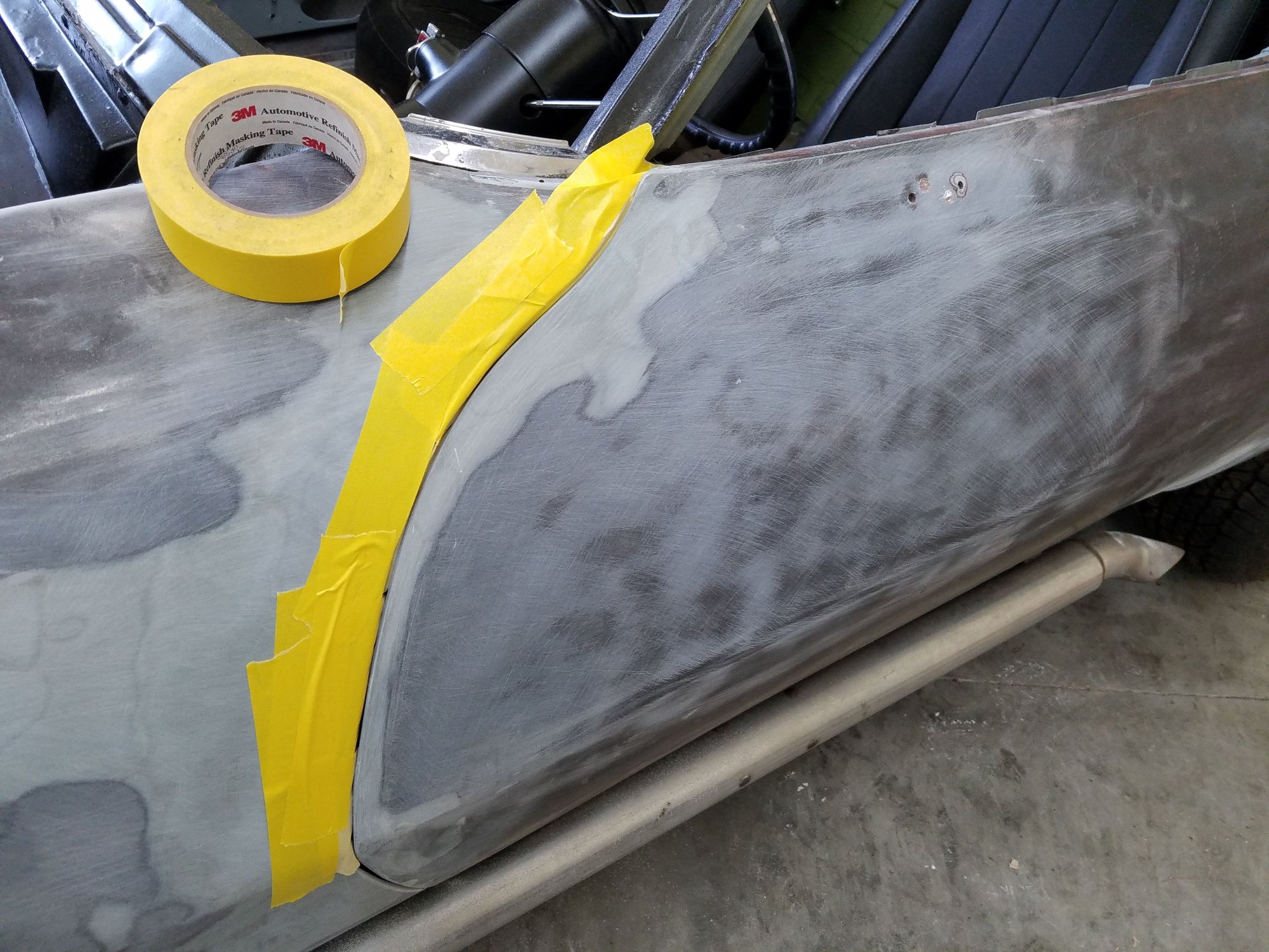

Below are a variety of pictures showing the door gap issues I had on my 69 build. Talking with Dub I learned how to back tape so the product would not fall into the gap while applying. The VPA is an excellent product for these repairs however there is a learning curve on how to mix based on temperature when to sand it etc. As Dub mentioned without seeing the problem it's hard to discuss a fix. Hope these help.
RVZIO
What is the limit for how large of a gap that can be closed with VPA without some glass/resin reinforcement? If you're building out the edge of a door with just VPA doesn't it become too weak at some point?

For what this is worth...and do as you wish.
Unless a person has used VPA...and KNOWS what its capabilities are. It might be wise to either...NOT comment on how they thinks it works...but rather....test it and find out for yourself.
I would not have any problem building out 1/4" to close in a gap...BUT...there is process to do that which is not that hard but does take some grinding and other steps to provide the VPA more of a surface to grab to. IF needed...I can explain to those who choose to PM me on it.
Also...for those who read cans and read that EVERCOAT states that VPA is not for structural repairs. I would bet about that all of those people did not call EVERCOAT to find out what that statement means. I did becasue that statement was not on the can when I started to use it. That statement was put on the can...because there are idiots out there that tried to bond fiberglass ground effect kits to the steel of a car. And it failed. SO...EVERCOAT had to put that in there for those who try to re-invent the wheel. By them putting that statement on the can...it releases them from the idiots in the world that will try to get them to cover damages.
It CAN be used for structural...but a person has to have a clue on how to use it. If anyone doubts me...call EVERCOAT and get a hold of tech rep...they WILL confirm it. I use it to bond on top hood surrounds, fenders, quarters and any part that is fiberglass and NON-SMC
If a person choose to apply mat and resin...have at it.
And YES...applying the VPA to the body panel and NOT the door is advised IF the closing of gaps is being performed......UNLESS....the person notices that previous bodymen have sanded away a lot of the outer skin of the door and some will need to be built out there. I have seen this in a few instances where when I look a the door gap...I can actually see the steel inner structure of the door showing.
YES...VPA can be used on the door like what 'rvzio's' photos show. Knowing what you are doing with it is helpful and in some minor scenarios...that VPA can be used to build out the gap on the door.
And for the record...when I typed out 'idiots'. That was NOT directed to ANYONE here on the forum. It was directed to those idiots that did what they did. SO....do not take offense ..because I was NOT directing it at anyone here.

Look at POST#3 in this thread. And the third photo. Roger posted a photo of the gallon can.
VPA= Vette Panel Adhesive from EVERCOAT.
And yes....in my opinion....there is nothing like VPA on the market. There are many products that I feel try to be like it but they all seem to coem up a bit short in that regard.
