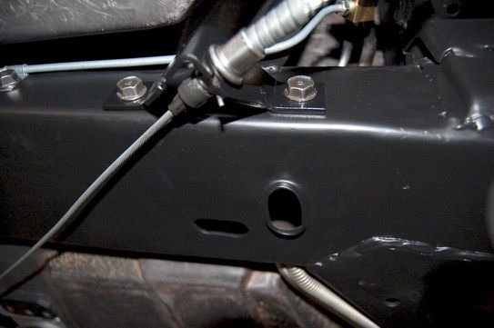

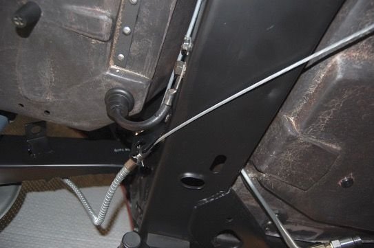

Hi DPC,
Welcome!
A NEW old Corvette for you!!
You must be pretty excited!!!
Here are the 2 slots on the crossmember that is just forward of the differential.
Good luck getting it home and I hope it gives you lots of pleasure.
Regards,
Alan
Right Side
Left Side
Old Apr 3, 2018 | 10:42 AM

Hi DPC,
"are these the rear ones?"
"Here are the 2 slots on the crossmember that is just forward of the differential."
The forward pair are on the side of the frame between the upper and lower a-arms.
Regards,
Alan
You can see the slight distortion from when the car was tightened down for shipping.
