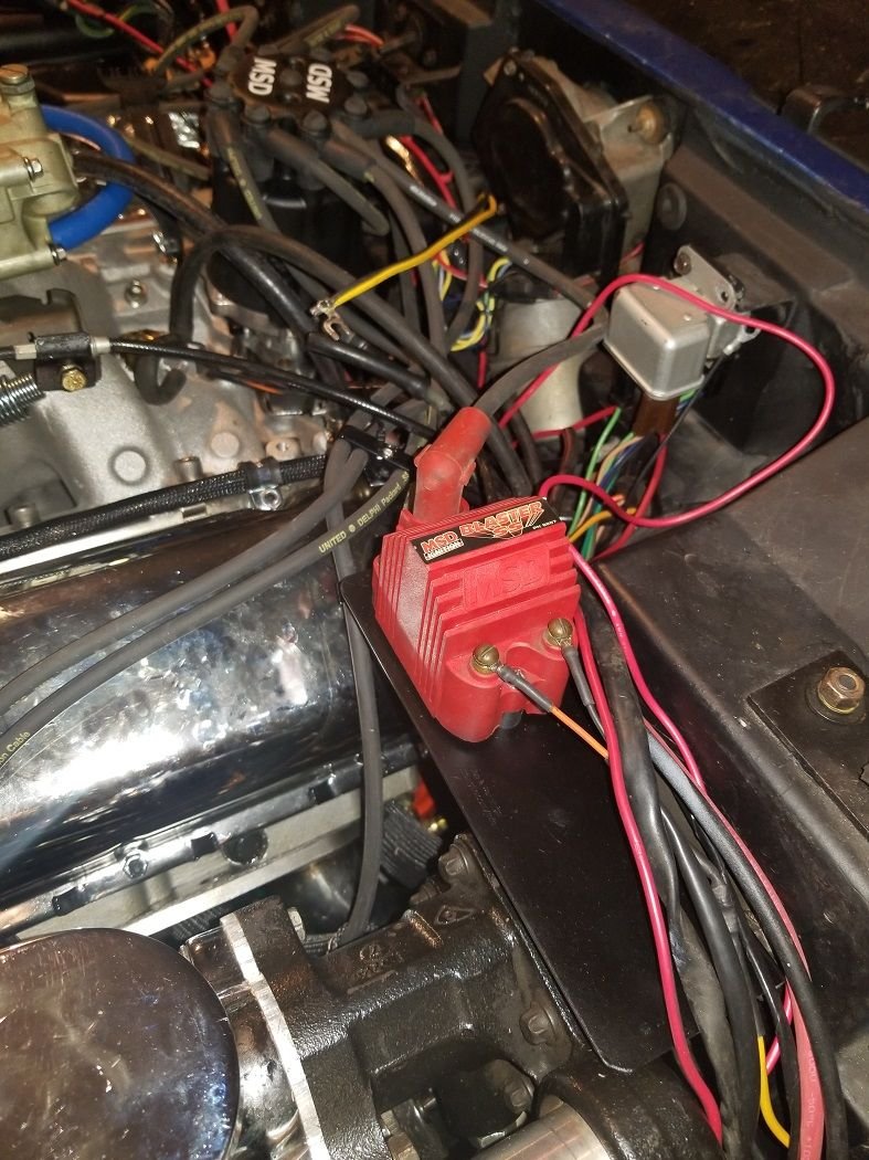

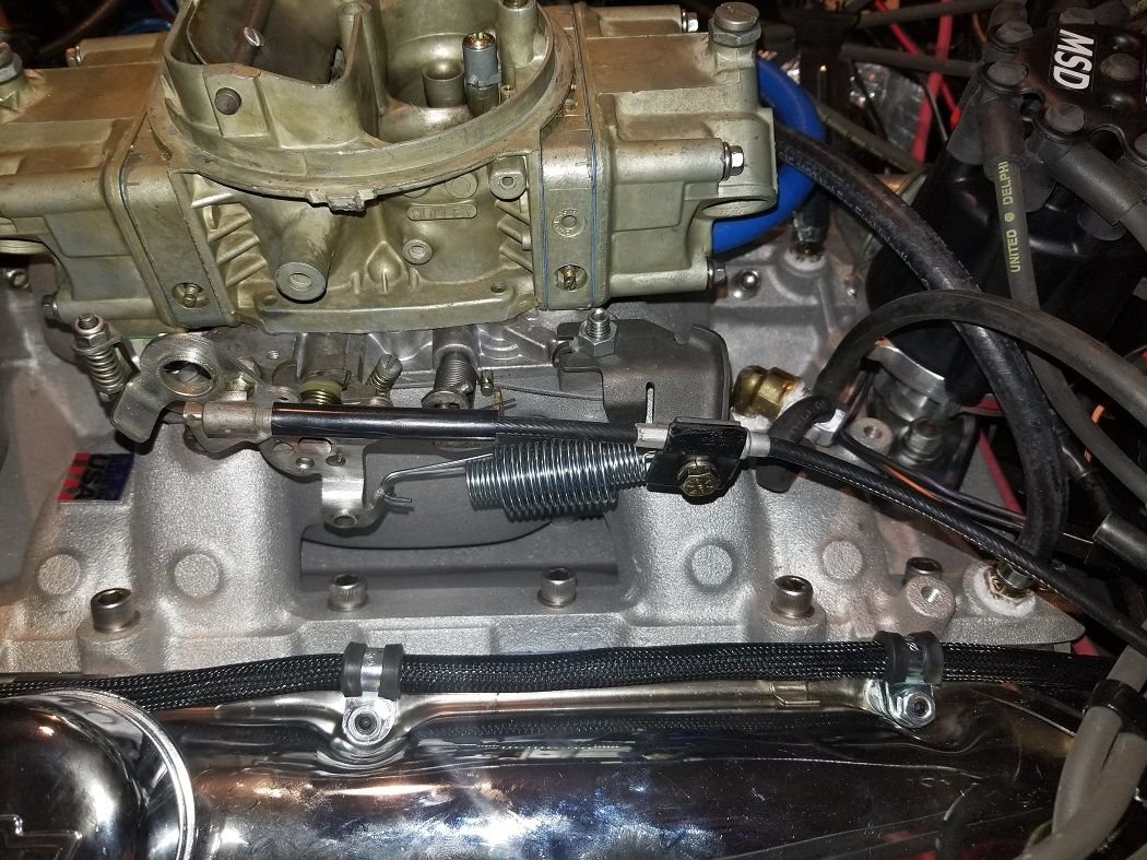

Okay, lots going on but I finally am getting around to posting some pictures. Between last weekend and this weekend I have finally reached the point of starting the engine. I had an issue last weekend trying to get the shifter to go into park and actually lock the driveshaft. After dropping the trans pan, I found the fluid control valve was not properly mated with the pin on the detent/shift lever. Once I got that taken care of, I bolted the pan back on with a new gasket and poured 6 quarts of dextron atf back in the trans. I added the small starter brace, and finished hooking up the shifter cable. Next was getting the remaining coolant hoses installed and filling the cooling system with Prestone and distilled water. I will also add some water wetter before I start to drive the car. I then fabbed/ painted/installed the coil bracket, painted and installed the ign. box bracket with the ignition box. I also added the isolated power and ground lugs on the passenger side. I also intend to add them on the driver side. This will give me easy to connect power and ground locations for current and future additions. The correct throttle cable bracket arrived so I installed it as well. That's it for now. Next weekend if the weather cooperates I roll it out of the garage, fire it up, and do the cam brake-in.

What was the problem with the billet Holley throttle cable bracket?
I bought one for my 73 and want to be sure it will fit.
What did you replace it with?
Thanks, Greg
Thanks, Greg
Greg, there was nothing wrong with the aluminum throttle cable bracket that I'm aware of. I just like the cleaner look of the factory type bracket. I can't say whether or not the aluminum bracket will provide enough clearance for a deep drop base air filter. The bracket I installed is a reproduction of the factory bracket that came on Holley equipped engines in Corvettes. I think there are a few suppliers that offer it.

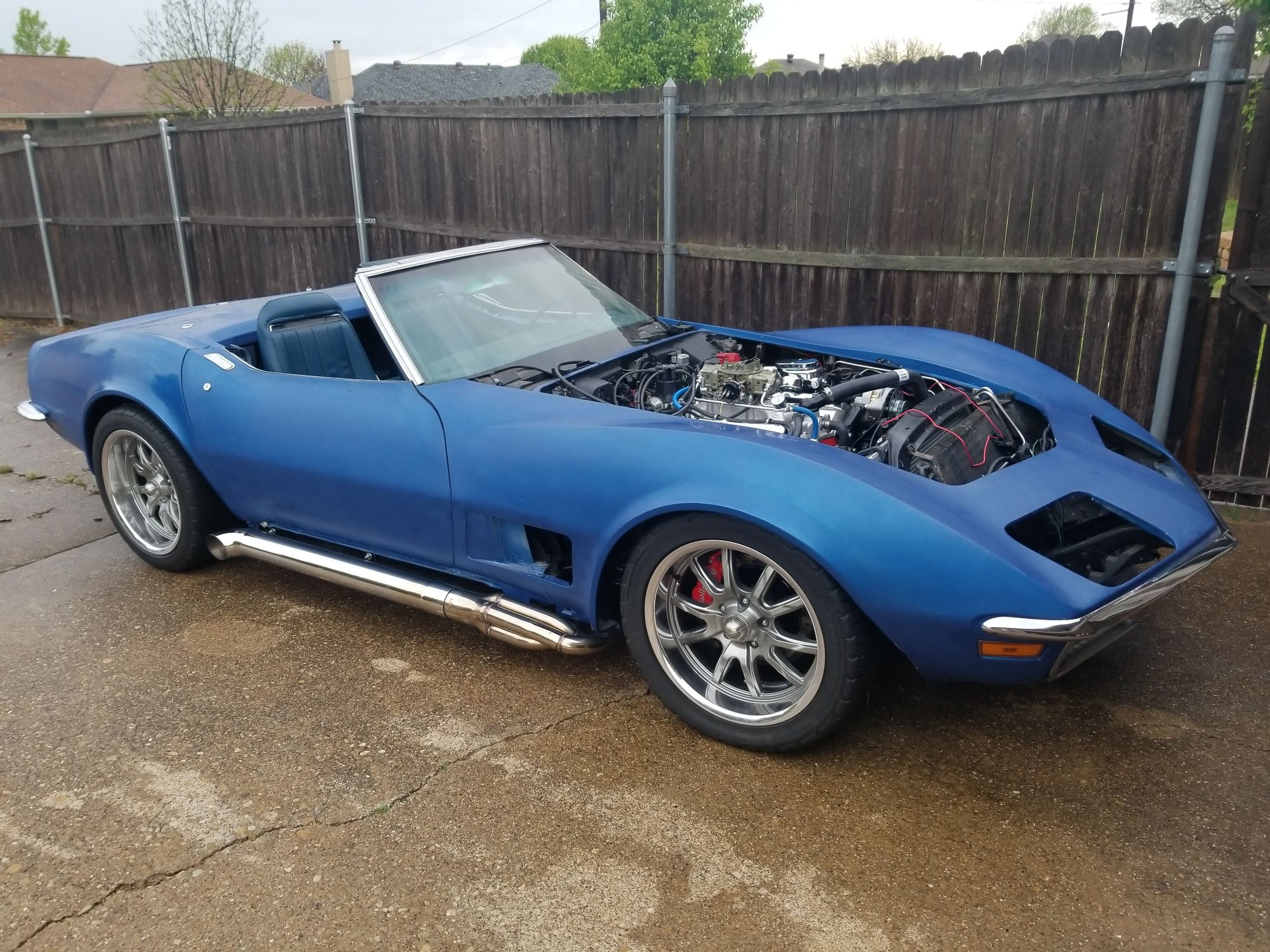

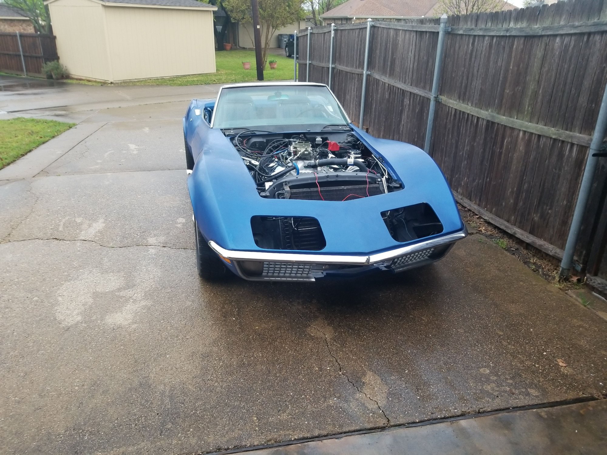

Yes! It lives. Initial start was pretty straight forward. I had to hook up an oil pressure gauge tester to confirm oil pressure because the gauge in the dash indicated zero when I primed the engine and when I did the initial start. Once I confirmed oil pressure, no oil, coolant or fuel leaks, I double checked the oil level and then started the engine and ran the cam break-in. The engine runs great and the throttle response is nice and crisp. I have a few video clips so far, and I am trying to figure out how to transfer them to my PC and then post them here. I am currently working on replacing the cooling fans that came on the car with a Taurus 2 speed fan. I also have to finish flushing the power steering hoses, reinstall them, fill the system and install the power steering belt and alternator belt. Then its off to the shop so I can do the alignment..... Oh, I almost forgot... those 4 inch side pipes sound Bitchin'....

Today, in between rain showers, I was able to bolt the wheels back on and set the car back on the ground. I sat down in the drivers seat, turned the key and the Big Block cracked to life. I put the shifter in reverse and for the first time in more than 2 decades, My 71 moved under it's own power..... WOOOHOOOO! It started to rain again while I was taking the pictures and I developed a coolant leak, so back in the garage it went.....
