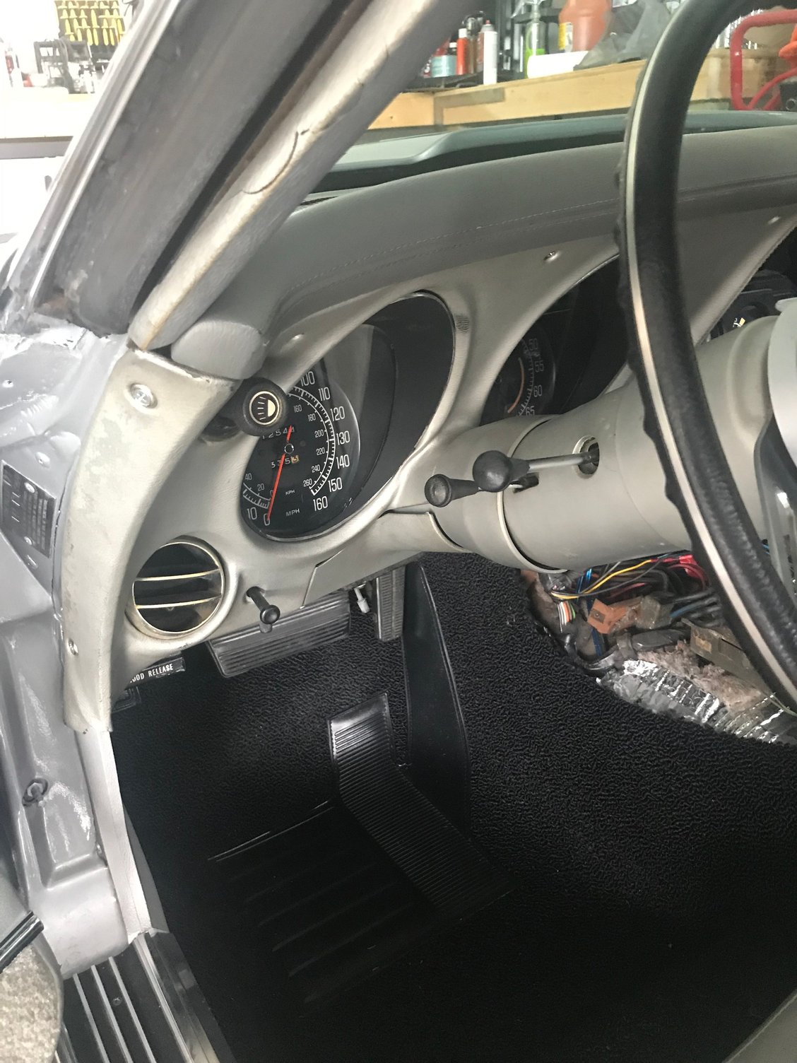

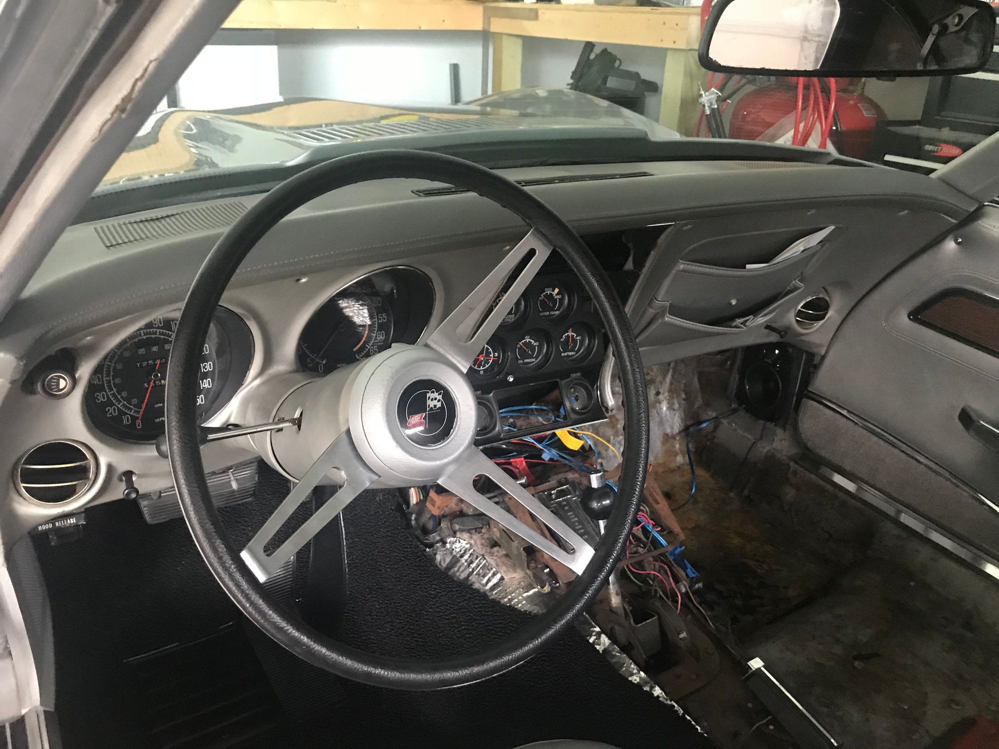

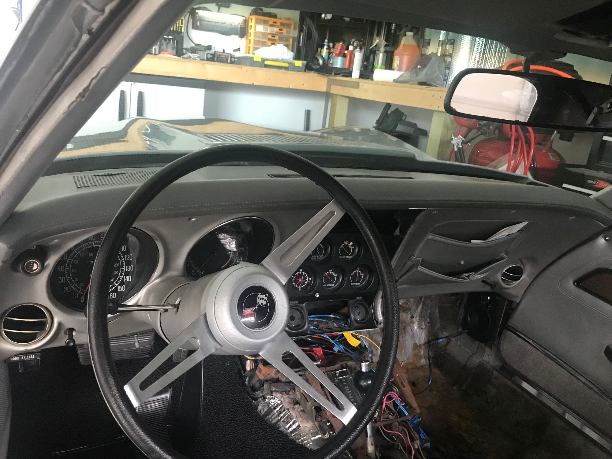

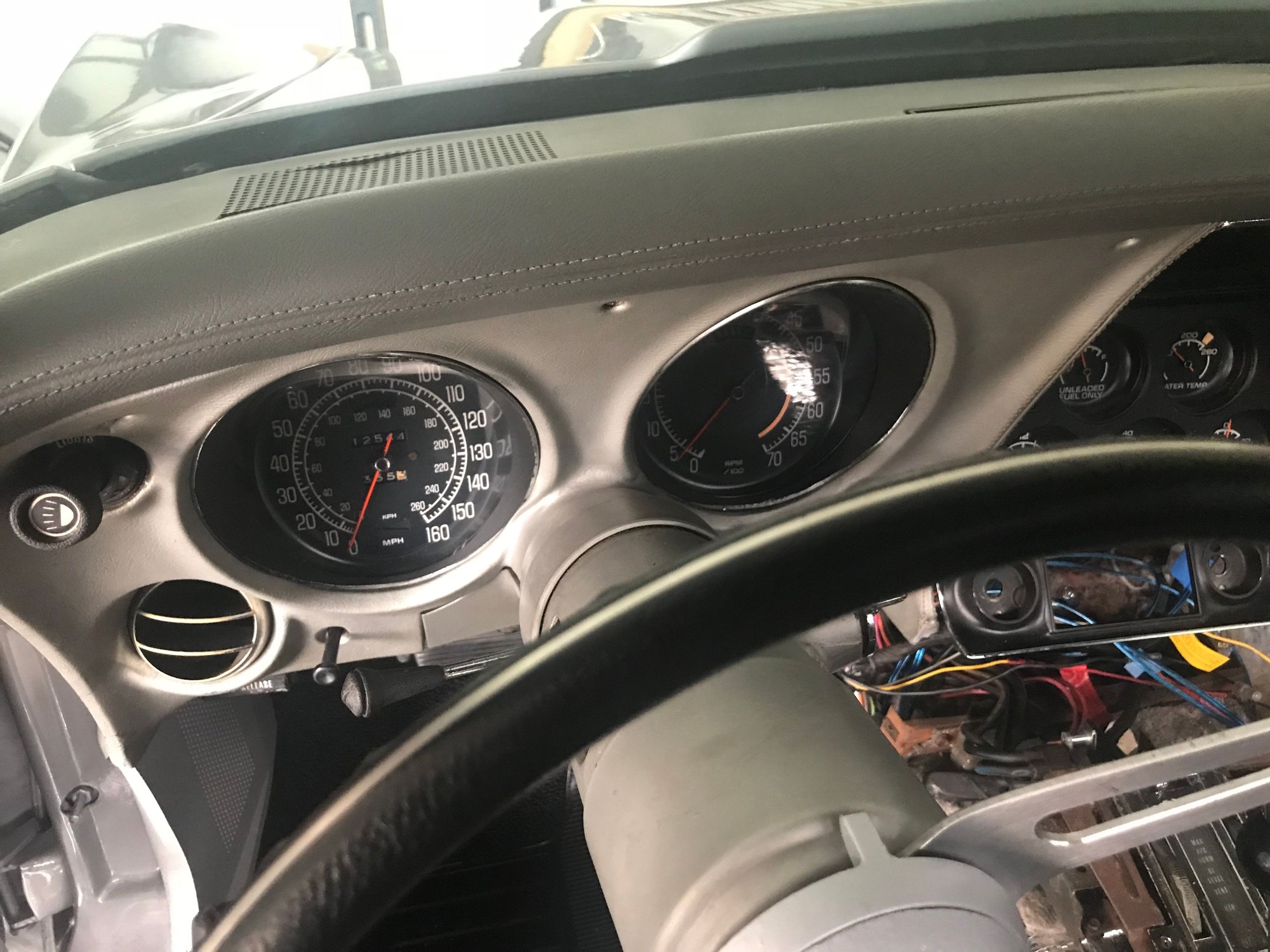

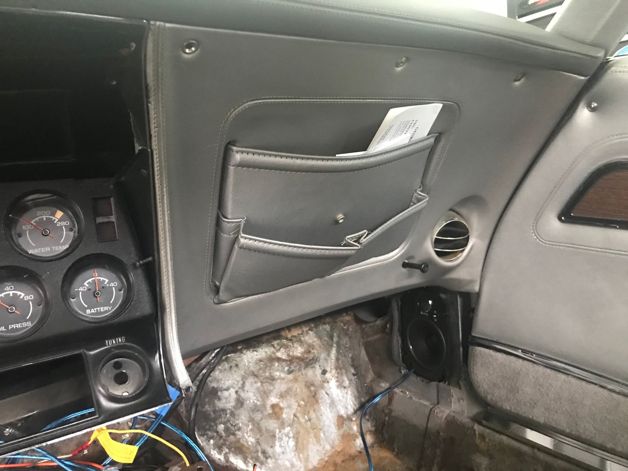

I have removed the center instrument bezel for other work...got me thinking about replacing the left right and upper dash while all this apart....
Is this very hard to do? I have read the dash is hard to replace. It really needs done

Jetglow.. Tommy said you called but putting a price on this would be impossible without seeing the car and the condition of the other parts. For instance, you sent me some pictures today... The pillars look like they could be replaced... do you want these replaced or do you want to go with others..
While you said you have speakers in the kicks, it's way too simple to replace the original speakers with a quality upgrade when the pad is out.
Next ... you know there are more than enough tech articles on my tech page to guide you through this process should you decide to do it yourself.. but without seeing the car and the condition of everything it's pretty darn hard to put a price on doing the job. Your're more than welcome to drive it down so I can take a look at it.
