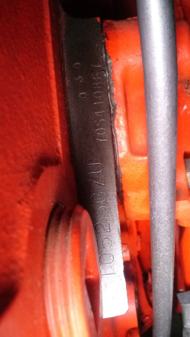

I have a 1970 LS5 454 and am looking for a little help. The body build date is F01, June 1, 1970, Casting date K79, Nov. 7, 1969, 3963512 casting for big block. Engine is stamped T0525 CZU, I believe built May 25, 1970 at Tonnawanda. The NCRS does not allow a casting date and engine build date over 6 months apart. The national judges have looked at the stamping and did not believe the engine had been re-stamped. I don't have a build sheet and the burden of proof is on me to prove the engine is original. I have seen several instances of this for 1970 cars and maybe someone on this forum is in the same boat. Seems to me if the stamping is good and the casting date is prior to stamping, it would have to be the original engine. Any help would be much appreciated.

At which National Convention was your car Flight Judged.... how recently?
What are the dates like on other dated engine components .....heads, intake, exhaust manifolds, etc. Are they typical for an engine assembled near the end of May?
Any chance of seeing a photo of the pad?

You may try contacting Al Grenning. From what I hear he has an extensive library of photos of stamp pads. He may be able to look over what you have, give an informed opinion whether it's original or been tampered with. Sounds like the date code fell just outside the 6 month rule.

We have seen a few of these. We (NCRS Judging) had one at the Laughlin, NV Regional meet last year and another at the Altoona Regional last August. Terry McManmon has I think two on his list. So... If your's is real, this would make number five or six?
I have collected the VIN numbers, build dates, engine build dates and casting dates from those cars. If you would care to share those with me, I would appreciate it. I'll add it to my the list.
When the 70-72 TIM&JG is updated again, I plan to add this to the Manual. I know the normal Mechanical judges are aware of it and Chuck Berge is aware of it. As we get older, we sometimes need help remembering though :-)
I have heard several stories why this happened, block being returned from school, advertising, promotions, etc. Gm would use them, as they were still good.

About 12-14 years ago a friend of mine had a very nice original '71 LS-5 automatic car that was built Dec 7, 1970 and that car's block was cast around April 6, '70 assembled on April 25. I'm no pad expert, but have looked at hundreds of them and I believe 100% it was original to the car. The car even got Bloomington Gold Survivor and the judges then too believed the block was original to the car. I think Terry Mc. was one of the Survivor judges too that said he believed it was the original engine. Not sure, but wasn't there a strike either at the engine plant or the Corvette assembly plant around that time? What's ironic is we were at an NCRS Chapter meet in Pittsburgh, PA around that same time and there was an owner there who had a Silver '71 LS-5 coupe that had a VIN# super close to my friend's car and it too had like an 8 month time frame between the block casting date and build date of the car.

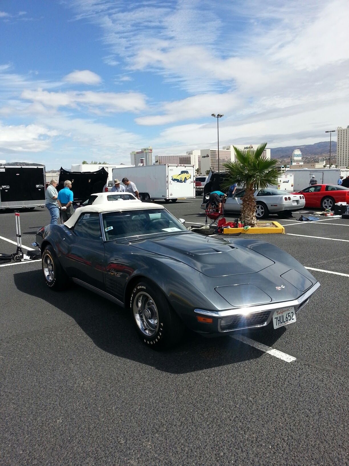

Hi md01,
Interesting information from Gary and a VERY NICE looking convertible in the photo!!
I hope you decide to bring your car to Las Vegas!

you just don't know the factory first in first out system and how well it was maintained. some blocks failed initial test and then went into a fix area for months, some blocks failed under warrantee and were sent back to the factory for refurbish, some blocks might sit built in the assembly factory for months awaiting a car due to strikes, some blocks might sit at the factory before and after being built.
in general if the process worked correctly and the line moved, and the trucks delivered the parts, then the 6 month rule is gospel. but there were many exceptions.
factory fonts, broach marks and correct patina factor in to what is correct. and engine originality is nothing but a plus or minus degree of faith when things can't be proven.
you just hope your appraiser, your judge, or your buyer can be convinced.

If I was a buyer, the lack of 48 year old patina would certainly raise a big flag for me on this stamp, even though the fonts and placing of the characters stamp look correct.. I would need a much better foto to determine the broach marks, which are hard to see on this example.

What is that 0 3 0 stamped on the pad ?

Beautiful looking 70 LS5 Vert you have in a great color. Need better pics of thebengine pad.

Hi jr,
"What is that 0 3 0 stamped on the pad ?"
I'm thinking the stamps indicate that the shop that rebuilt the engine at some time bored the cylinders .030".
