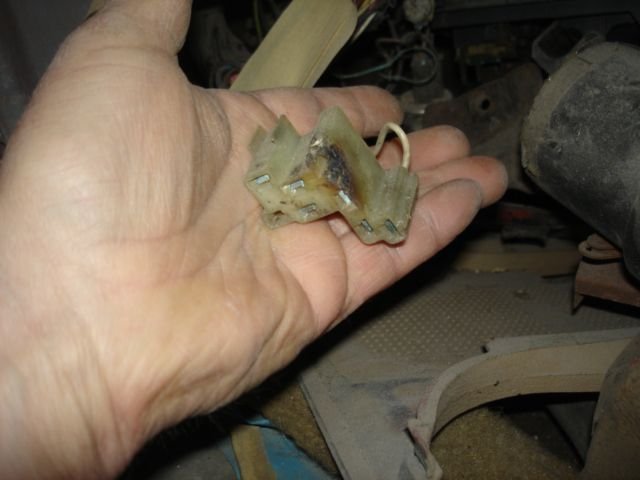

As promised. Here is a photo of a headlight switch that obviously malfunctioned and DID cause the dash to catch fire.
DUB
DUB
I don't believe I've seen one that bad although I've seen a dimmer switch connector in that condition.
YEAH..I was kinda shocked when I got into to to find this. The dash panel was really cooked and actually got so hot that the laminate film in the windshield bubbled between the layers of glass.
It now causes me to have to consider this area as being a point where a fire can start. Not like I do not have countless other areas to worry about.
DUB
