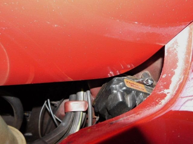

Originally Posted by portland68
Can anyone tell me where the Ignition Pulse Amplifier is located on the 71 LT-1?
Open you hood left outboard of car can be higher then this one look in the wheel well should be 3 nuts in a triangle those are its mount bolts.
Old Sep 22, 2019 | 07:59 PM
  #422
portland68's Avatar
portland68
Joined: Mar 2018
Posts: 62
Likes: 5
Thanks, I will take a look..
