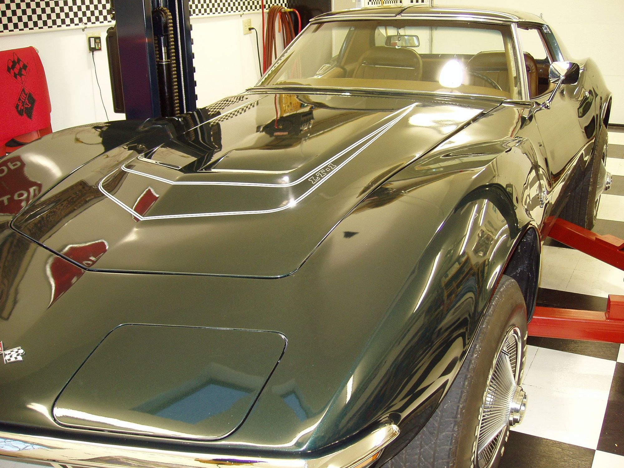

Was second owner of this 71 Brands Hatch Green for 33 years sold it in 2006 to 3rd owner who sold it to the 4th who resides in Florida.
This is a friends 71 LT-1 and it for sale on the Forum Stunning over the top restoration. His asking $49k
