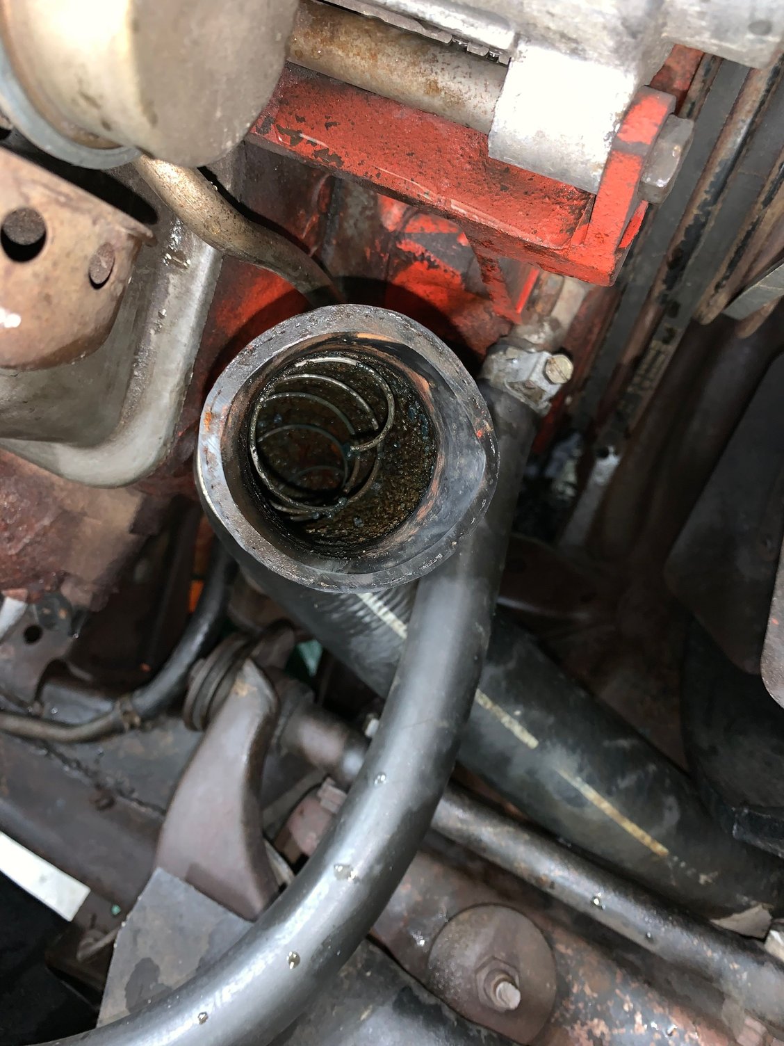

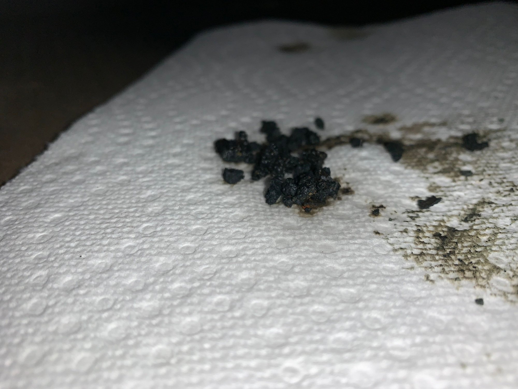

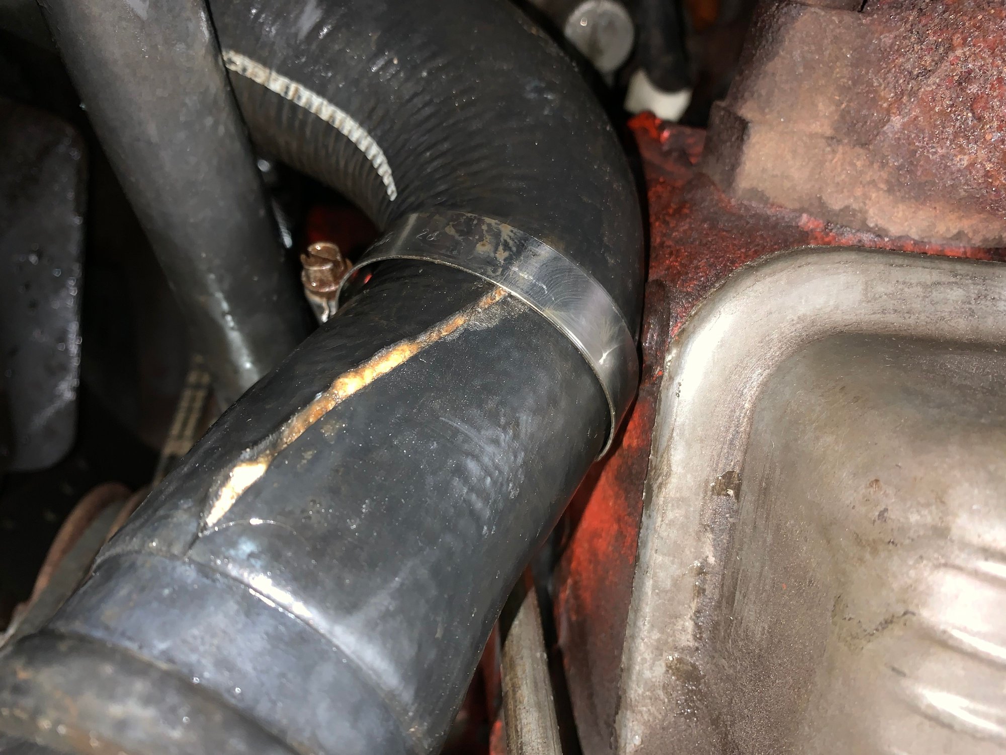

Pulled the lower radiator hose to drain the coolant. This junk came out and a good amount of it. The hose is covered in it internally which also has a crack/slice in it. Time to get a new hose. My question is can any of the junk get in the engine and cause issues? It ran great before I pulled the hose off at around 160 degrees. Also, if anyone knows of an original hose I can get my hands on that would be great.

Me personally............change the hose, change out as much coolant as you can, run it for a year, and repeat next year. I would not flush the system as you don't know what you may raise hell with (radiator and / or heater core). I'm sure I do not need to tell you......keep that hose!

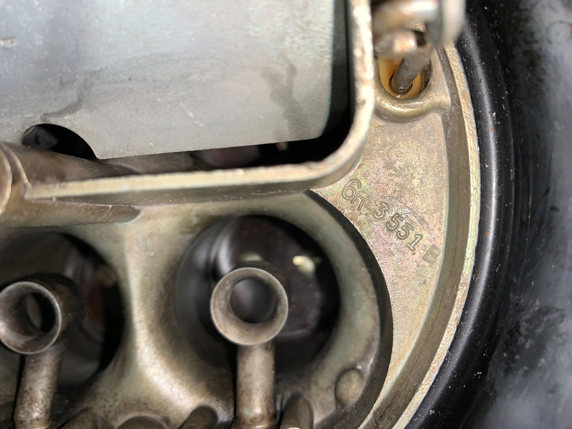

Found this code on the 4bb Holley over the weekend and the tech judging manual doesn't reference it or I overlooked it. Does anyone have an idea of what this code references? Thanks.

That is a Holley casting number not a number you can use for model information. On the air horn vertically stamped right next to your casting number would be the numbers needed for this Holley. Also could be on the side of the carb. This video should help you scroll down to the video.

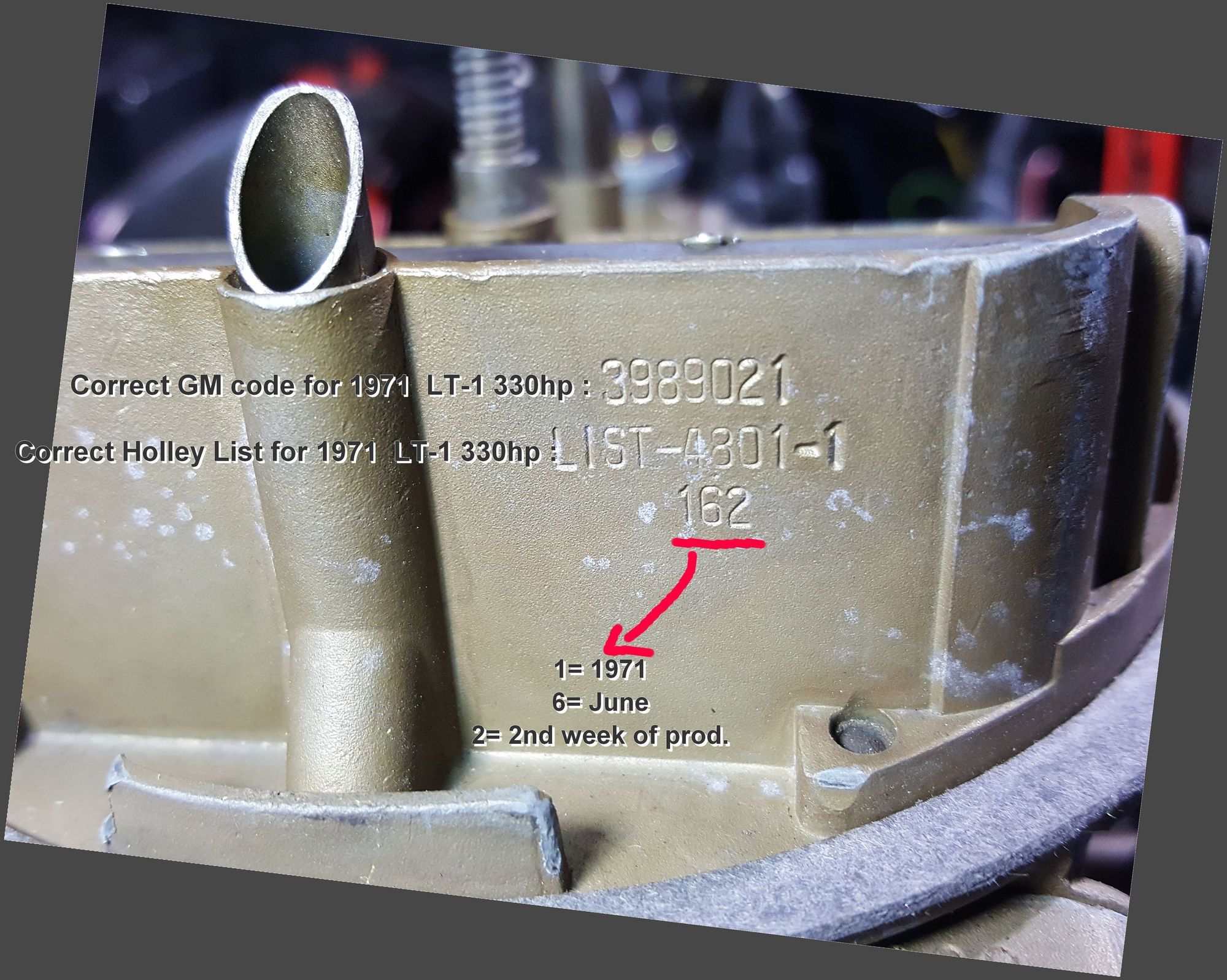

Here is the correct ref list from my 71' LT-1. Location is front wall of the air horn stamped (hollow).
But true you also have a number (cast not stamped) on the top of the air intake right side (passenger) as yours. The one cast in relief on mine is 6R 3828 B.
Further, you can also have both the metering primary and secondary that have the correct numbers, respectively 6808 and 4919. I'm not sure it's jugged though.

My carb was born on Jan 1970 in the 3rd week.

@bearcatfan9 you got it ! List-4555 & 3972121 are correct numbers for camaro and corvette LT-1 / Z28.
1970 and 71 and I guess 72 Lt-1 are all 780cfm (which is far more than needed). By the way a Holley tech told me a 650cfm would be for road application much more adapted. But well who's gonna change a carb that's still working ?

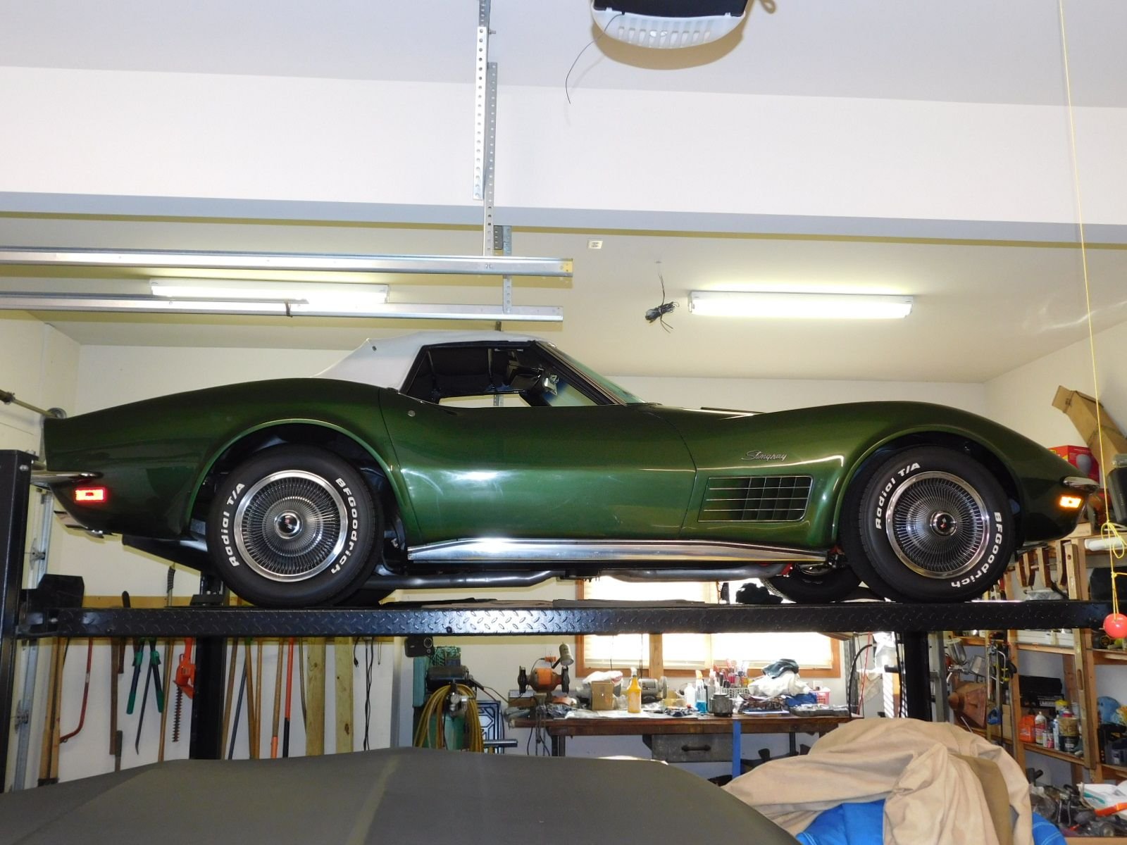

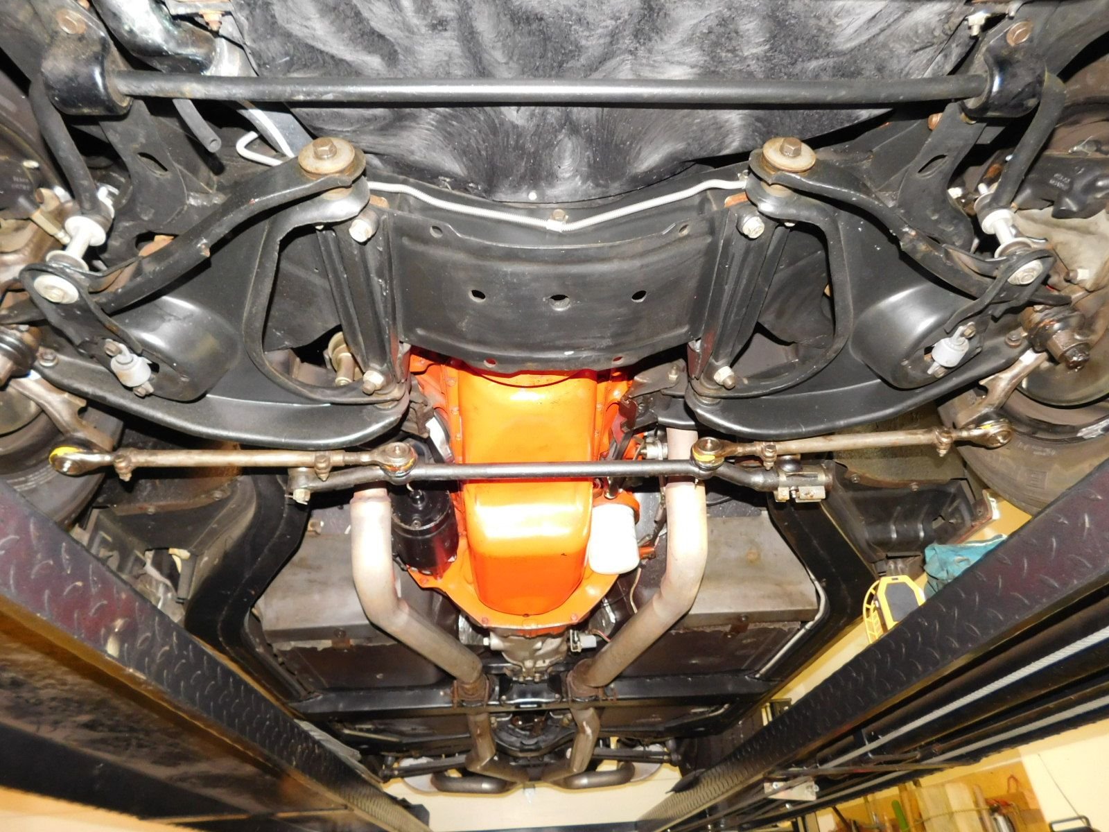

This thread has been really quiet recently so I'll add my resent purchase.
I sold my maroon '70 LT1 roadster a few years ago and I really missed that car and appreciate LT1s in general.
I recently was able to buy another 1970 LT1 and I am very happy that I did. It is a correctly done, frame off, older restoration of an all original low mileage, 42.5K, car. I am the 3rd owner. Number two owned it for over 30 years. The original owner saved all the paperwork and stopped driving it in 1979, storing it in his garage. The second owner achieved Bloomington survivor and 3 years later Bloomington Gold. He then had the restoration done and won 2 National NCRS top flights, scoring 98 points the second time. Since then he maintained it and kept in nearly the same cosmetic shape since the restoration. I'm finding some minor things to keep me busy, but it needs very little.
Besides the car, the original paperwork is really great. Everything was saved since new. Here's some pictures of the best items and a couple pictures of the car. I just started going through the car and cleaning.

Looks brand new nearly and great paperwork!

Looks great

That's remnants of a radiator sealer such as BarsLeak..
