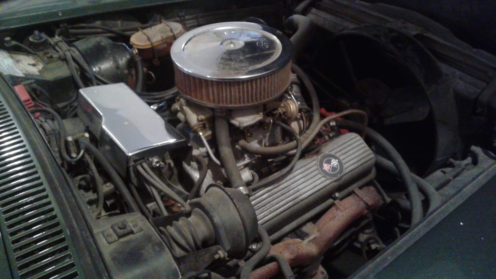

Good morning all , i have maybe a lt-1 in sight , i have a question , can a lt-1 can be ordered with a 3 speed auto ? Or it's only muncie thing ?

they send me this picture yesterday night , he will send me more picture with built sheet later today

If that is the engine in it, it is not original. The transmission extremely unlikely.
What year. If 72 they are ID in the VIN if IRC. If earlier, look for three holes/nuts in the front of the left wheel well. They are for the TI amplifier.
Oh, and check to see if the cross member under the transmission is bolt in. Such only used, I believe, in cars originally built with an auto.
The tach should have a 6500 red line, unless 72 with AC.
All easy to check.

Although the smog pump is gone and the associated exhaust manifolds are not correct for the A.I.R system, the fast idle solenoid is still there. The engine might be the original born-with.....would need to see the stamp pad and VIN of course. The build sheet will be interesting to see.

I have the vin number , what i need to look for ? , it’s a 72

Is there an "L" in the VIN? If so, it left the factory as an LT-1. (This applies to 1972 models only.)

This is the correct engine.Approach this car with utmost caution. Too many red lights flashing IMO.CURIOUS! I swear I saw a group of engine pictures associated with this car, and the engine clearly was not correct. My apologies if I've steered you astray.

Thanks guy ,it's a L48 with aluminium intake ,i keep dig to find the right car
