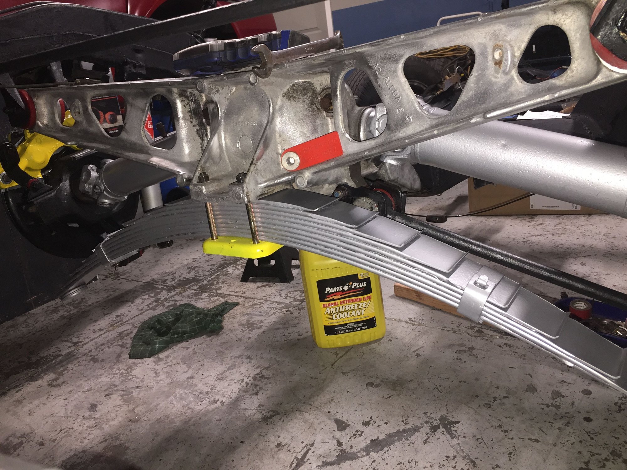

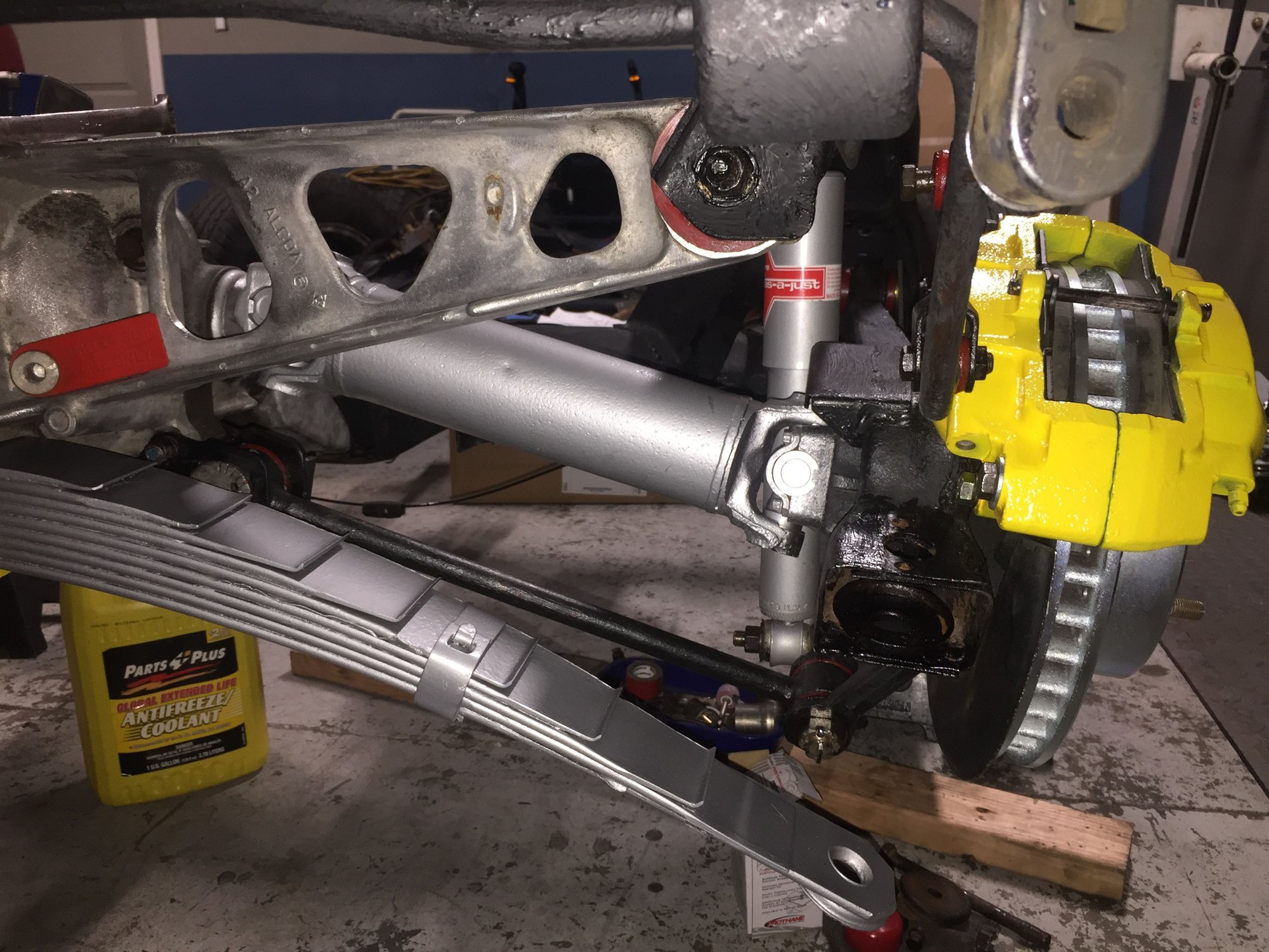

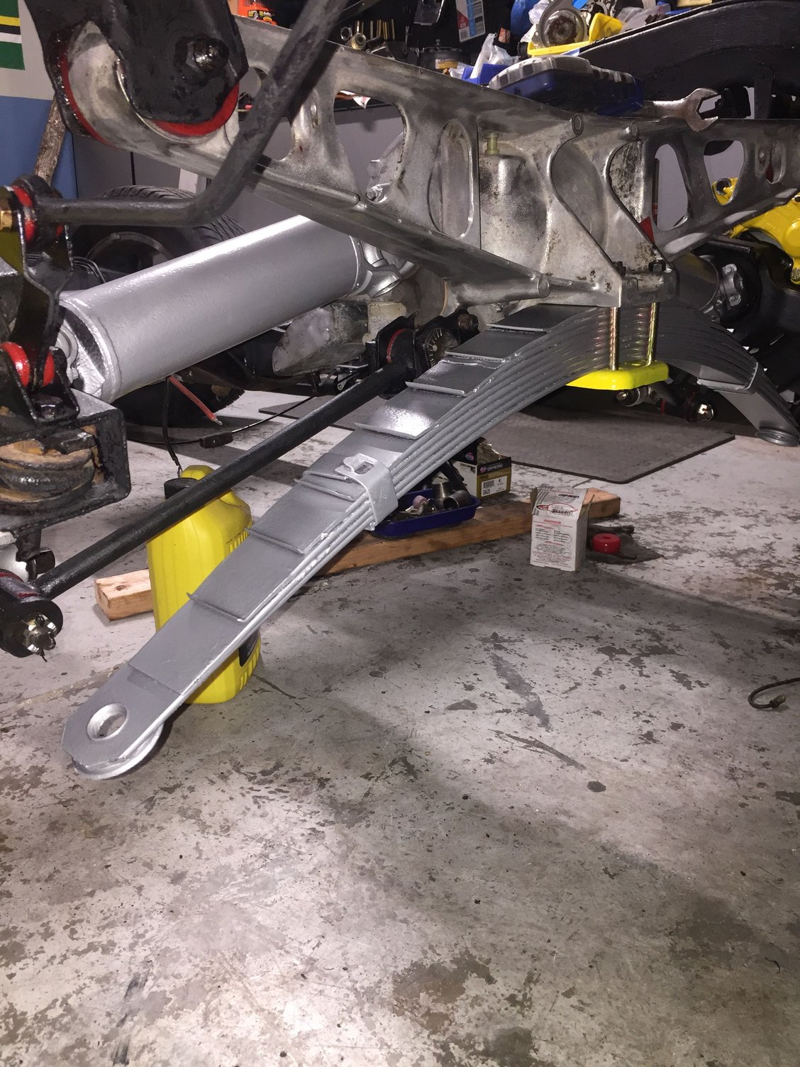

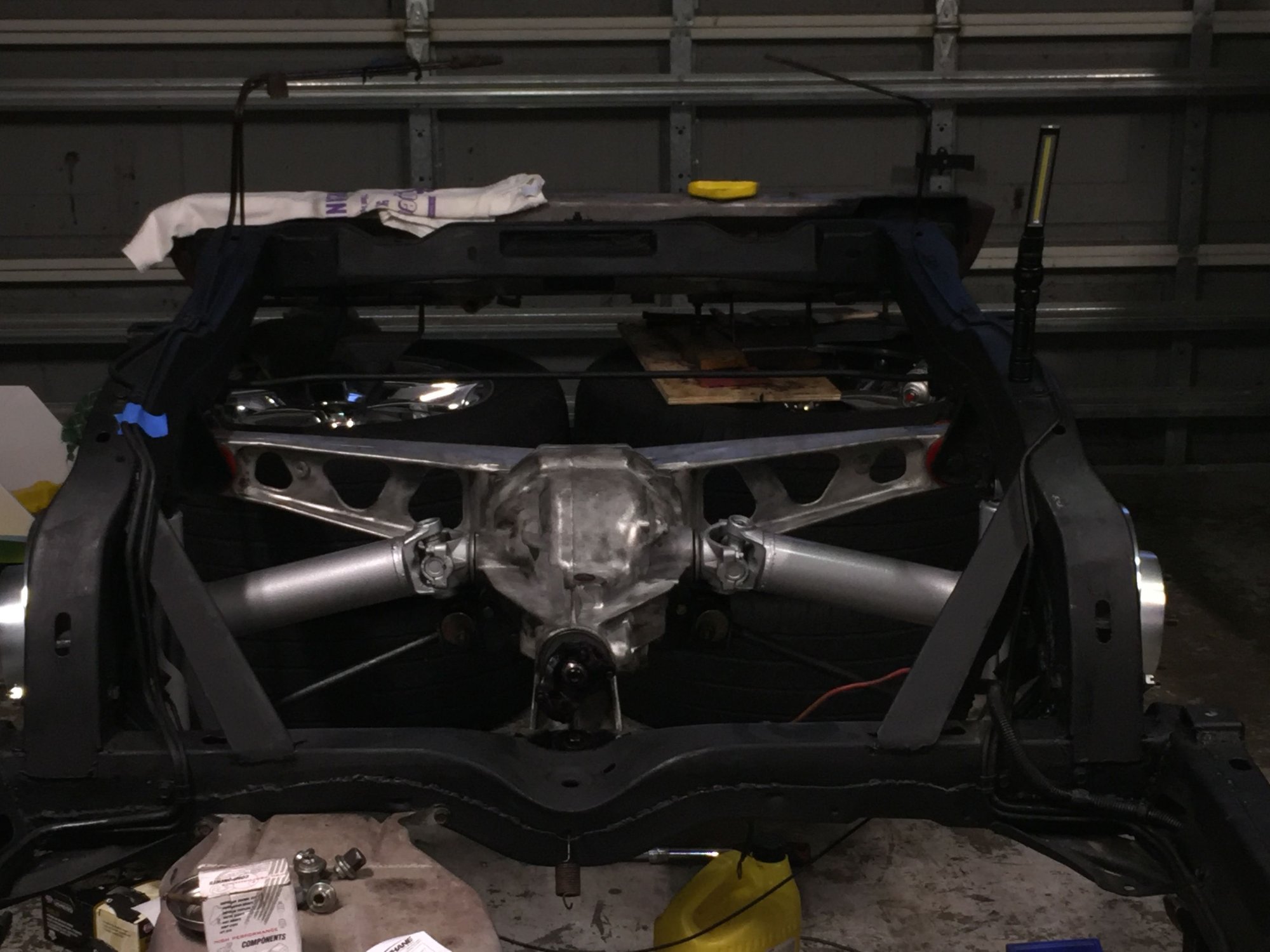

Need to clean the diff once I can roll it outside but looks better than day one.
Spring bolts will be here shortly.
Frame work is all but complete. I’m waiting on the spring bolts to drop it off of the stands, (ordered). Started on the laundry list of interior needs including repair of rusted kick panel mounts and rear mount bracket replacement. The wiring will take some time since the interior was partially apart when I got it and I still need to replace a few panels.

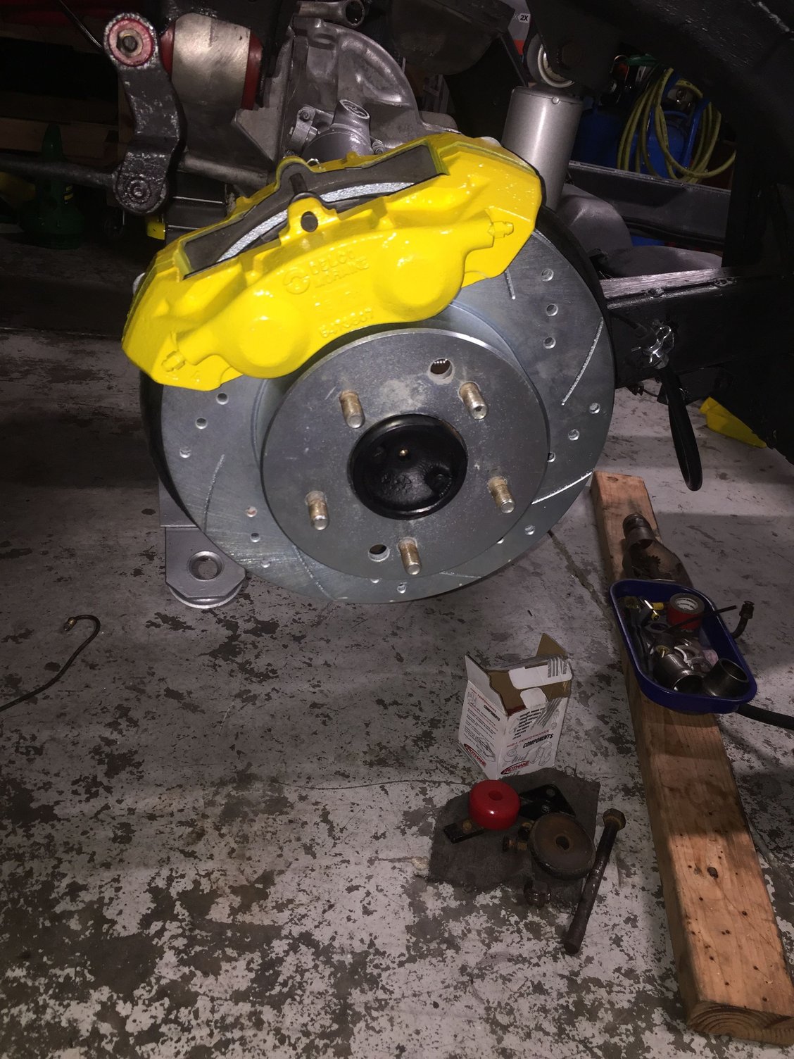

Looks awesome, the yellow calipers are clean.
Solid progress!

Thanks, it’s nice to see it coming together.

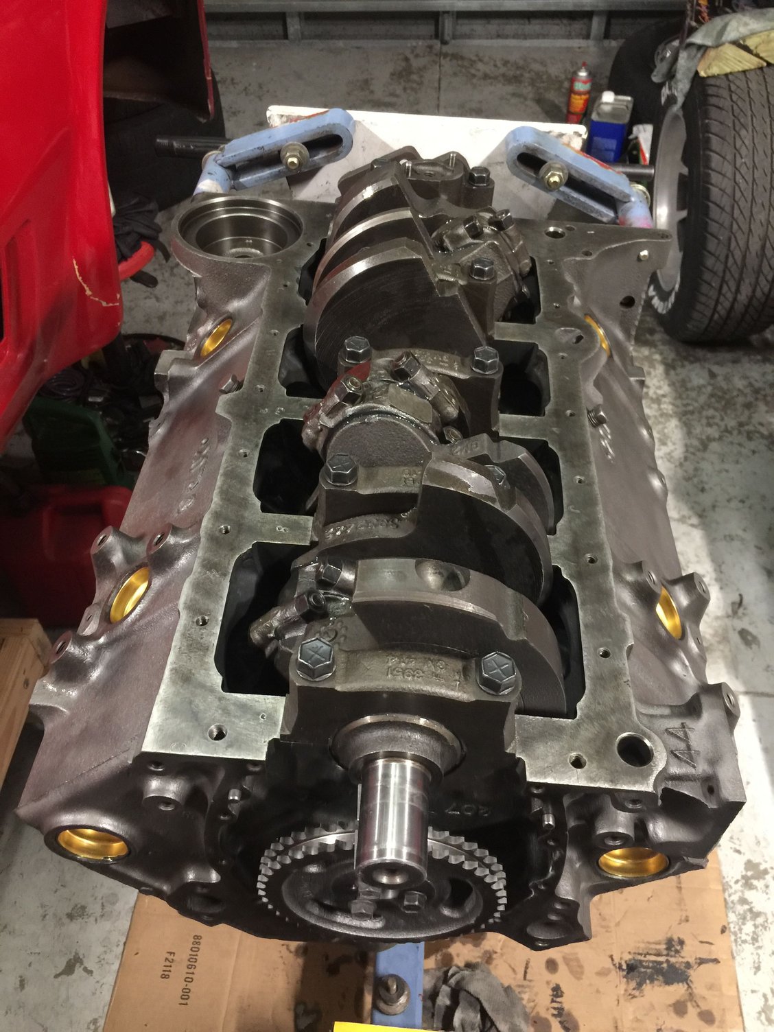

Default Started on engine

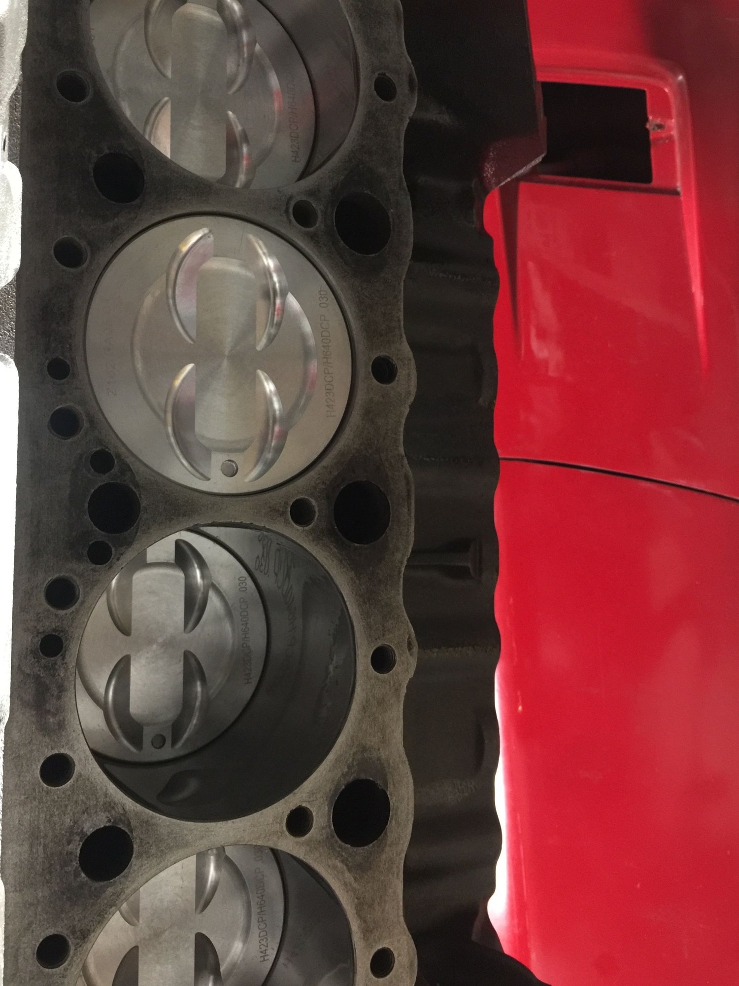

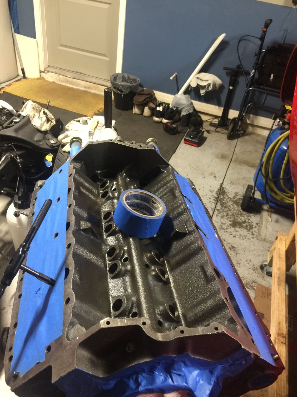

Got my block and parts back last week. Took time to clean everything and now I’m putting it back together. Crank, pistons and cam are in and it’s time to call it a night.

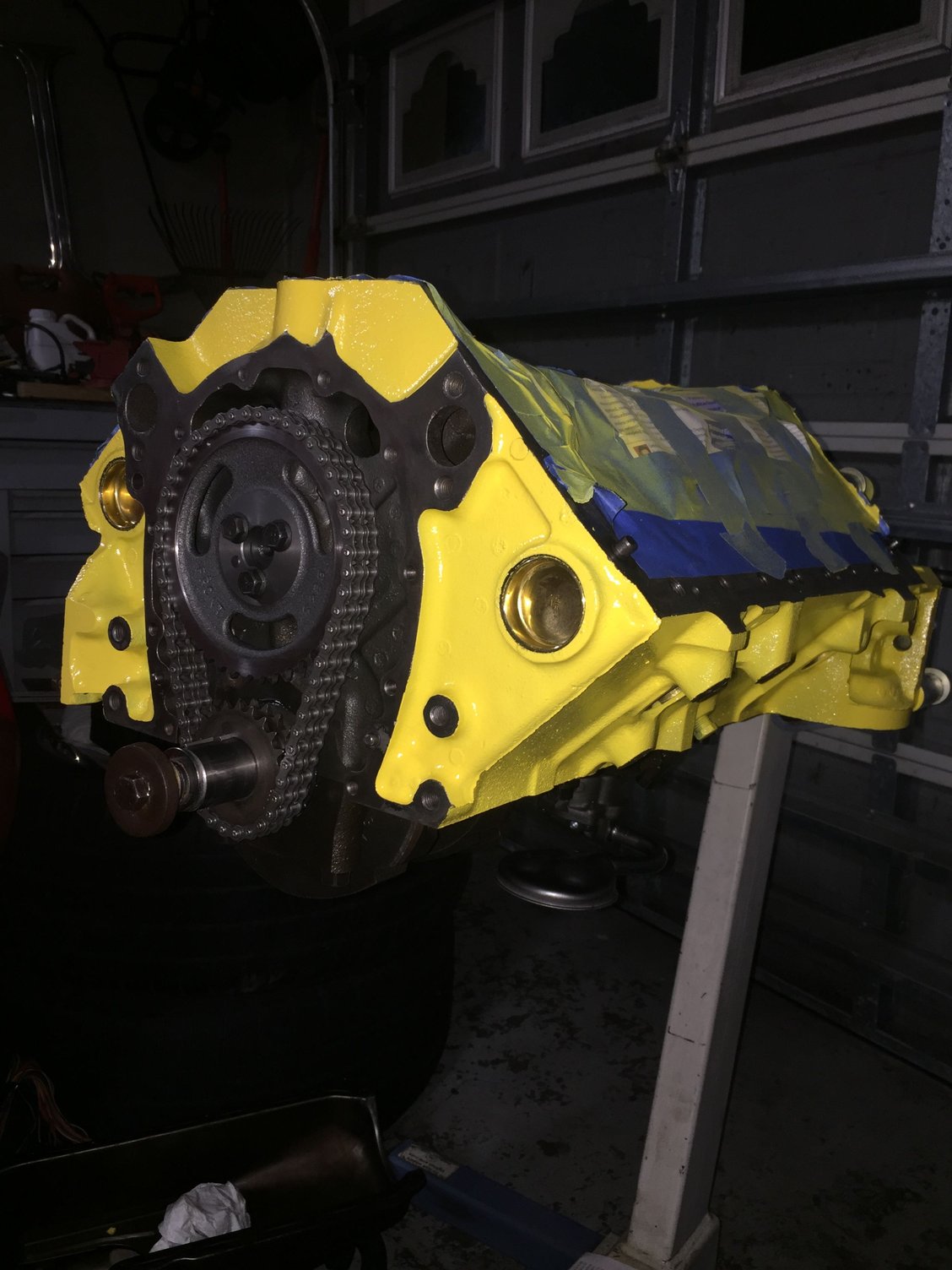

Old Dec 28, 2018 | 06:00 PM
  #34
Gman81's Avatar
Gman81
Joined: Aug 2018
Posts: 151
Likes: 45
From: West Palm Beach, FL

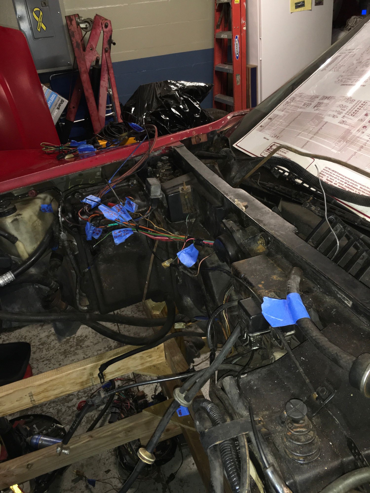

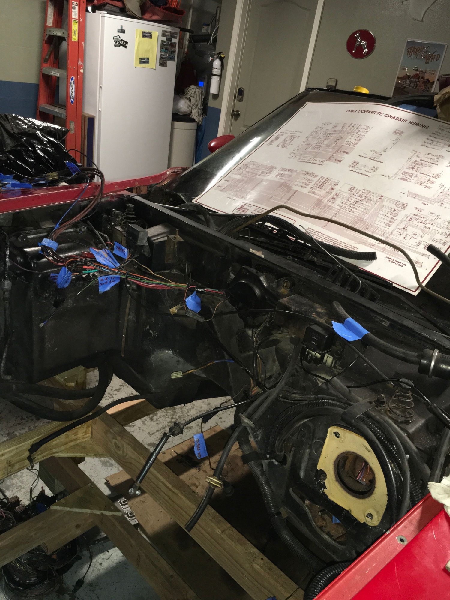

It’s been a busy December and I have not done much to the car engine wise. I tossed my oil pan when I tore the engine apart and now having a tough time finding a replacement, (rookie mistake). I need an oil pan that will fit my oil pump pickup so the small sump does not work, (kicking myself). I’ve already returned one to Amazon and one to Ecklers because my 81 seems to be an odd duck. Anyway, I’ve started in on the harness repairs and identification, since it was mostly hacked and bubba’d when I got it. See the before and after pics of the engine compartment. Interior wiring is also coming along nicely and should be complete in the next week or so.

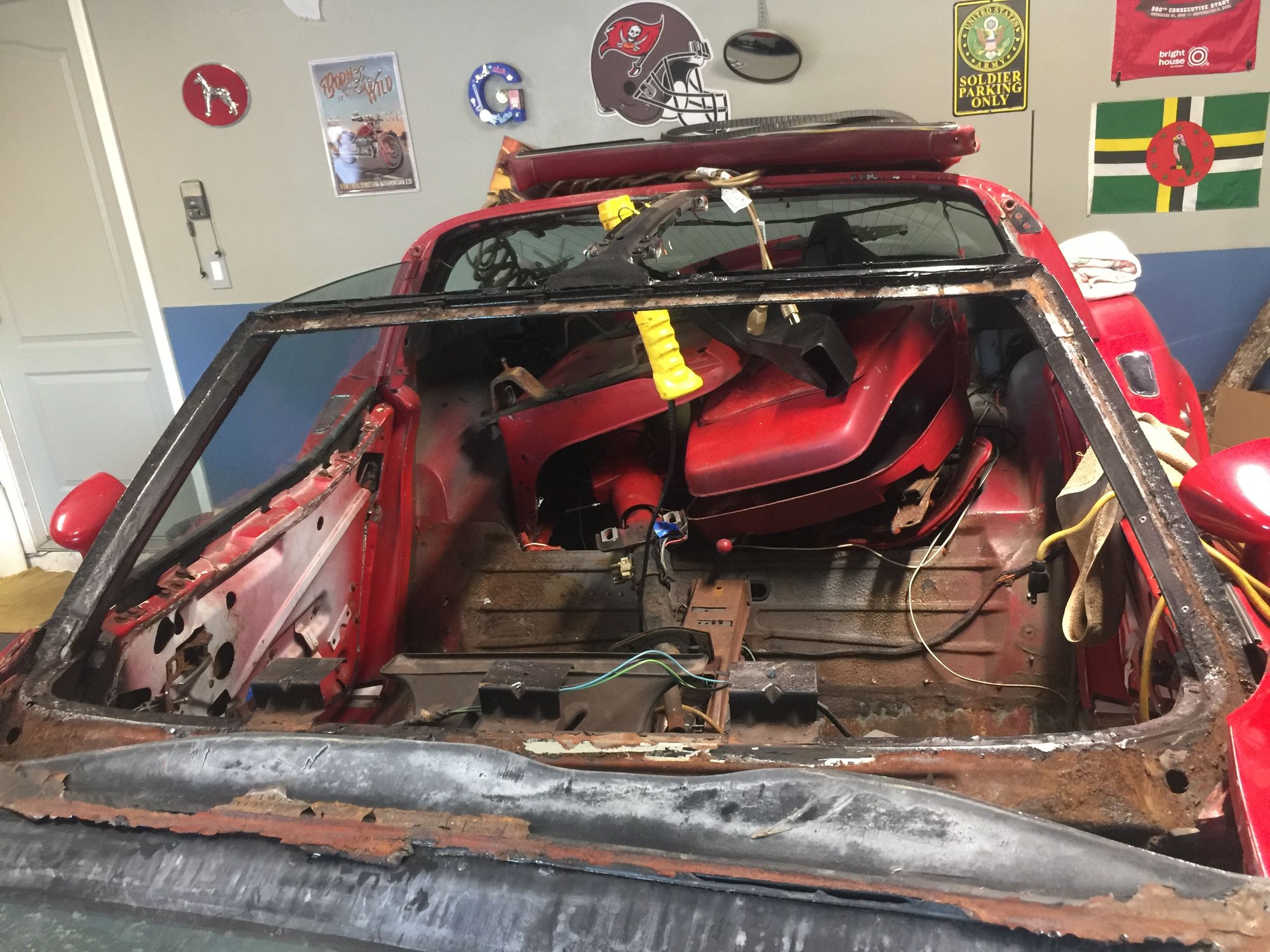

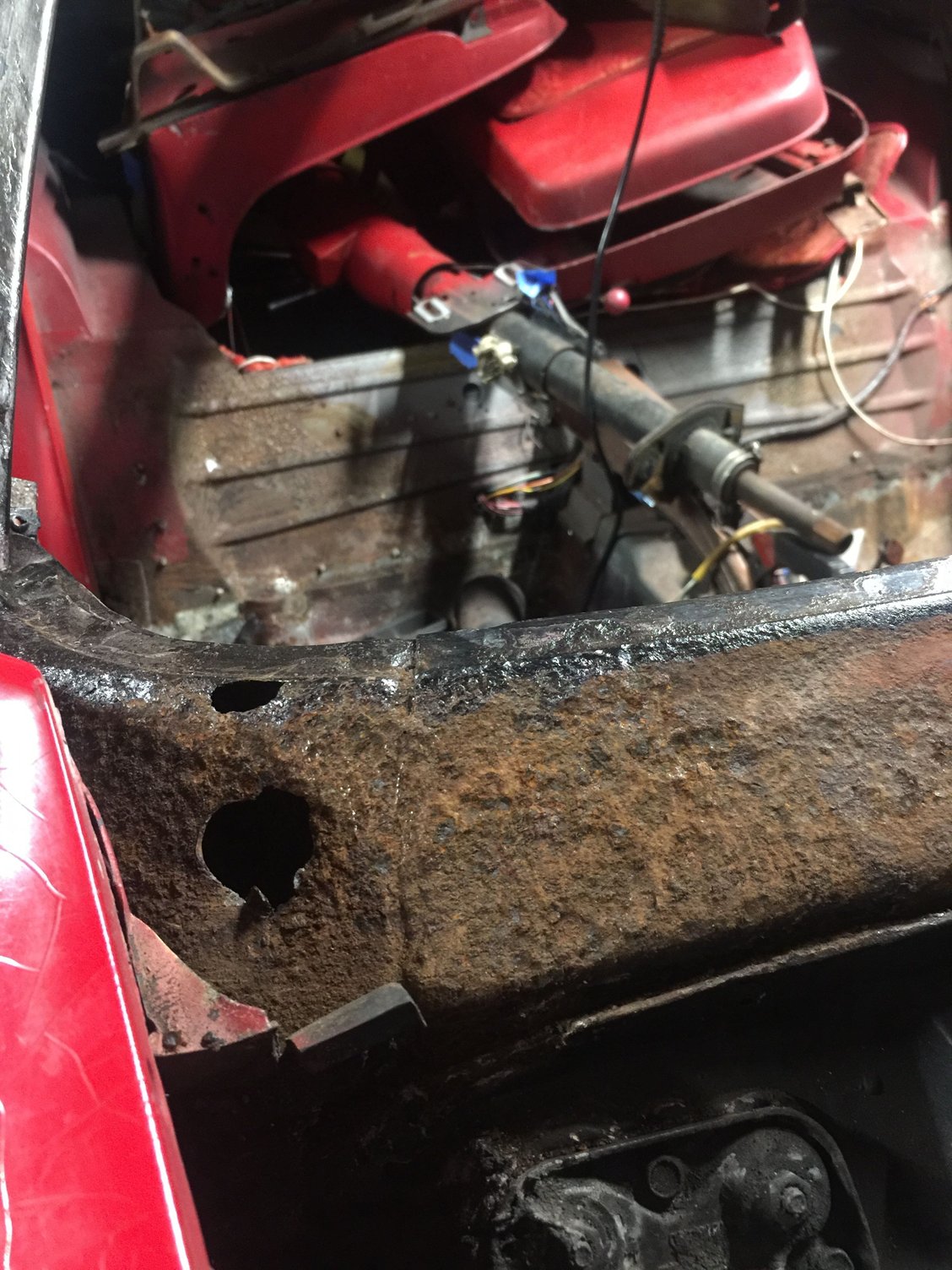

Pulled the windshield today and the birdcage is not as bad as I thought. That’s a relief, still have to do some work but manageable for sure and the interior dash side is clean and solid.

That part of the birdcage looks very rough to me.

Not as bad as it looks. Solid and I will replace the flat corner sections with welded in stock.

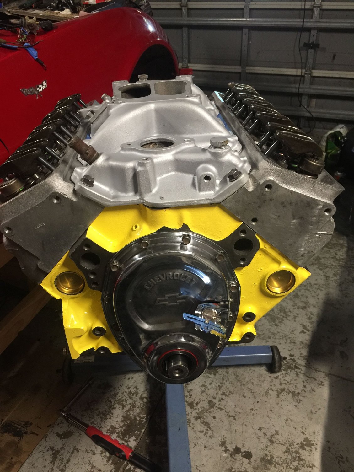

I’ve gotten engine together enough that I can set it in the frame with the trans today. Need to get Bracketry and peripherals installed slowly. It was missing a few brackets not yet identified but my neighbor has an 80 that I can look at for guidance. Slow and steady, but not to slow😁

Some 40+ years ago (and before the advent of fart cans & tunercars) I built a hotrod 3KC Toyota 1200cc pushrod motor … and painted its iron block yellow too! I Iike it on yours as well!
I can see in your pics your H423 pistons, Aluminum Heads & Flat Tappet Lifters.
Did you deck the block? if so How much?
Which Aluminum Heads? they look like they may've been run.
Which Head Gasket?
Which cam?
