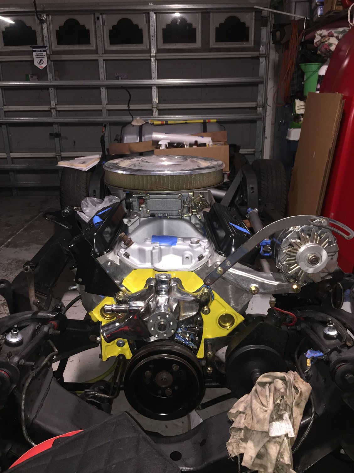

Some 40+ years ago (and before the advent of fart cans & tunercars) I built a hotrod 3KC Toyota 1200cc pushrod motor … and painted its iron block yellow too! I Iike it on yours as well!
I can see in your pics your H423 pistons, Aluminum Heads & Flat Tappet Lifters.
Did you deck the block? if so How much?
Which Aluminum Heads? they look like they may've been run.
Which Head Gasket?
Which cam?
Best guess heads are L98 / ZZ4 heads
Decks don't look like any Recent mill/deck

Originally Posted by jackson
OP Gman81
Which Head Gasket?
Which cam?

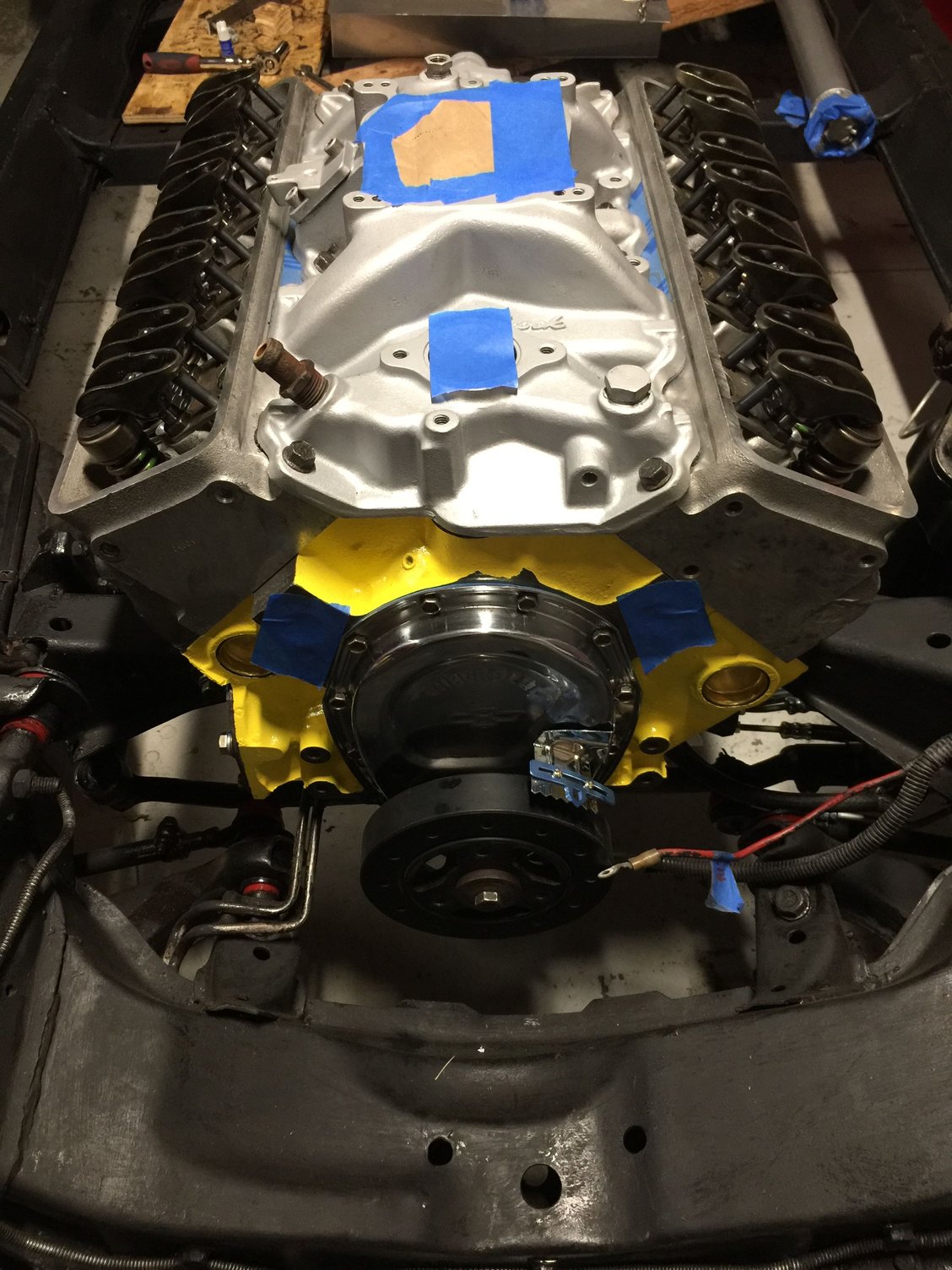

no deck work on the block. I got the heads from my machinist off a project he was pulling apart and he did all the valve work. Center bolt valve covers, 58cc. Pre-vortec style 87-96.
Speedpro pistons and mild cam at .466. Edelbrock intake.
installed in the frame with rebuilt trans this evening.

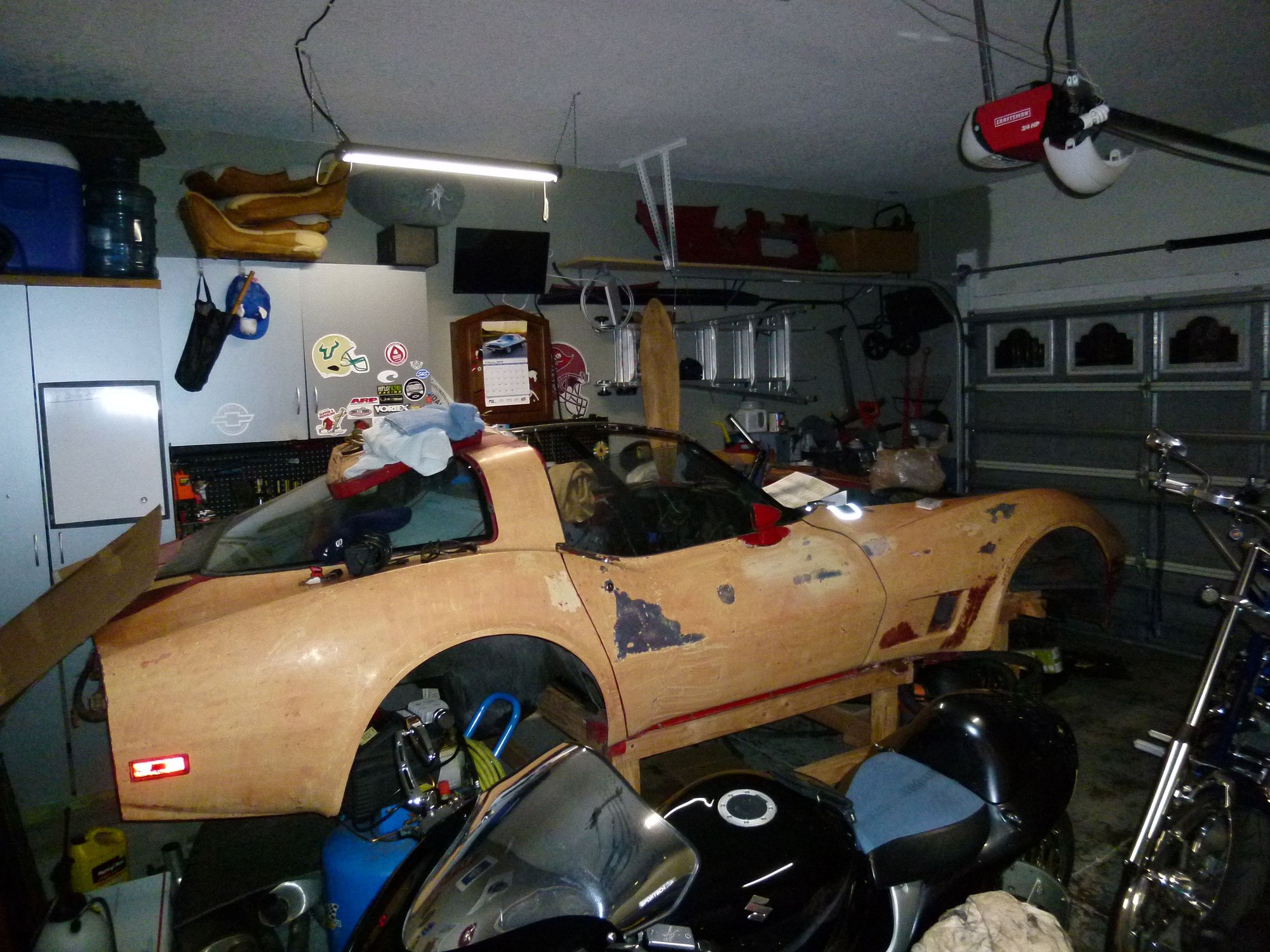

Engine is mounted in the frame, I'm working on finding a set of headers that will work with my angled plug heads. Started scraping the old paint from the body, welded the right side floor pan in along with the #2 right body mount. The ac compressor mount is missing so I've been checking the scrap yards around here in hopes of locating one. Small steps...
Body by razor, pulled the bikes from storage for Daytona bike week in a few days so the garage is tight at the moment.
Small steps and a little sweat equity.

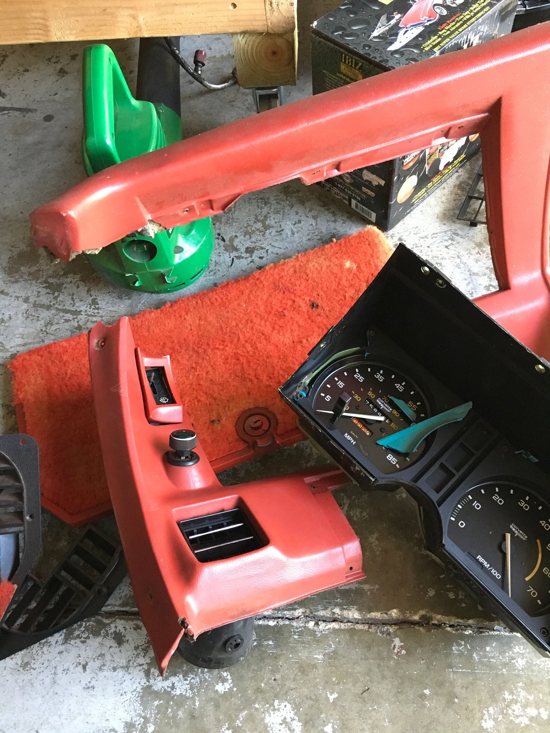

Thanks for the headers Pete, should work out splendid. On another note, got home last night and my parts shelf had fallen off the wall damaging my speedo/tach cluster and cracking my dash into two pieces. Now I need to figure out how to repair or spend money; just a little bit frustrated

Oh, that sucks so hard. Sorry to hear about your mishap, and on that super nice cinnamon interior!

As as for the dash, maybe do a repair with some plastic weld and then cover it in leather!

I figured I could repair as best as possible and glue a dash cap to it. Found a black one for $105 plus shipping. Actually more concerned with the cluster bezel but will see if good glue helps on that.

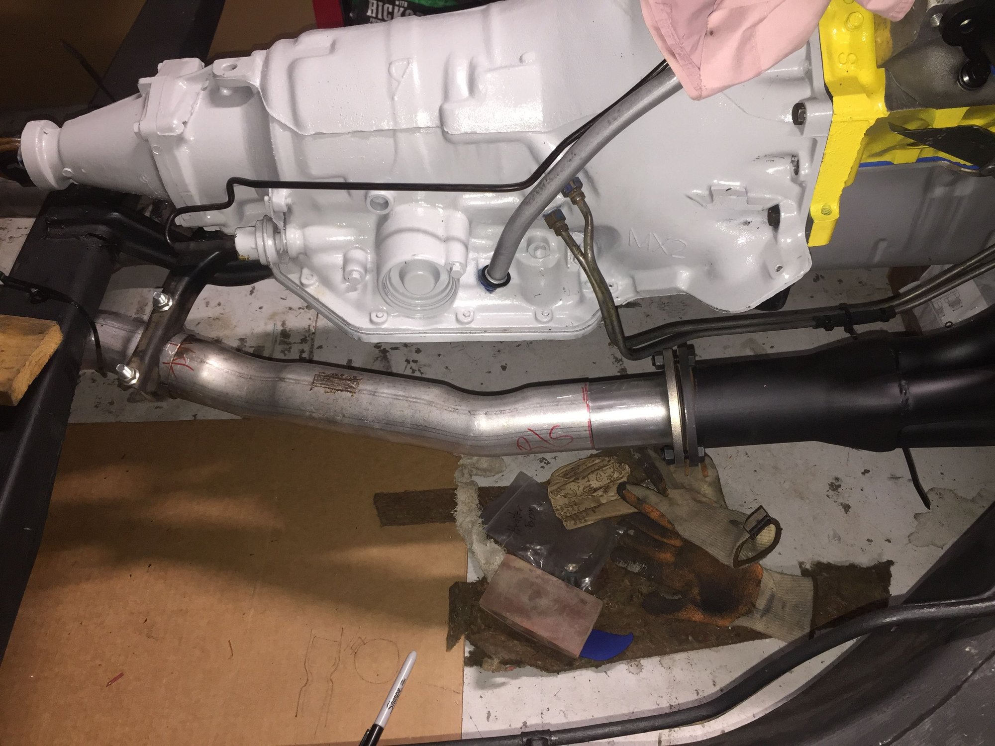

Default Exhaust mock up

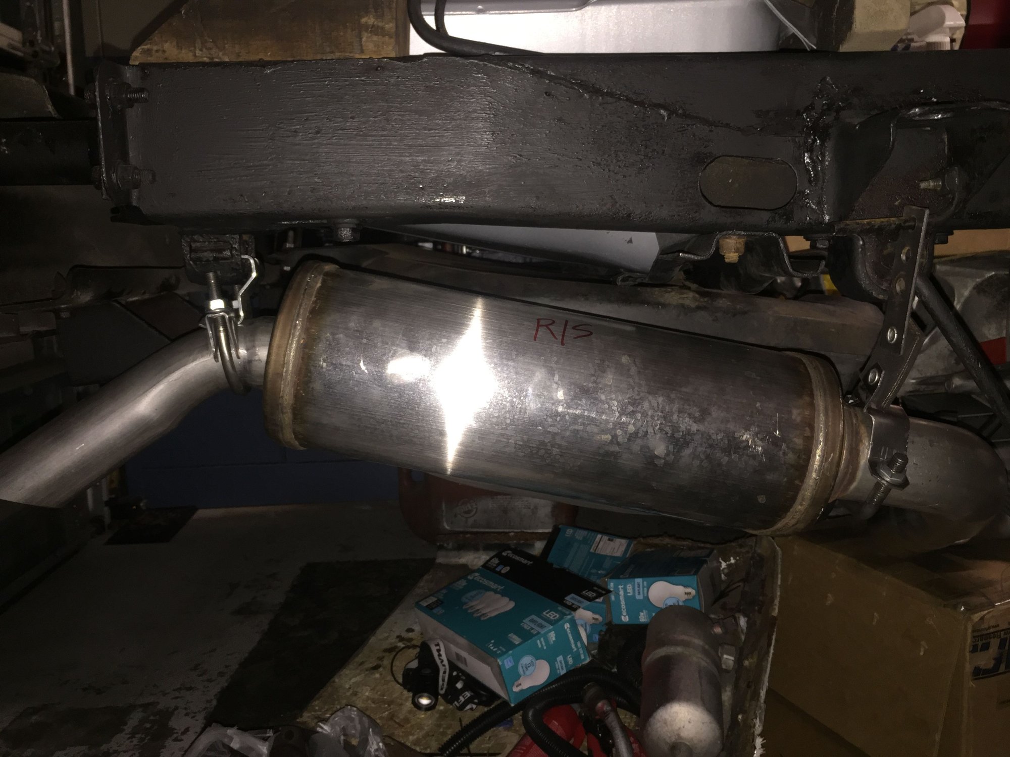

Started on the exhaust this week and so far I’ve hung the right side and may be ready to weld in on Thursday. The driver side is in but not yet tweaked for welding.

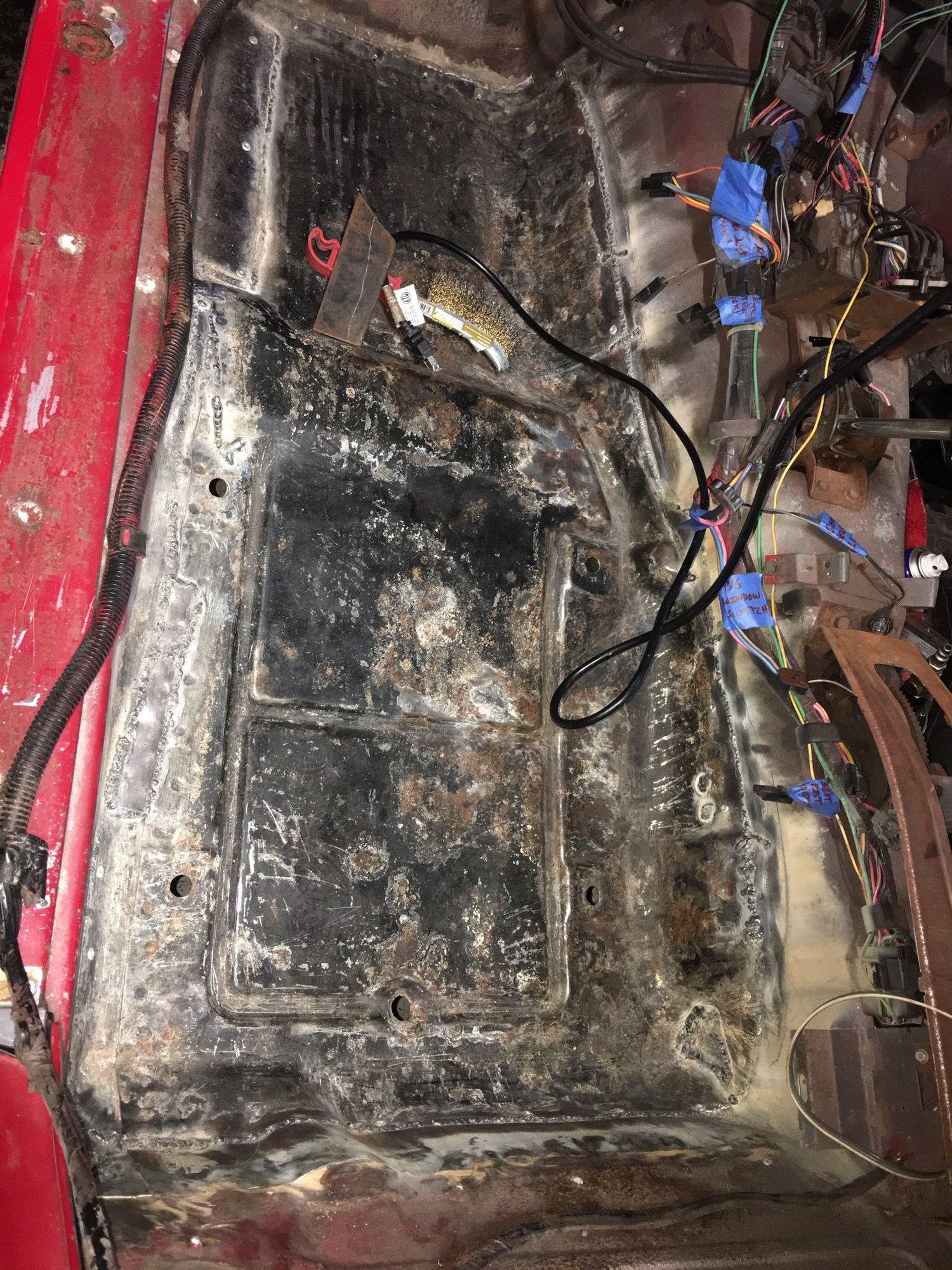

Default Weld Work

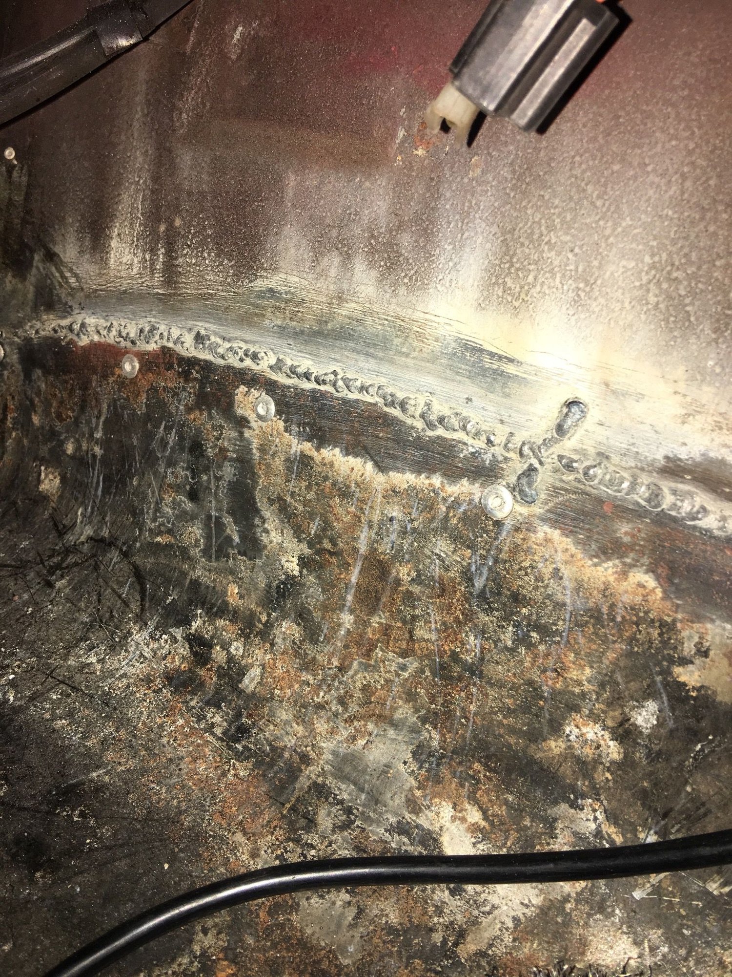

Spent the day welding in and fabricating pieces on the driver side floor after cutting out the whole rusted through sheet metal. Got used floors from the scrap yard several months ago and finally at the point to get this done now. Exhaust is in completed today. Now to get into some body work and paint. Toying with painting it myself with neighbors help.

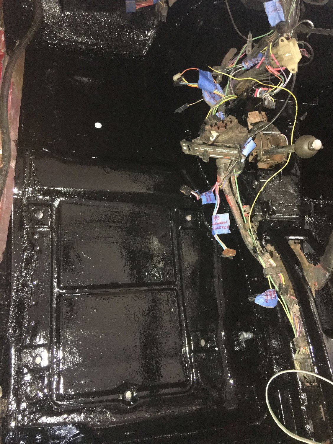

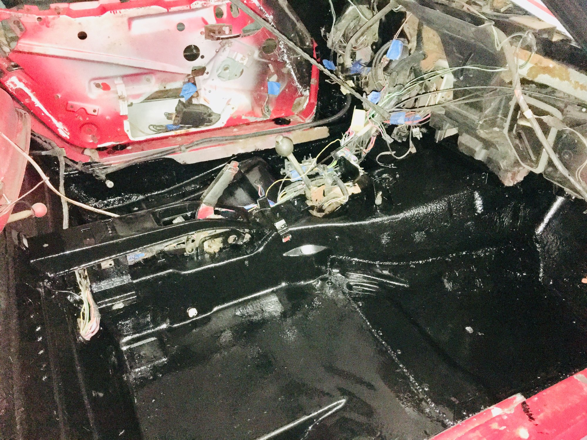

Cleaned, treated and painted with POR15;
