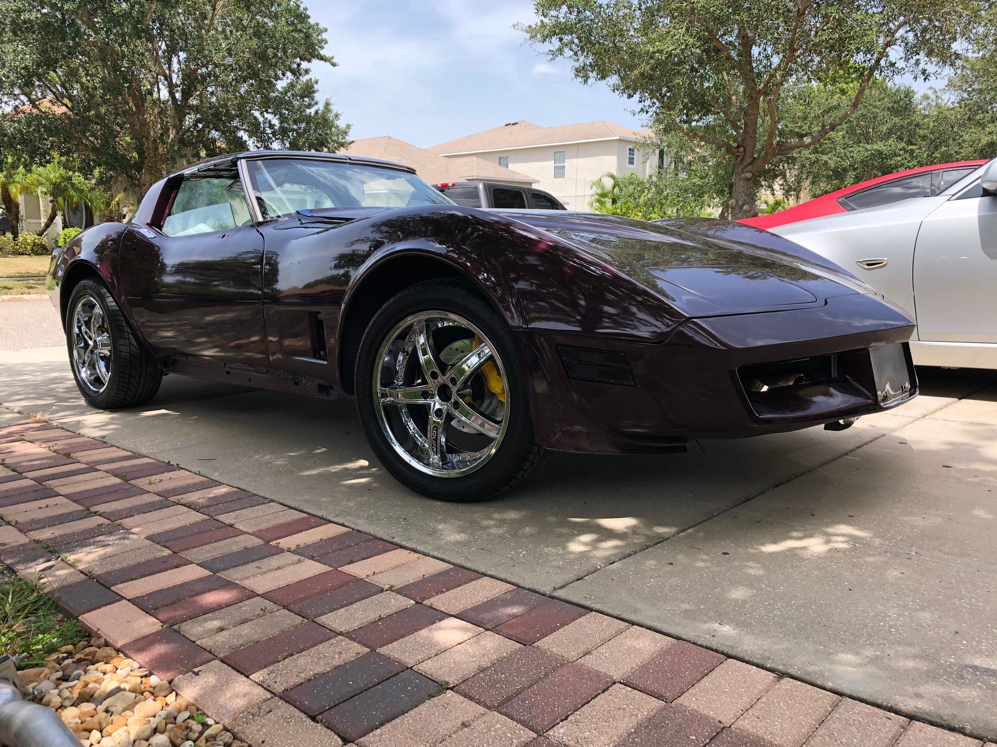

Wheels aren’t too bad, wish they were staggered but got a great deal on new wheels and tires that someone didn’t want to make work on their own project. Still need to run the buffer again and all the small stuff that adds up but coming along slowly.
Just got the wheels on yesterday
The hanging wire is my rear view camera. Waiting on my head unit to complete.

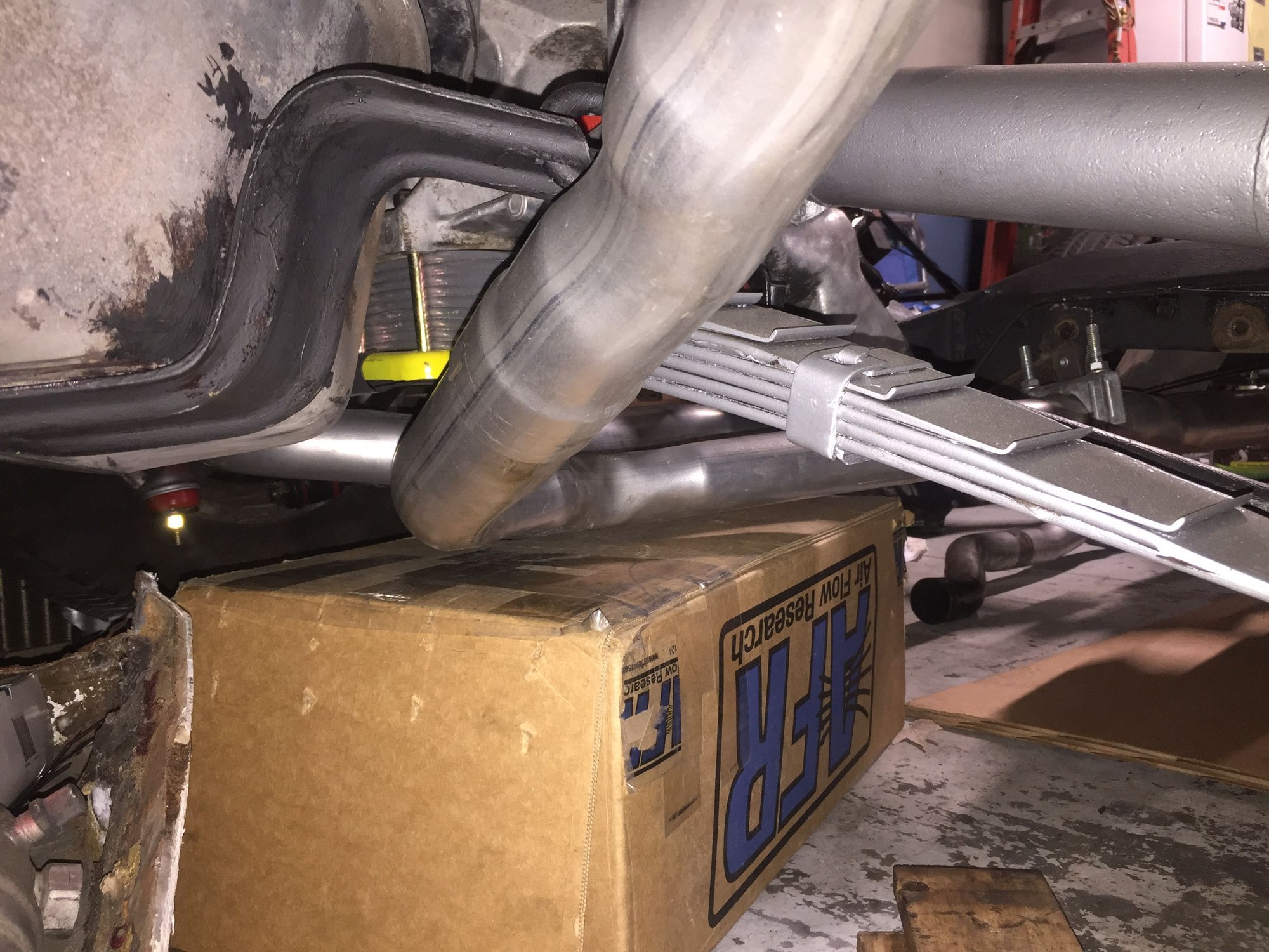

Started on the exhaust this week and so far I’ve hung the right side and may be ready to weld in on Thursday. The driver side is in but not yet tweaked for welding.
Is that a shipping clamp on your spring? If so, I thought it was supposed to be removed (if you haven't already) to allow proper movement of the leaves while driving?

[QUOTE=nwav8tor;1601919909]Is that a shipping clamp on your spring? If so, I thought it was supposed to be removed (if you haven't already) to allow proper movement of the leaves while driving?
Anyway, nice thread and great job. It's looking good but will look even better when you're driving it!
Paul, I’m not sure about that, this is the same spring that was on the car when purchased, only cleaned and painted. I’ll have to look into that to verify if it needs to be removed or not. Do you have the same spring setup?

My car is a '71 but has a similar 9-leaf transverse rear spring like yours. Mine did not have those clamps when I removed it from the car for rebuilding...
Paul

The question about the spring clamp got me wondering today so I took look under my 80 , Yep, there was the clamps . 40,000 miles on the car so it's original. never heard of removing the clamps , most if not all older spring leaf cars have them.
Thanks for the information. I decided to go to the local cruise show this week and check out a few of the other c3’s rear suspension. This is my first Corvette so I am not sure if the clamp is on or off but I won’t remove it unless it has to be.

Gman, I believe '63-'77 used 2-1/4" wide leafs, but the 78-82 went to 2-1/2" width. From many sources I've seen, the earlier installations did not have clamps on the springs as shown in the links below:
http://www.superchevy.com/how-to/cha...ear-suspension See photos 3/41, 5/41, 19/41 & 21/41
https://www.corvetteforum.com/forums...p-by-step.html See Alan's pics in posts 3 & 10
https://www.corvetteforum.com/forums...lp-needed.html See Alan's comment in Post #12
I'm not sure if things changed in 78 when the use of wider leafs began that would effect your '81 situation, but I can't see why it would've...
Not an expert, just MHO
Paul

Originally Posted by nwav8tor
Gman, I believe '63-'77 used 2-1/4" wide leafs, but the 78-82 went to 2-12" width. From many sources I've seen, the earlier installations did not have clamps on the springs as shown in the links below:
Paul
Thanks Paul, I’ve been looking into this and have seen some with and some w/o. I have not taken my clamps off at this point until I am sure that they need to be removed. Seems like it’s the original spring with 75k on the clock so I will do my due diligence before I regret it. I plan to go to the local cruise show this week and check out a few if any show up. I don’t see a lot of c3 Vettes around but a few are usually at the local shows. I appreciate your input and examples. Thanks

They sure sell a lot of replacements on E-Bay for something some people say that they should be removed and thrown away.
Ill keep mine until I can verify whether it’s on or off. I am curious to find out though...
