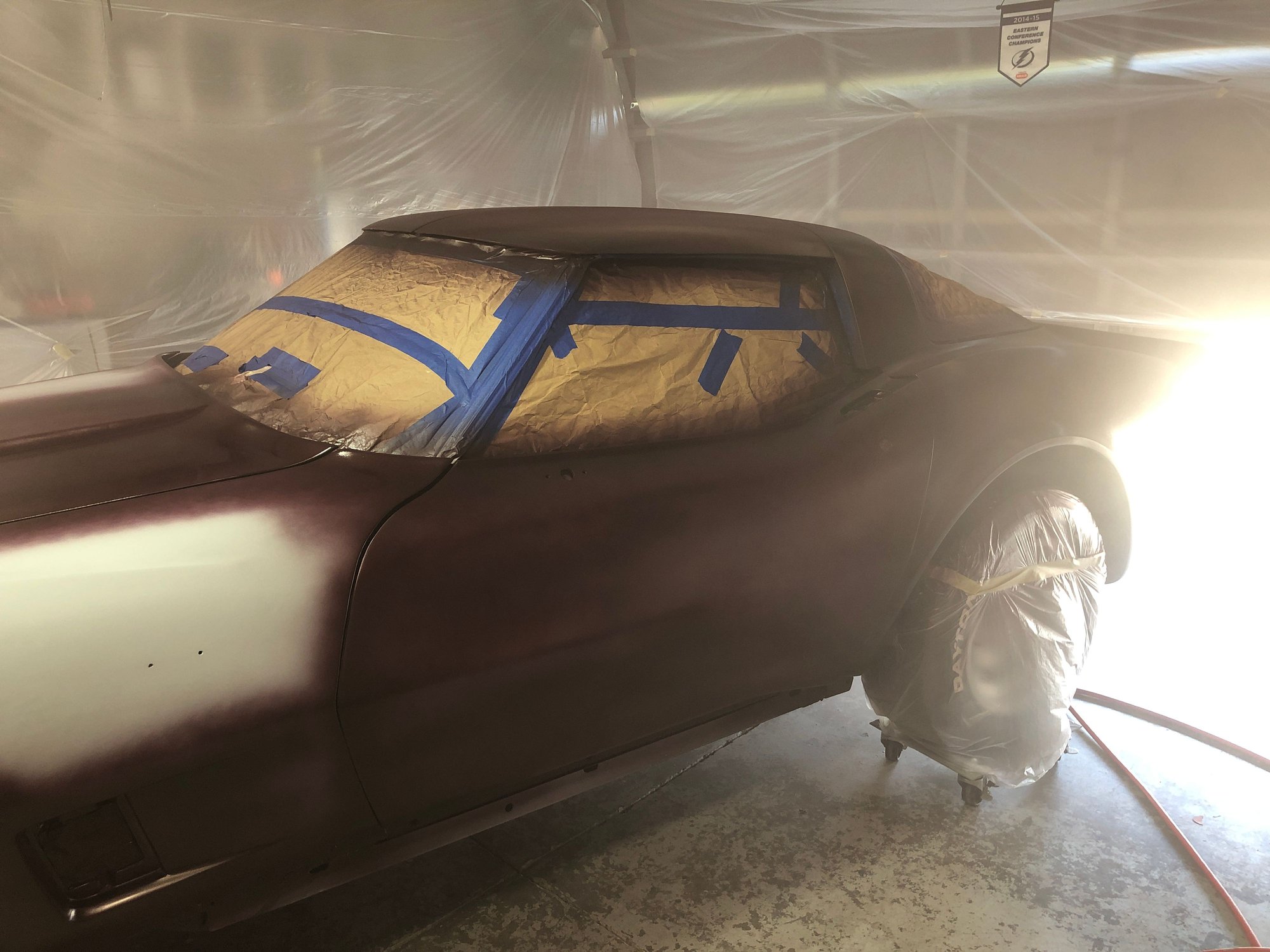

A few hours on Saturday morning last week, no complaints from the neighbors all done inside my garage.

I used a Upol primer and PPG’s Shop Line Paint products. One of my suppliers on the job use to do body and paint work and we talked for awhile and decided to go that route, (I’ve never done this before so all new to me).

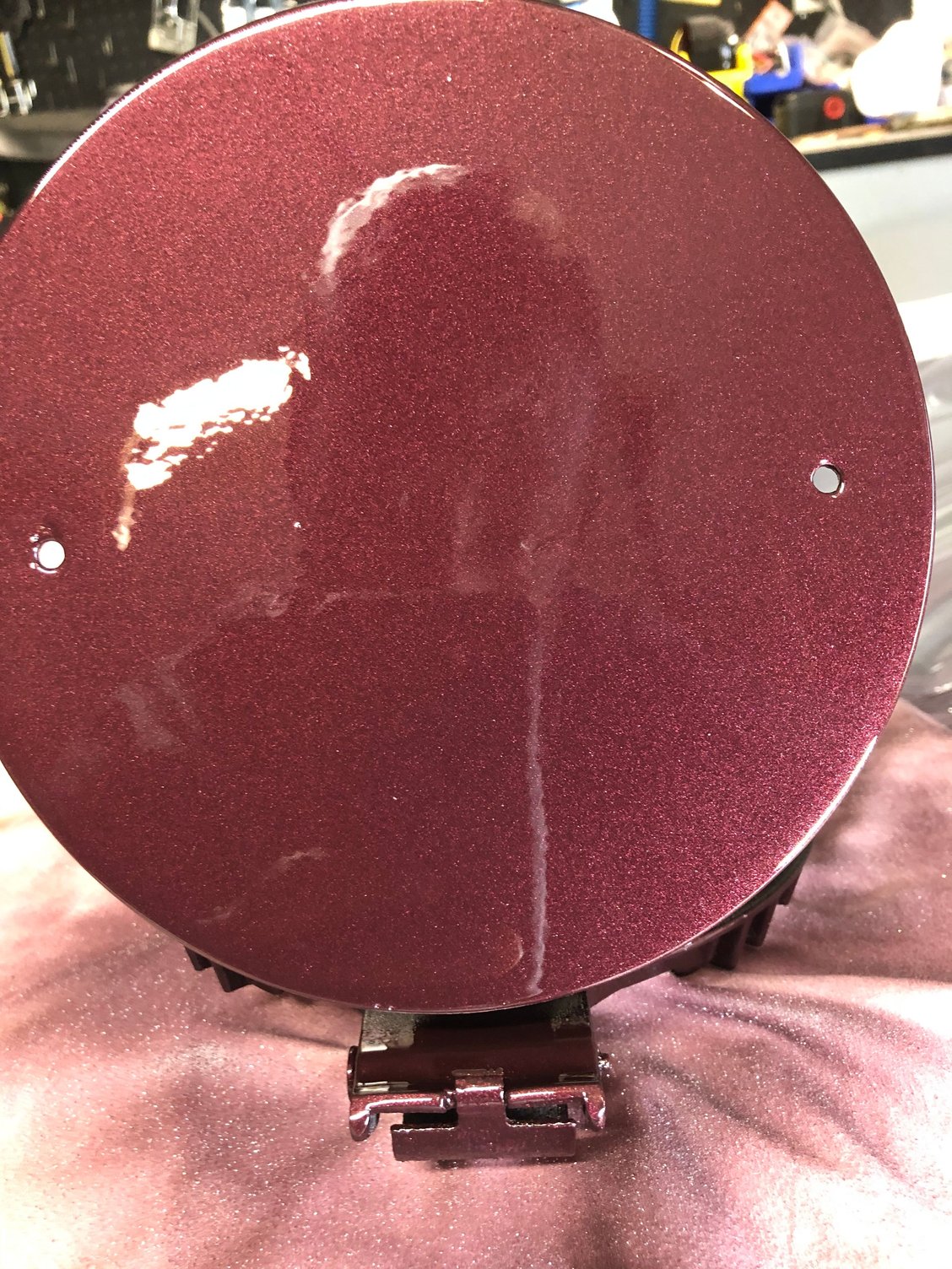

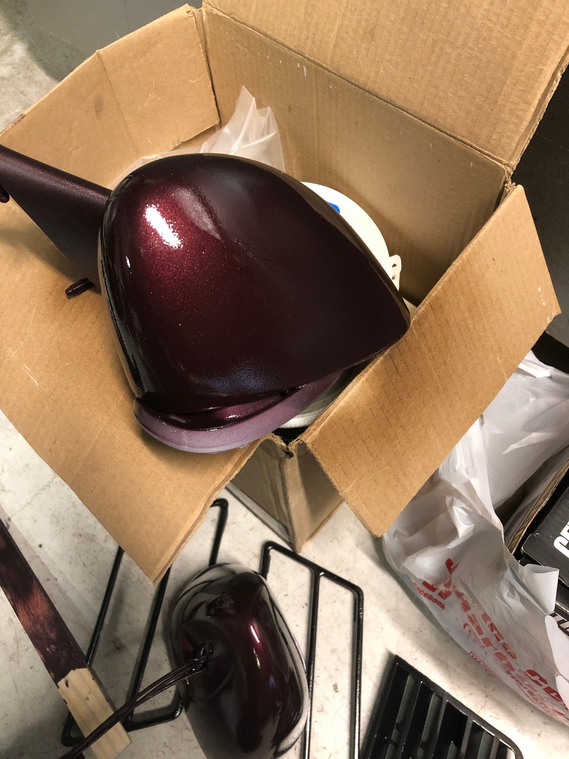

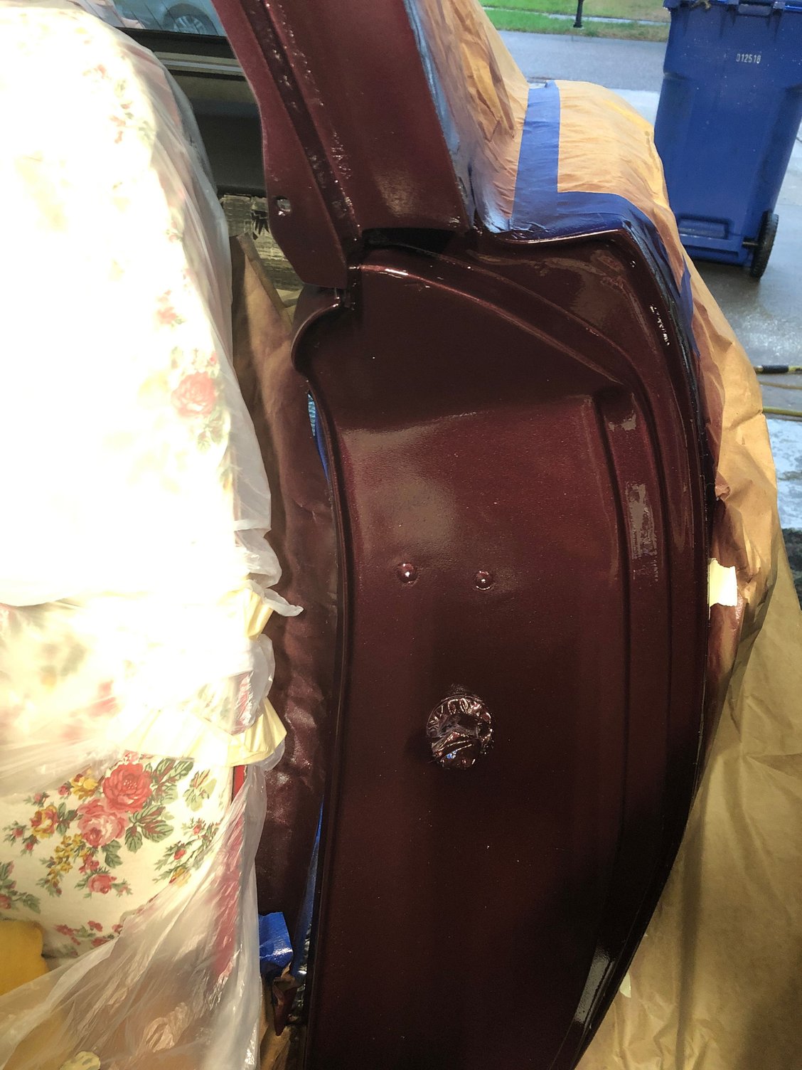

Got the door jams, hood edges, t-top water line and fuel door painted and cleared this weekend. Interior panels are also body color but a little less on the clear coat, (did not want those pieces to be too shiny). Plan is to sand all edges with 1000 grit and paint the body next weekend. Had some dust issues but I am told that will happen no matter what. I’ve asked someone to cut and buff for me because I’m to chicken to try it, lol.
? Base Coat-Clear Coat or ? ....

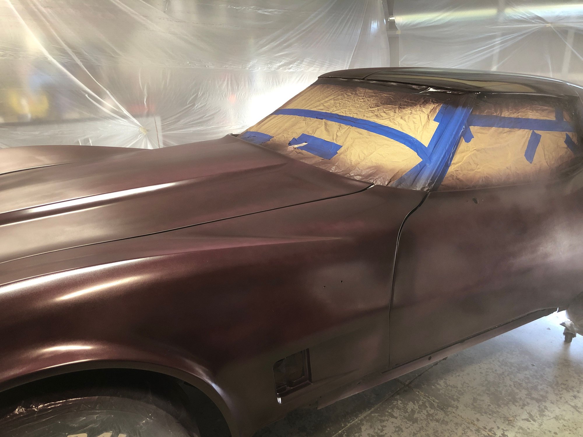

Yes sir. Three coats of base and three of clear. I went a little heavier on the hood edges and fuel door. I have almost two gallons of paint with the 1/1 ratio so will try to get four coats on the body if it stretches but three full coats would be great.

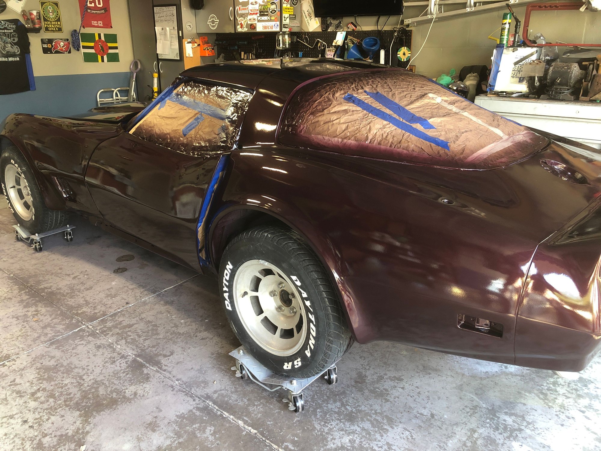

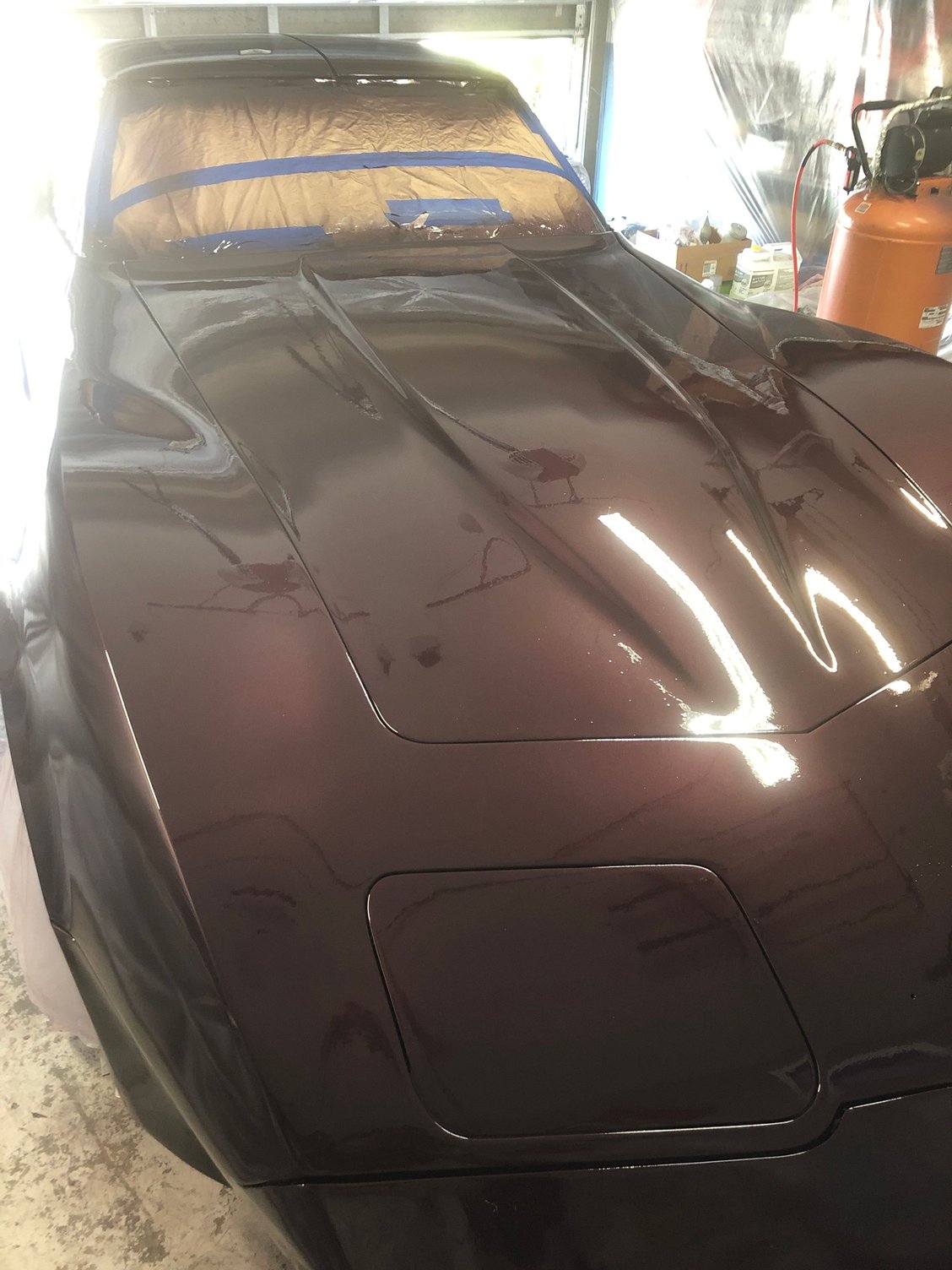

Default Got some painting done today
Love the color and should be better after sand and buff next weekend. Had some issues with the water from the compressor but got through it thanks to my buddy Z. Not bad for a job done in a cave, (my garage).
Old May 31, 2020 | 10:07 AM
  #117
jackson's Avatar
jackson
Joined: Sep 2001
Posts: 7,739
Likes: 630
From: Unreconstructed, South Carolina
cave man
looking forward to sunny, post-buff pics

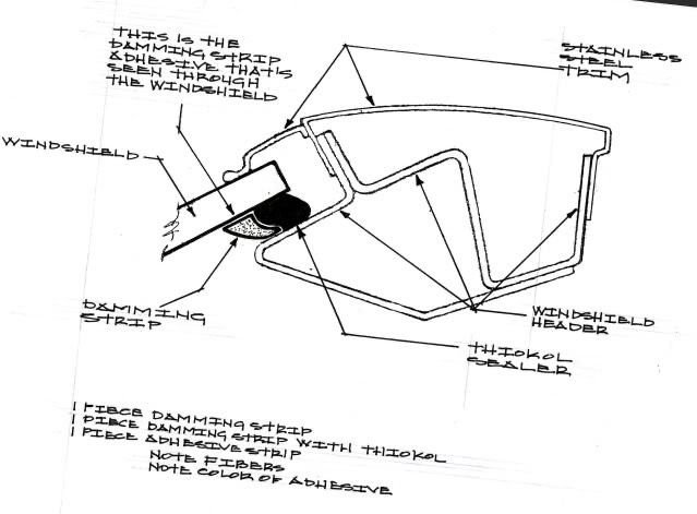

Getting ready to install the SS T trim and windshield trim pieces. I’m not sure if the T trim goes behind the trim clips or inside the clips along with the windshield trim. Can’t seem to find any good pics or videos in my searching.
