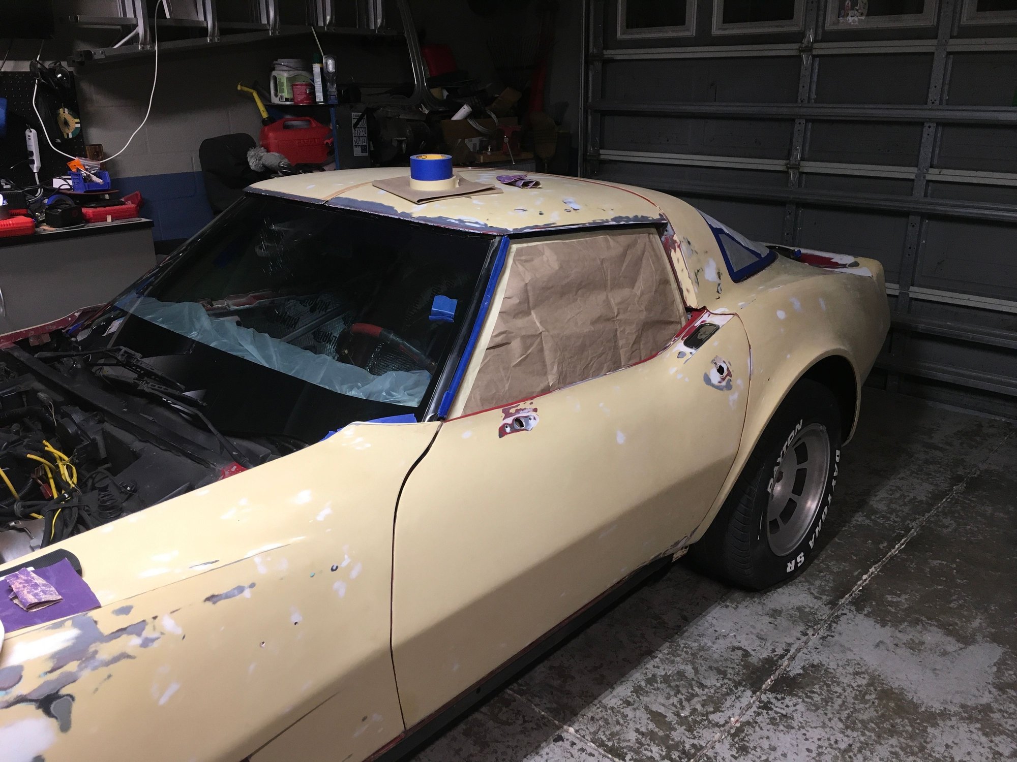

Been awhile since I posted here but have been busy with so much going on. Decided to paint the car myself and have an ex body shop painter to oversee some of my work and give feedback. Planning to prime this weekend and paint the following if weather holds up. Then we will clean up and paint interior panels and get them installed. Still a few months from being done but it’s looking like we could be driving by summer.

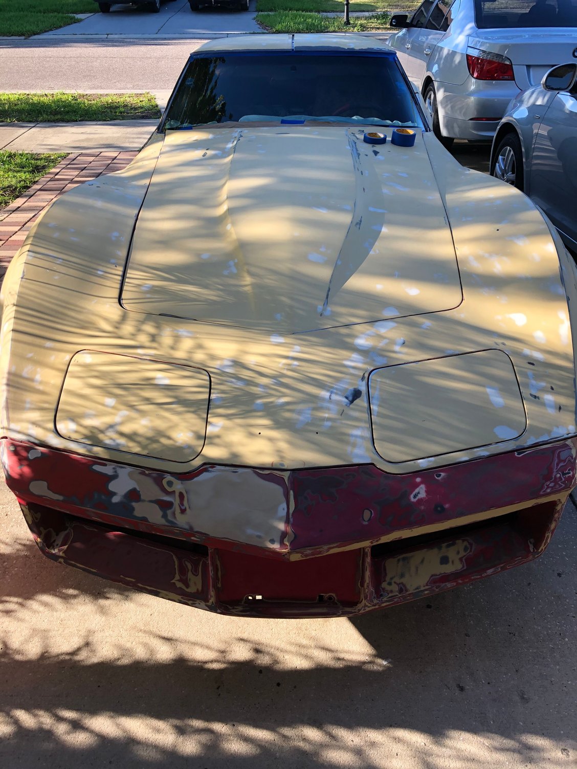

I’ll try to take pics as I go and post them up each day. Spent a lot of time with sandpaper and body filler to repair all the nicks from razor blade paint removal. Got everything taped up except for the windshield and wheels, I’ll be getting rid of the wheels for 18’s if all goes well.

Well, it’s been raining since yesterday so prime is put off for another week. Last night I rebuilt my headlight actuators and will recheck and fix any body issues while getting the cab area masked off since I’m also painting jams. Started looking for 18” wheels also...

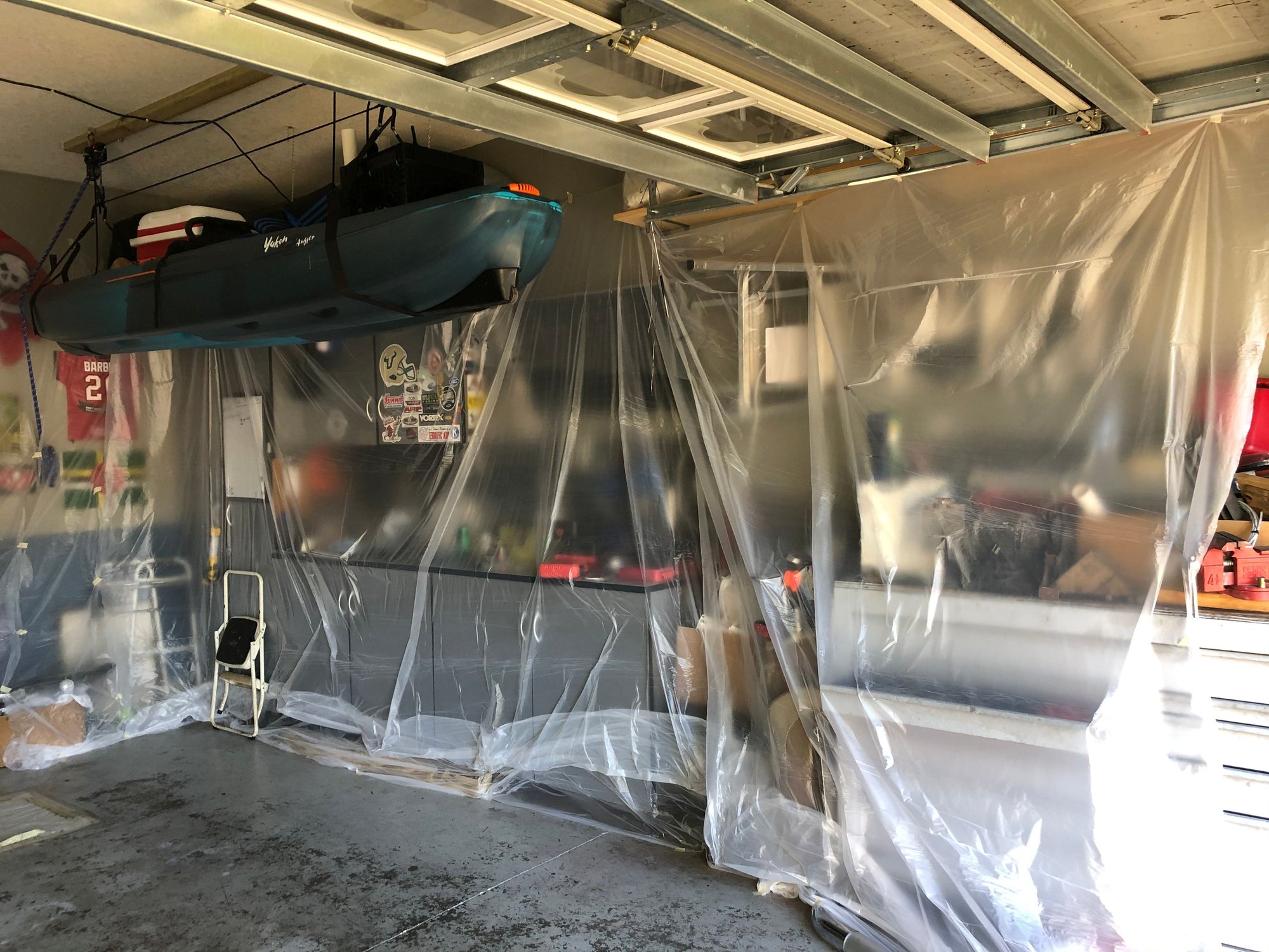

Primer Time? If all goes well in the morning we will start on bringing out the beauty of this beast. I’ve got the plastic sheeting on the walls mainly to protect my stuff in the garage. When I paint though I’ll also cover the ceiling and garage door.

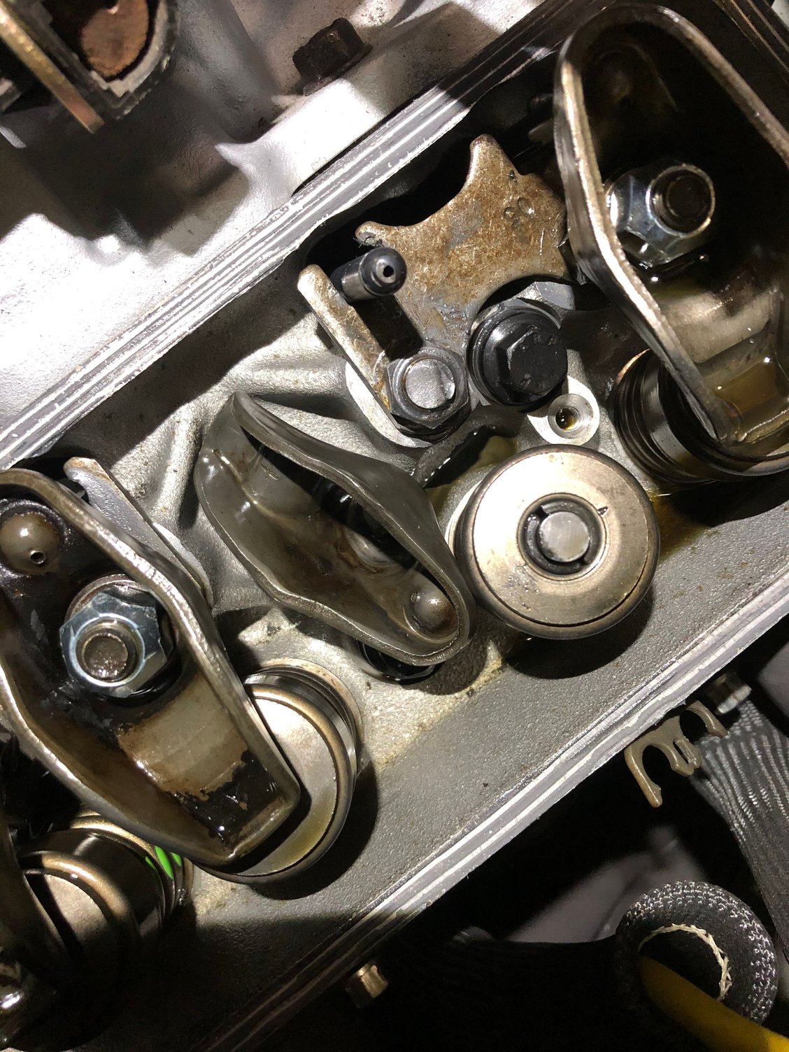

Heard a ticking/pinging type sound and pulled the valve covers😭🙏🏽😠😡. Have to push paint back to get engine right. Push rods wore into the rod guide plates a bit. Just can’t figure out why the rockers moved off center. I guess valve adjustments were too loose.
Gonna take a stab at it.
Those are 113 L98 heads. Some L98 came OE with a so-called guide plate BUT also w/ self-guided aka self-aligning aka rail-type rockers ... those appear Not.
The so-called OE guide plates were an anomaly ... they were installed on heads to aide engine assembly ...Not to guide PRs when running ... that's what the rail rockers were for. Those plates look like the slots may be too wide to properly guide PRs when running.
Perhaps yours has the OE fake guide plates and you're running plain rockers? If so, get some rail rockers and maybe that solves it.

Thanks Jackson, good to know. Yes, the heads are later model Chevy purchased from the machine shop I used in Ybor City, FL. I may not be going back there for various reasons. I will look into the rail rockers and see what I can find out. The rockers seemed to be a little askew, running off to one side. Thanks for the info.

Jackson, any thoughts on rockers arms needed? Roller or not? It’s a mild cam with 1.5 rockers. I guess I could use them with proper guide plates and hardened push rods.
Dunno if your PRs are OK or been scarred up.
Yup, you could get some real plates & use your stamped rockers ... or ... my preference
you could get some stamped self-guide rockers like those that were OE in virtually every sbc since mid-eighties.
-add-
and, for this ... No roller, No roller-tip
The cryo-treated Elgin Black Ice are Very good.
https://www.elginind.com/wp-ckcontent/uploads/2018/12/Elgin-BlackIce-4pg-2018-ProStock-Insert-Brochure.pdf
for yours:
ICE410737 (stock 1.5:1 rar, long slot, guide rails) ... they come eight per pack so be sure you get sixteen
sixteen = $120 delivered ... maybe cheaper elsewhere dunno ?
https://www.ebay.com/itm/Elgin-BLACK...sAAOSwfjZdL5KP

Thank you again Jackson. You were on point with the SA rockers, even my so called machinist was no help. I will place order tonight. PR’s are fine but I will check each for straightness. Also need to replace one rocker stud. Should be good to go after that. Thanks

don't recall if those L98 heads' studs go into water or not ... maybe sealant ... if threads are deep enough, with SA you can dump the fake plates. hope that gets ya going again.
I've no doubt the machinist knows lotsa stuff I don't

I will thread seal the studs when reassembling. Going to replace all the studs also. Thanks
