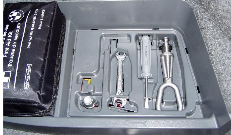

I'd feel a lot more comfortable w/ a tow hook when winching the car into / on a trailer!!!
I too am looking for a solution-
for the rear-
these two look like great options- one for spring other for coilovers-
And for the front-
Really like "'Ignatz" idea
However- I was going to use a removable "hook" that comes in the trunk of just about every BMW. A little longer than the aftermarket ones- so I'm hoping I can just screw it THROUGH the grill and it stays hidden when not in use.
