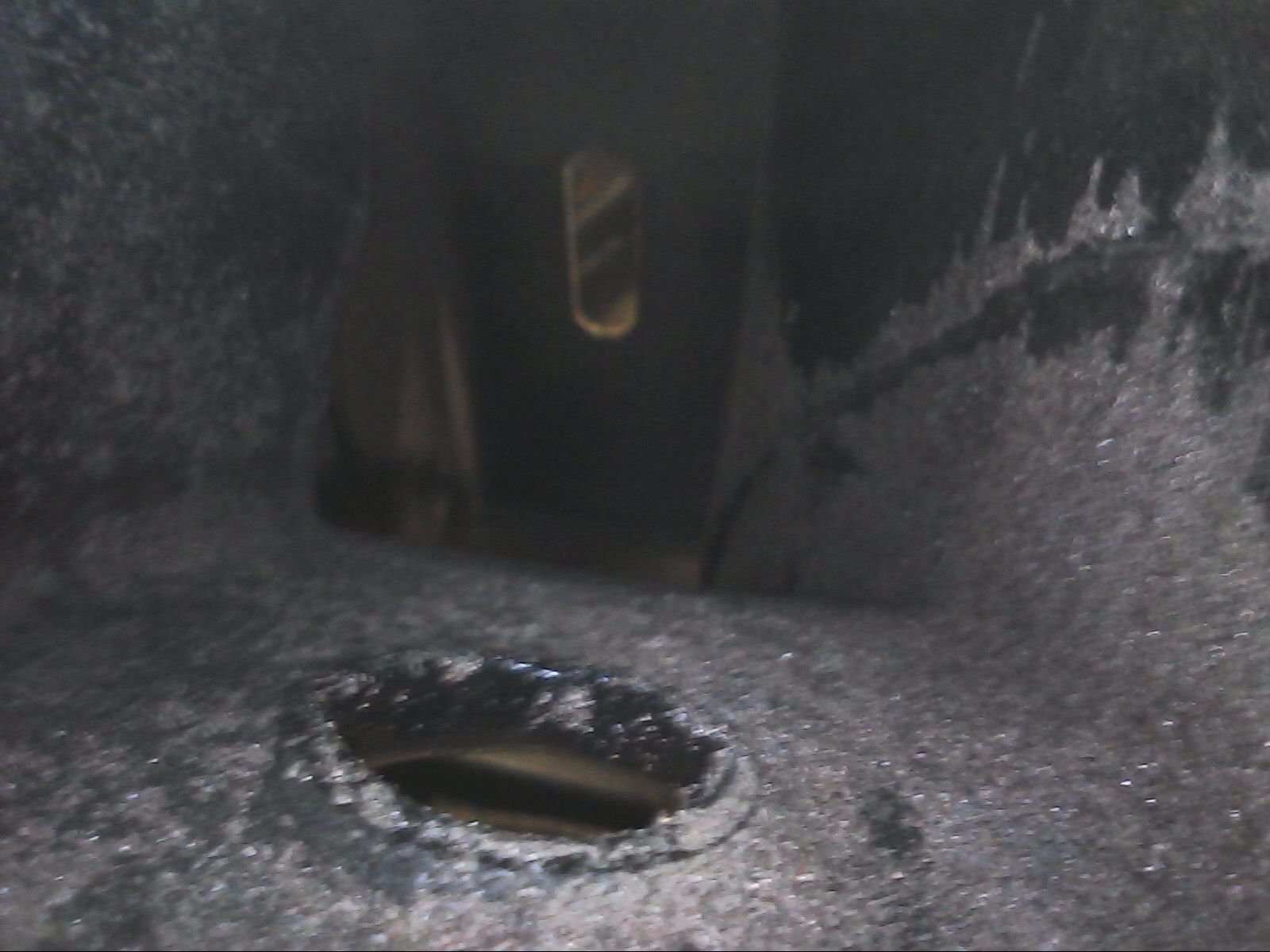

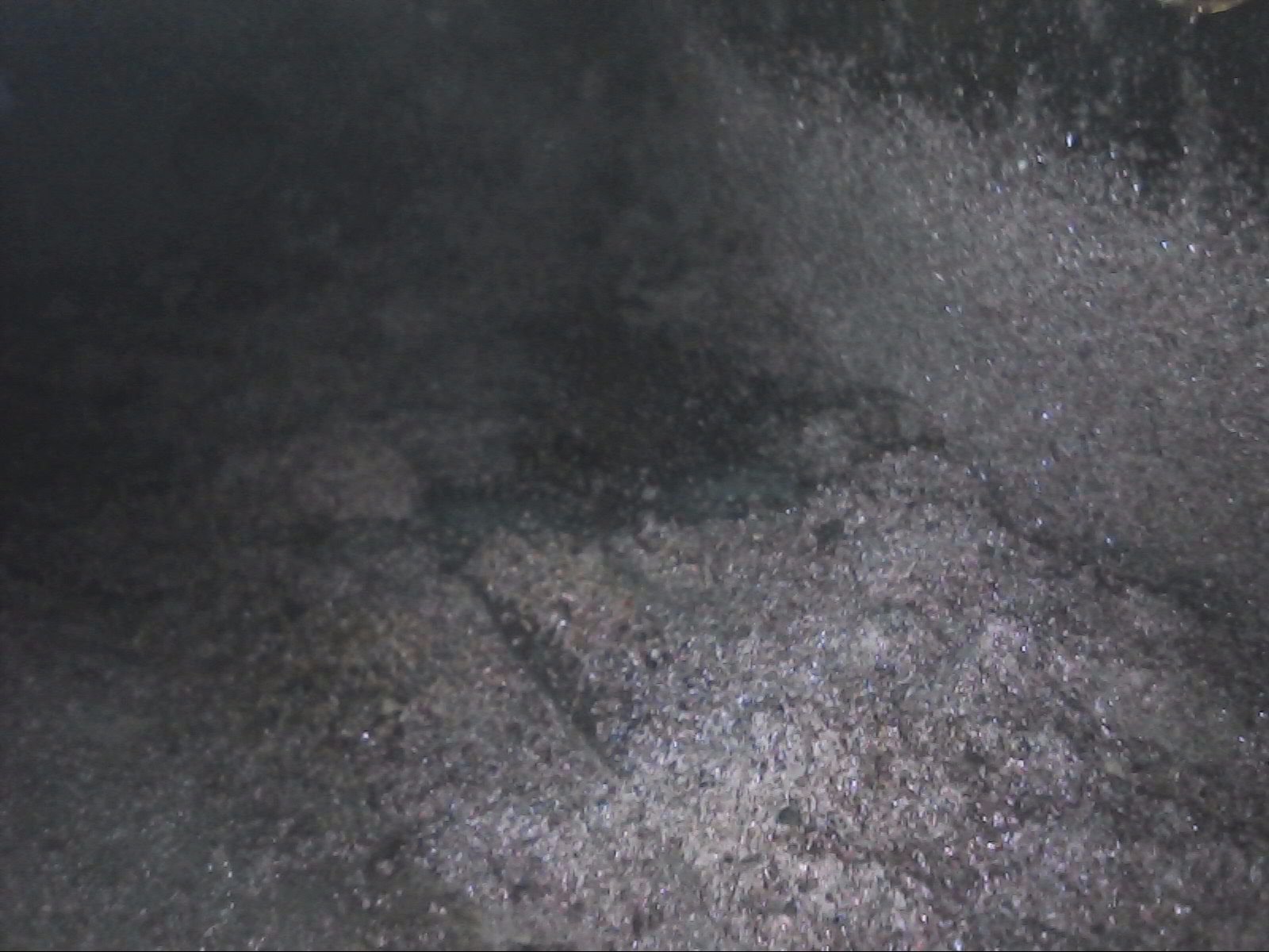

Tried out the cheapo endoscope tonight. Not too bad for $25
The following pics hopefully give an idea of what the inside looks like (Second, Fourth, and Sixth pics attempt to show the hole the camera went into). Also, in pics 3 and 5 I think I see the internal structure or walls that DUB mentioned earlier.
Since the wax seems to be holding the media, what would be the best action to take at this point?
Thanks again andHappy New Year all!! ,
Tod
