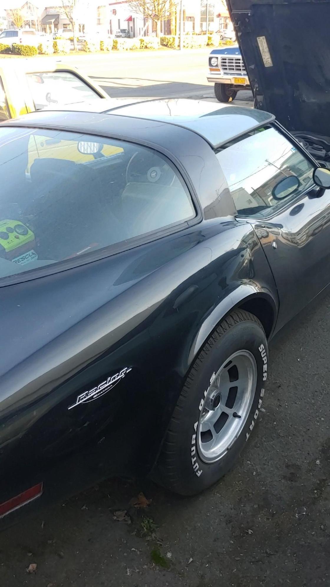

I had my brother look at it for me. If it's worth it he'll be doing the purchase on my behalf as I won't be home till MAR. It is an 81 but listed as an 82. Go figure. The headlights don't flip up but that might have something to do with the vacuum leak, missing vacuum line, open vacuum ports. It was too filthy to drive (sitting at a dealership) so I don't know if the suspension, trans, etc is OK. The car did start up cold, supposedly had the motor gone through (although missing vacuum lines doesn't sit well with me). The trans was rebuilt and has new exhaust. The interior needs a lot of TLC. It was repainted and needs to be polished and waxed. My Brother says it's in decent shape. the T-top seals and the rest of the rubber is new or in good shape. My brother says a tune up is all the engine needs. No issues there. Here are a few pics, any suggestions?

This 1981 car is falsely classified as a 1982-

I'd personally pass on this car. There is a lot of crud on the inside and this C3 had sat outside a long time. Long enough that the water flow created a pattern in the paint by the right front turn signal and down the door, from dripping off the passenger side mirror. The dealer or seller polished the front fender, but didn't do the lower part and that's where I see the water wear pattern. C3's are notorious for bird cage rust and they don't do well sitting outside for long periods of time. A lot of paint chips around the hood and lights too. The engine might have been gone through, but that was a long, long time ago, from the looks of it. It does have an Edelbrock manifold (you can see the American flag underneath the air cleaner, but it has a stock Delco HEI and who knows what carb is sitting on top? You're going to end up dumping a whole lot of dough into this '81, like the entire interior for starts. Take a look at what a new interior will cost you.
If you have to have AC, the later C3's, certainly had them a lot more often (correct me if I'm wrong here), than the earlier C3's. You might wait to get back and include in your search a '73 to '77 with an L82 or a built L48 and a four speed. The stick shift cars always bring a little more money and they are a lot of fun to drive as well. Just my .02 and thanks for reading.
PS: The plastic 'Racing' logos pasted all over the car, are a pretty good indicator of a juvenile mindset, because those are totally tacky on a Corvette. This car when it was driven, was probably flogged hard, to keep up with the 'racing' image, the owner tried so hard to project.
