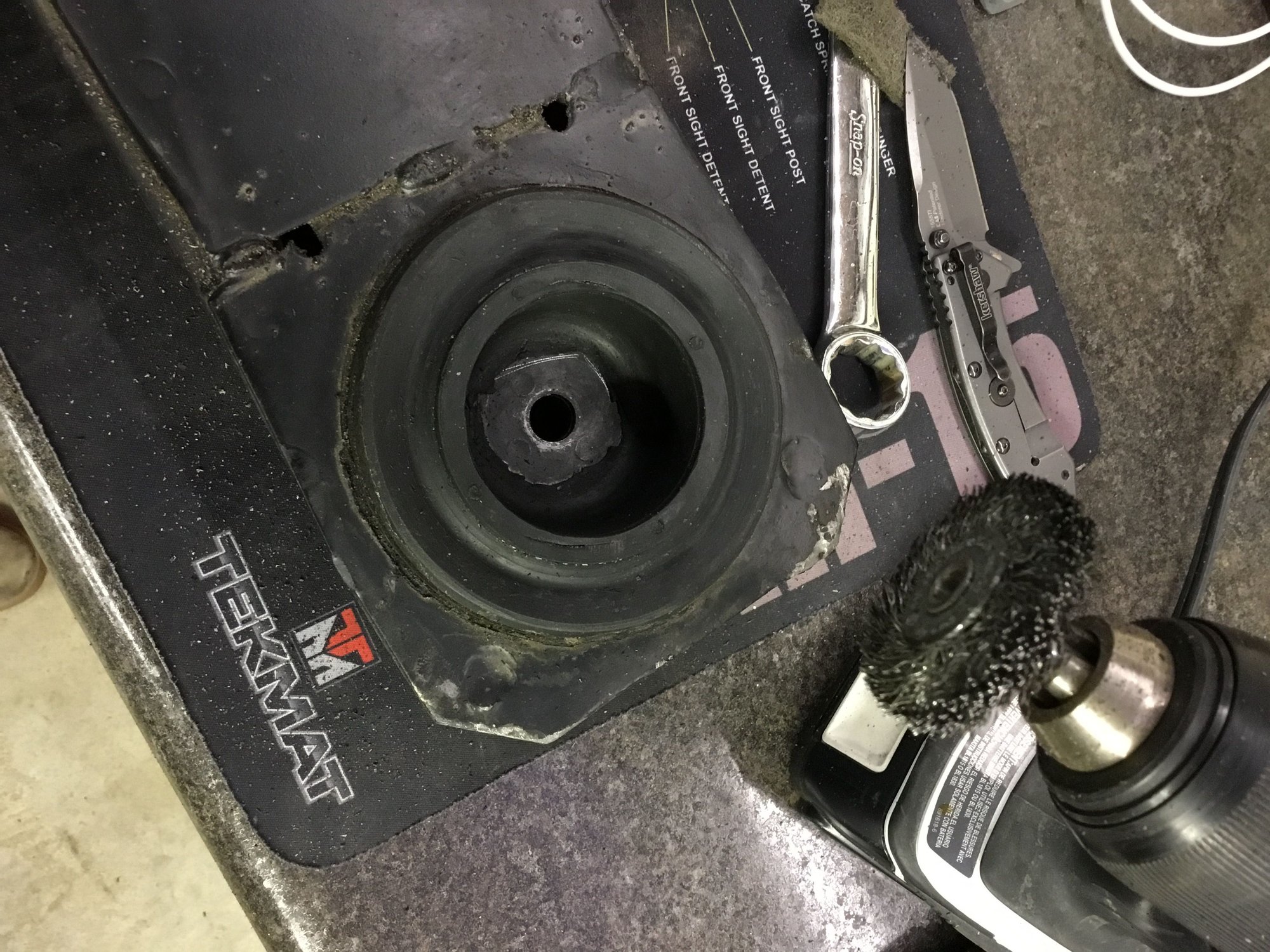

Just got done wire wheeling the cushions getting all the dried grease residue outta there. These cushions basically have zero miles on them. I replaced them awhile back when I swapped out the diff cover for the heavy duty one. I wasn’t comfortable with the gap since I had zero the last time I had the crossmember out (old cushions). Was just checking it again to make sure all was cool.
There is basically .008 to .010 difference between the cushion ID and the hat OD, that’s not much.
Gonna wire wheel everything
some more and then try another fit.
I’m A little bit more at ease hearing others says that they have seen gaps. I just have visions of the crossmember dropping during a drive.

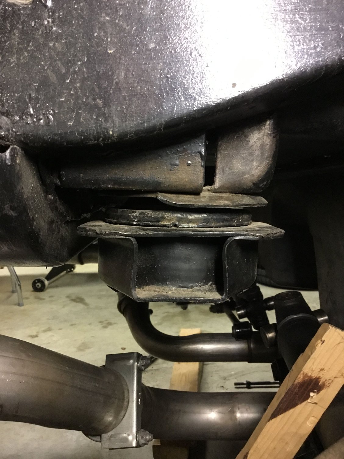

I guess my 50 year old cushions were wore out!
still have about a 1/4” gap both sides.
‘Guess i’ll mount everything back up, drive it for awhile and re-torque
you can see the cushion is up against the top of the hat
I'm pretty certain you'll be fine. Just check them after driving a bit.

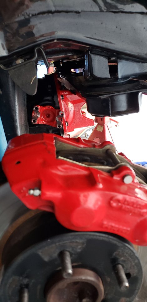

Did mine 2 years ago. This pick is from today. (Poly bushings I used fell apart and now I can't get shock mounts out.)
