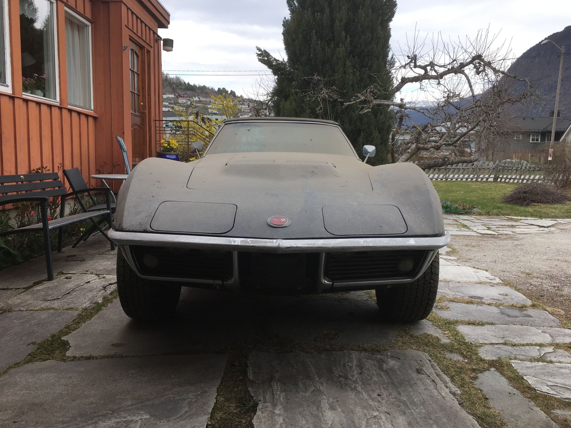

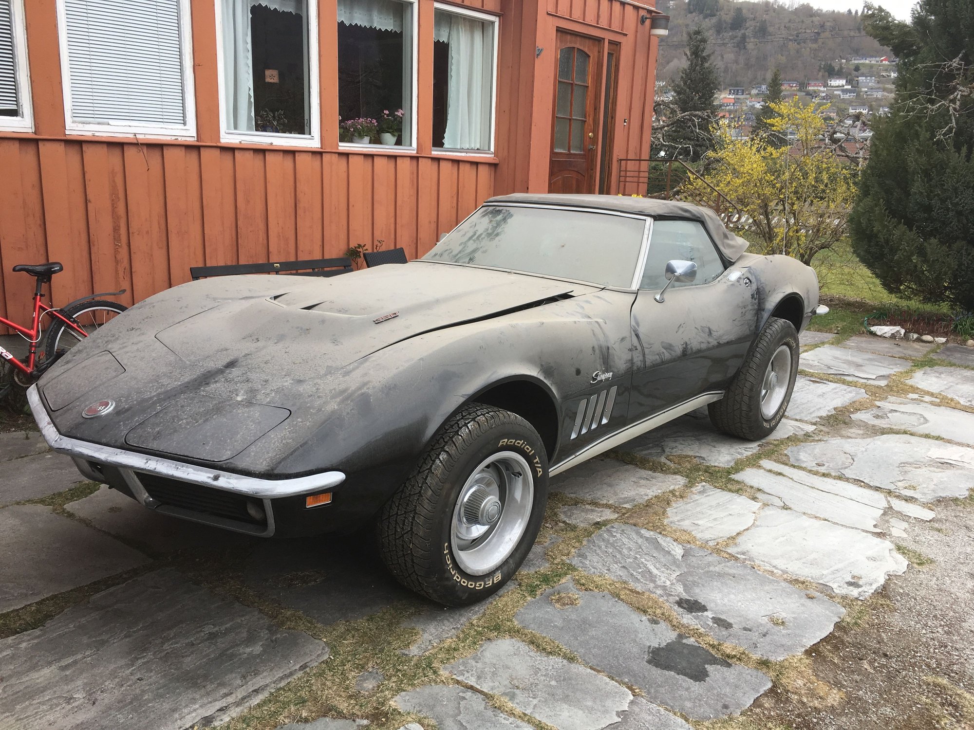

Me and my dad got his 68 vette out of the garage. It has been sitting for 24 years now and I am so excited to start this project. Does anyone have some tips on how to clean the vinyl roof?

I'd start with a soft bristle brush. She's sitting awfully high.

Soap and water to start. Do not use anything abrasive on the rear window. Clip down the rear bow before you wash the top.
ok thanks. Do you know why it is so high? It has no engine in it and it stood on stands for the past 24 years

I use a soft bristle brush and SIMPLE GREEN. Then terry cloth towel. NOVUS on the rear window.
I have a 69 Convert....Gives me a heart stopping moment everytime I see something like this....love all over again!
Good luck.
Not so sure of the big block hood and the 350 emblem on a 327 car! Let alone the 69 STINGRAY emblem on a NON-STINGRAY 68... What happened to the cross flags on the nose....(UGH!) (Hits me as a bit tacky). But to each his own.
Good luck.
Unkahal
I know that the car is all wrong in that way. The previus owner messed it up with different emblems. It had a 427, then he changed it to a 350 therfore the bb hood with a sb engine
No engine will certainly have the front end riding higher but the rear is probably the rear spring. Being on stands for years and (assuming) the original steel spring, they’re probably held up by rust. Driving it will likely settle the rear down, as will putting on a new spring.

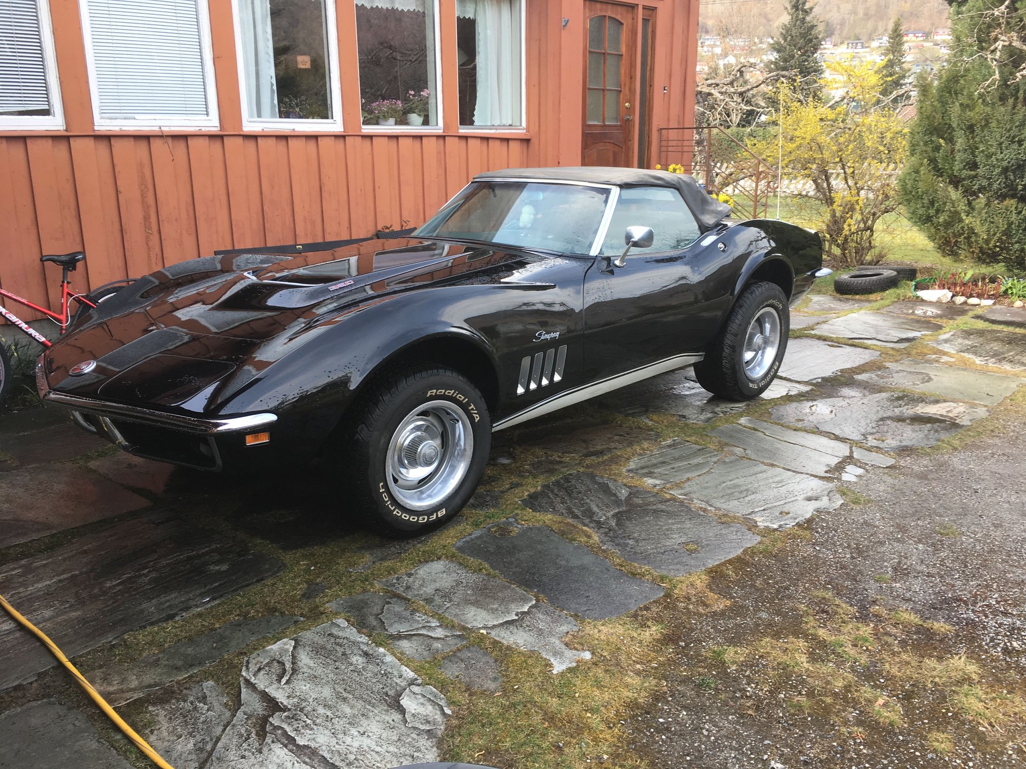

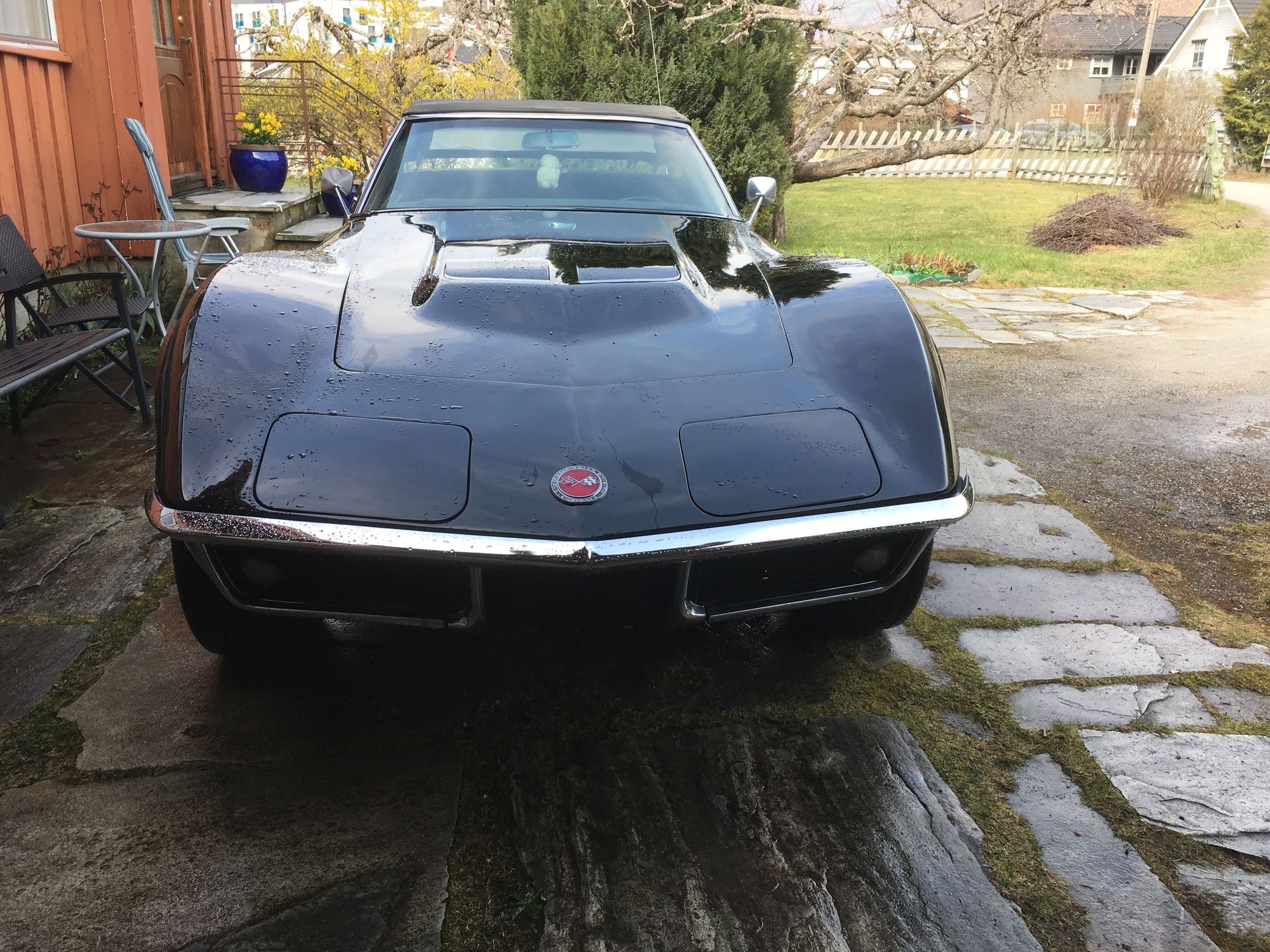

Just saw the pics of it washed . You should add them as you go in a new post, dont edit and add because people that are subscribed get the last post and wont see the beginning of the thread. Its amazing how beautiful your car is, she looks like she has fresh paint....
