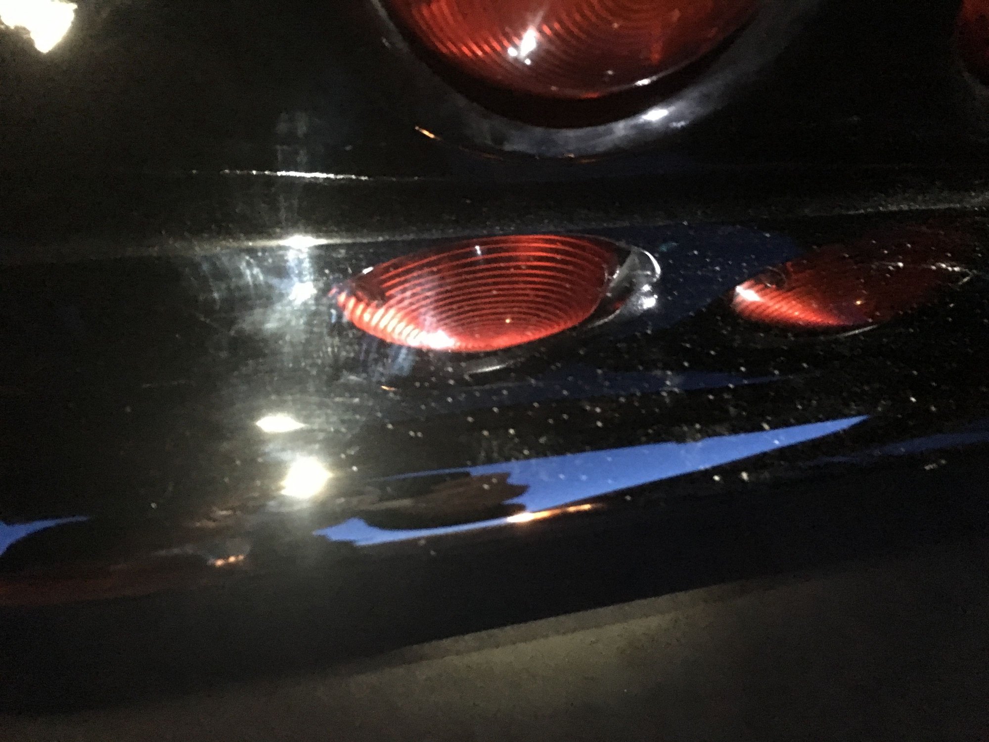

Does anyone have som tips on how to remove these spots on the chrome? (Sorry for bad light, but you get the point ) I have currently used a very old Autosol Metal Polish, but it dont seem to be working that good (I have bought a new one, maybe that will work better?). Do you guys have any tips or products i can buy to remove these spots on the chrome? Thanks in advance

I am no expert but that appears to be light-moderate pitting, though we have all seen a lot worse. I do not think there is any product that is going to make that look new. May shine up but as far as getting the "spots" out I kinda doubt it. The chrome is just worn. Pieces like the bumpers can be rechromed but it may be more cost-effective to replace parts like the mirror, door handles, and front grill pieces. Just my opinion. I hope others provide theirs.

You will not be a le tp polish those parts while they are on the car....it could damage the paint. You may be able to plish the bumpers while they are on the car with a hand-held buffer.`
A set-up like this below with some polishing compound will help and will be- much faster than hand polishing, but it will not remove the worst "pits".

You won't be able to polish that out on your chrome, without dulling the finish. [Don't sk me how I know...] Your best bet would be to clean them carefully so to not scratch them if they have hard particles on them now; then use #0000 (4-O) steel wool to buff them a bit. If that 'spotting' is just at the surface, you might just come clean. If that won't do it, you can only use some chrome polish and buff them. Trust me, if you 'machine' polish them, they will only get worse.

You're going to think I'm nuts but I've had good luck with a light rubbing of 0000 steel wool, followed by a chrome polish.

Dear C-3....sorry to be the 'hateful-shoot-the-messenger guy'. This is Chrome pitting. This is PHYSICAL...the chrome has given up the ghost.
splotches yes....physical pits no.

it is not on the chrome. it is IN the chrome. aluminum foil packs aluminum in the holes where the chrome is missing..real repair is replate or replace. the more you polish, the less chrome you have left.

Some chrome 'polishes' have abrasives in them. Find out which they are and don't use them!! But, trying to polish the spotting out BEFORE using the #0000 steel wool is a good idea. BTW, #0000 steel wool is much softer than the layer of chrome. All is does is remove 'softer' deposits on the surface. If you have light corrosion and/or rust showing on the surface, #0000 steel wool with clean it off and shine it up (after cleaning all loose debris off, first). It will NOT damage 'good' chrome.

The aluminum foil 'trick' is for chrome with some small pits/voids in the surface. As you rub the foil, some aluminum is scraped off and deposited in those open areas, causing them to be filled with shiny aluminum. It's a temporary improvement, as aluminum soon oxidizes and turns into 'dull' aluminum. But, it works for a day or so (maybe enough for a car show). That method will do nothing for your spots.
