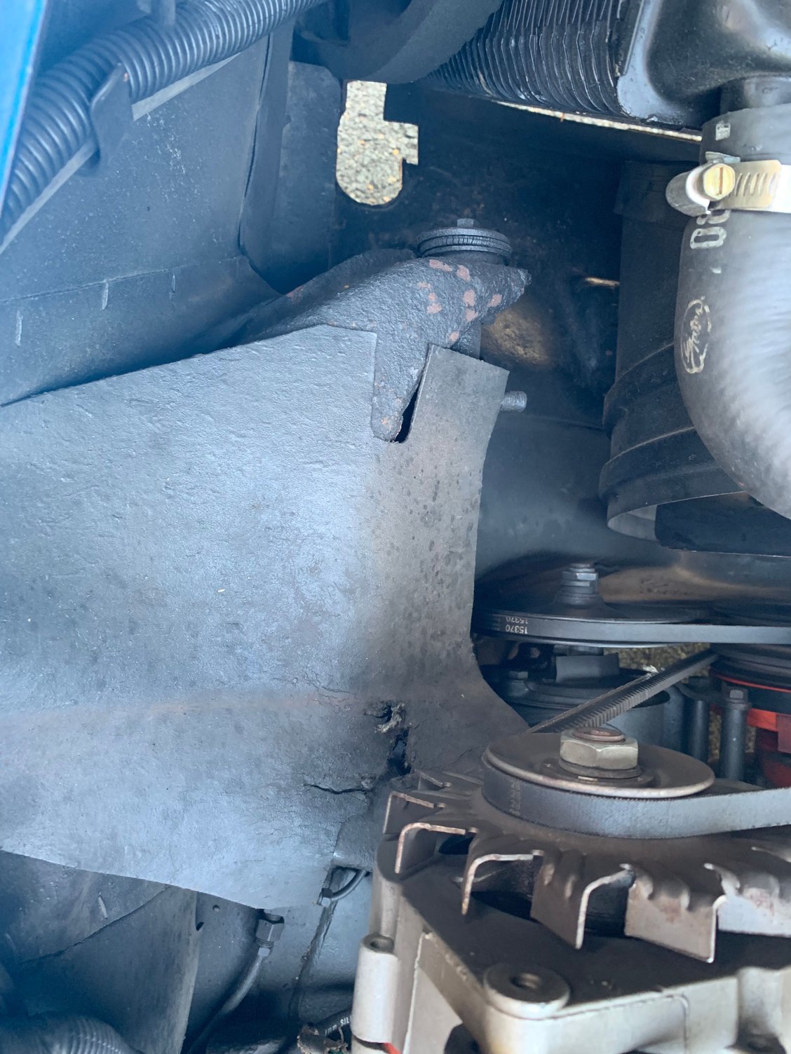

I found this 68 I really like and the price is reasonable. The engine runs good no smoke, the Muncie 4 speed shifts good. Everything seems to work, it needs bushings and suspension refresh. The big concern is rust. I can’t find any holes in the frame but I’m laying on my back poking around. I got a few pictures, I read about the bird cage so I might be able to get the owner to let me take the kick plate out. I see a bit of rust color near the vin where the rubber meets the glass. Is there a particular place I should poke on with a screw driver to see if it’s bad. Would you run away, it’s a convertible with a decent rag top.

Definitely not a trailer queen, but I don't see anything that is out of the ordinary for a 50 + year old car. That shock in one of the photos needs to be replaced. Looks to be mostly surface rust on the frame.
You will want to check all the body mounts to be certain. There are 8 of them. Two can be accessed from inside behind the kick panels. If the current owner doesn't want to open it for you to look, I would pass. Honestly the car looks like it needs a frame off. You will want to consider that when negotiating a deal. Frame restoration can be time consuming and expensive, considering you have a place to take everything apart and store it while the work is done.
What are your intentions for the car, should you purchase it.? Daily driver, restoration or resto mod.? Got any pictures of the shiny side or the interior.?

here are some pics

doesn't look too bad underneath. 1st day production is an interesting detail.

Looks pretty good to me. Engine compartment and engine look like they are part of a car that’s been well taken care of and maintained.... Have a look at the sticky 10 rules for buying a C3. Go to post #133

Look at the rear body mounts in the rear tire well, look at the rear kick up at the front of the rear tire. Those generally are the 2 worst places if it was driven in bad weather conditions. You can look around the windshield, have him cycle the wipers and then stop them with the override switch under the dash and look around in the wiper area.
Then check the kick panels for the front body mounts. Looks like a lot of surface rust so far
Great price for matching numbers

There are some 'changes' under the hood, but nothing earth-shaking. The rust wouldn't bother me, unless it looked a LOT worse in the birdcage area.
That '68 car had International Blue as one of the exterior colors. That car is NOT International Blue. It looks like it was repainted Bridgehampton Blue (factory color in '70-71). I like both of those colors; but if you wanted an original color, that car doesn't have it. But, it looks terrific.

I don't see anything in those pictures that would scare me as far as the rust.
one odd thing I see, very last picture, by the drivers hood hinge it that some kind of big flat patch on the firewall?
I really dont think 16k is a bad price for that car. nicely optioned vert.

Thanks for you input Tiger Joe! I don’t know what that is on the firewall. I wonder if a repair was performed. Thanks for pointing that out, I hope someone wasn’t trying to fix an issue under that. Your the 2nd person that didn’t think the rust was that bad so that is encouraging. I’m going to see if he will let me tap on the frame lightly to test for major flaking Saturday. Rusty frames scare me especially on one I’m not familiar with. The guy advises I can come and check the 8 chassis mounting areas.
