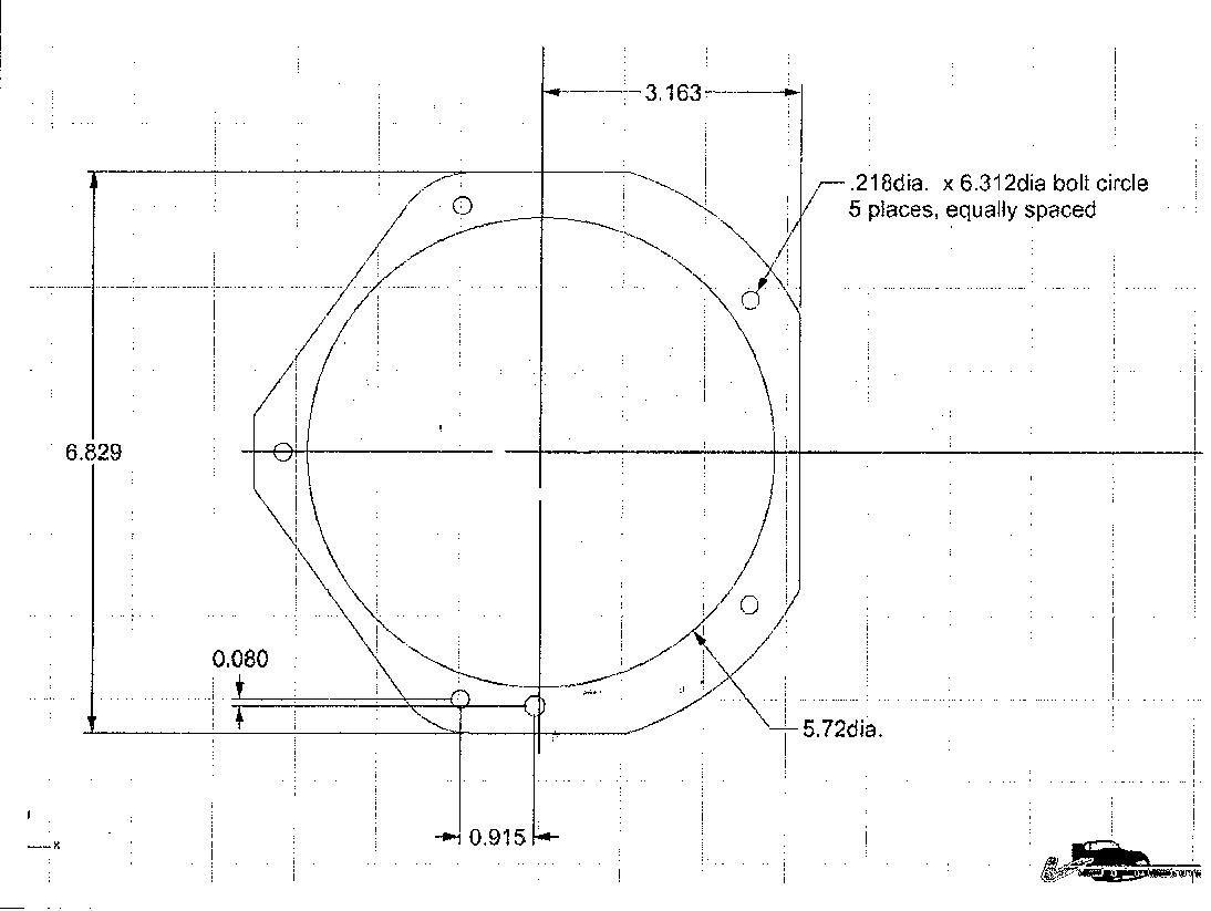

If you want to install the C-4 blower you will have to make a spacer.
Here are the dimensions.

What is the thickness of that spacer?
AdamMeh says 1 inch thick, see his post:
https://www.corvetteforum.com/forums...tall-info.html
