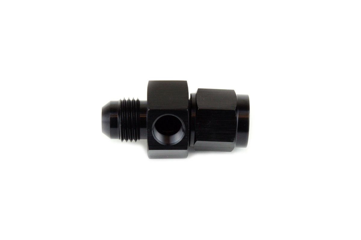

This- doesn't get any easier....
https://www.speedwaymotors.com/Earls...BoCZ5wQAvD_BwE

Awesome thanks for the info
