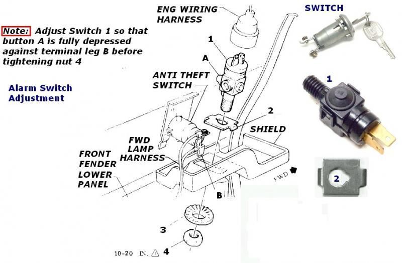

Old Sep 5, 2019 | 08:43 PM
Steve COSD's Avatar
Steve COSD
Joined: Mar 2005
Posts: 683
Originally Posted by Duke94
It's not that complicated of a system. Just a bunch of normally open switches that go to ground and energize a relay to sound a horn when the circuit is closed.
I have a 75. This applies if the alarm switch is on the front driver fender. The switch on the fender has a backup switch that is activated if a crimanal rips out the switch on the fender. This backup switch looks a lot like the switches used to show the headlamps are up. It is a black plastic switch with a button that has a rubber seal around it. The button has to pressed up and touching the fender switch to complete the system. This button activates the system if the fender switch is pulled out. Make sure the black button is depressed all the way in when it is touching the fender switch.
The other problem may be the horn itself. it is located behind the driver rear tire. Not the best place as far as water or dust. Test the horn.
Let us know how you do.
Thanks Steve
Old Sep 5, 2019 | 08:58 PM
Peterbuilt's Avatar
Peterbuilt
Joined: Aug 2006
Posts: 7,426
Likes: 1,559
From: mount holly NC
Here's the switch that Steve COSD mentioned.
