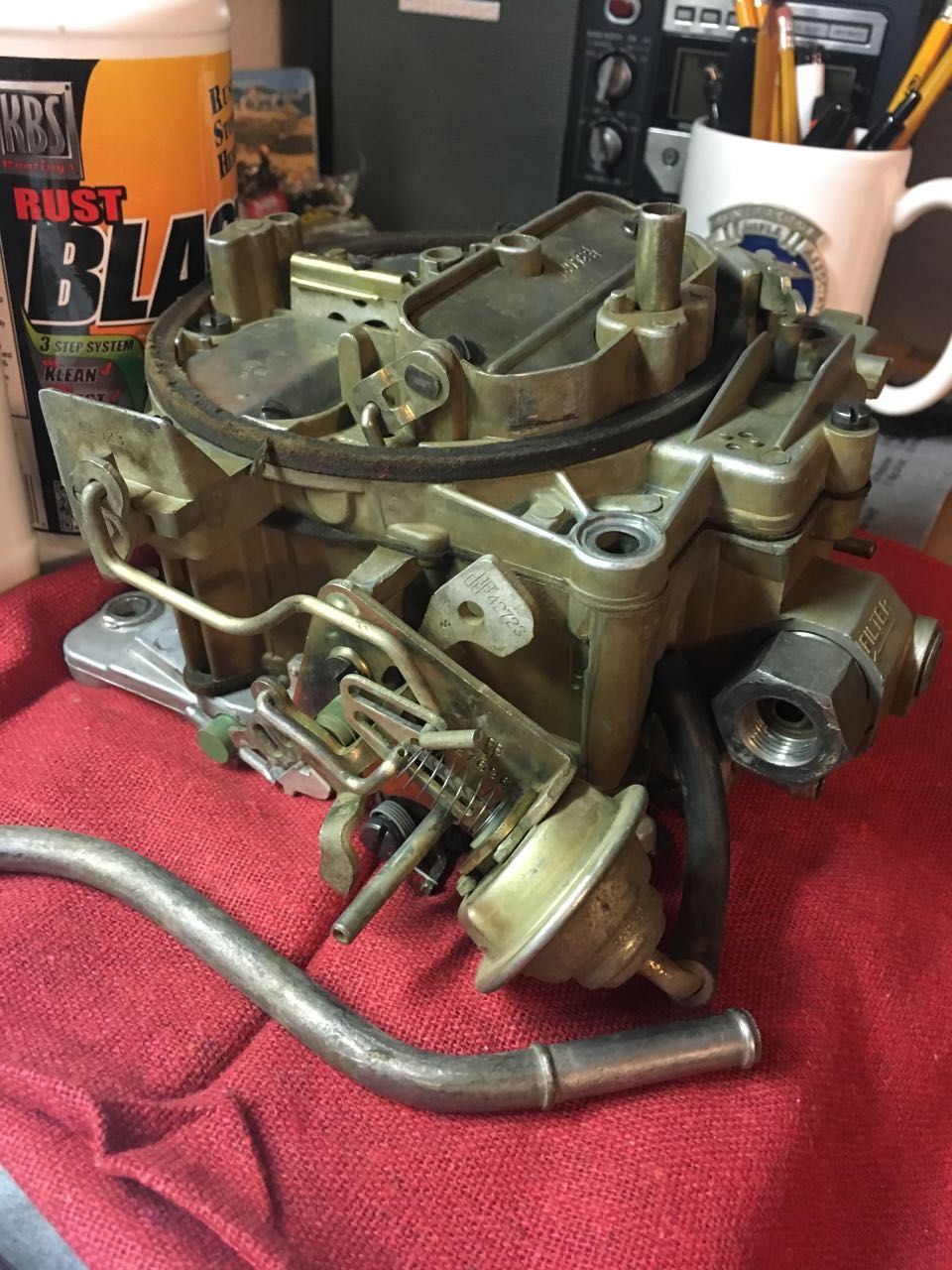

After sending Lars photos of the replacement carb currently on my car, he suggested replacing it ASAP. It is a badly configured rebuild that is in sad shape!
I was contacted by an NCRS member, having the correct carb, albeit a service replacement manufactured in 1975 (my car is a 72).
Lars took a peek and determined that it is an unmolested Rochester worthy of his attention. I purchased the carburetor, knowing that once Lars works his magic, it will be much better than the bootleg Q-jet I'm running now.
I'll continue to search for the date correct carb, but in the meantime, I'm packing this up and sending it off to Lars.

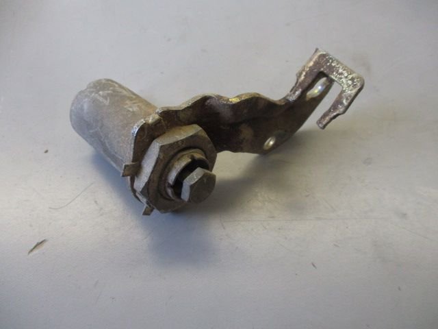

The idle solenoid, installed on the carb, looks like this:
Solenoid with bracket:

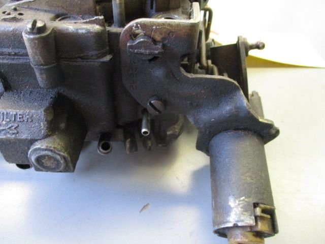

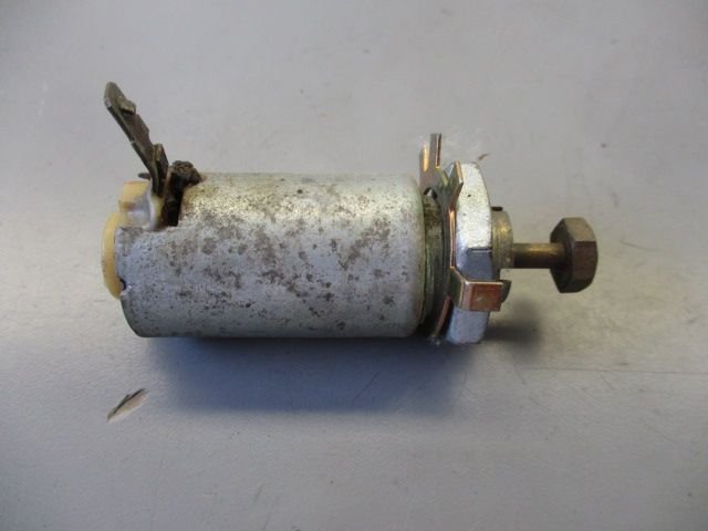

Solenoid. This is what is known as the "long" solenoid, which is correct for your year. There are also "short" solenoids, sold as replacements, even though the "long" ones are still available:

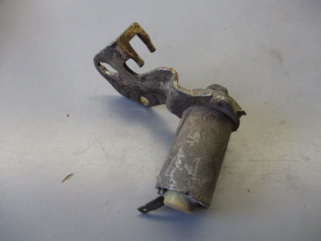

The brackets are available as new reproductions from Corvette Central and other suppliers - their part number is 353126 for $16:

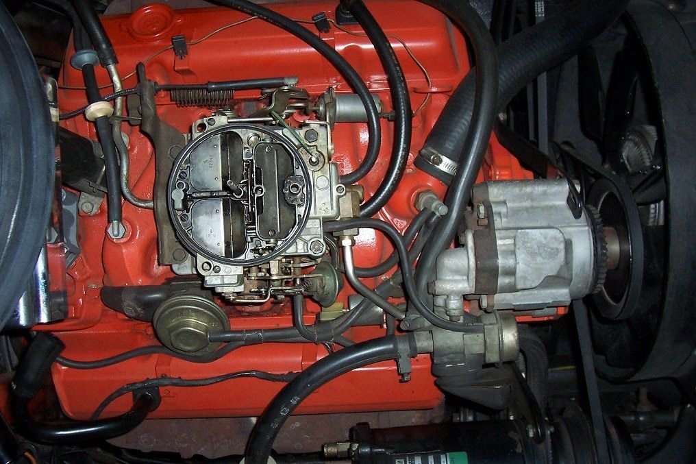

Installed on the engine with the tan wire hooked up (I don't believe this wire is routed "correctly," but it gives you the idea):
