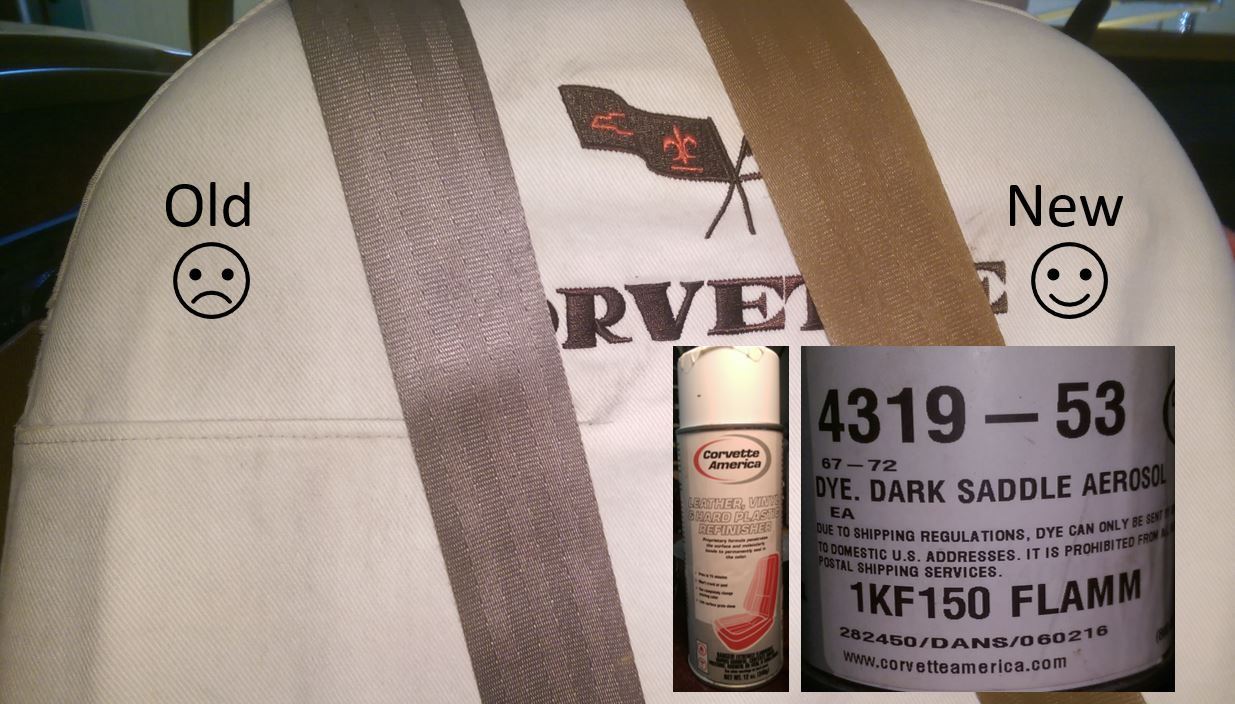

The dye I used doesn't smell anything like spray paint.
Works great. Covers well. Not sticky at all and I even used it on my seatbelts and it's holding up fine.
Dye I used

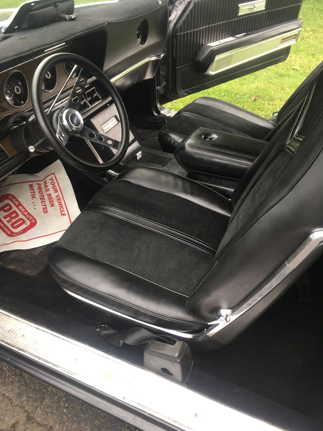

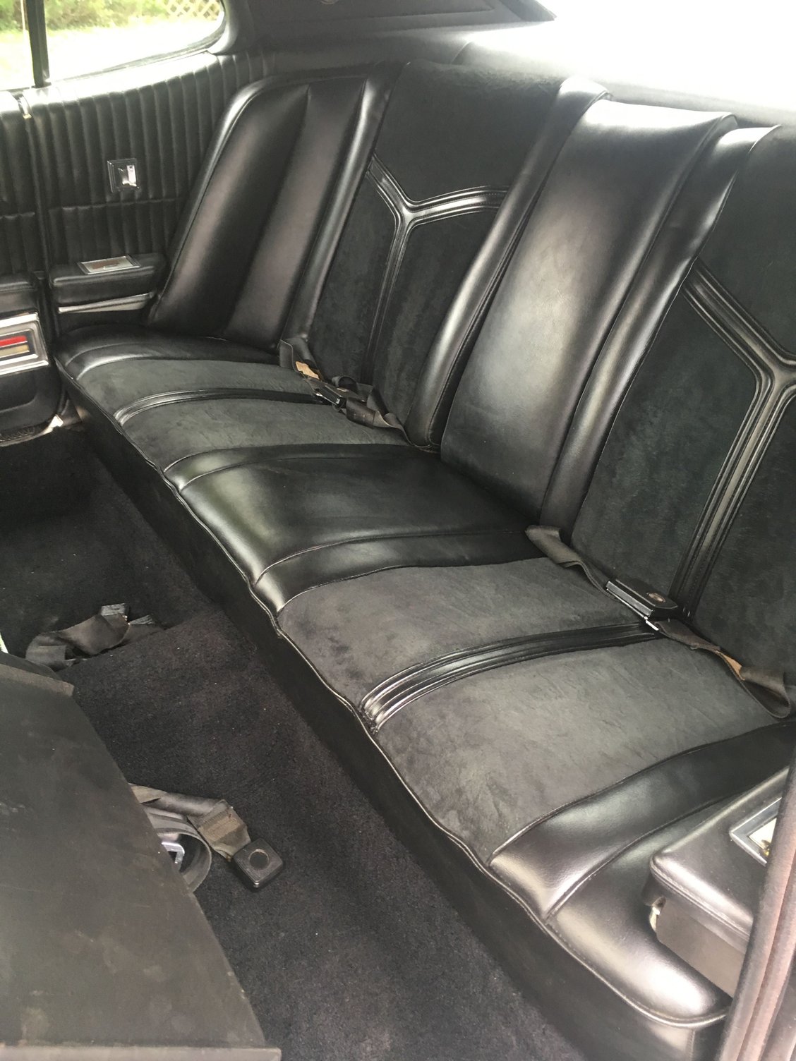

I just did this on one of my other cars. I used SEM. I contacted them first as I was wanting to match plastic, vinyl, and even velour. They sent me some good tech data and I used all their products as far as cleaners adhesion promoters and dye and the end result was way better than I had figured it would be. The seats and console were a straight outta the 70s green to give you a idea of how they started
