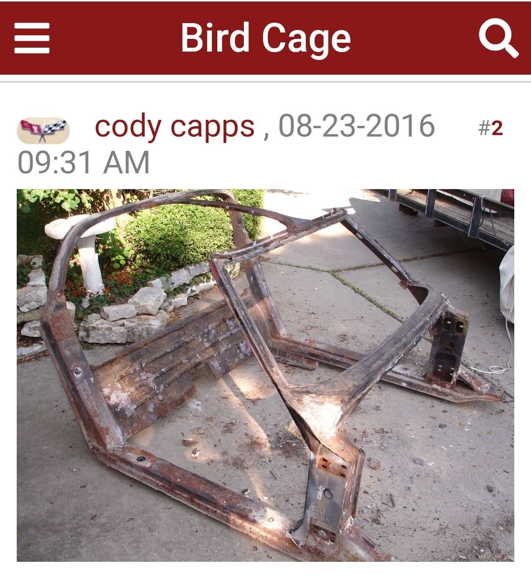

everyone keeps saying birdcage, I don’t really know what that means. Also thank you everyone who has replied.

Birdcage is the frame around the windshield -- a pilars/crossbar that the t-top comes to meet. It is a regular rust trouble spot. I'm replacing the corners and top crossmember on my 70 right now.

Here is a great pic , provided by member cody capps,,,
Read this thread,, and read, read, READ all you can, to understand what to be looking for,,, this can make or brake a project!!!
https://www.corvetteforum.com/forums...bird-cage.html
