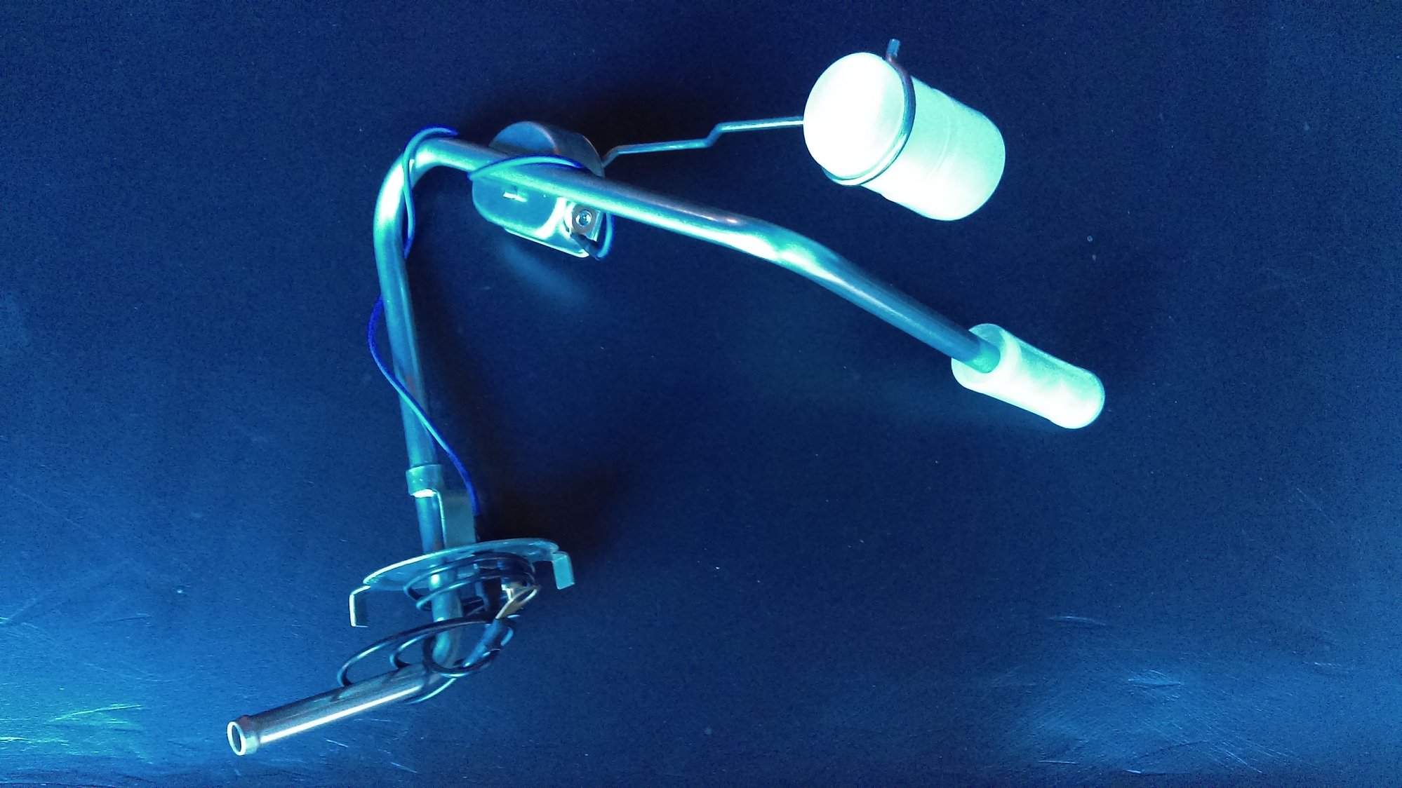

For what it's worth, here is the Spectra fuel sending unit for the early C-3's. You can see from the photo, the float IMHO is less likely to fail because there are no penetrations and the material is a better quality. Also found out that the bend in the pick up tube is extremely important. The failed unit pickup was 3 inches off the bottom, effectively running me out at about a quarter tank of fuel. The new unit pick up sets nicely on the bottom as it should, giving a much more accurate read. Happy with the product, install was messy but quick. Took her out for a spin after, gauge is working .
