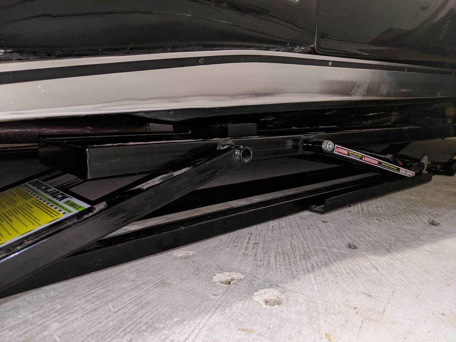

so, i was going to jack my car up to get a better view of some things, pulled out the quickjacks, lined them up, powered them up a little but noticed something wrong rather quickly
the rear is much higher than the front.
and even if i keep going in the quickjack's travel, that rear end gap doesn't seem to close much
like the entire car is trying to balance on those front two jack points....which is not good!
Am i missing something?
passenger front
driver rear
driver front
passenger rear

Does your car sit level to begin with? I am assuming you are using the same size rubber blocks on all four contact points, right? I use one large rubber block for each contact point and just move them around until they are in a good position under the frame. I've never had that problem with them being that off.
Do both Quickjacks sit level before they contact the frame?
Old Jun 10, 2020 | 09:08 AM
Mooser's Avatar
Mooser
Joined: Apr 2011
Posts: 11,183
Likes: 3,335
Since the frames do that forward/aft movement as they go up and the vette is close to 50/50 on the wheels, the rear block is just in front of the rear wheels when I lift but the front one is back another foot or so more of the weight is on the front pad, I usually have the tall block and the short on on it's side up front)
I can say that I usually load mine so it lifts towards the rear (car goes up and back) so the puck trays are reversed to what you have there. but if I need to do rear suspension work I load it as you have
I always have to use the taller blocks or it will touch on the trans-crossmember (or come really close and it looks like it's going to)
I position the front blocks a little farther forward than yours look, just at the start of the turn-in on the from
Typically I'll also put a set of jack-stands up under the front swaybar to "take some weight" of the front of the car cantilevering that far forward of the lift point, I doubt it could fall but it makes me feel better crawling under there

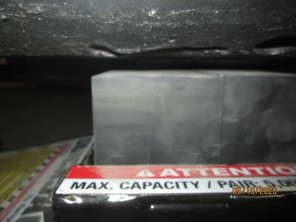

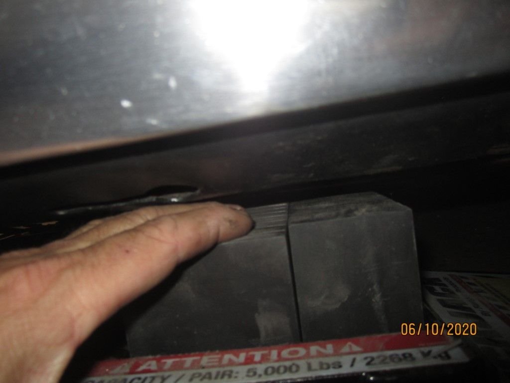

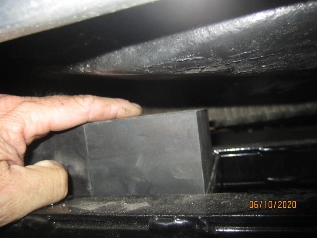

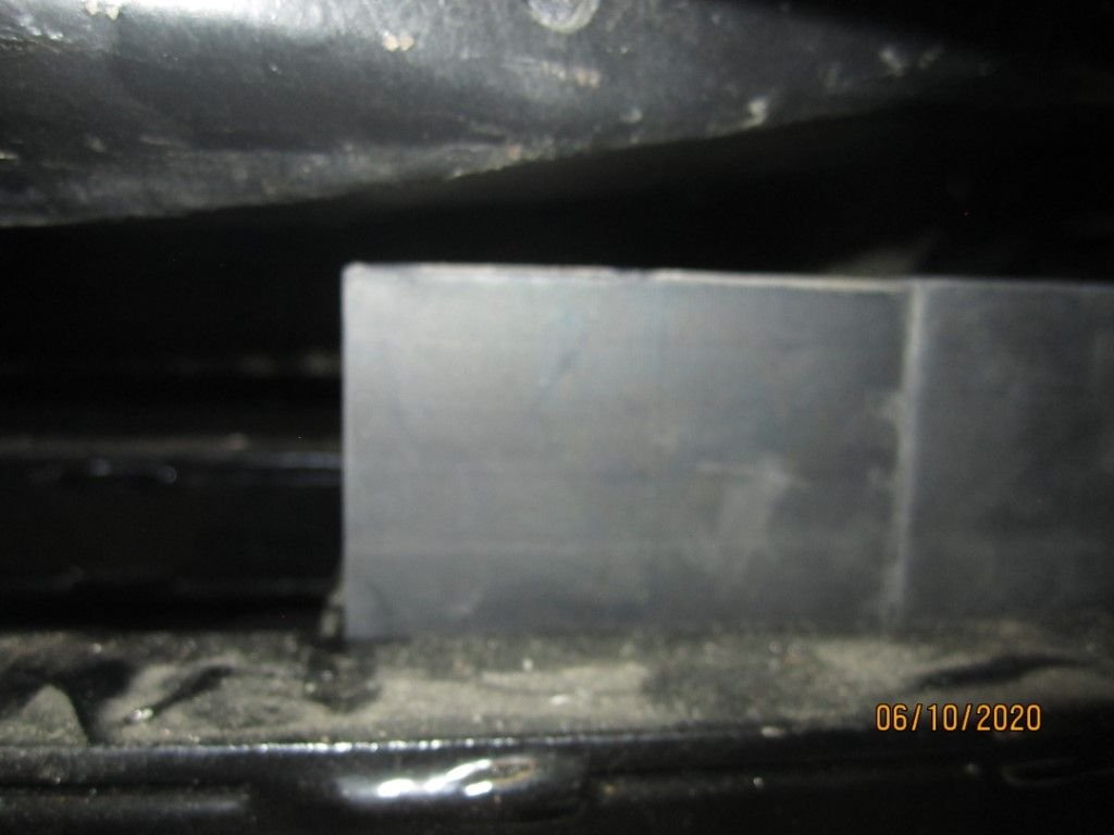

Had to put mine up a couple of times today/tonight to adjust the rear toe shims
As the lift approaches the frame without touching
DF, a bit of room above the fingers there
DR, fingers just barely touch so maybe 1/4 or 1/2" less than the front
PF
PR
This is with the lift moving the car up and back so I don't have a lot of choice at the front blocks, they are as far back in the pockets as they can be.
As you can see, the lift hits pretty close to at the same time front and rear
M

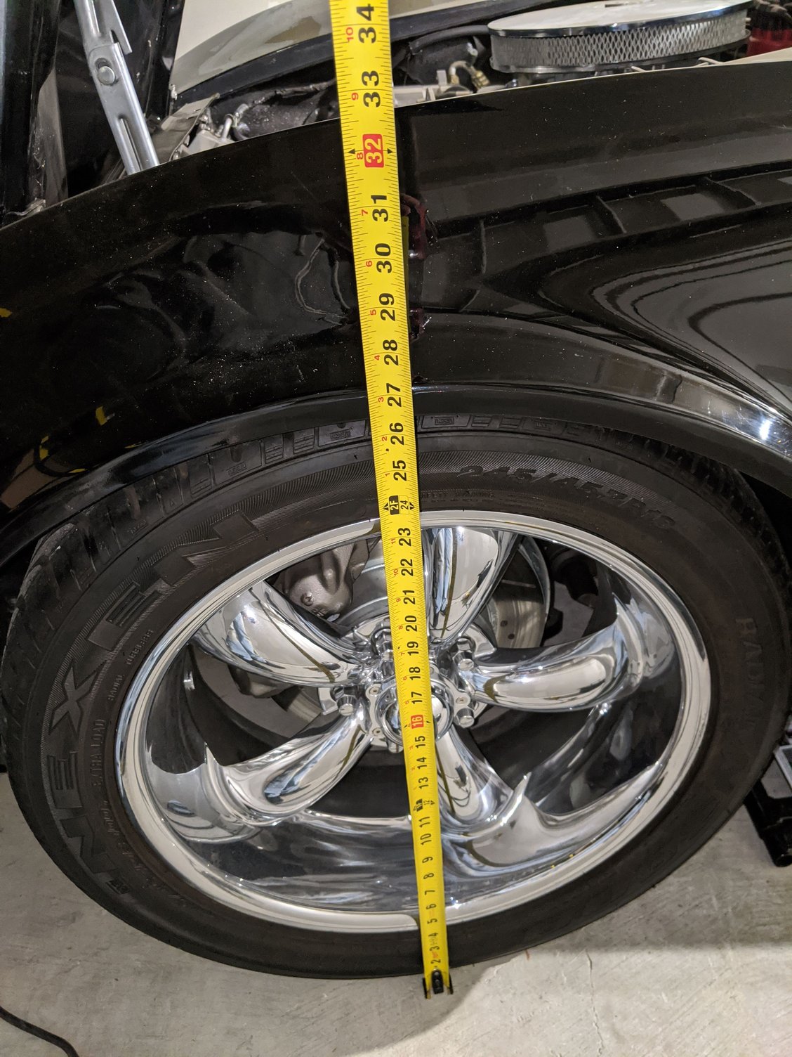

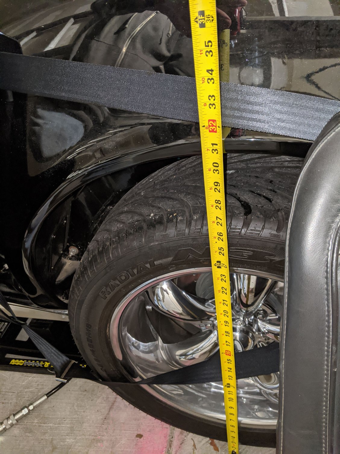

well this is downright disconcerting, the rear fender is a full four inches higher off the ground than the front (26.5 vs 30.75)

rear fender height
Old Jun 11, 2020 | 07:29 AM

Something must be wrong to get it that high
two things to look at quick is how the outside spring to trailing arm bolts are set as they affect the rear height. Also if you have raised the car and set it down the tires need to slide out as the suspension tries to swing back up. If they cant, they can hold up the rear
if that's ok, look at the sway bar

The 27" vs 31" fender measurements show where your problem is. The rear end is way too high. Rear spring end bolts are the first place to look. I have a 77 and a Quick Jack. All 4 fenders are around 27.5" and, when lifting the car, the 4 rubber blocks contact at about the same time.
