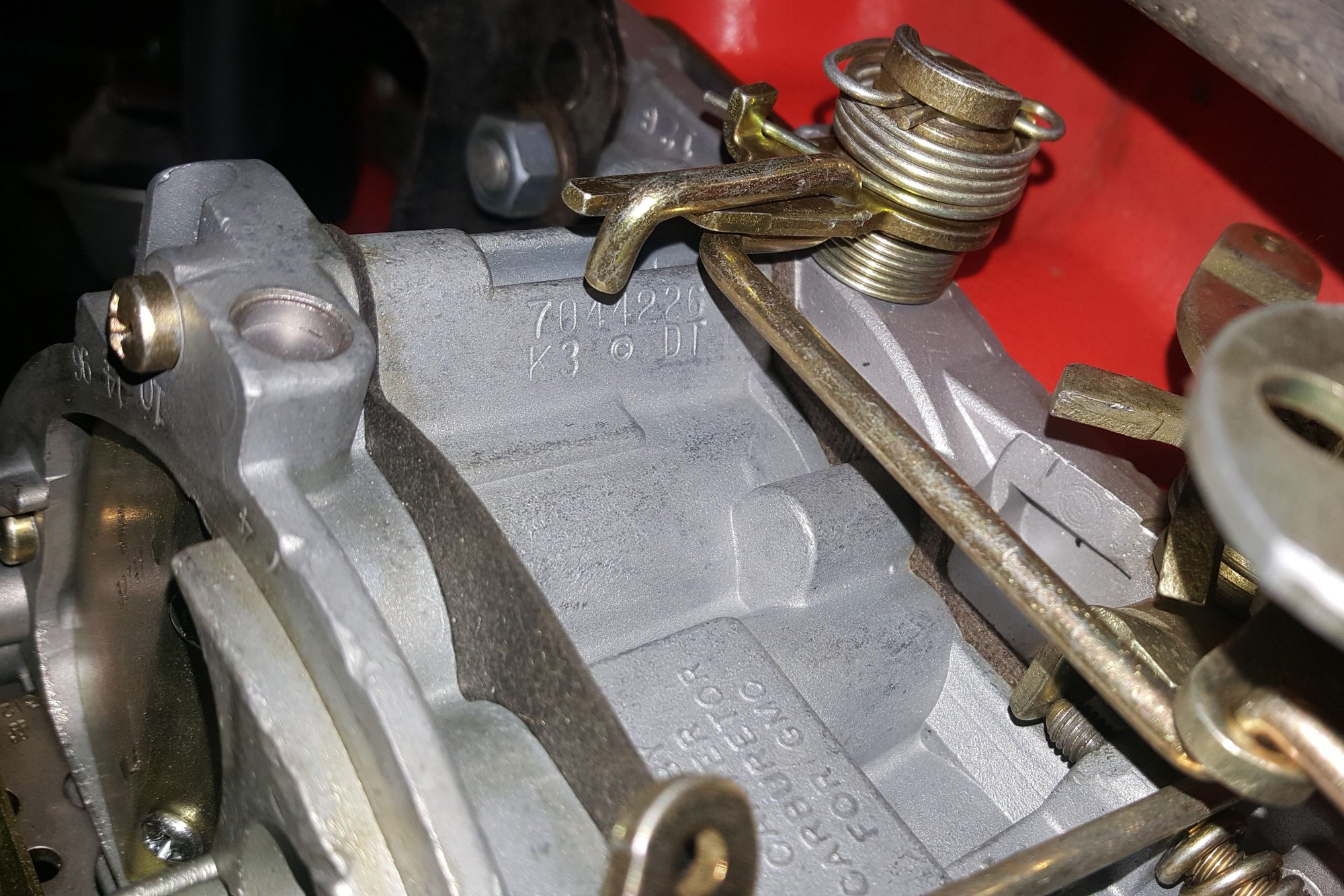

Here are a couple quick pics, since one of you asked.
Thanks for the thoughts on the carbs. I think this one has a few problems, but it's possible when the previous owner did some work, they didn't fully tune it. I noticed it's for a different engine than my 454.

I'm no expert, but that looks like a commercially rebuilt Q-Jet. You might want to email @lars for a second opinion, but he may say that carb is not worth fixing.

You're absolutely right. It's a hacked, destroyed commercially built carb, best used as a door stop. Right off the bat I can see the secondary airvalves are screwed up somehow, which is probably a good indication of the condition and setup of the rest of the carb.

Lars, thanks for that assessment. I was already leaning heavily towards another carb, and I had noticed I was having a hard time getting the proper adjustments, and even my mechanic buddy told me something wasn't working right in the secondaries. It just doesn't have the punch a 454 ought to. Since I had already planned to do a little upgrade to the engine, I figured there was no reason to keep messing with this one at the time; either repair, later, or replace.

Did your buddy try adjusting the tension on the secondary air valve that appears to be not fully closed?
About 7/8 of a turn from fully closed of the spring tension lock screw would be a good starting point.
