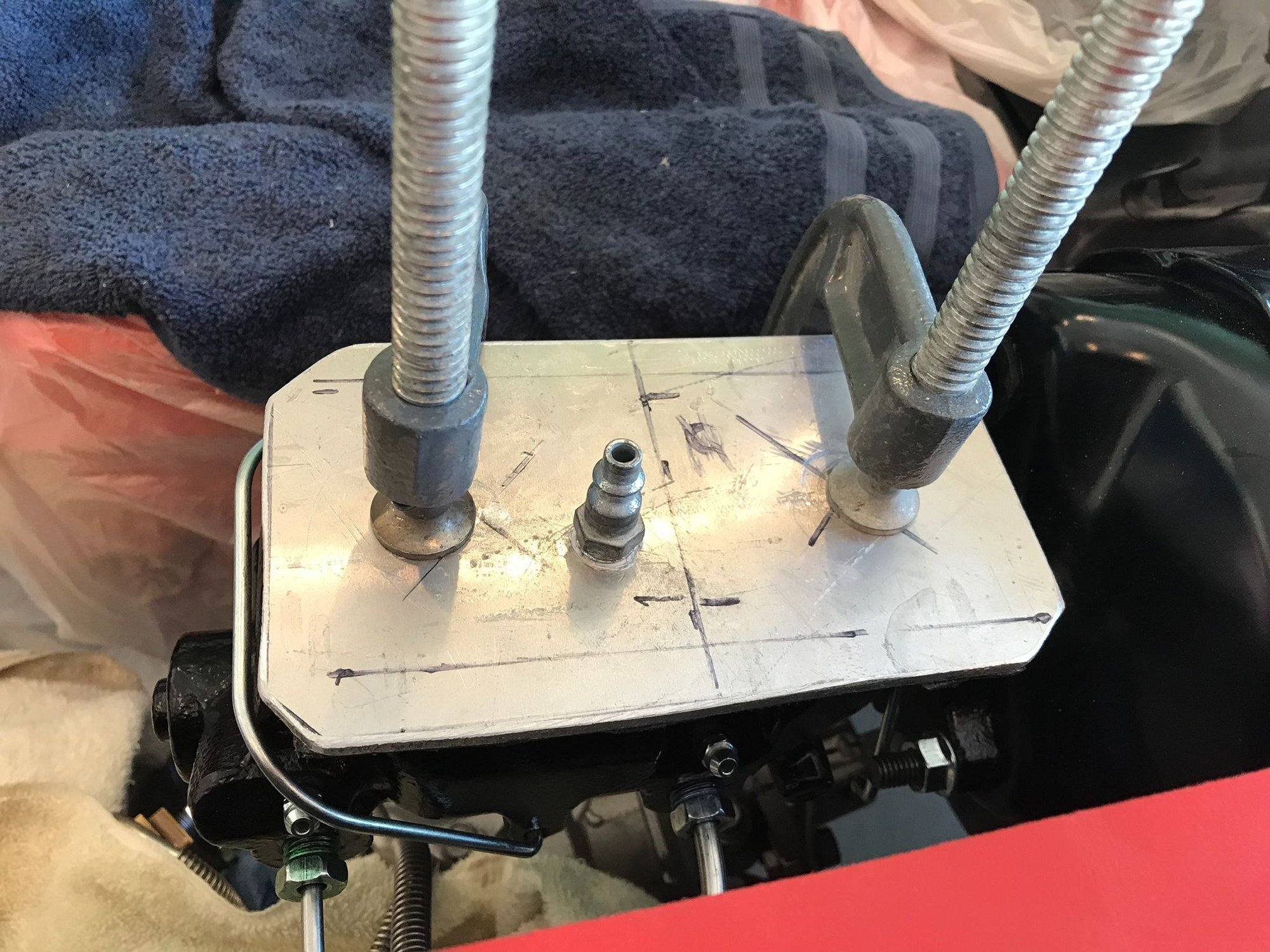

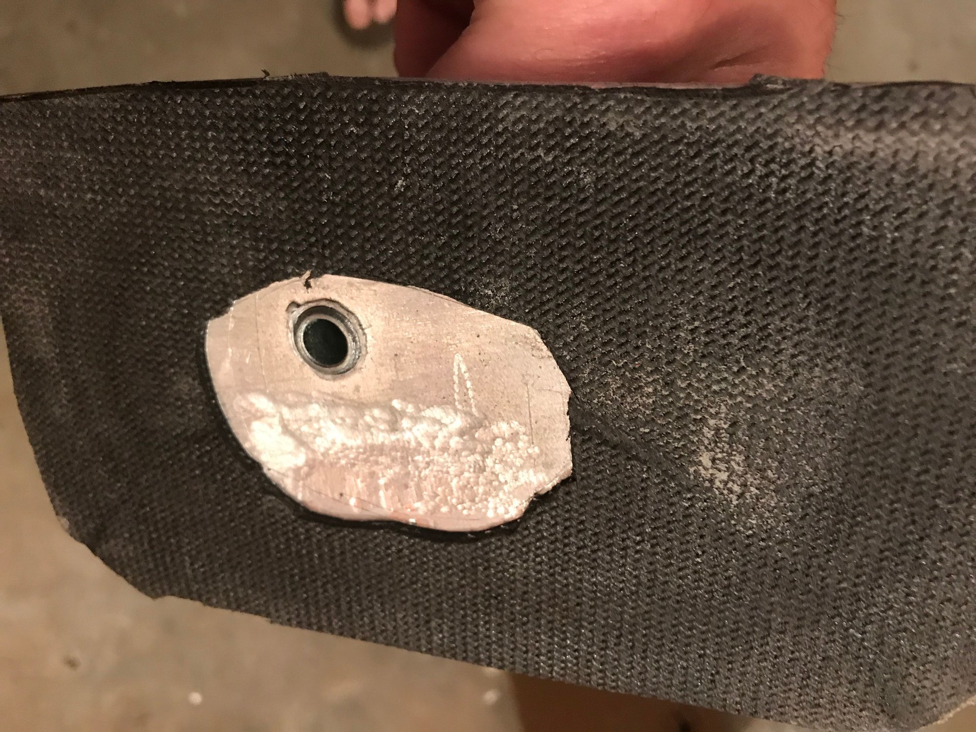

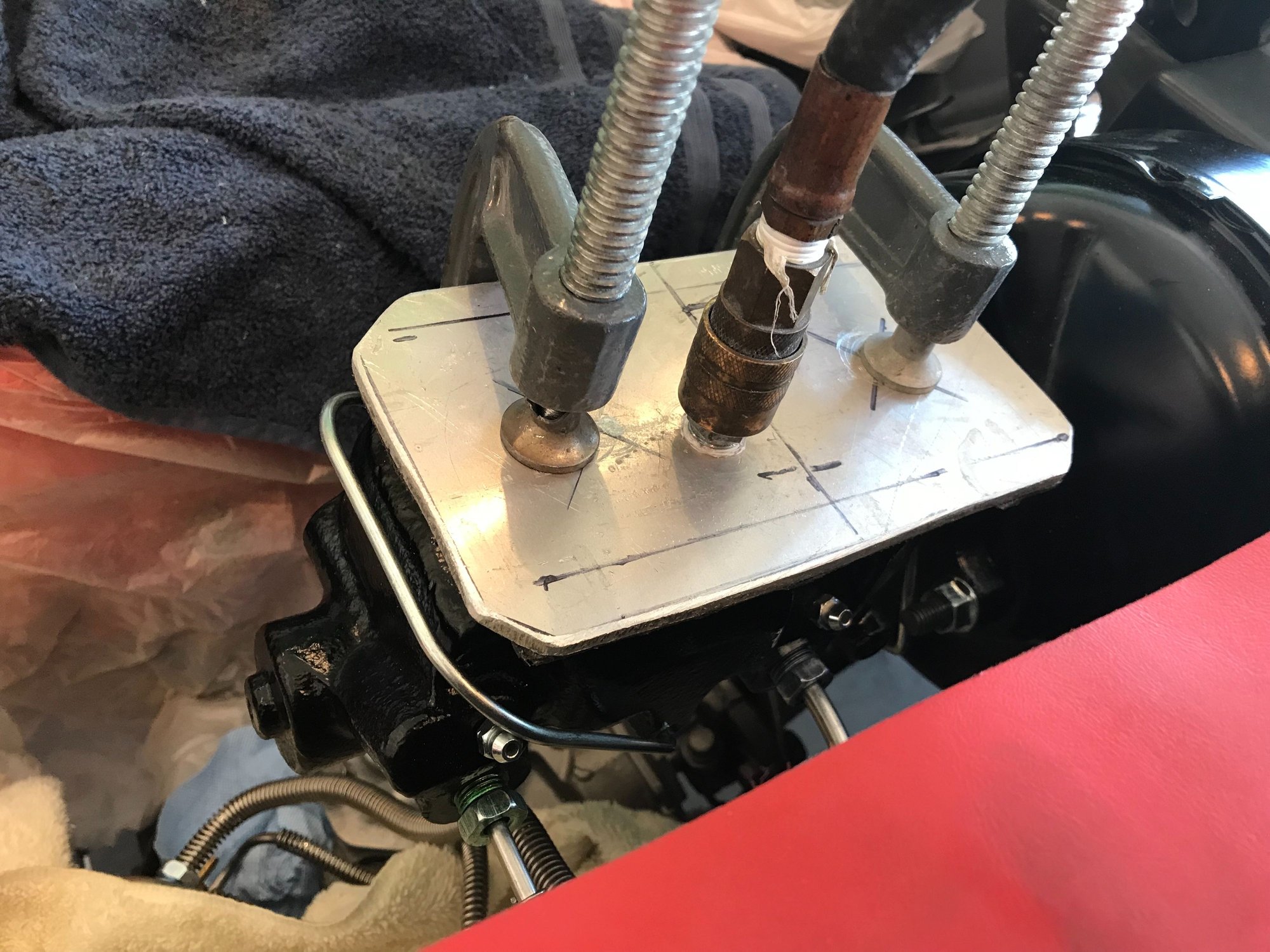

Thought I would share my experience/solution to bleeding my brakes. This is a bit crude, but hopefully it can assist others. I did a complete brake system replacement, lines, calipers M/C. My initial attempt to bleed the system, gravity method, pumping the pedal were not working so I did a little research and realized my best method would be power bleeding. Here is what I did...I considered modifying the sprayer bottle like others had done....first I needed a plate to cover the M/C regardless of what actual pressure method I used.
I salvaged a piece of 3/16” aluminium plate, drilled and tapped a hole to fit a male air line fitting. Glued some leftover rubber shelf liner to act as a gasket, as well I ground out the centre area to allow the air to pressurize both sides of the M/C. Clamped the plate to the M/C with a couple of C clamps.
Once I got the plate on I set my compressor to 20lb pressure, connected the air line.
I went ahead and followed the bleeding sequence, LR Inner,LR Outer, RR Inner, RR Outer, RF, then LF. I made sure I kept an eye on the fluid level in the M/C so it didn’t run dry. I did a bit of research and decided to use Dot 5 (silicone) mainly to protect my paint. The M/C was bench bled prior to the install. I also used stainless lines and ended up with a few leaks. More research and ended up using copper flare washers that worked great to fix the leaks. Overall this worked great, and making the plate took about 30 minutes and cost nothing.

Great job. It would be nice if you could fabricate a factory type cap that could use the stock bails for attaching the cap to the body of the master cylinder. That would eliminate the need for clamping and un-clamping as you add brake fluid. Again, great job. Jerry

Not sure that those flimsy bails would hold seal against 20psi .... but maybe at lower pressure. Drill/tap your plate at the center point of each fluid well; then install properly cut-down hex-head bolt (3/8"-16 maybe) with a groove in the head to accept the bail loops. You can adjust the bolt for proper retention of the bails. You'd need to seal the bolt threads with epoxy (?) once height is established. That might hold 5-10 psi. But if pressure is too high, the ends of the bails will eventually pull out of their pockets...and you will have a real mess....
Certainly a creative approach...

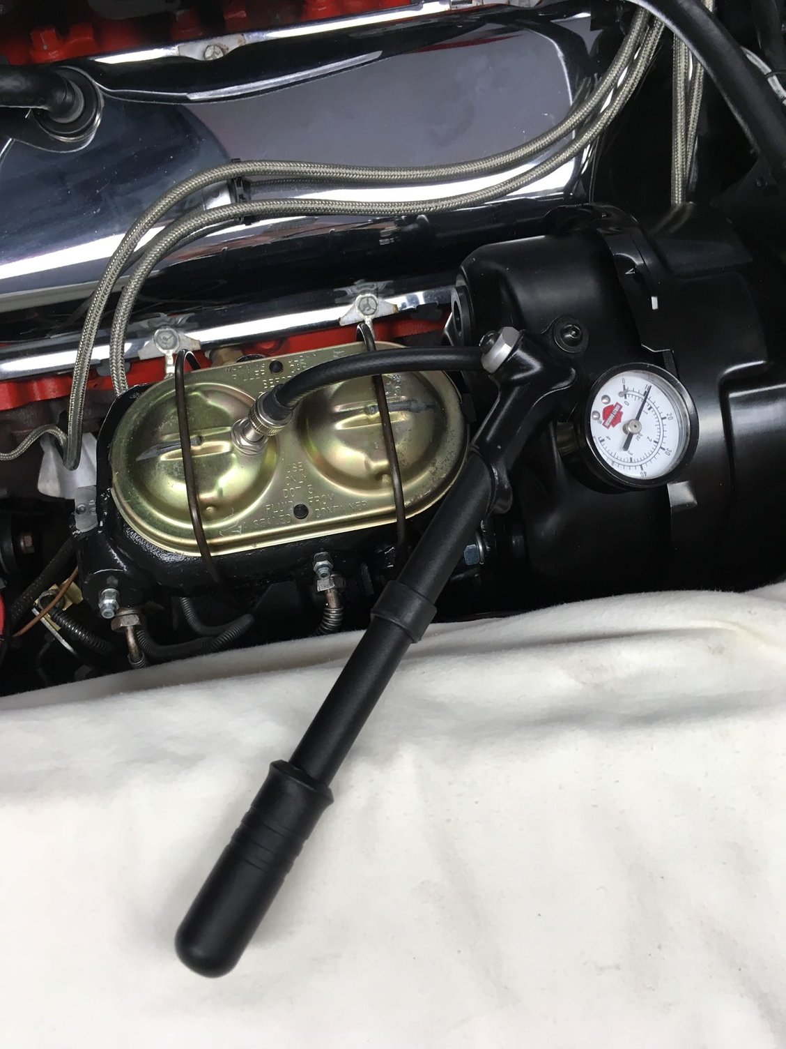

I sent the Motive back and made this with a spare cover and used the air shock pump for my Harley, worked like a champ. I never could get it right using gravity, the pedal or a mity vac but this did the trick.
