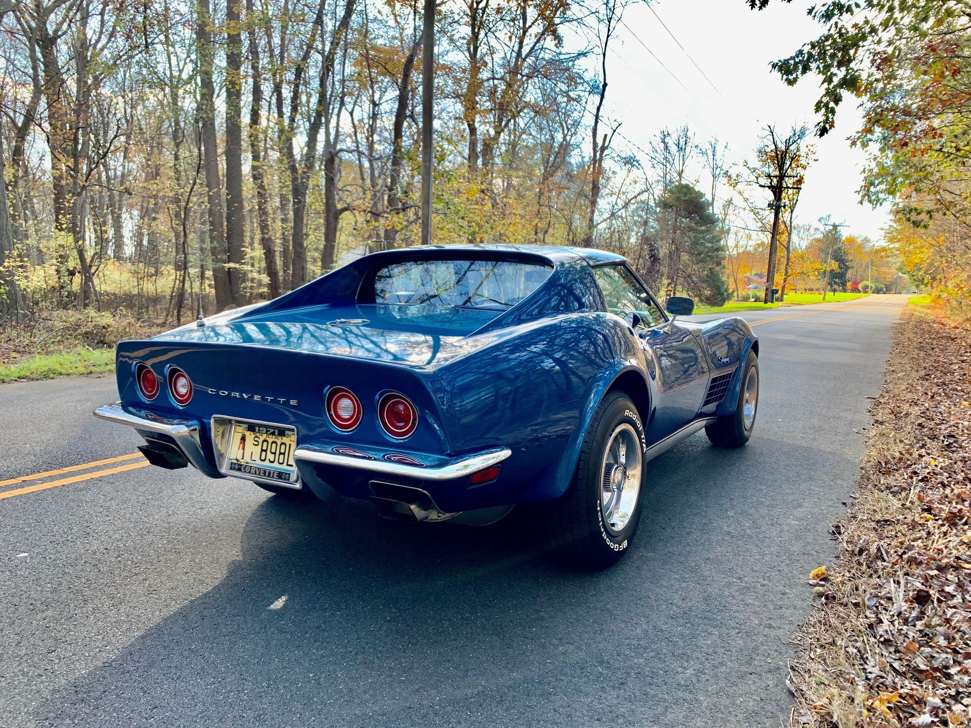

Originally Posted by BBCorv70
I'm having my 70 repainted. Very long process as you indicated. The shop lets me participate to cut hours of labor charges. I see and experience first hand how long it takes if you're very focused on details. Final decision on color is TBD, Is that an original color? Bridgehampton Blue or some other?
Yup! 979 Bridgehampton Blue...here’s another pic for ya!! Put some pics of the 70 up!!
Thanks, nice looking car, like the color. My 70 is at the shop, still in primer. Expect to be painted late fall or early winter. Not much to look at right now.

Head's up!! ---
#979 Bridgehampton Blue color code is only valid for 1970 & 1971. In 1972 the Corvette came with color code #979, also.....But it was NOT Bridgehampton Blue ; it was Targa Blue, and entirely different (darker) color of blue. When you order paint to a GM color code, make sure you also state the MODEL YEAR for that color code, as well.
