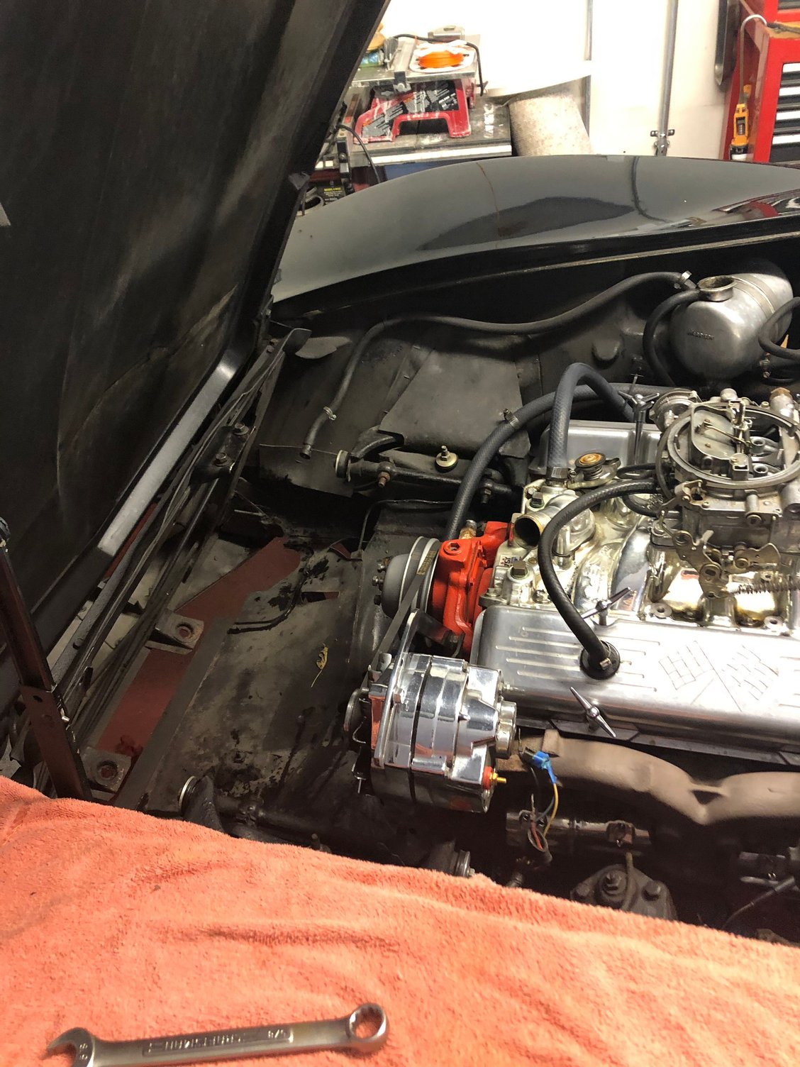

Well, that didn’t last long. I got the seats out and managed to get the left front body mount bolt off. Most of the threads from the retaining nut were still on the bolt when I got it out, but it came out. So onto the left rear body mount bolt. I knew it wouldn’t be good when that pocket was filled with a 1/4” of rust crumbs. The socket fits sloppy on the bolt head, so I’m afraid to put too much pressure on it for fear that I’ll round the head. Any tips or tricks for getting these out?

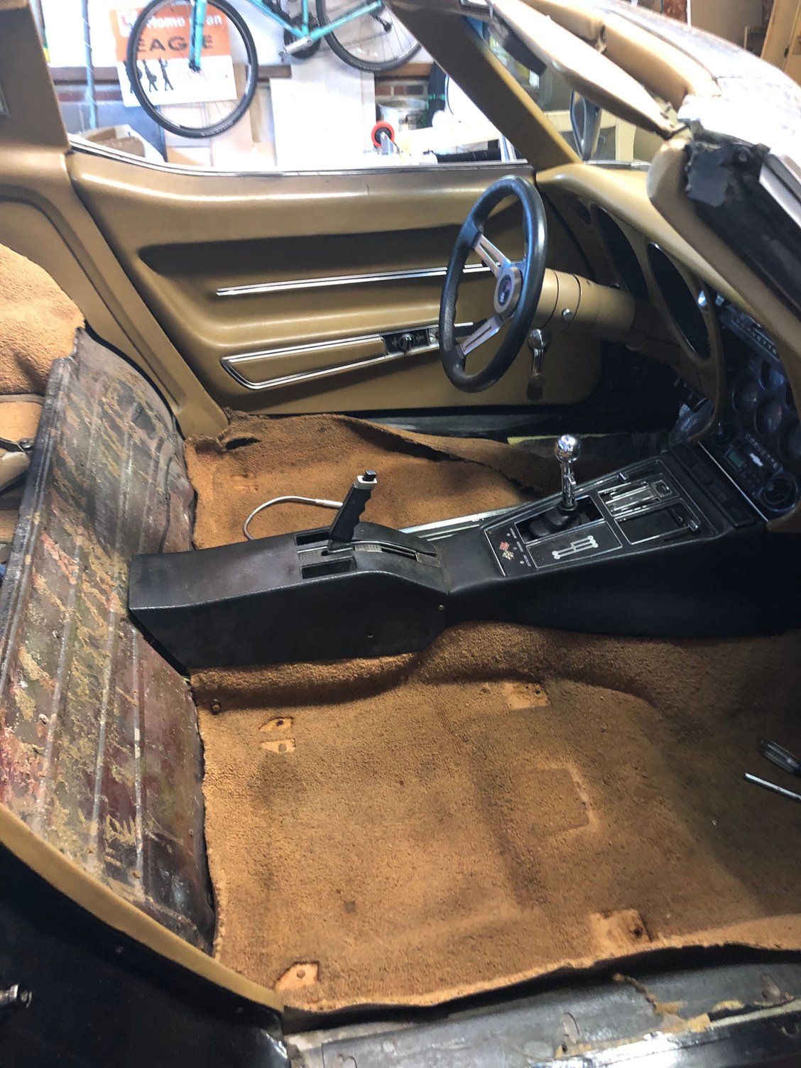

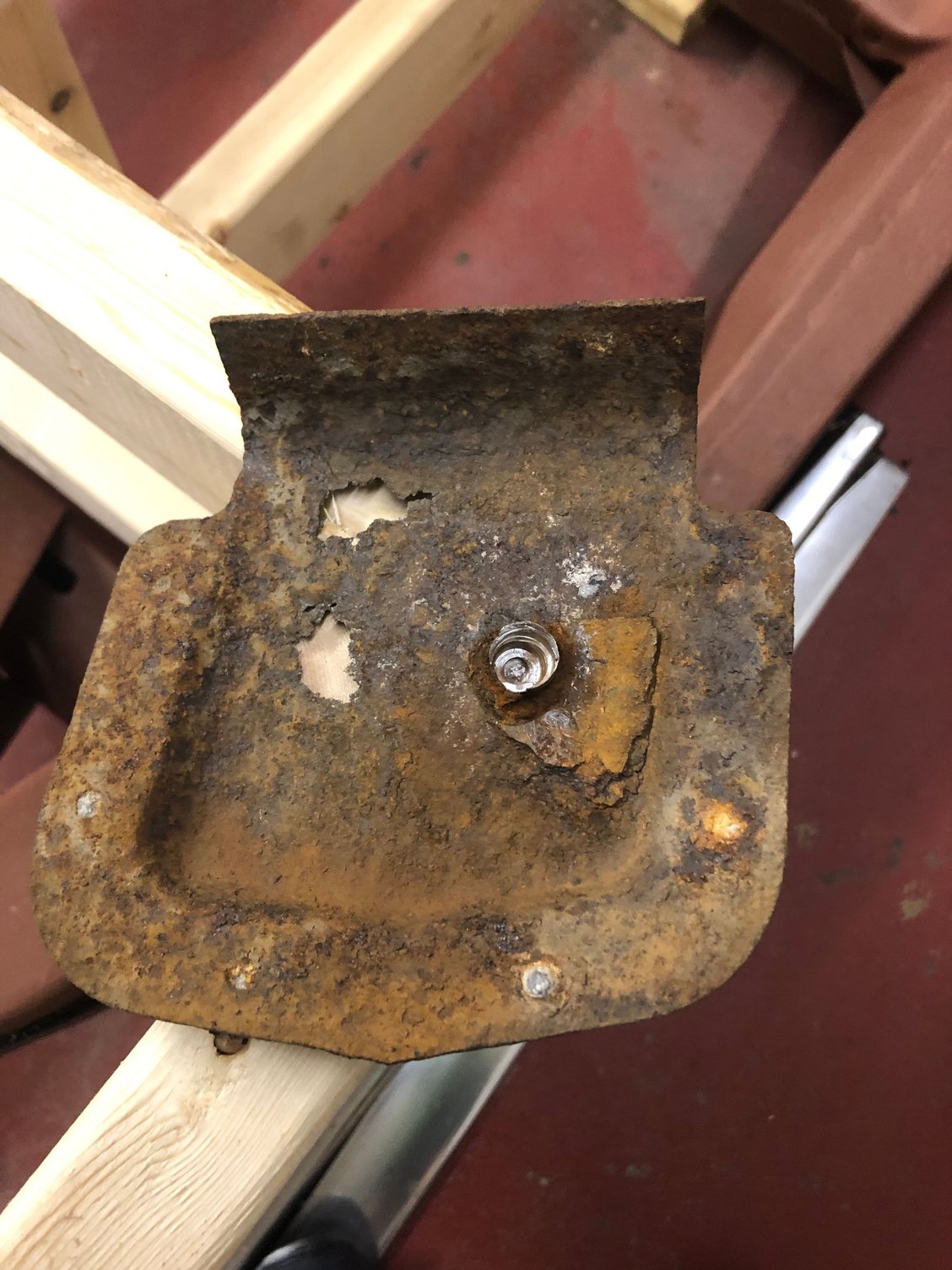

Good day. Seats are out. The seat belt backing plates have definitely seen better days. I didn’t realize how rusted they were. Of course, the bottom facing the road had multiple layers of undercoating on it, but the side facing the floor boards, never touched and layers of rust flakes, to the point where there are holes that were never designed to be there.
Also got the radiator out and some of the bumper supports. I still have to figure out what all needs to come out with that radiator support frame. I’m afraid because some of those bolts look more like rust than bolt.
So, I made decent progress today. We will see if I can get those rear body mount bolts out tomorrow. There isn’t much room in that pocket. I can’t get a 1/2” universal joint in there, because the angle isn’t enough to try to use an impact gun. So I’m still not sure how to get those body bolts out.

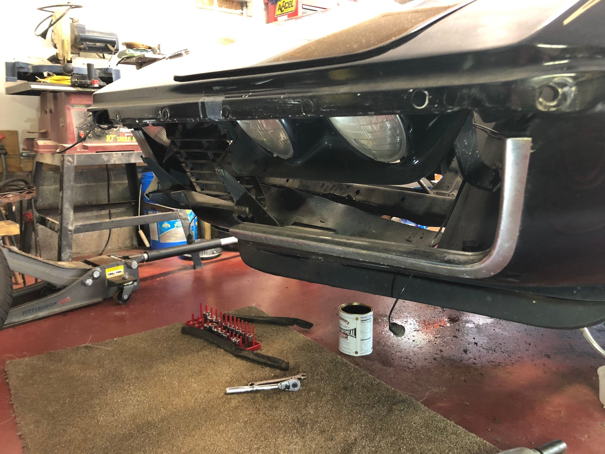

So most of the front bumper is off. The frame horn to bumper supports are out, the center bumper support is out. Making progress.

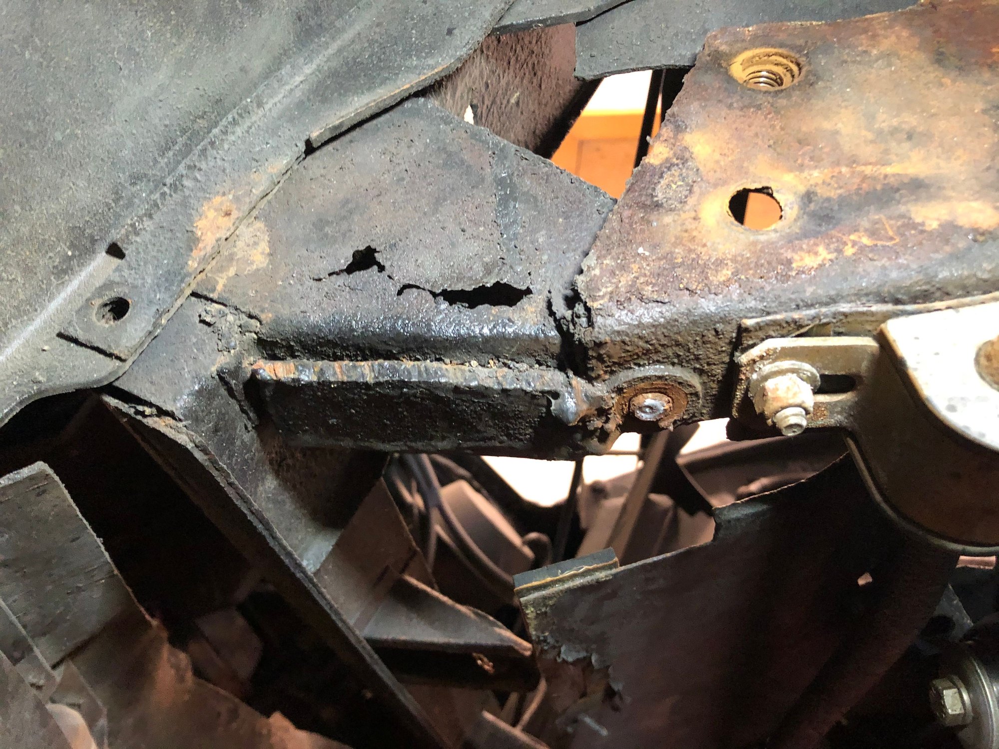

I started looking at getting the radiator core support out, and noticed it was pretty ugly. I tried to take the lower support bolt out and the head snapped of. Nothing new. Not the first time that has happened on my car. With the bolt out, I can see the full scope of bubba work done. Not only did the previous owner weld over the core support with 1/4” steel, he welded it directly to the frame horn. And even welded the washer to the frame. Thank you sir, may I have another! Now I have to cut it out. No hope for salvaging it now, not that the giant rust holes didn’t already make that decision for me.

You are much better off getting a 69-up radiator support and a larger aluminum radiator. All 68's had cooling problems. This car was GM's first "bottom breather". Look at a 63-67 Corvette and you have a huge open front grille to cool the radiator.
Our C-3's have two headlights blocking the air flow and then a front license plate too! Our cooling air only comes in through the two lower chin holes that the front spoiler supplies with air. Lou.

In Ohio, starting on July 1, there is no longer a front license plate requirement. I'm sure I was grandfathered in with a 1968 car, but I can assure you that the big flat, front license plate holder will not be going back on my car. That front grill looks cleaner without it anyway. Plus the additional airflow. Also with the aluminum radiator that I already have, I should have no problem with cooling.
Since I have a 1972 frame, that is a fantastic idea about the 69 core support. I was worried about having to cut those frame horns, because the 68's are one inch longer than the 69+ cars. With that radiator core support, and the front frame extensions from a 69, I can make what I have work without modifying that 72 frame. That drastically simplifies this project. I had to replace the radiator core support anyway, and the frame extensions have seen better days, so I won't be upset replacing those. Especially if it saves me from cutting and welding this new frame.

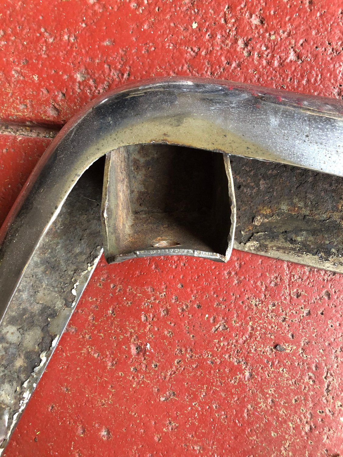

Here’s all of the recent fun. First of all, I figured out my car was hit in the left rear (prior to me owning it). My first indication was trying to remove the left outer frame to bumper brace. All bolts removed, and the piece just stuck there, suspended in mid air. Turns out someone fiberglass welded that brace into place. Couldn’t be bothered to remove 3 bolts before glassing over it. Then I found the center bumper braces were bent on the left side. The top brace is from the right side. The center brace is the bent one and the bottom most is the new replacement. Not bent terribly bad, but enough that I don’t like it and I wouldn’t put it back on the car that way.
Then there are the center most braces. Top is the right side, middle is the new replacement (note it looks very closely shaped to the original on the top), and the bottom one is the bubba brace. It is about 1/2” off from the others. It has been cut, extended and welded to fit the crash damage.
And here is today’s discovery. Why would I think the left bumper mounting brace wouldn’t be crushed? It is not supposed to be mushroomed out and bent like that. Everything should be in a nice 90 degrees from each other. What I don’t know is if I should try straightening this one out or buy a new one. The knock offs are not an option, so that means this is a $500+ replacement part. What do you guys think?

I would try straightening it out or look for a good used one. The repop bumpers have had a lot of complaints over the years since I joined
I figured I had nothing to lose by attempting to fix it. It wasn’t as difficult as I thought. A hammer, punch and some vice grips was enough. It turned out better than I was expecting. Not bad for a complete amateur hack. And cheaper to rechrome it than buy a new one. Best I can figure, someone must have backed into an immovable object, or it was a very low speed impact. There’s only minor scratches on the outside of the bumper.
