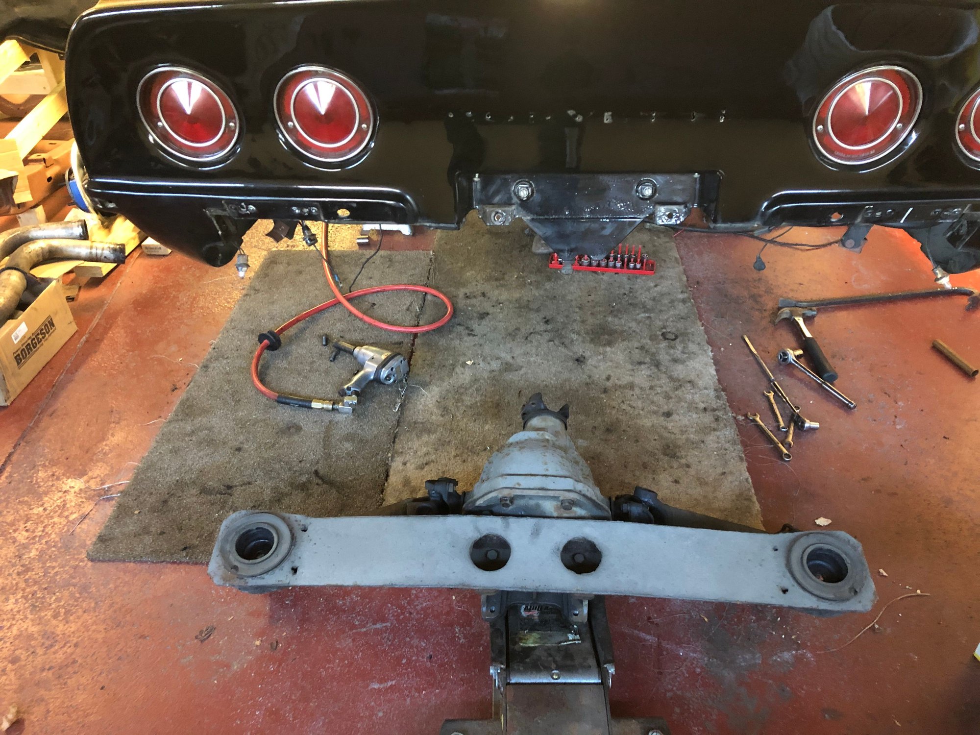

I just thought I would throw this out there. Now that I got the rear diff and half shafts out of the car, and off to the repair shop, I can now much easier see the damage that led to this frame off restoration. I think I know what was causing that clunk in the rear of my car now. This is repairable, right?

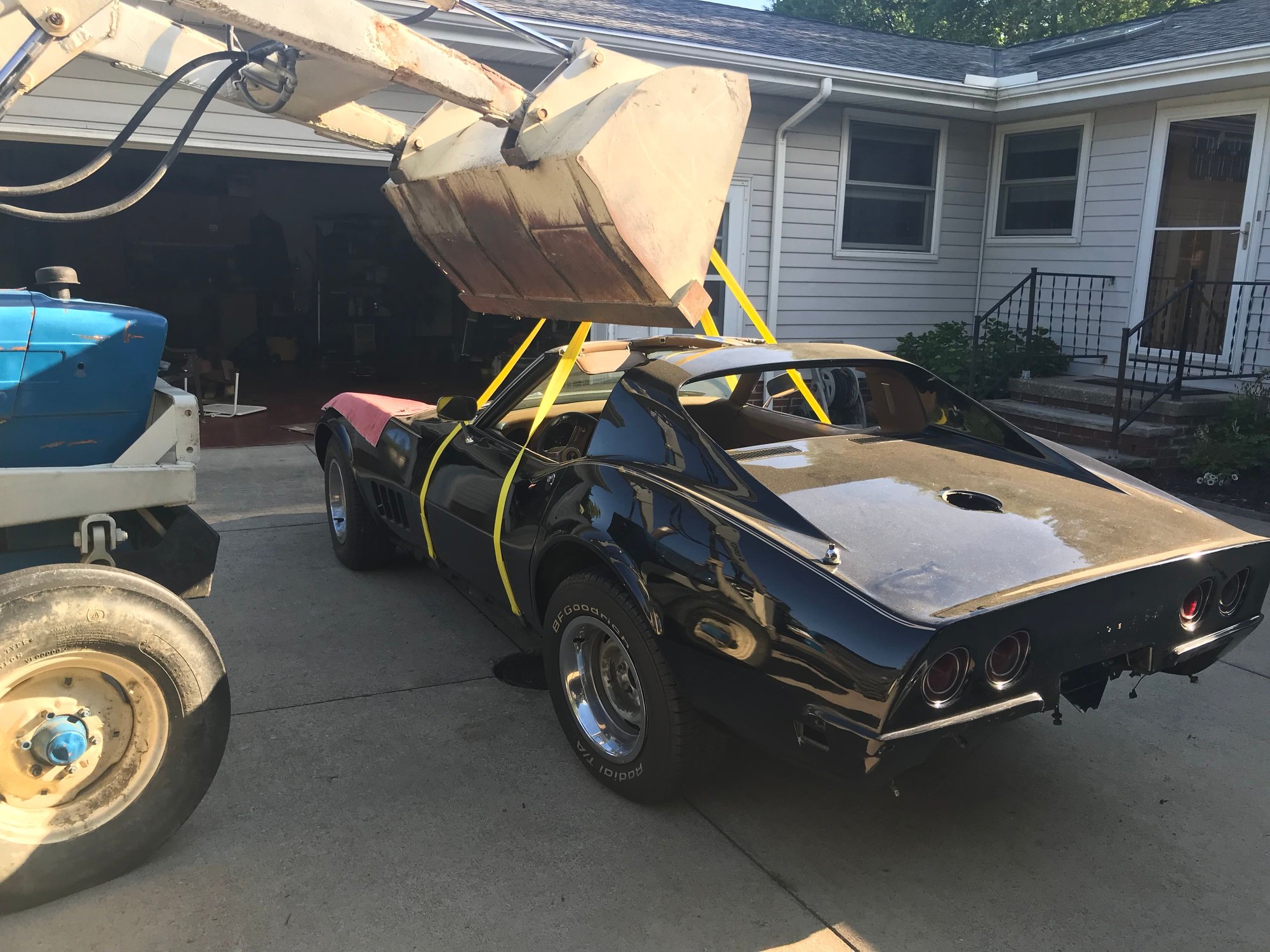

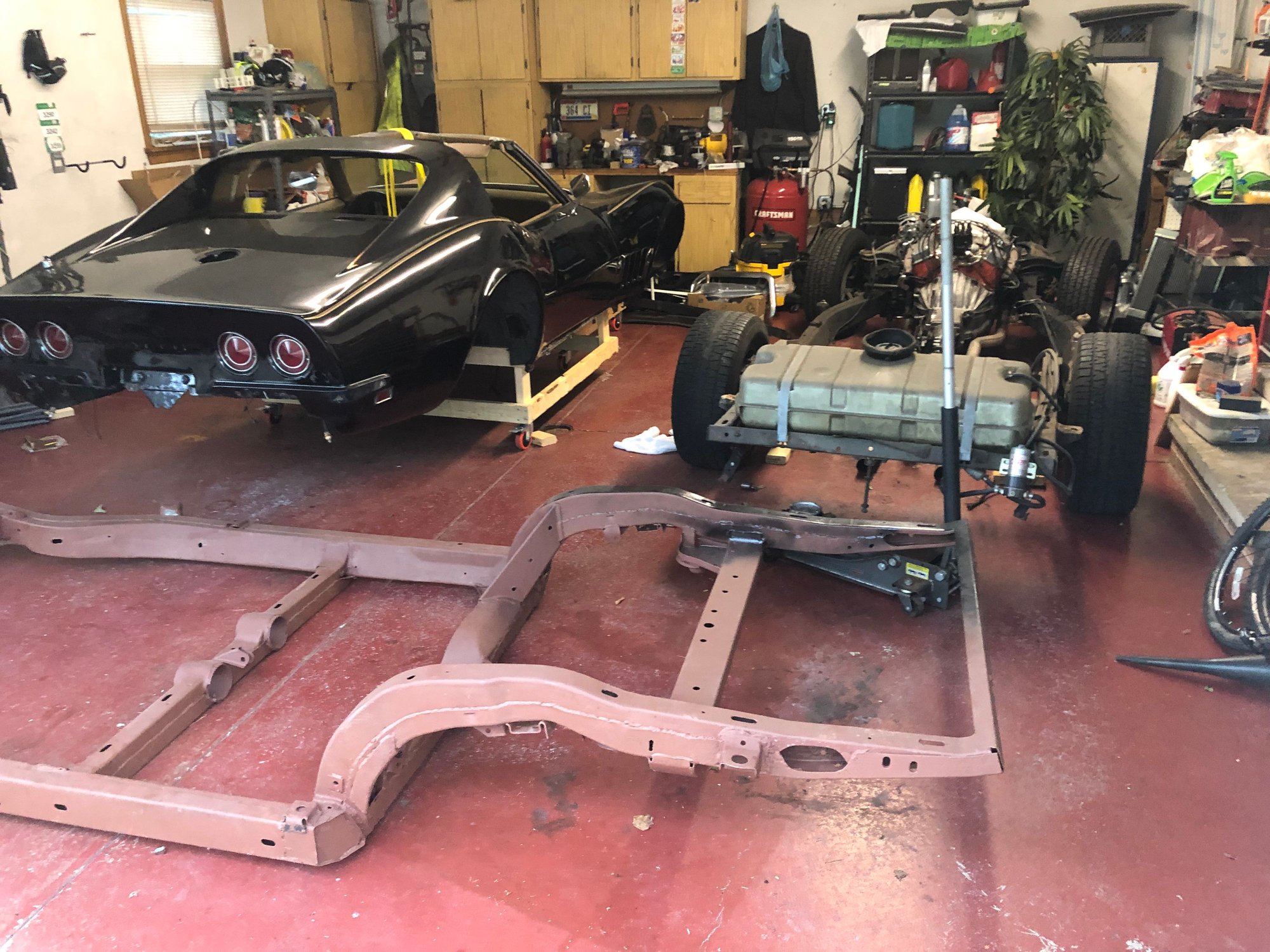

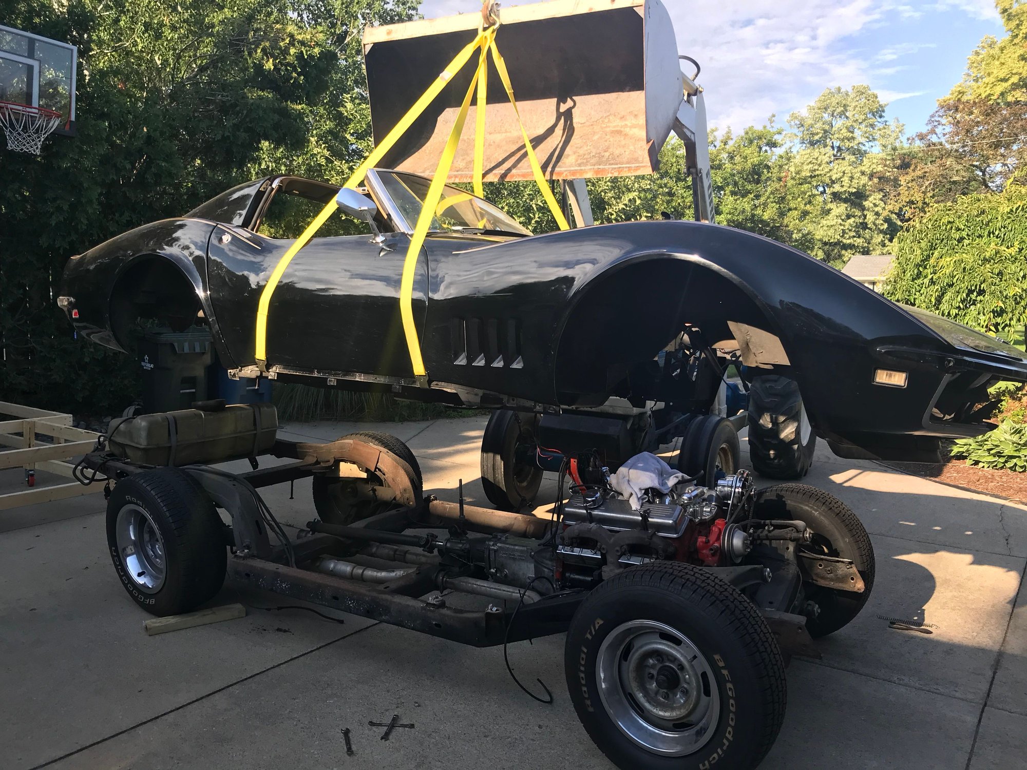

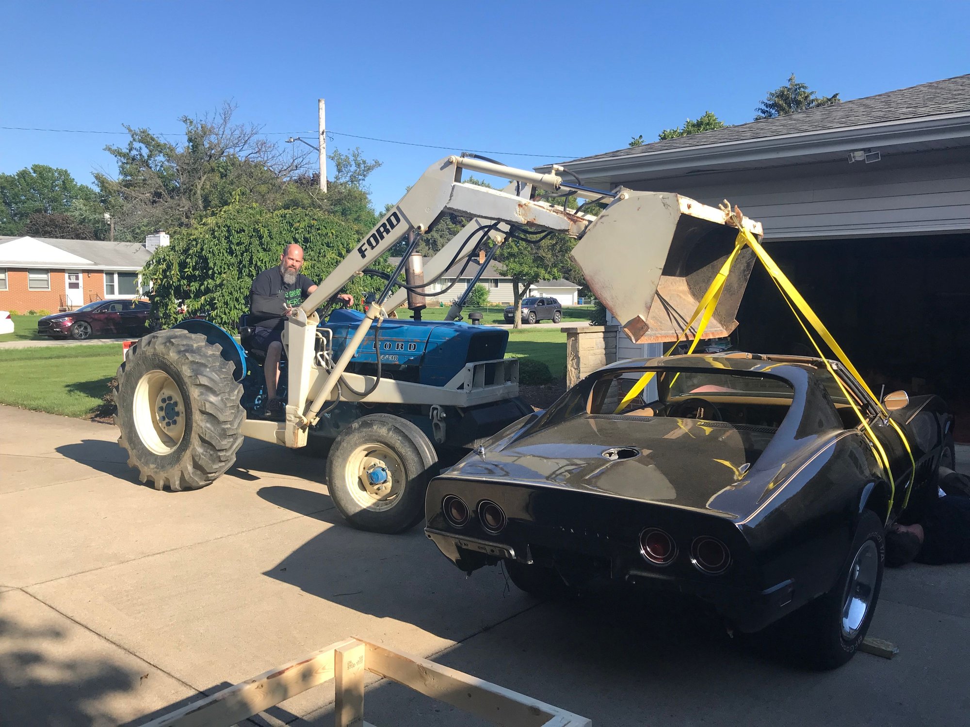

Well body finally came off today. Went easier than I expected. Probably took 45 minutes tops. Only one casualty. I forgot to take off the clutch return spring. It’s a little stretched now. But I’ll take it. That was literally the only snag.
Lifting it up
Getting it into the air:
and onto the body dolly.
now my garage is officially stuffed
Now the real fun can begin!
Old Jun 14, 2021 | 07:49 PM
  #49
Shovels and Vettes's Avatar
Shovels and Vettes
Joined: May 2008
Posts: 9,063
Likes: 2,736
Very cool......its an exciting time at this point. As you said, the fun begins.

Good job! Now...put some bracing under those #4 rear body mounting areas to prevent stress cracks in the paint
Yeah, I’ll have to cut some 2x4’s to support those. It’ll give me something to do tomorrow. Thanks for the tip!

Cool way to pull the body.
First time I've seen it done that way.

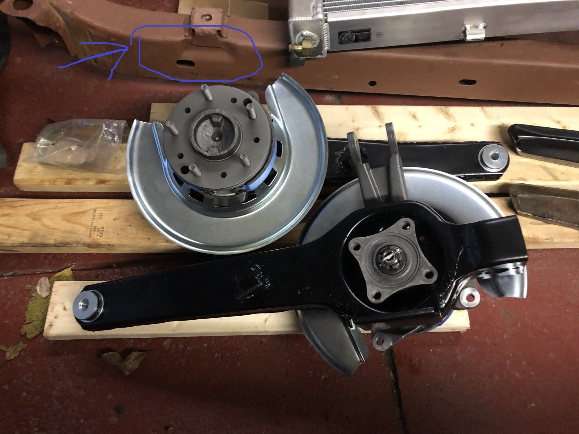

Originally Posted by vette68
I can’t remember all the bastardizarion that was done to this frame. I believe it started as a 76, and the guy I bought it from had the rear frame section from a 72 welded to it. Showed me the receipt. So it is definitely its own frame at this point. I keep calling it a 72, but who knows what the hell it actually is! And now that I have the body off, I can measure to make sure everything lines back up.
Yeah , I was going to suggest it had been butchered , but I didn't want to upset you !
You might want to look at that mount I circled , looks like the guy welded a washer onto the top of it . They are cheap to replace , or at least run a tap through it to clean up the threads and put plenty of anti -seize on the bolt when the time comes .
I’d always rather hear the truth, if anyone sees anything out of place. No offense would ever be taken!
The cage may have been welded around that nut, but a real, valid, square body nut is in there. I have been able to run a new body mount bolt through it. I’ll have to be careful getting it powder coated. I may just leave an old bolt in it so the threads don’t get clogged and I don’t have to tap out the powder coating.
It was a Ford tractor pulling a Corvette body. But it worked very well. Went easier than I expected. I hope it goes back on as easily as it came off!

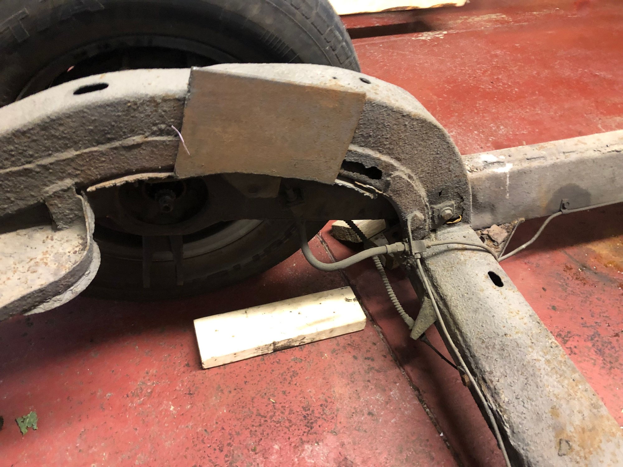

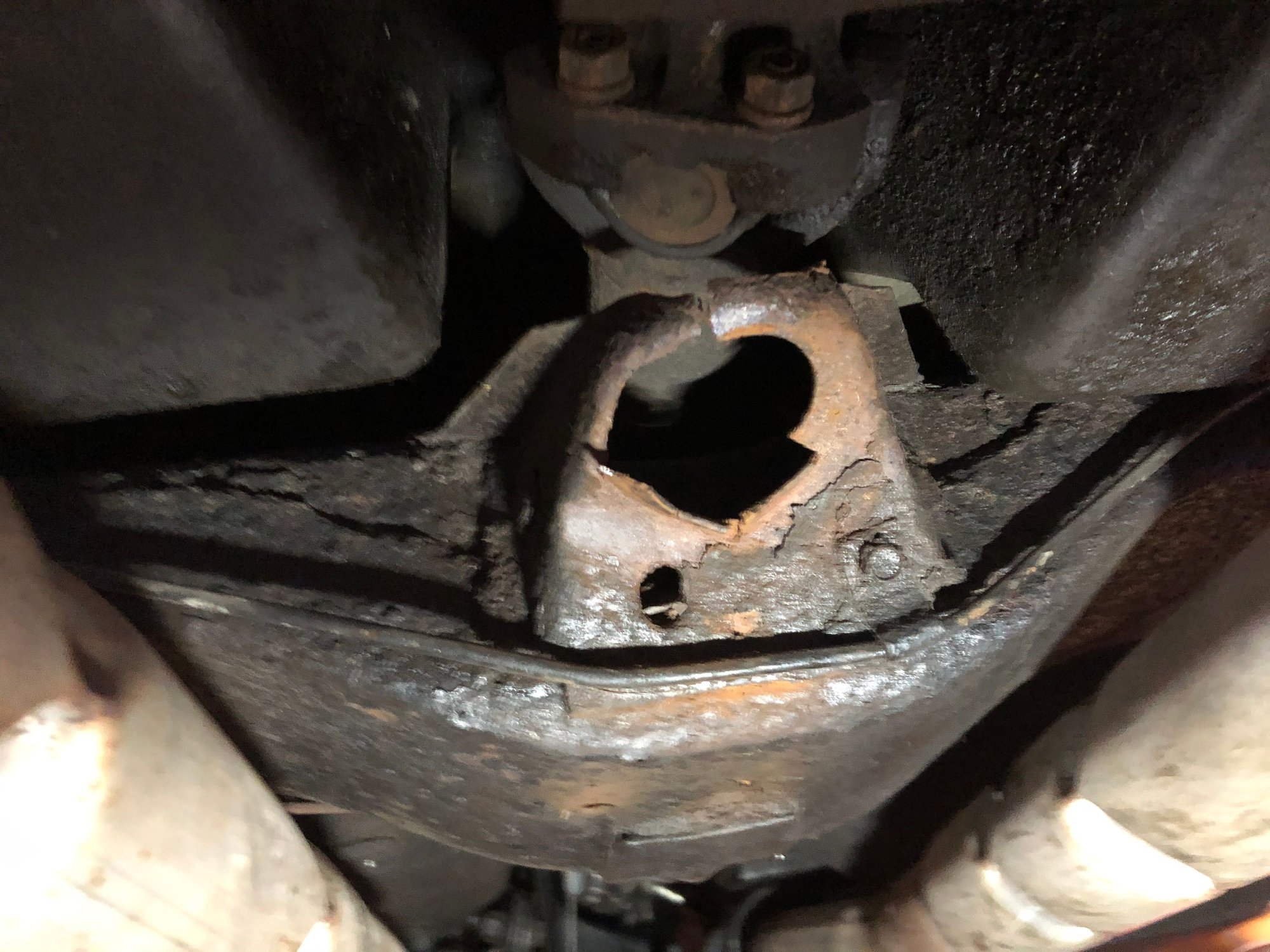

Funny the weird **** you find when you take the body off the frame. I never even noticed that the previous owner welded a giant piece plate onto the left rear wheel riser on the frame. And I can see why they did it too. I was blissfully unaware that this was even here. At least they did a good job welding the piece of plate all the way along the bottom and top edge.
