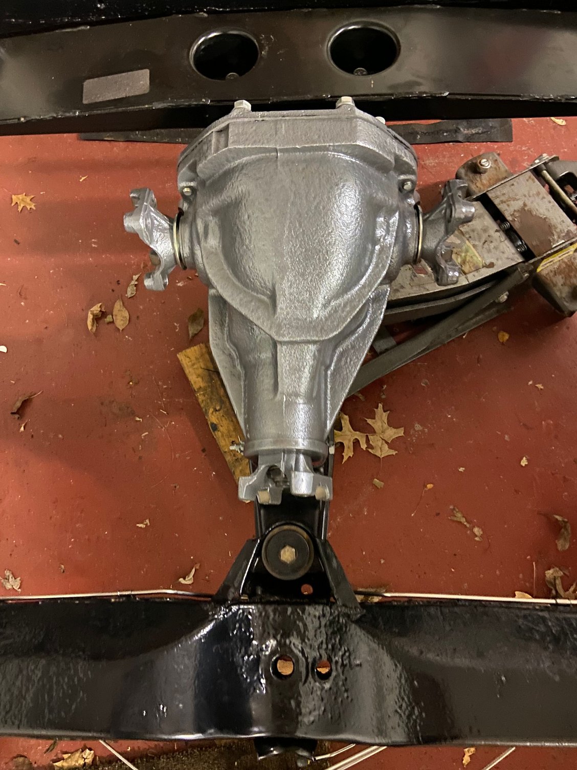

I was also able to get the rear differential installed. I am ordering new bolts for the half shafts so they are not installed yet, but at least the diff is back in.

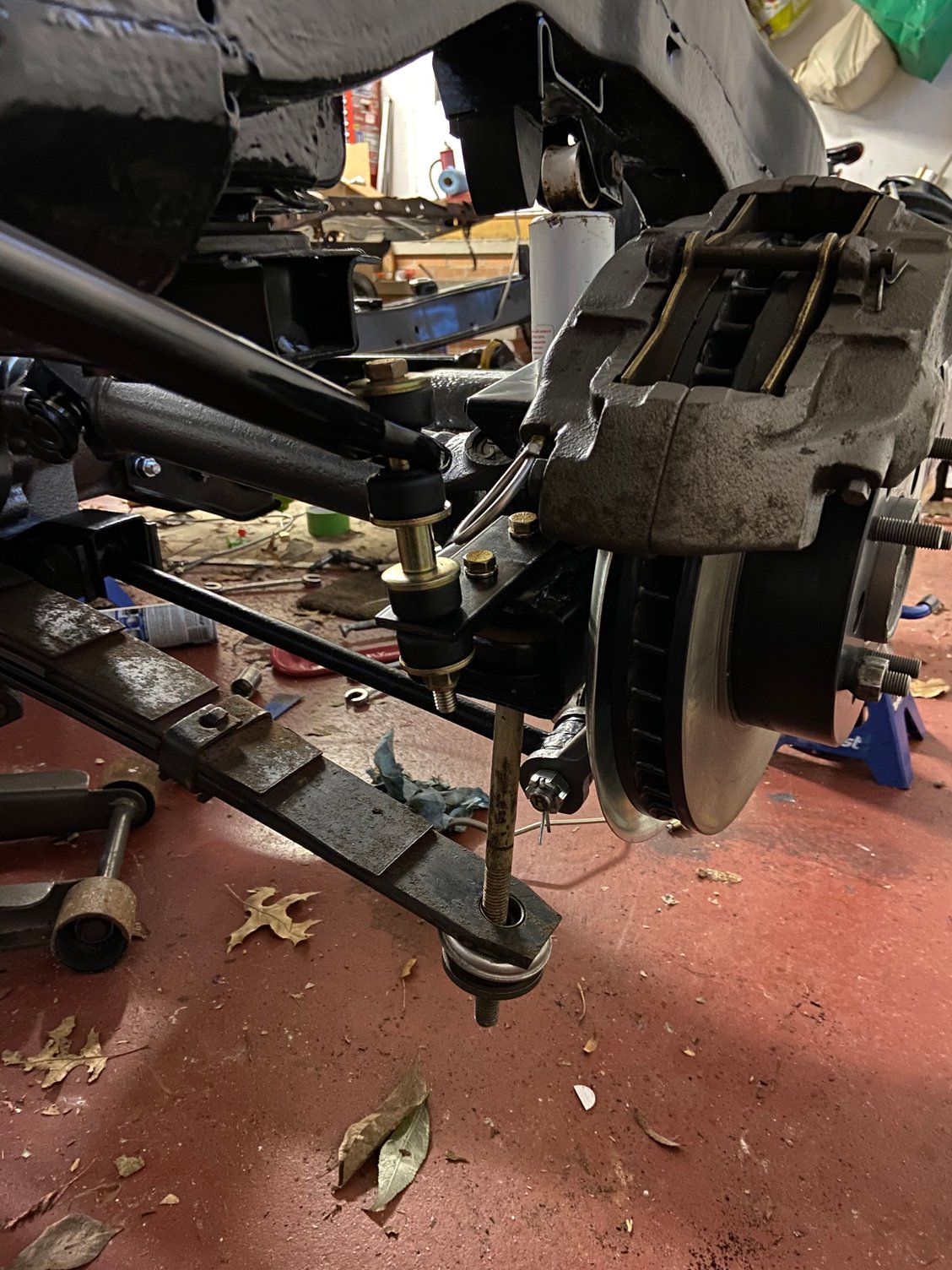

Well there it is. I have a fully functioning rear suspension. I mistakenly thought I could wrestle a 40 pound transverse leaf spring into place by myself. I have the 7 leaf heavy duty spring, 2-1/4” wide In a 2-1/2” differential cover. So getting those 1/8” spacer plates in was a chore. I needed a buddy and even a come along to get everything in place. Was way more difficult than I remember it being when I installed it initially. But it’s all done. Leaf spring, shocks, strut rods, sway bar, brake lines. I even re-indexed the rotor so it lines up with the parking brake port (friendly reminder to not forget to do that if you are replacing the rear rotors). I’m starting to run out of things to do on the frame. I’ll be ready to move the motor and trans soon. Moving right along.
I also got the front spindles in yesterday. Rented a spring compressor from Auto Zone to get that done. It was a chore too. But got as much of the steering linkage in that I could. New steering damper, idler arm, ball joints, tie rod ends…. Of course, my tie rod end alignments are not even close to a guess at this point. We will see if I can give them a visual alignment when I get the tires on, so I can at least get it to an alignment shop without chewing up the tires completely!

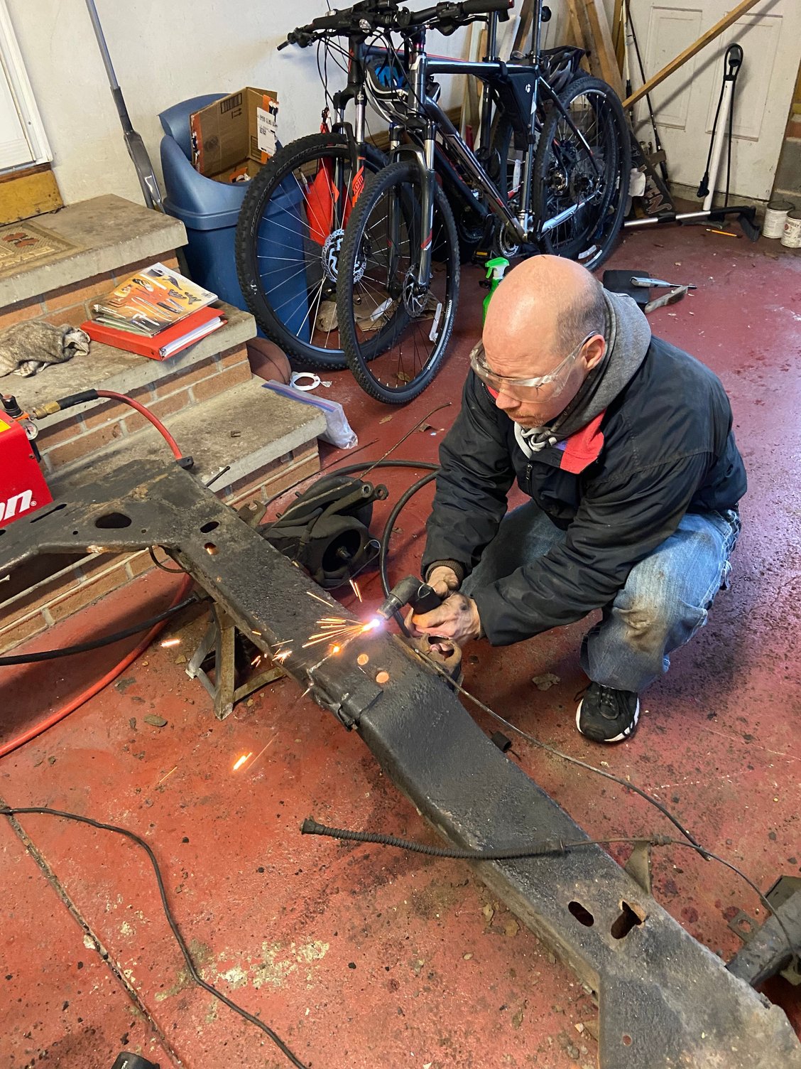

I hope nobody was waiting to offer me stupid money for my old shitty frame. Too late now. Because the fun has begun. Old frame plus plasma cutter equals lots of sparks. Yes it is as fun as it looks! So the old frame is not coming out in one piece. It is coming out in multiple pieces. I needed to make some room to walk around the new frame so off with the back end of the old frame.
What you can’t see well is the almost 2 inch pile of rust crumbs in the old frame right where I cut this apart. And I’m sure most of the rest of the old frame is equally as corroded.
Anyhow, destruction is therapeutic and fun so I had to share.

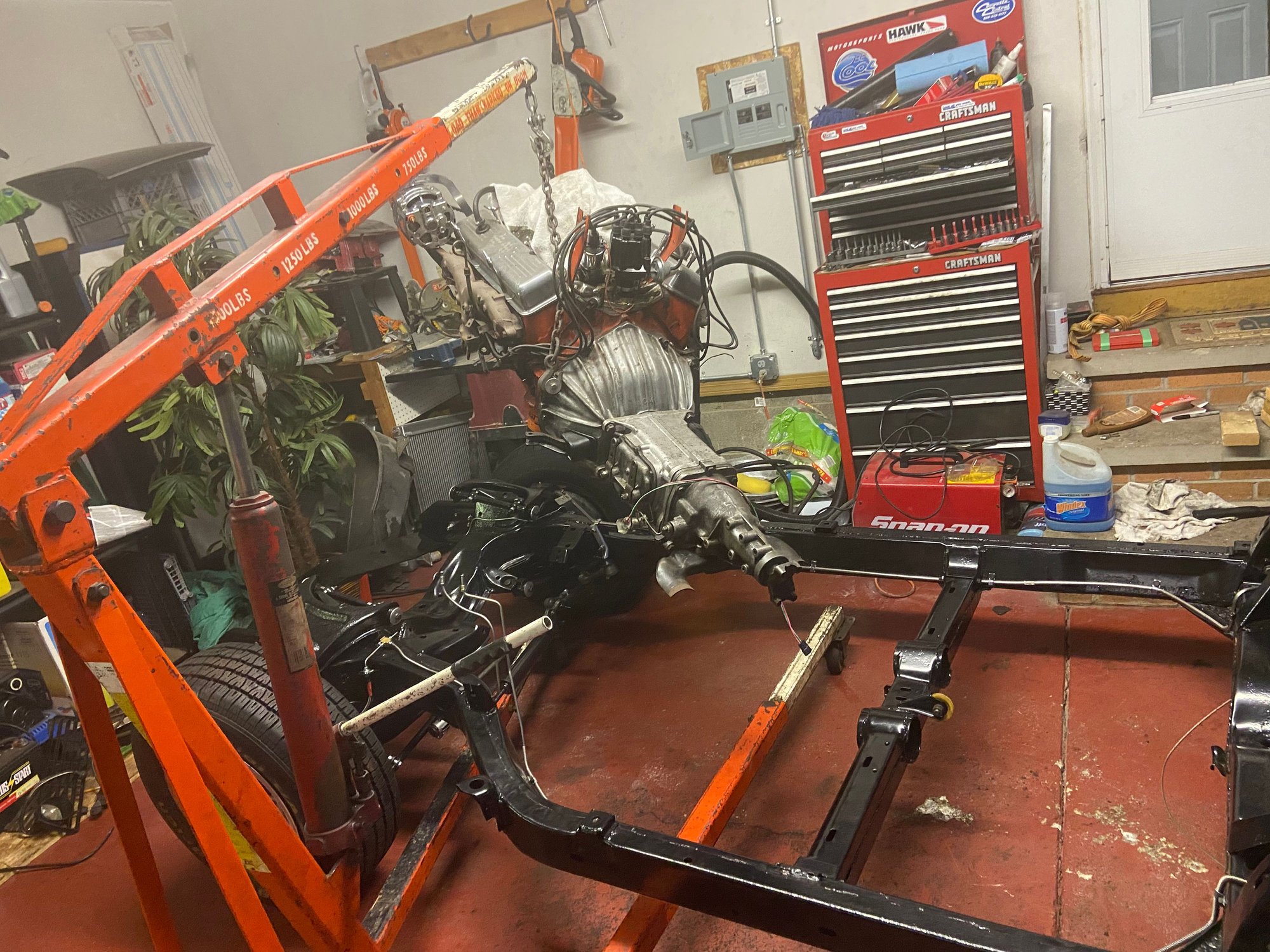

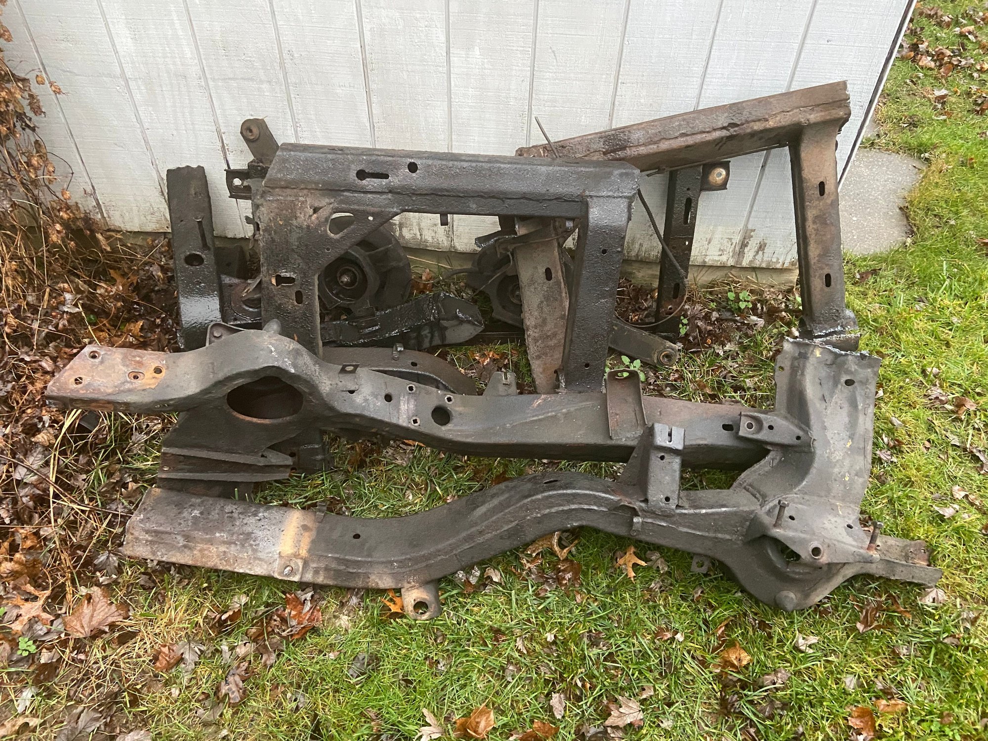

Another good day. I essentially went from 3 cars in my garage down to 2. I got the engine pulled from the old frame
Then it was time for destruction. The old frame was a rotted piece of ****. There was no saving it. The rust holes were too huge and it was structurally gone. So a buddy and I got some quality time with the plasma cutter.
So all hacked up and set outside next to my shed. Hope it doesn’t rust in the rain!
So after the old frame got removed, the new frame was put in its place. Had to shimmy it around with a jack, but I got it moved and in place. And the engine is hanging over the new frame. I am cleaning the engine and replacing the engine mounts before putting it on the new frame. Gotta get the oil and dirt off the engine so it looks like it belongs on the new frame.
That was enough fun for one day. Now I won’t be tripping over what was essentially 3 cars in my garage before. It’s nice having just 2 now. Well, a frame and a body.

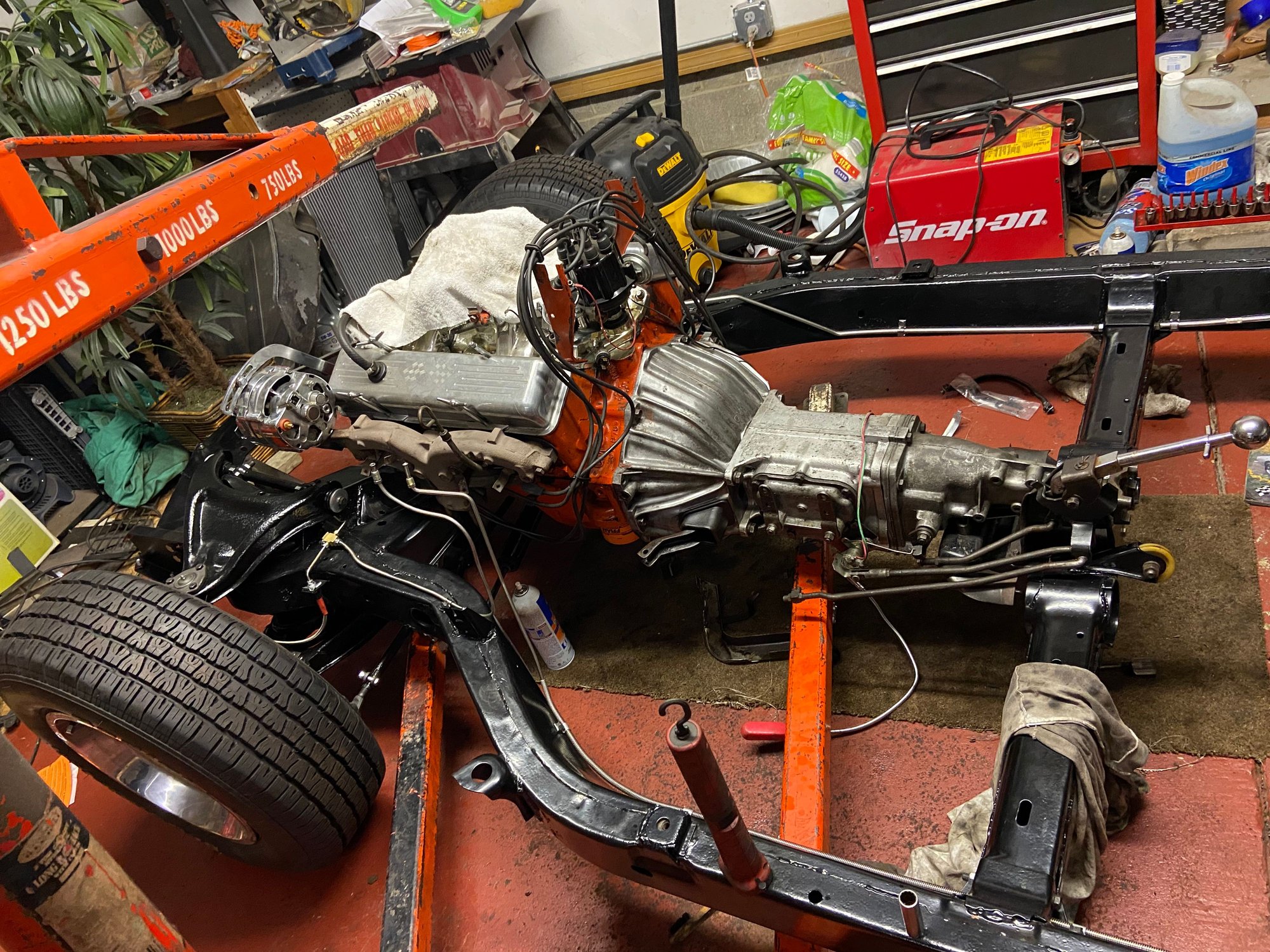

Well happy New Years. My impatience got the better of me today and I dropped the engine on the new frame. It’s infinitely easier to do this alone when you don’t have to maneuver around a body.
I did have to drill the back bolts for the shifter support into the crossmember. This was originally an automatic frame, and I’m “converting” it to a manual trans. The guy I bought the frame from already welded the Z bar in place, but I had to drill the back shifter support bolts. No big deal. The original nuts were welded to the frame, so I substituted for some nyloc nuts so they shouldn’t come off. And since they are inside the crossmember. Nobody will be able to see them.

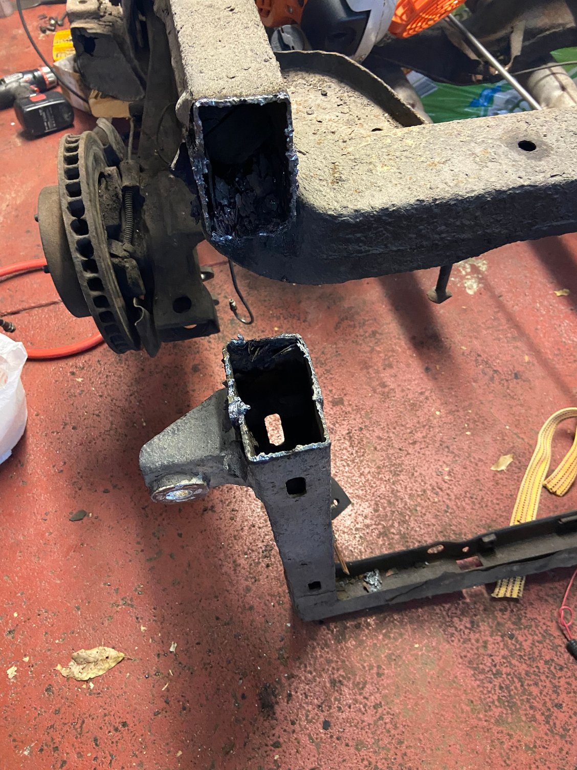

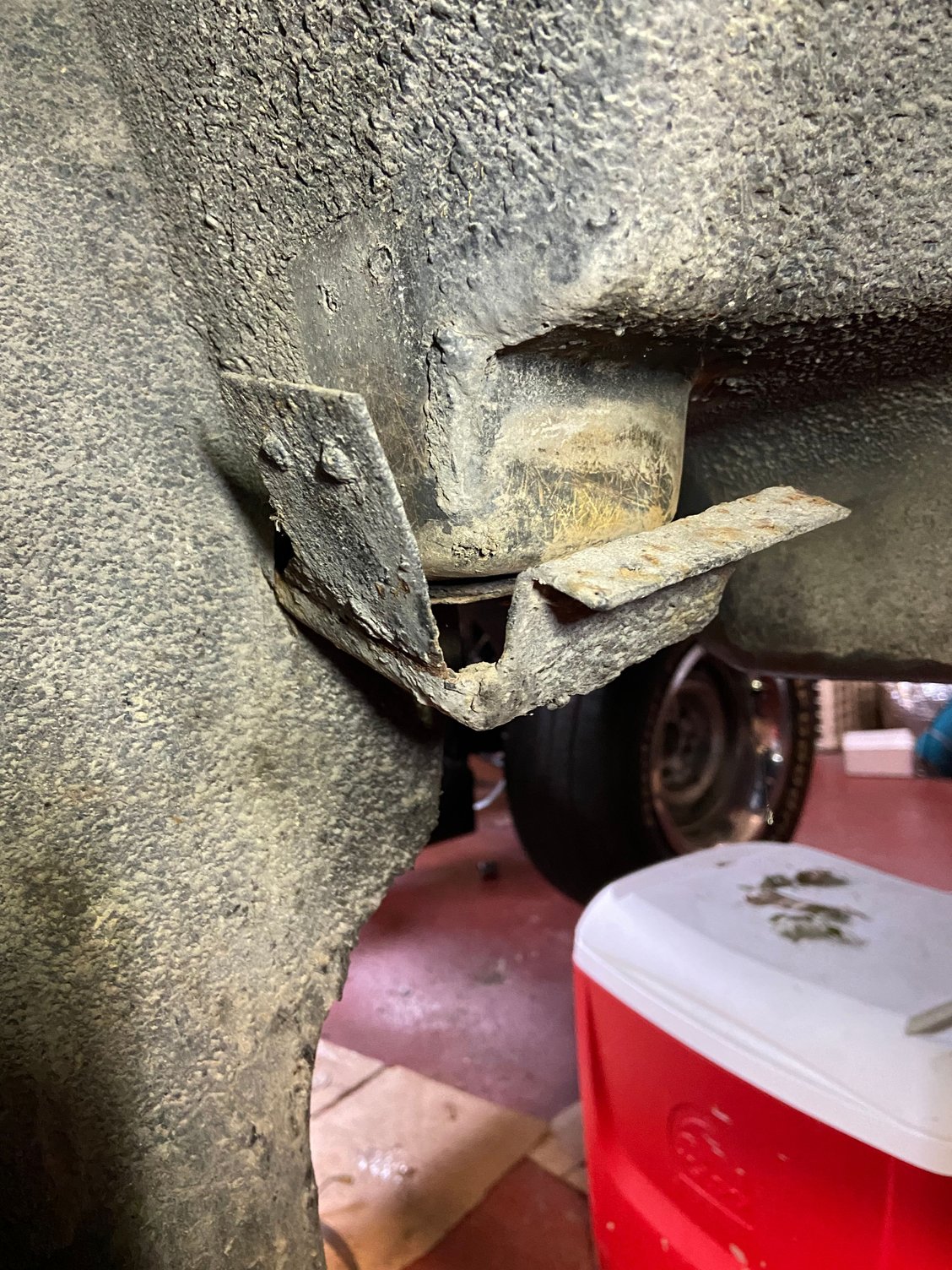

Starting to get some work done on the body. The number 4 body mounts were not pretty. This is what happened when I pulled on it by hand. Not much left of the rivets holding it to the body.

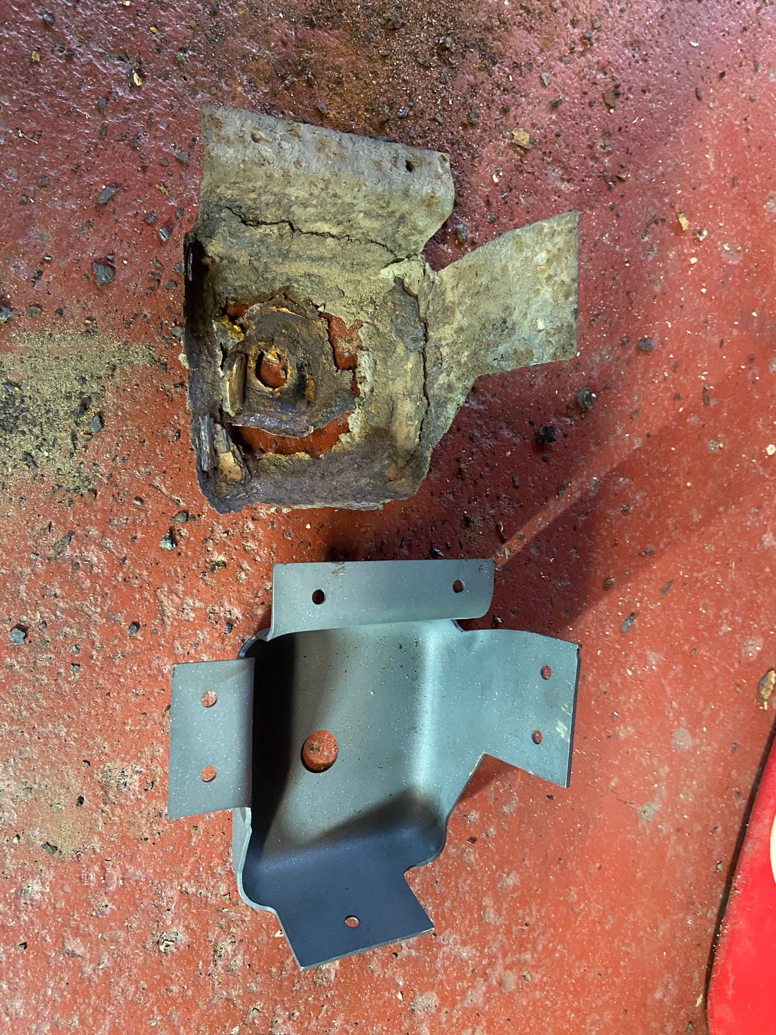

Here is what was left of the passenger side body mount, next to the new one. The old one was rusted all the way through. Held together by gravity.

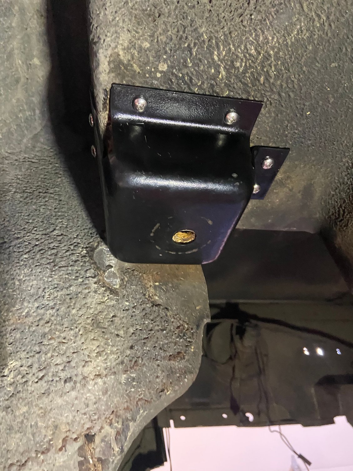

I painted the new one black. And in order to make sure this never happens again, I bought stainless screws and stainless nyloc nuts to hold these in place, instead of using the aluminum rivets. These shouldn’t go anywhere now.
if you are ever looking to buy a C3, look at the number 4 body mounts. If they look anything like mine, walk away. Unless you want to do a frame off restoration.

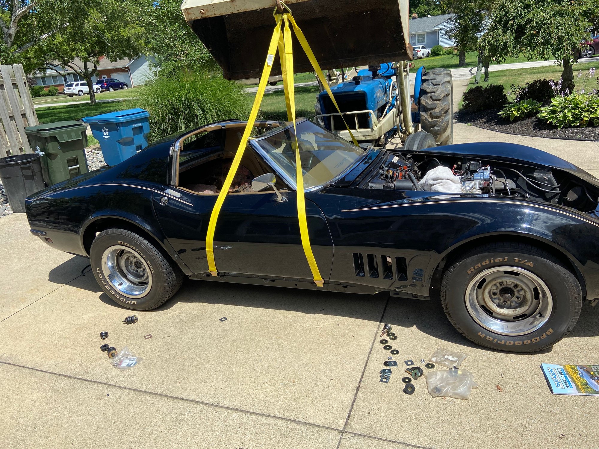

So it’s been a while, but the body finally got put back on the frame today. It went together fairly easily. Took some finessing to get the body mount holes to line up, but all in all, not too bad. Been a long time coming, but I’m glad it’s done. Now to get the rest of the bumper mounts and wiring done. Still more to go, but definitely good progress.
