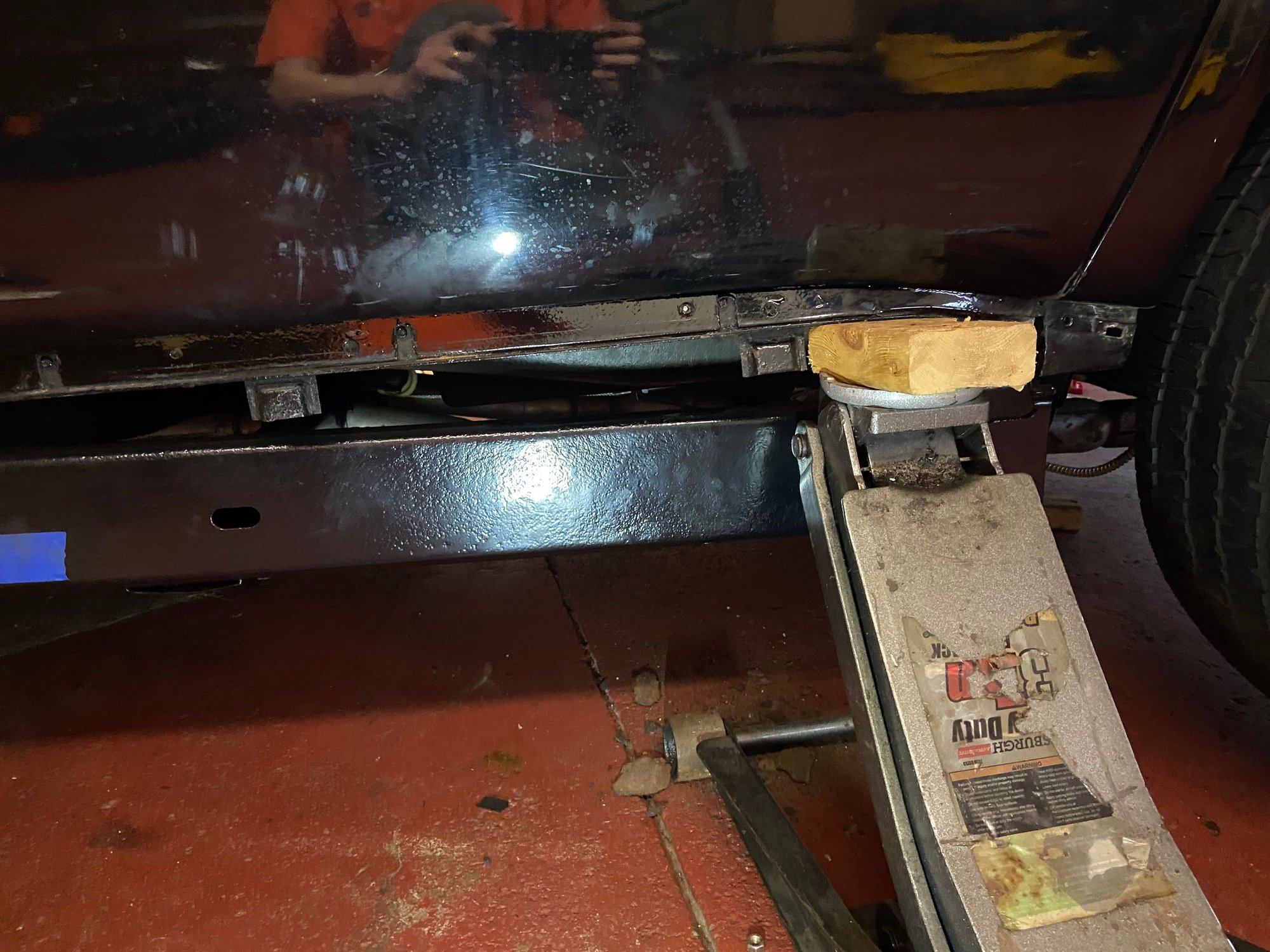

So why would any of this be easy? I got all of the rear bumper braces off, the center seat belt safety cable out, plus all of the body bolts out of the car. Boy, do those come out easy when they are brand new! But that was the only easy part. When I try to jack the body up from the frame, the body lifts about 2-3 inches, then I think the weight pivots and the frame starts lifting with the body. Of freakin course it does. Why would it be easy to jack the body off the frame? You can see the gap between the jack stand and the frame. Guess I’ll have to attack this some other way. At least the new seat belt backing plates are ordered and have arrived. I just can’t install them yet!

It took me 3 tries to lift the body 6"...
You would be surprised how much weight a couple copper-braided ground straps will hold

Ok, so I had to put the tires back on it and drop the car off the jack stands. Then I was able to get the passenger side body lifted. Once the car wasn’t supported so far behind the front wheels, the body lifted pretty easy. And of course, I was so excited that I got it lifted, and could weasel in the new one, I didn’t take any pictures. Maybe when I do the drivers side. So here’s the old right next to the new left. This wasn’t necessary, was it? Even though this is a real pain to do, I just couldn’t half *** it.
So one side down, one to go. Yeah, I just pop riveted it in place. There’s another point off…
