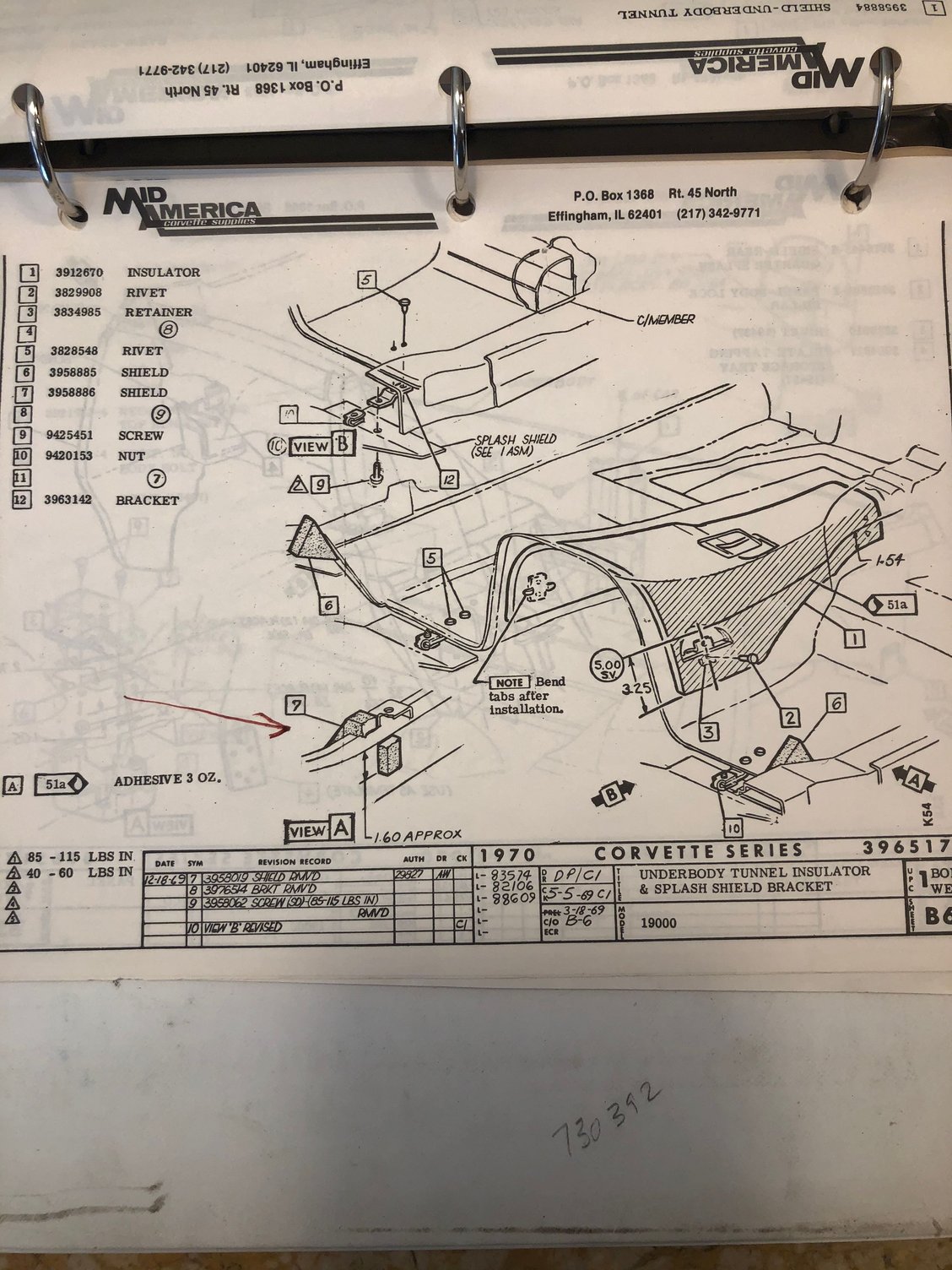

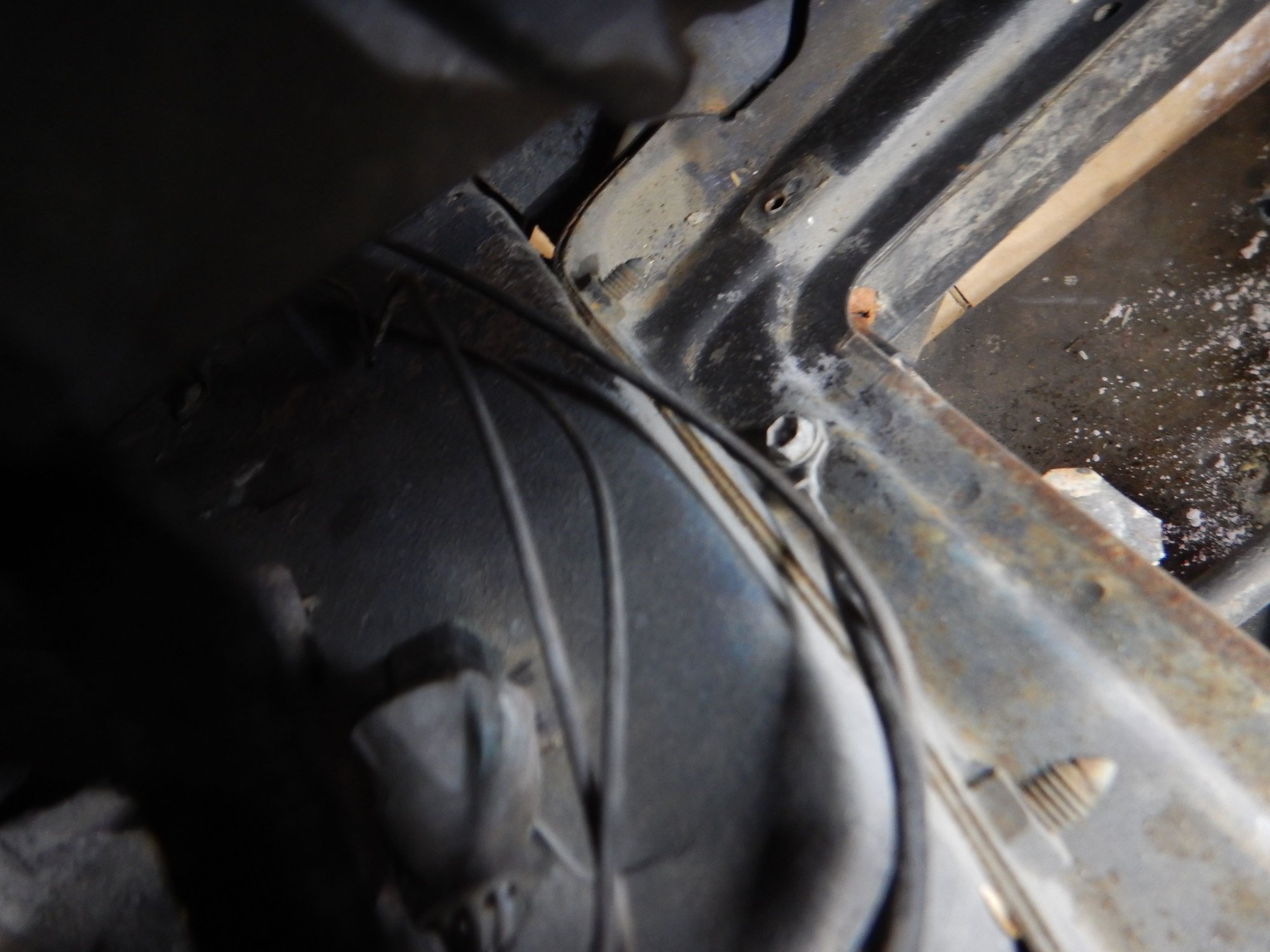

Nice work. There are also 2 ground straps that are located at the #1 body mount/Side vent location, frame to birdcage. Along with 1 ground drivers side rear gas tank area for the rear tail/back up lighting I believe.
Not sure but on my 70' there are 2 foam inserts between the birdcage & frame by the #1&2 mounts for moisture protection.
Hope some of this helps...... Ground Everything... lol
Arrow points to foam piece
Foam insert between #1 & 2 mount
Ground strap between birdcage & frame located in this area/ strap looks similar to the exhaust bbut has a clip on one end.

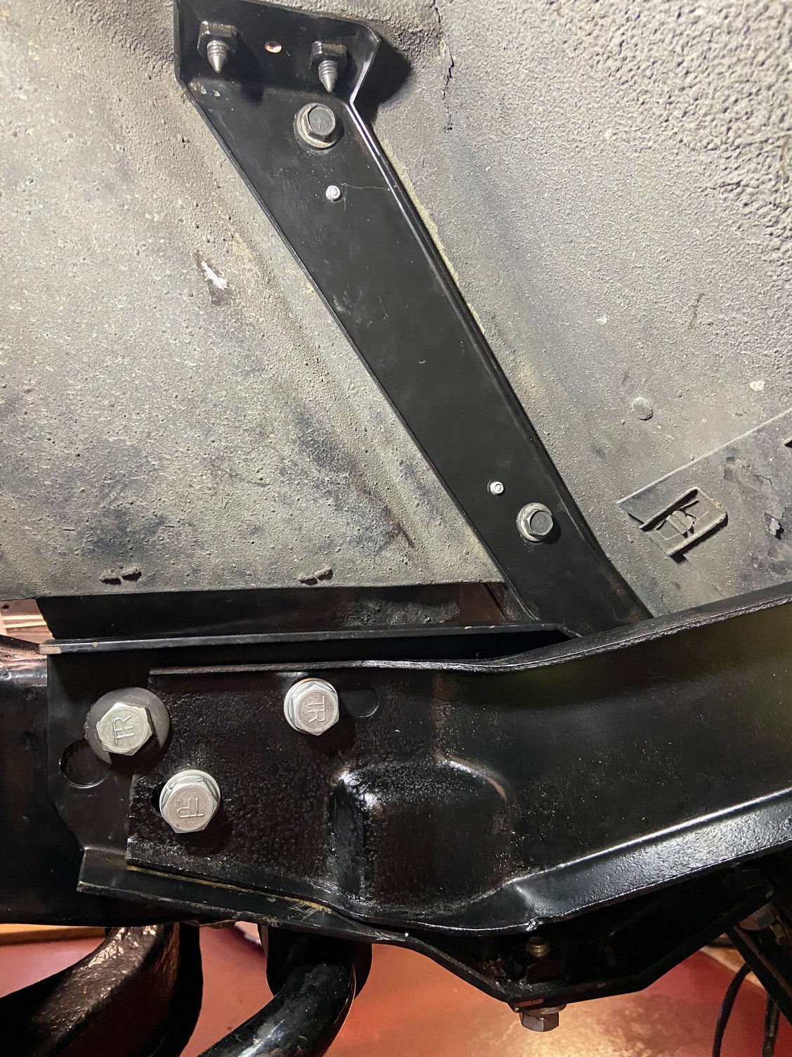

Steady forward progress. Both front bumper braces are in place now. The drivers front fought me more than the passenger, but we are almost 1968 front crash ready now. Shiny new parts and bolts that nobody will ever see again, except me. Now time to start on the front center bumper brace.

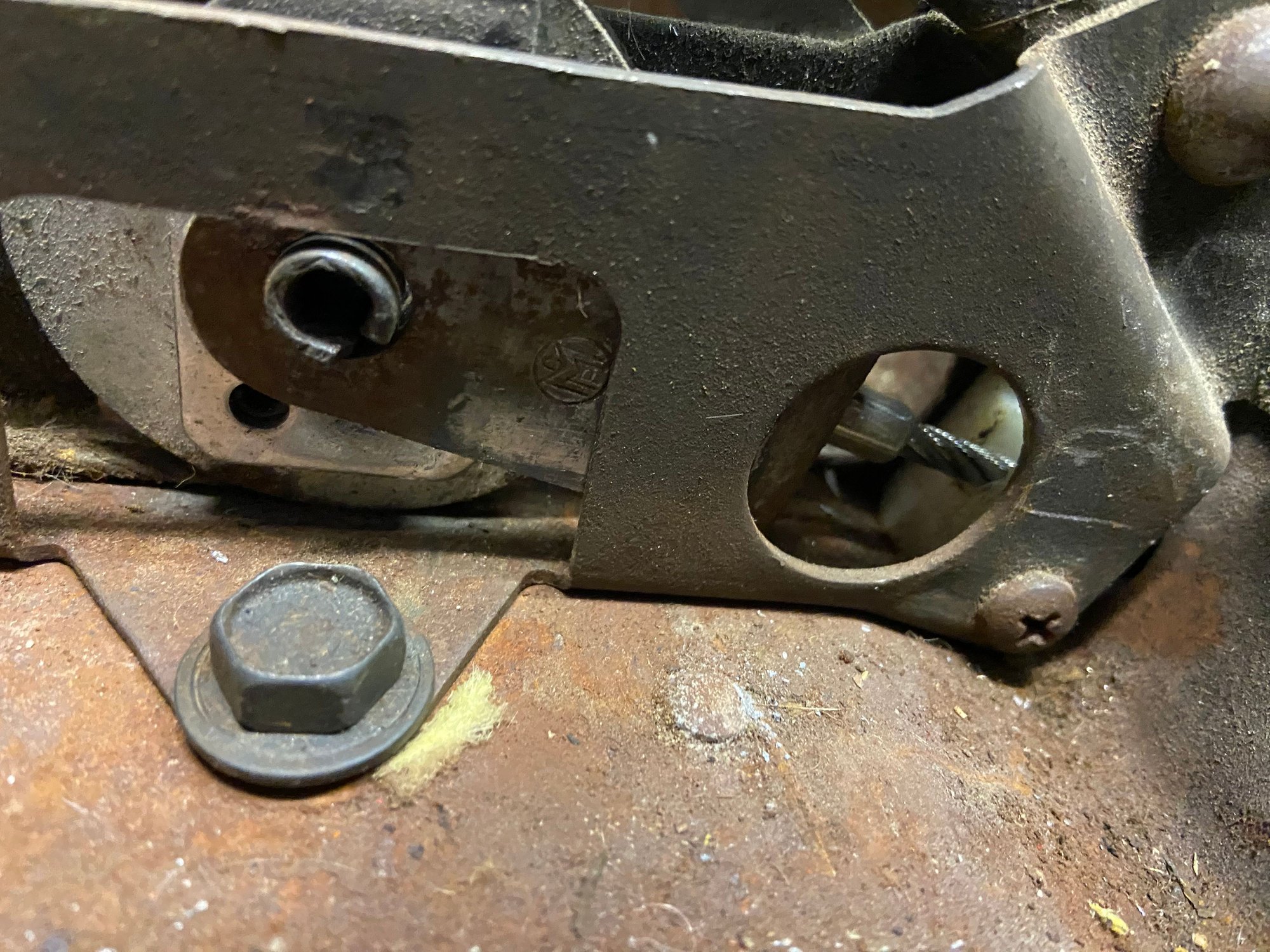

Progress has been very slow recently. But I finally got motivated to get some small things done. And I finally have a fully functioning parking brake, after never having one before. Probably needed new drum shoes, and I would just park it in gear. That was my parking brake. But now I have all stainless parking brake hardware and cables. Got the handle installed. Yeah, hard to get a picture of the new cable in the brake handle.
And here’s the new hardware underneath, with the new seat belt safety cable in place too. Unfortunately, the new brake cable doesn’t leave a whole lot of extra threads to account for future cable stretching. Will probably need to use some washers. But that’s a future problem.
